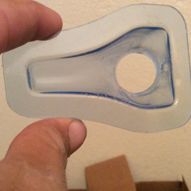

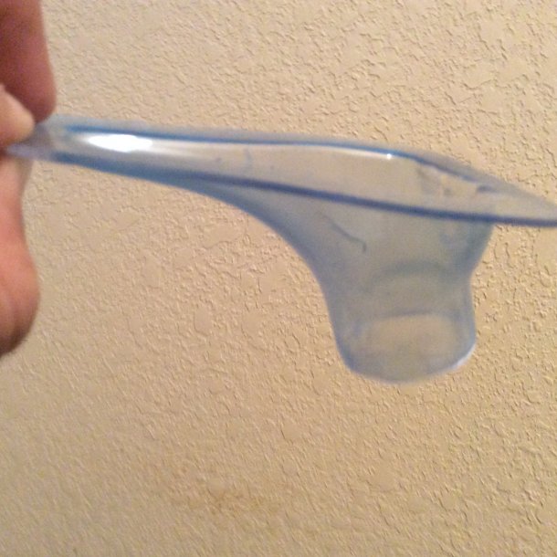

OK did the louvers for the cans.
I've opened 4 separate hols on top of them I've screwed the louvers.
Very easy and fast.
I don't like the regular hols you Dremel on the bottom they are not efficient and don't suck the hit from the cans.
I rather make it obvious but efficient.
If the louvers won't solve it then I'll close the cans with an isolating materiel and add some NACA ducts to the fuse and canopy.
