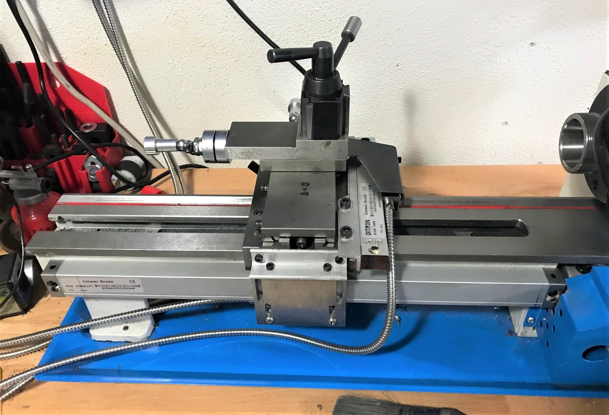

Got the carriage scale installed. It works great so far. Only checked a 3" travel so far, but it's right on the money. I've got to build some extensions for the guard tomorrow so I can get it all back together.

I didn't put any guards on the scales installed with the reader down. The only one that was guarded was the lathe cross slide and now that is gone.

I'll have a cross slide guard. The one I'm putting back on is the splash guard on the backside. I'll extend it out a bit so the chips don't get too out of control.
