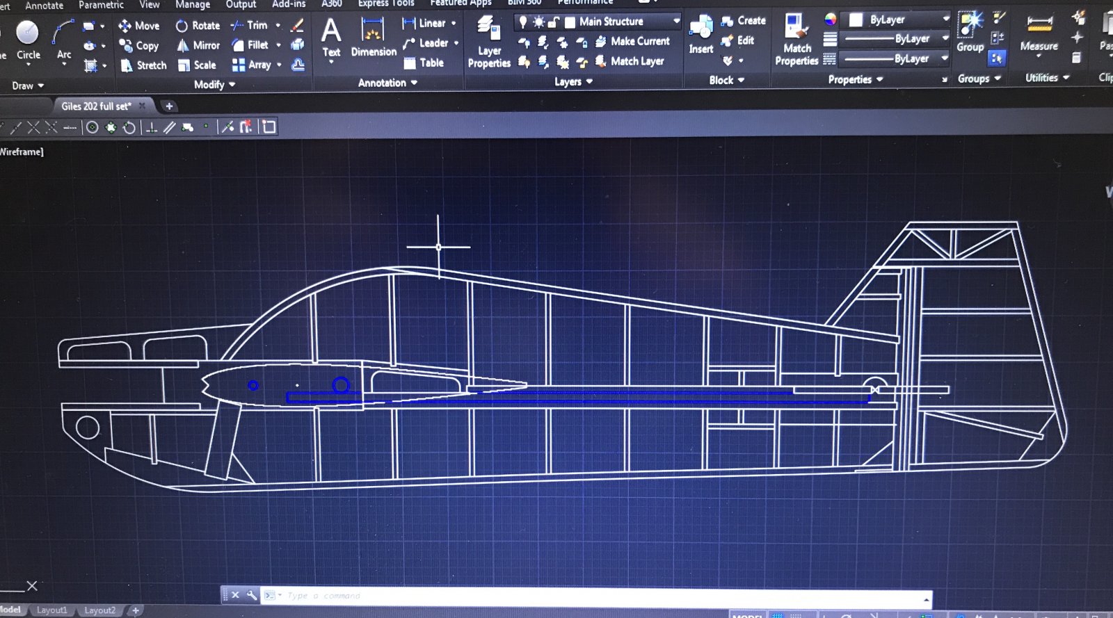

Could be, but I am looking to totally change the materials of the construction of the fuse. Basically a composite structure, with no wood, no fiberglass tubes. Didn't want to attempt any changes until after flying as designed and seeing how the weight comes out. I tend to be very methodical with changes, especially those which I may know little about. Call it the engineer in me. I may end up changing the power plant, but who knows... I am pretty green with the whole 3D realm.

To build it light in my opinion just build it like any other profile out there. Get rid of all the ply, that wonky wing tube mount in the fuse, drop from two 3/8 tubes to one 1/2 tube mounted just below where the wing tube goes through the fuse, and stick build the rest of it like a normal profile. I personally think I could build that plane down to between 7 and 7-1/2 pounds.
Are you implying that you would use carbon instead of the ply, or do you mean just not use the ply - I realize I am confused :D
Yes get rid of the ply and build it with a fiberglass tube down the middle and using balsa like a normal slab. I will post pics a bit later.
