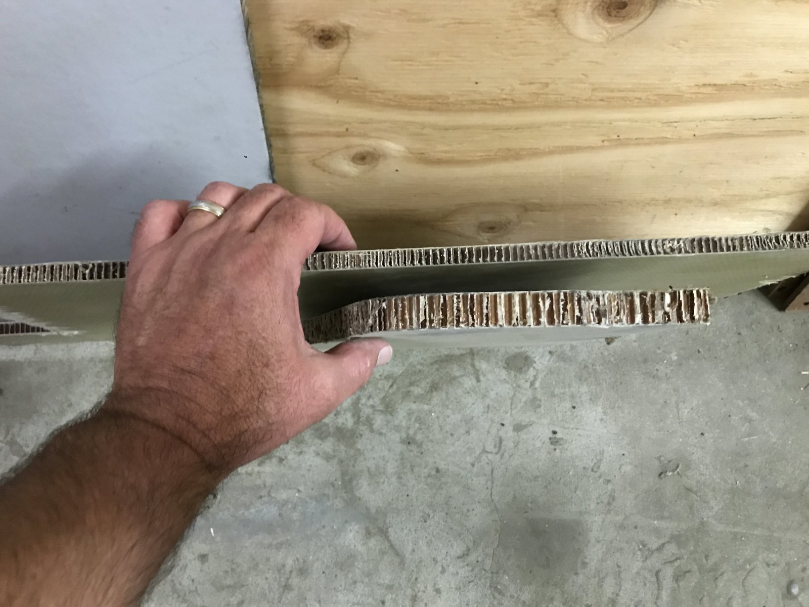

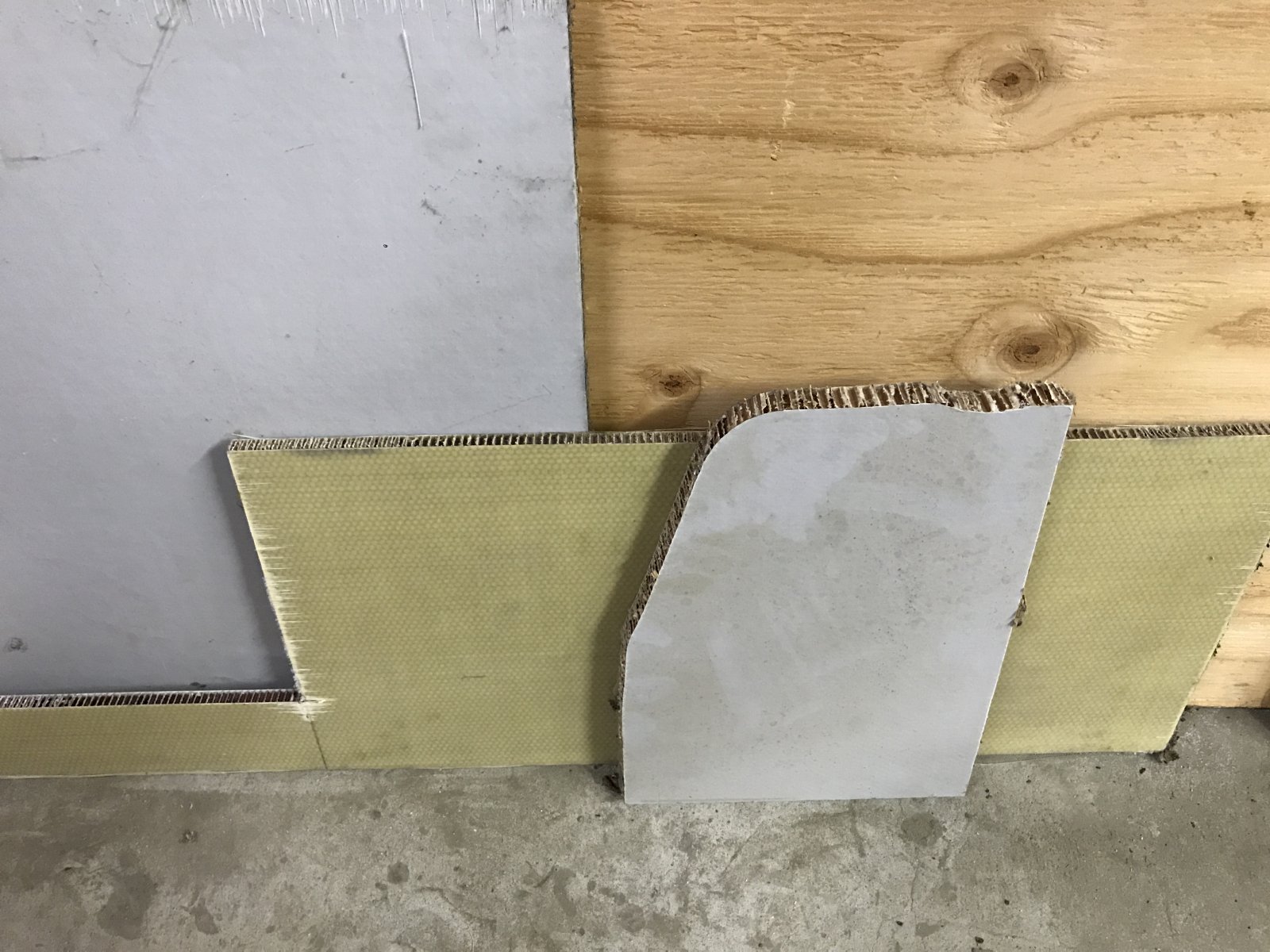

Snoopy: I am looking to use prepreg and aramid core panels. I have several 4'x10' sheets of 11/16" and 3/8" e-glass and a couple 4x8 of 1/2" carbon panels. I used them to build my race boats back in the day. Essentially, I am looking to replace the entire fuse with the prepreg panel.
The panels are below these are the e-glass panels. Also have some with aluminum skins. The carbon is about half the density of the e glasss. 11/16" thickness are about 10 oz. per sq ft. Think it would be really easy to cut out the profile, cut holes for wing tube, engine, etc. and paint. Something to play with.

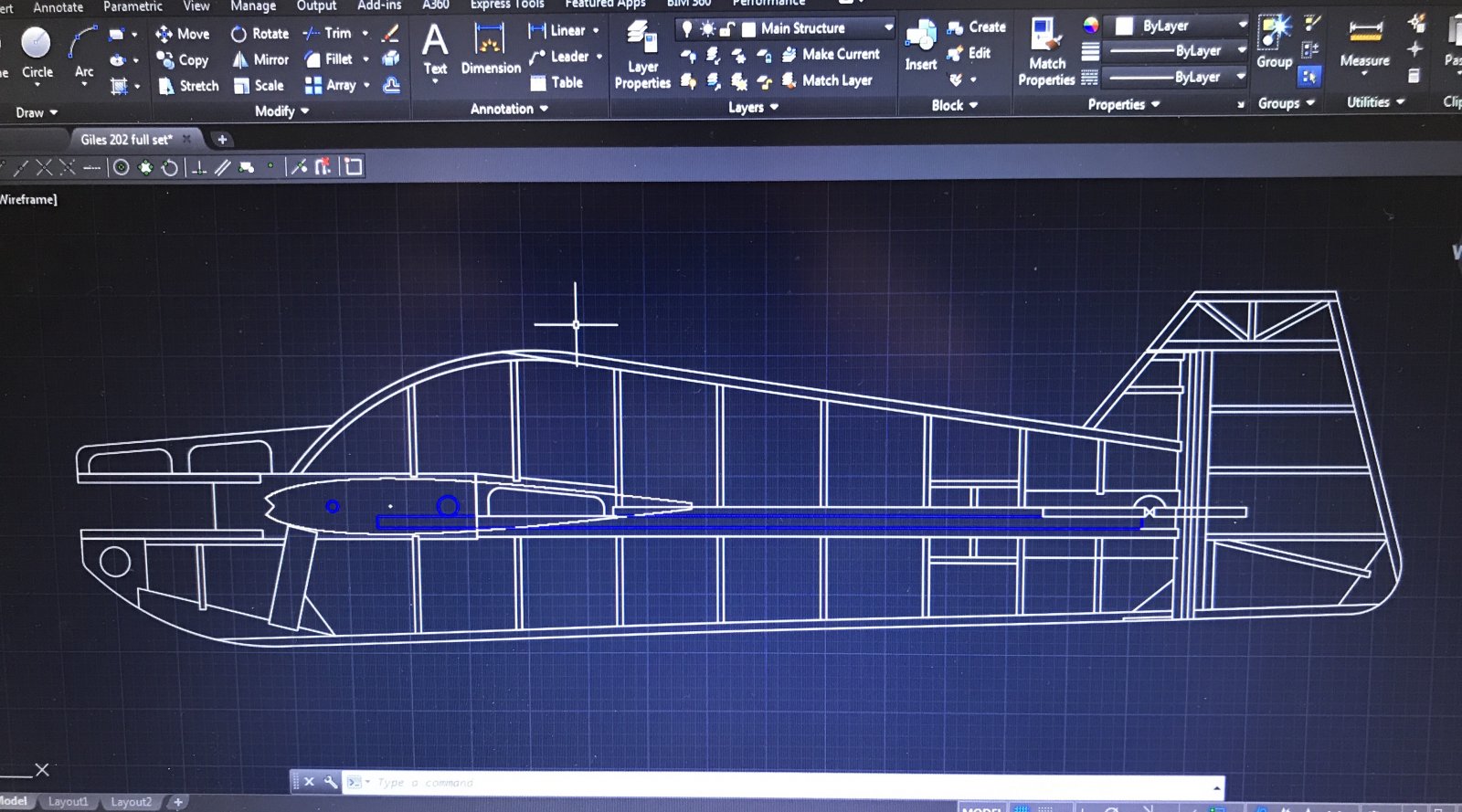

One question on the Acad drawing why have you not pulled the Eglass tube all the way through to the motor mount.
That whole center section is the motor mount. It will be a 1/4" balsa core and two 1/4" x 3/8" hardwood rails then its sheeted on both sides with 1/16" birch ply. Once laminated it's incredibly strong.
