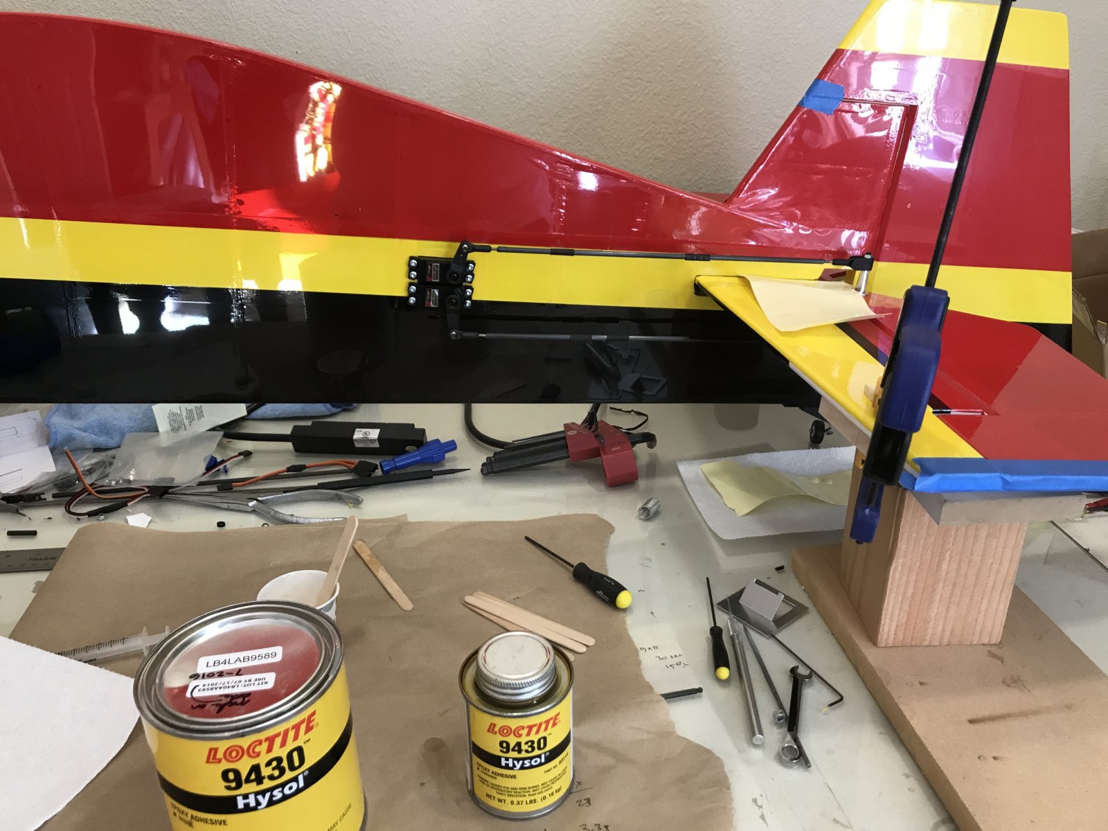

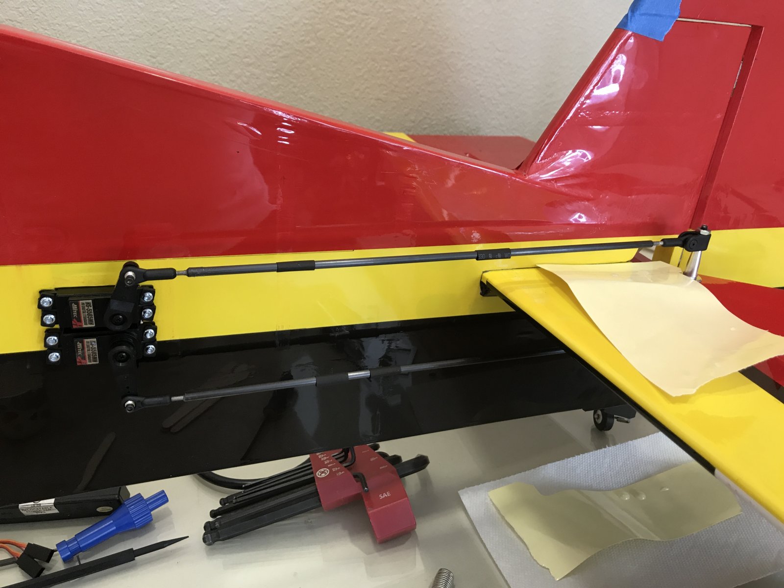

Surfaces are hinged. Got servos installed in tail. Started making up pushrods using 4-40 threaded rod and carbon fiber tubing. First try gluing in the rods using thick CA was a miserable failure. Got mad and used some hysol 9430. Can't find anything that bonds to prepregs better than that. Just takes forever to cure.

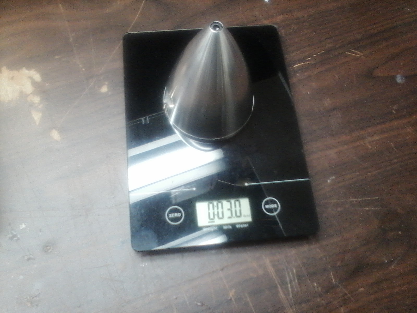

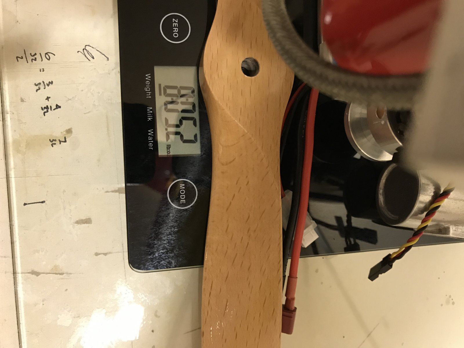

I have everything mounted or sitting on the scale. 8lbs 5.2oz. (Except for tech aero IBEC and a couple fasteners). Also looks to be able to balance reasonably well. Pretty happy with that. End result should end up less than 8.5 lbs.
