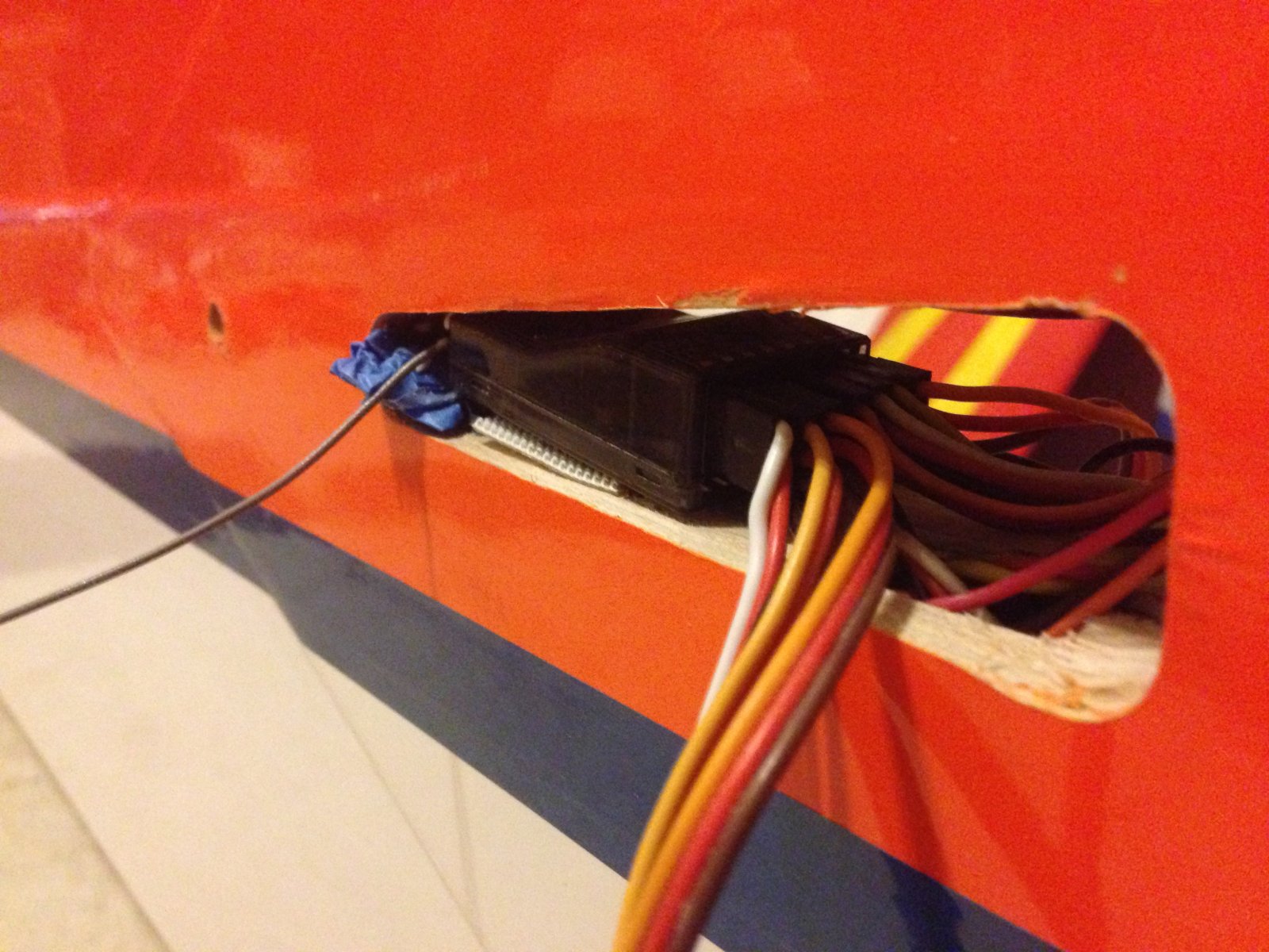

Fuse on my sbach 65 was 5/8" thick and it worked well with a little plate to hold the receiver.
Receiver mounted in my 55cc edge. In my sbach I had it turned facing one wing so once wing was installed I could plug everything in.
