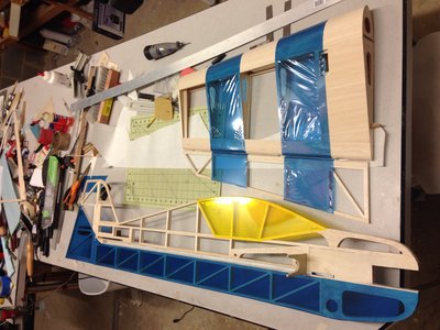

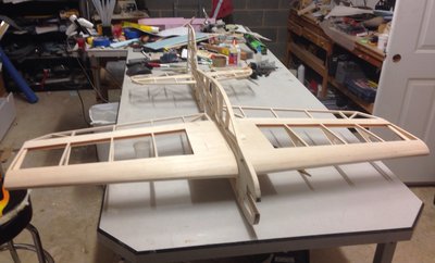

Anyways I will be building version 2 before to long with some changes to it for kwj48 to cover and fly for himself. I should be cutting some wieght on his version so stick around and see
Sorry no new update. Been working a a new profile since I crashed my lamyak. Needed something for all the cuts out of it to go into. As soon as my roll of orange covering shows up I will have it finished pretty quickly. I would be more than happy to send you the rough drawn plans and my templates if you want to build one like V1. You could just make a copy of them for yourself and send me the originals back. let me know. V1 flys great but I do think that V2 will fly better with the mods I have made to it. As far as V2 goes I have the wing saddle glued up and cut out for it but havent gone any further than that with it.
