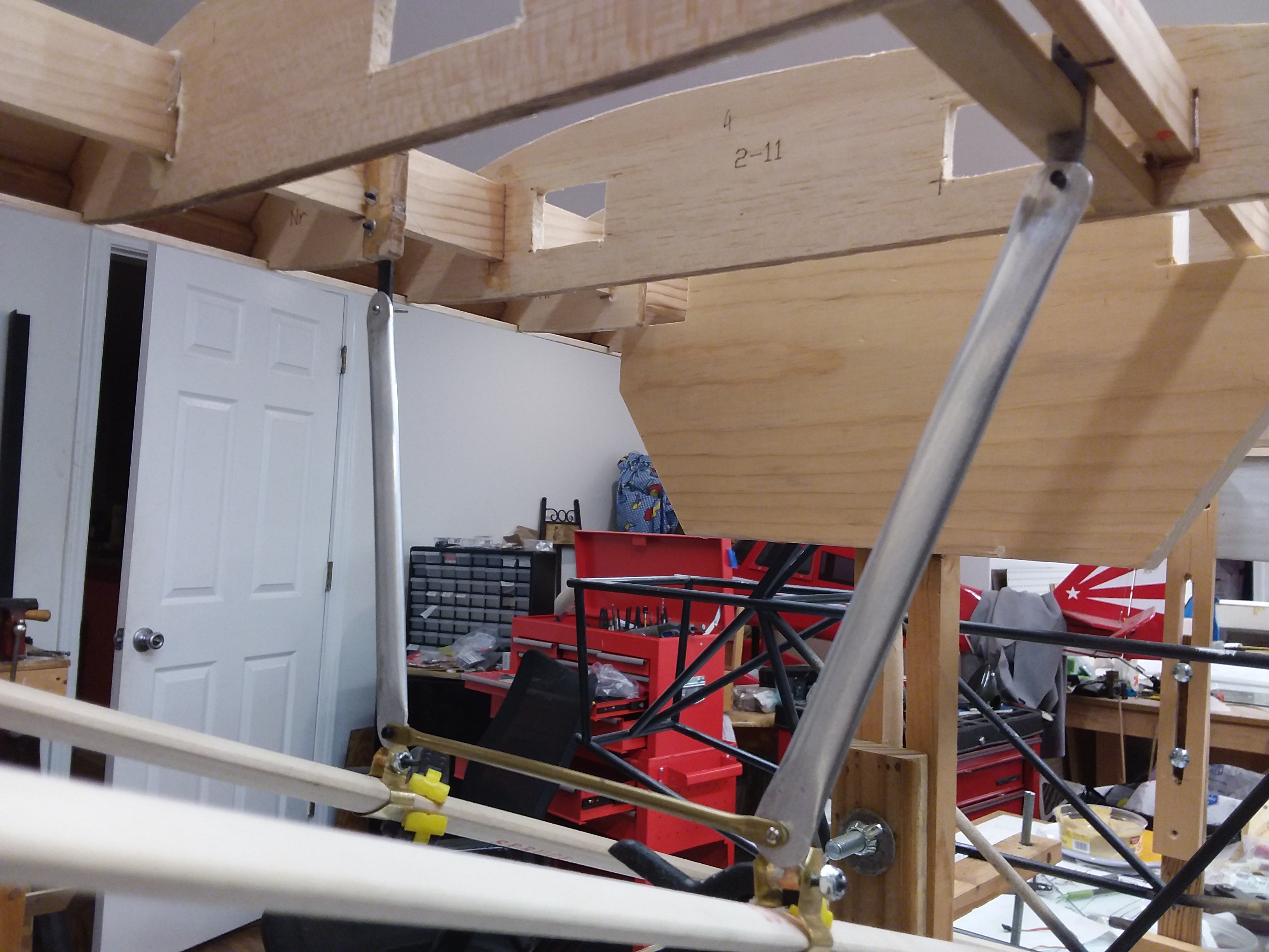

Primary planes charged and ready for a 75 degree day tomorrow so back to the Cub. Working on the wing struts tonight.

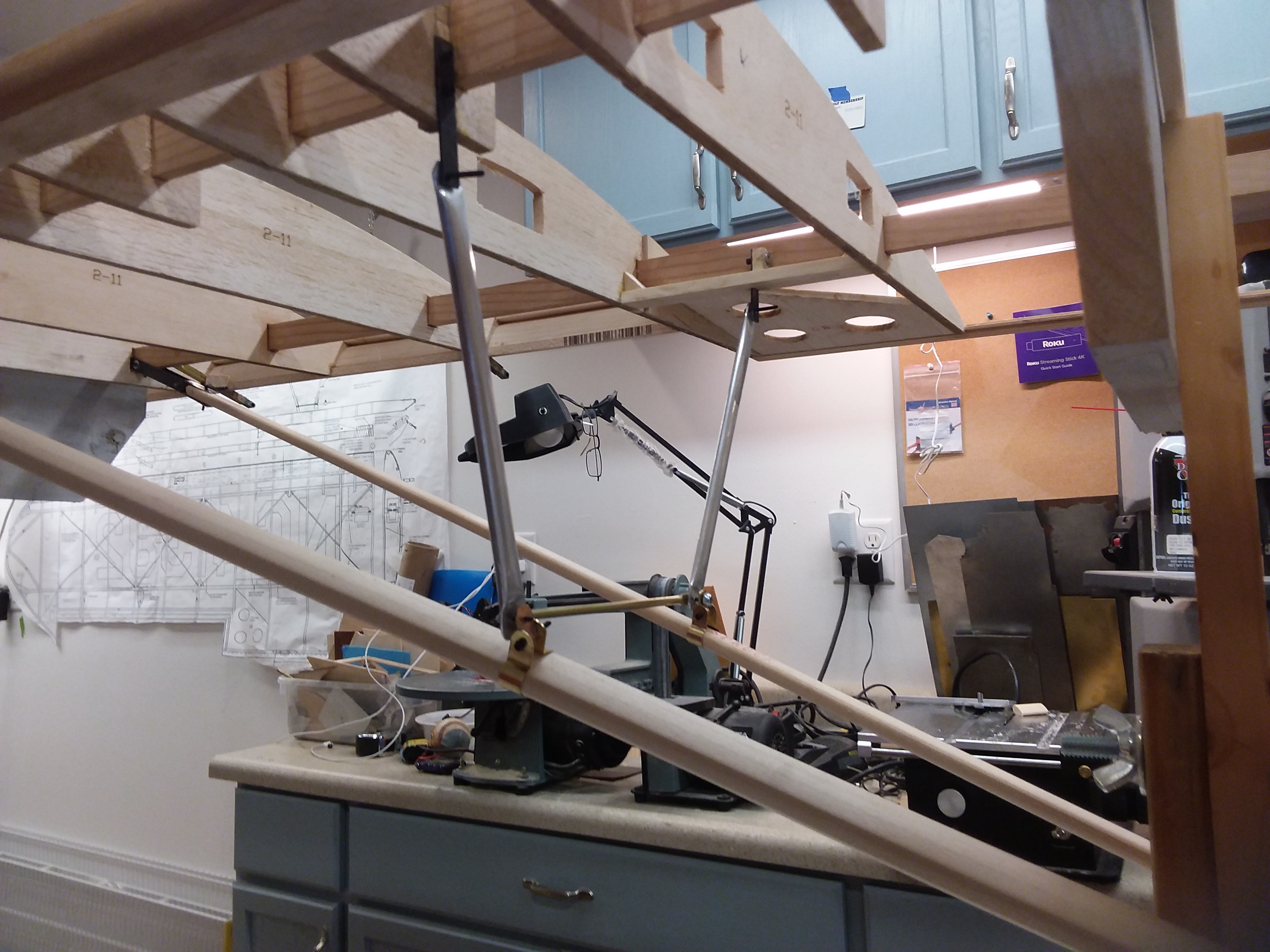

The brass tube assemble is an adjustable dummy piece so I get the real spars cut to length properly.

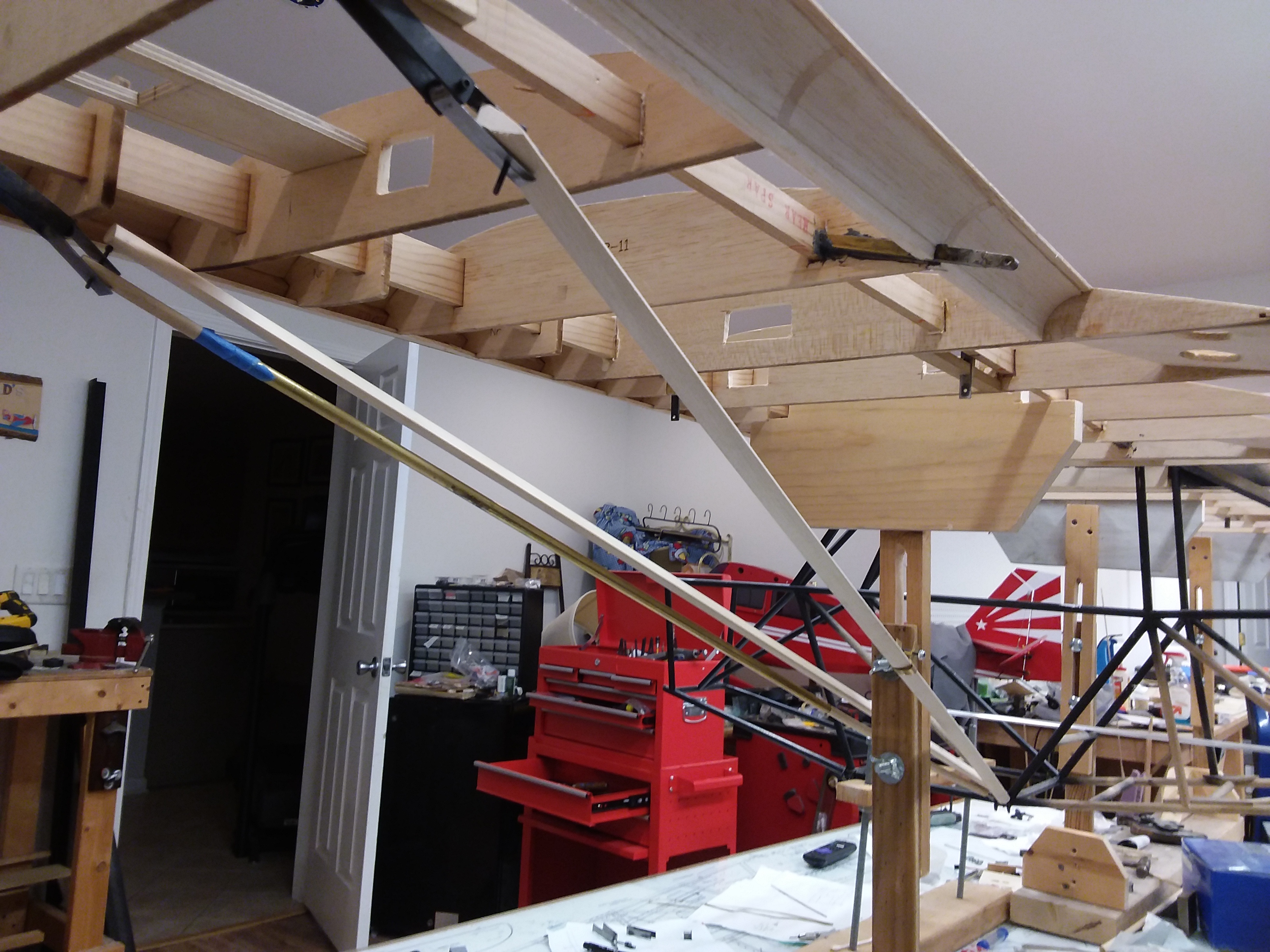

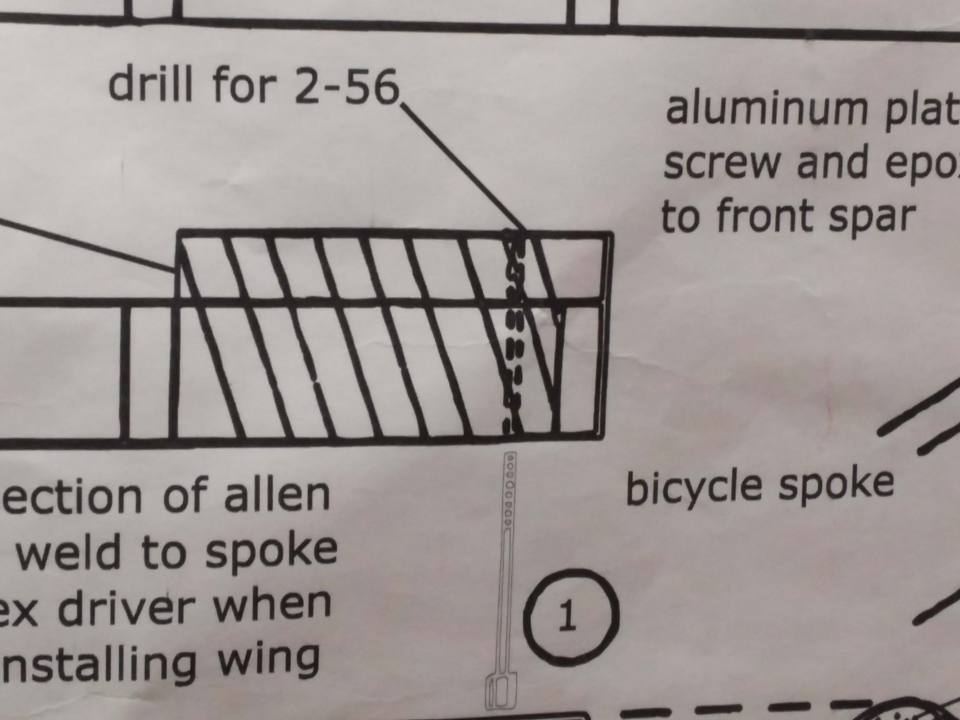

Not happy with the old school spar connecting idea I decided to modify it. First the original idea.
