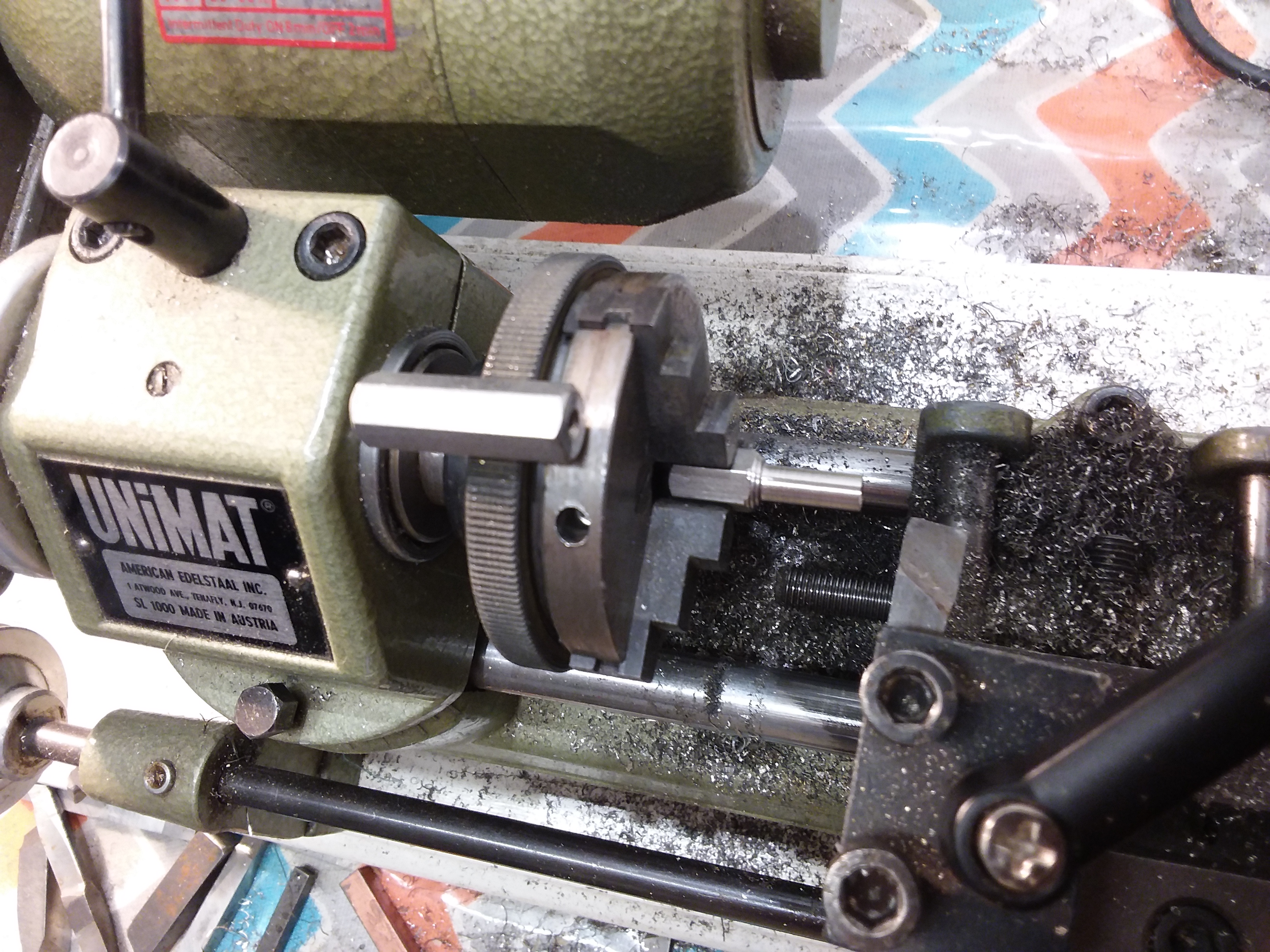

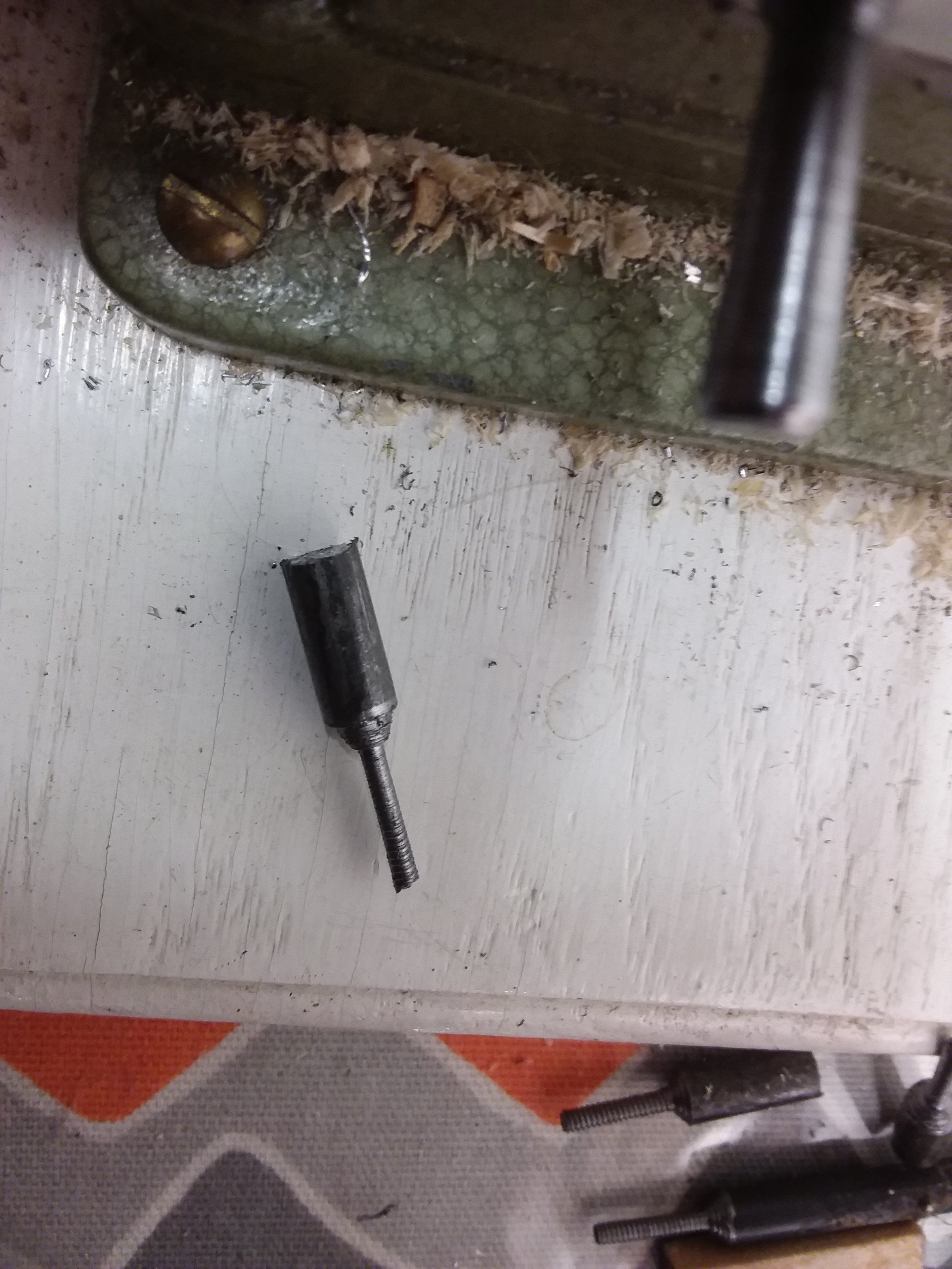

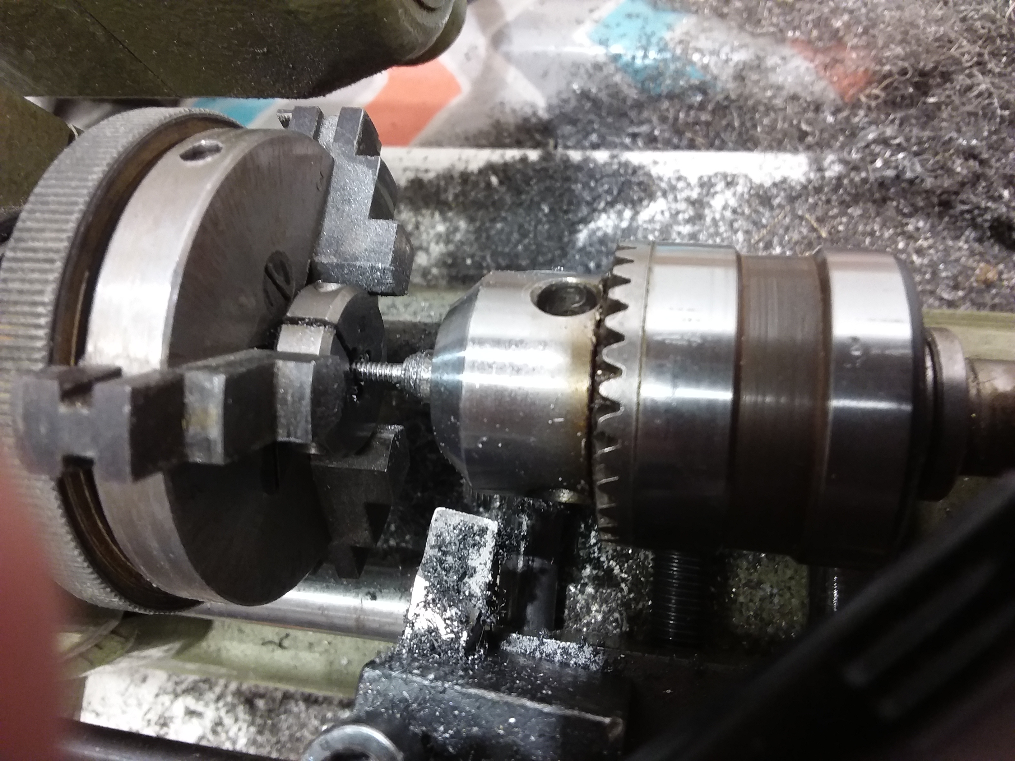

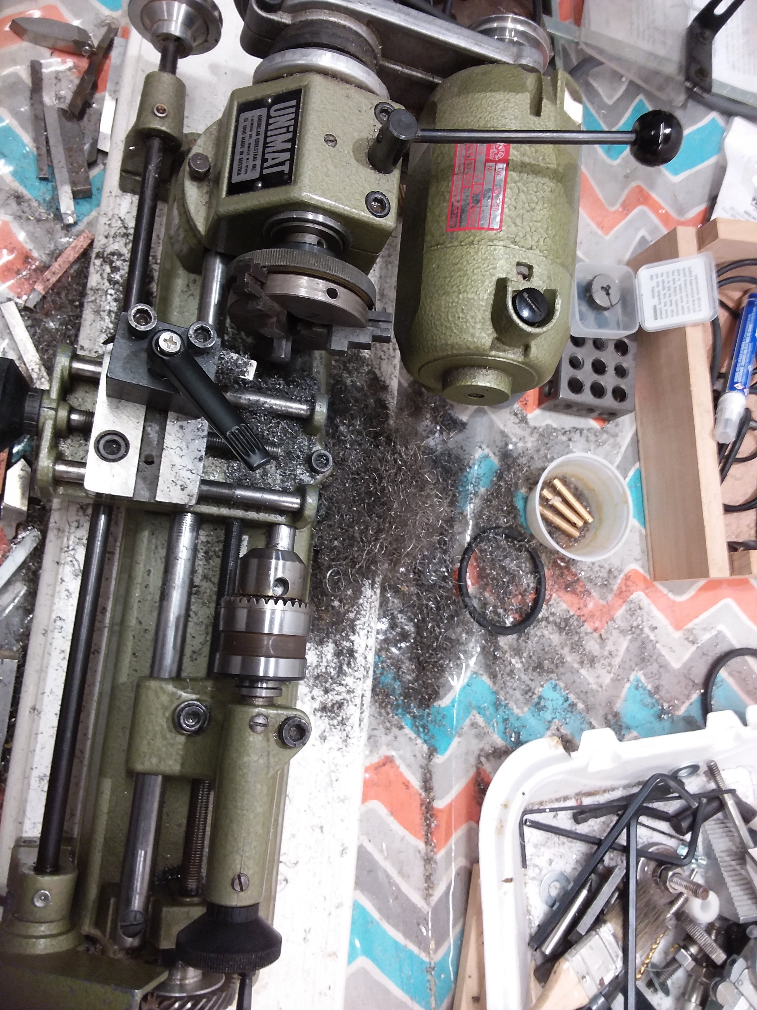

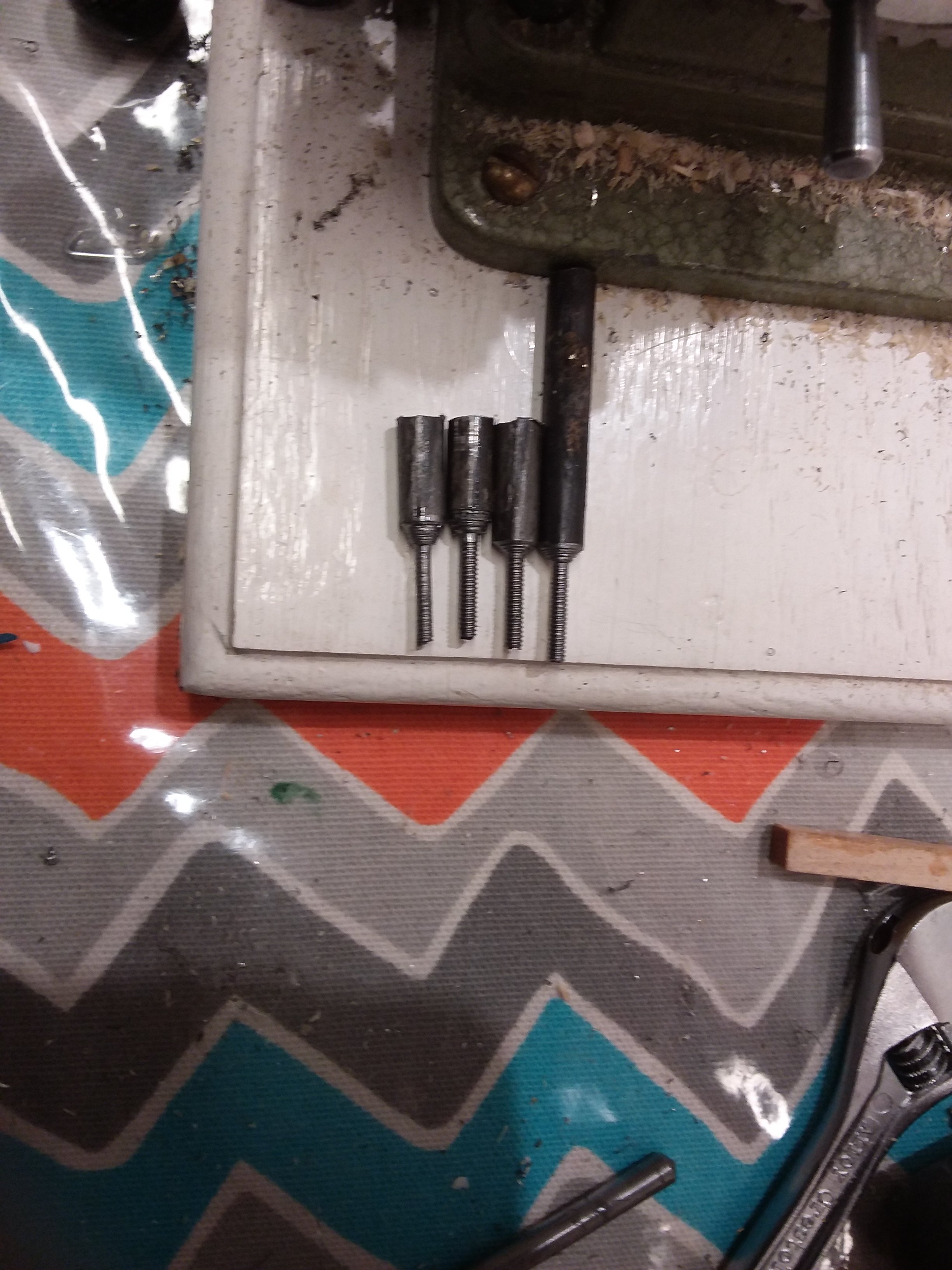

Don't know. I've had this Kevlar thread for years, don't remember why I bought it. I smeared the JB Weld on the wood and brass tube, wrapped the thread into the JB Weld then rubbed the JB Weld around the threads. Rock solid.
Transition complete. Pin could be shorter but no rush.
