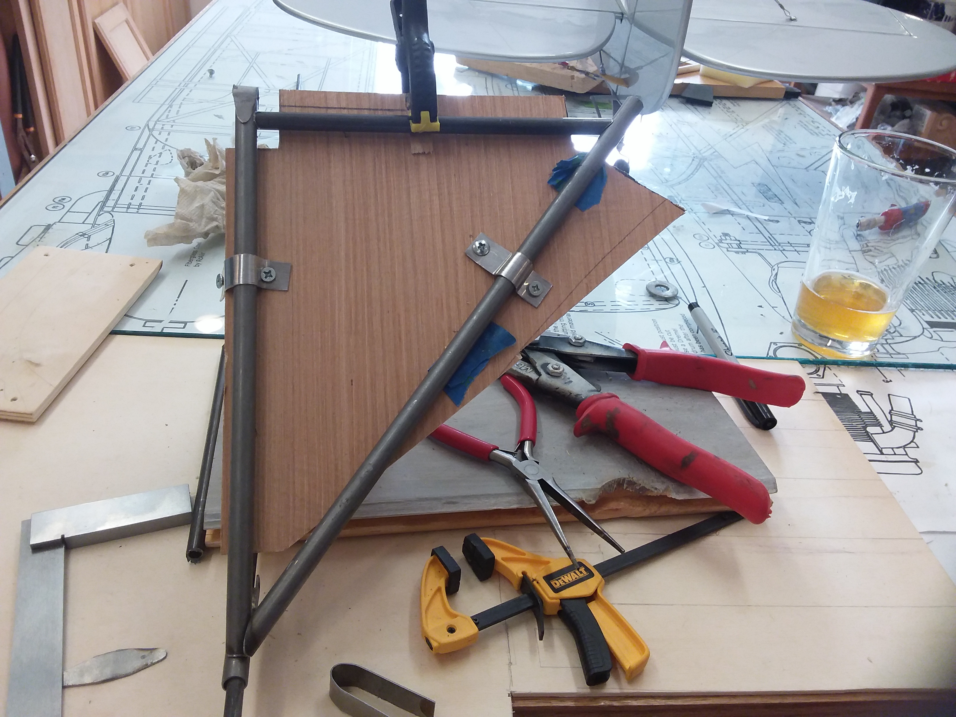

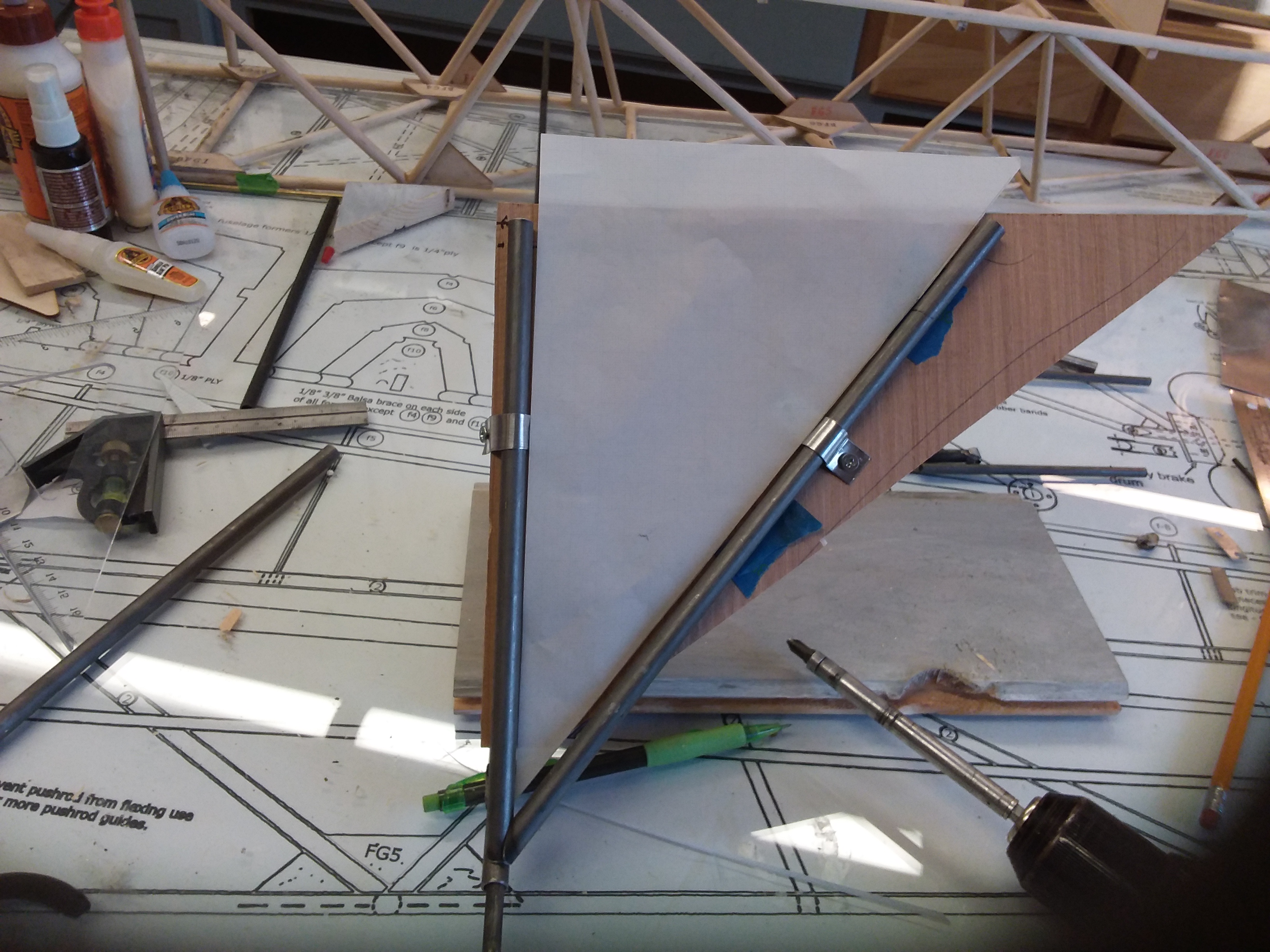

Working on landing gear today.

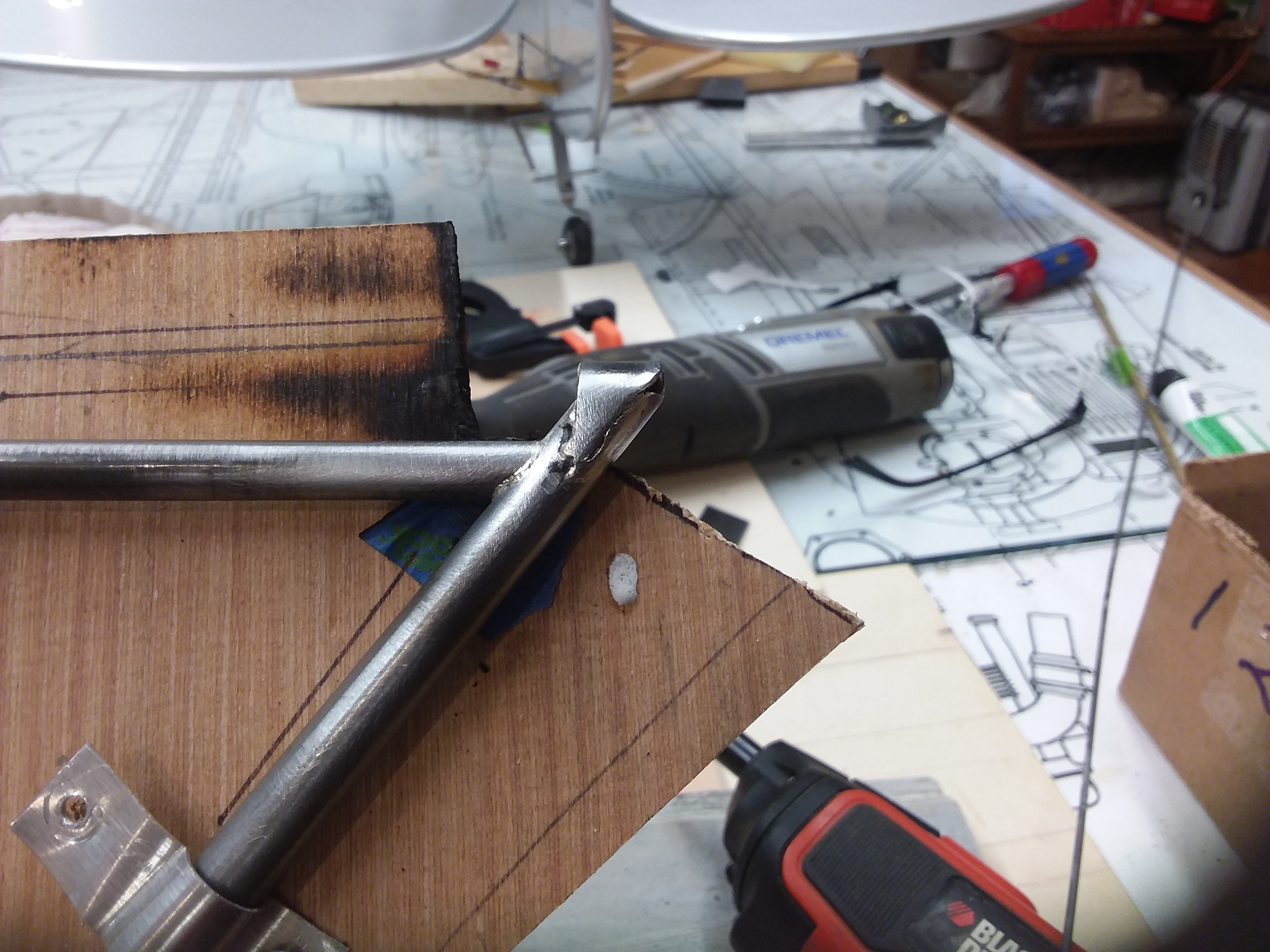

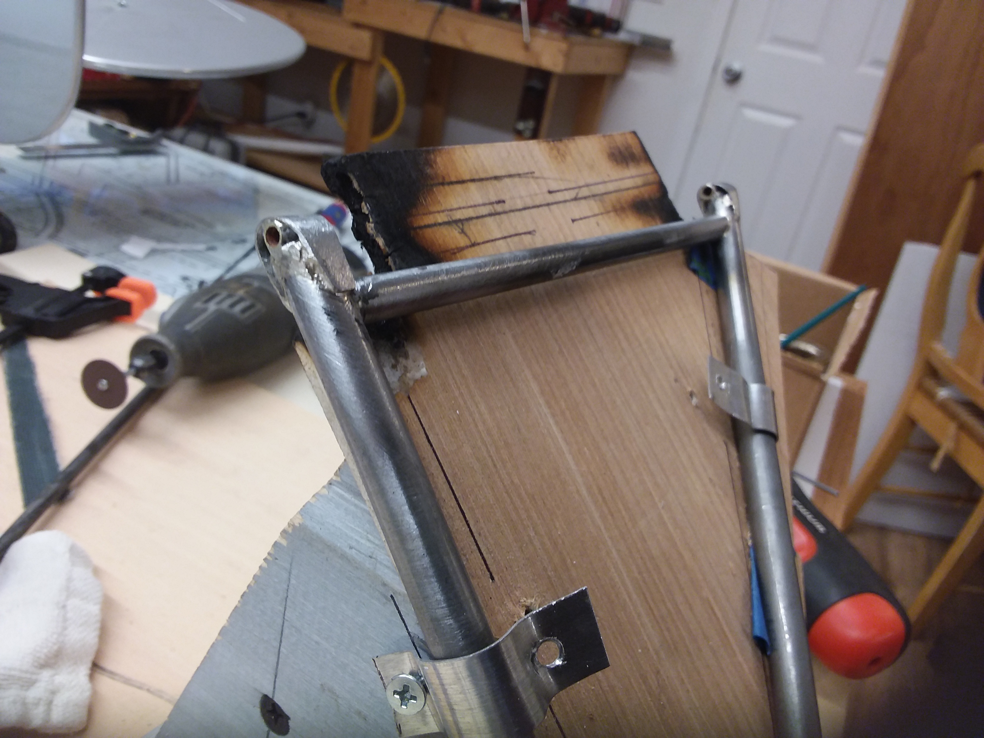

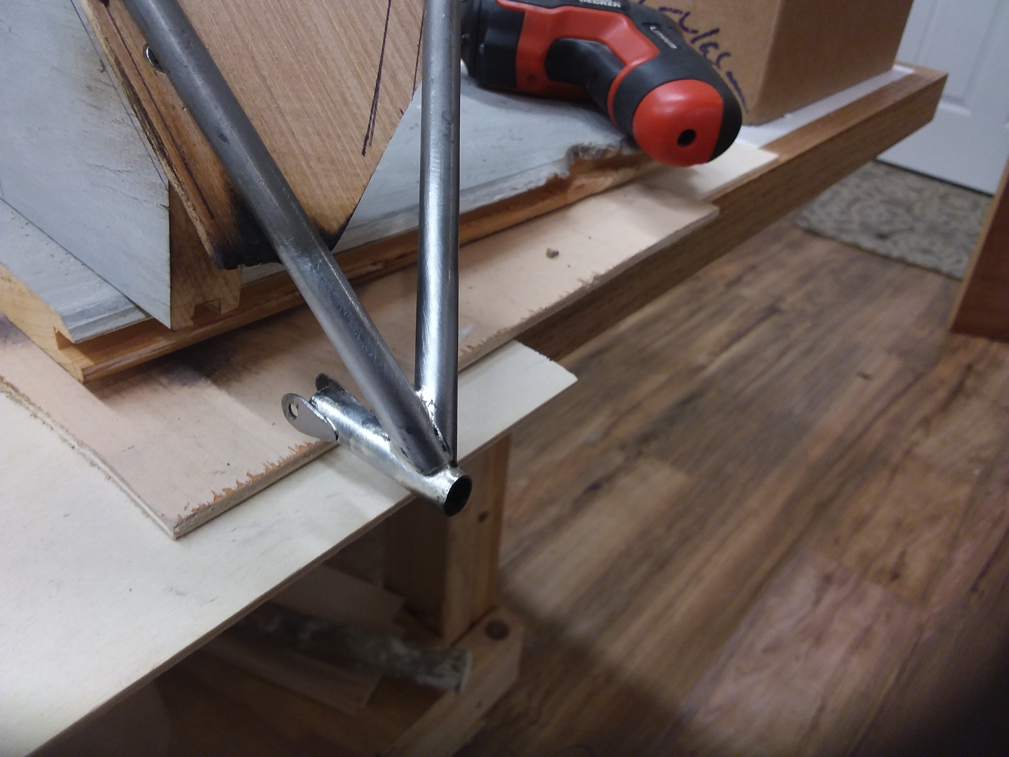

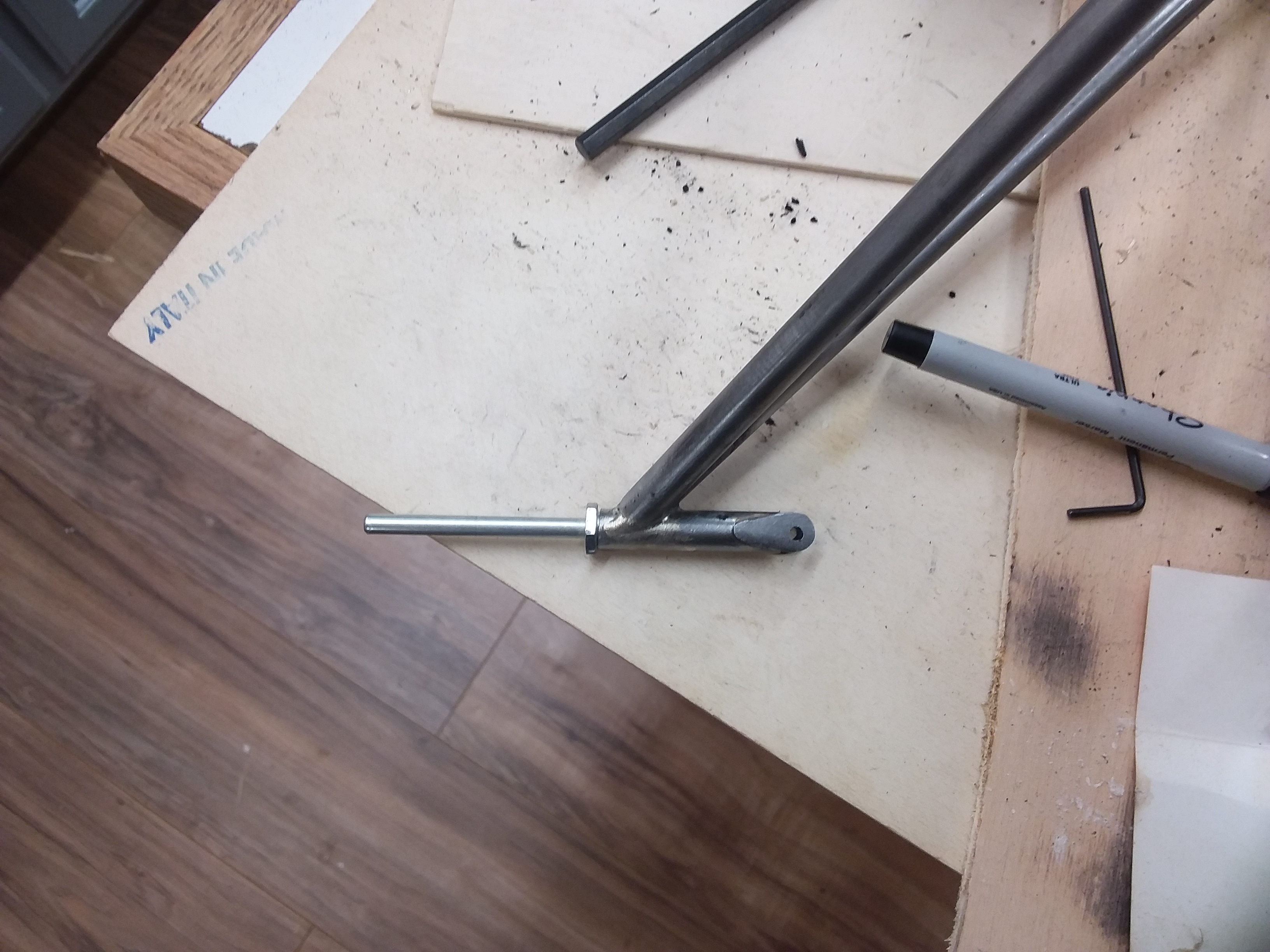

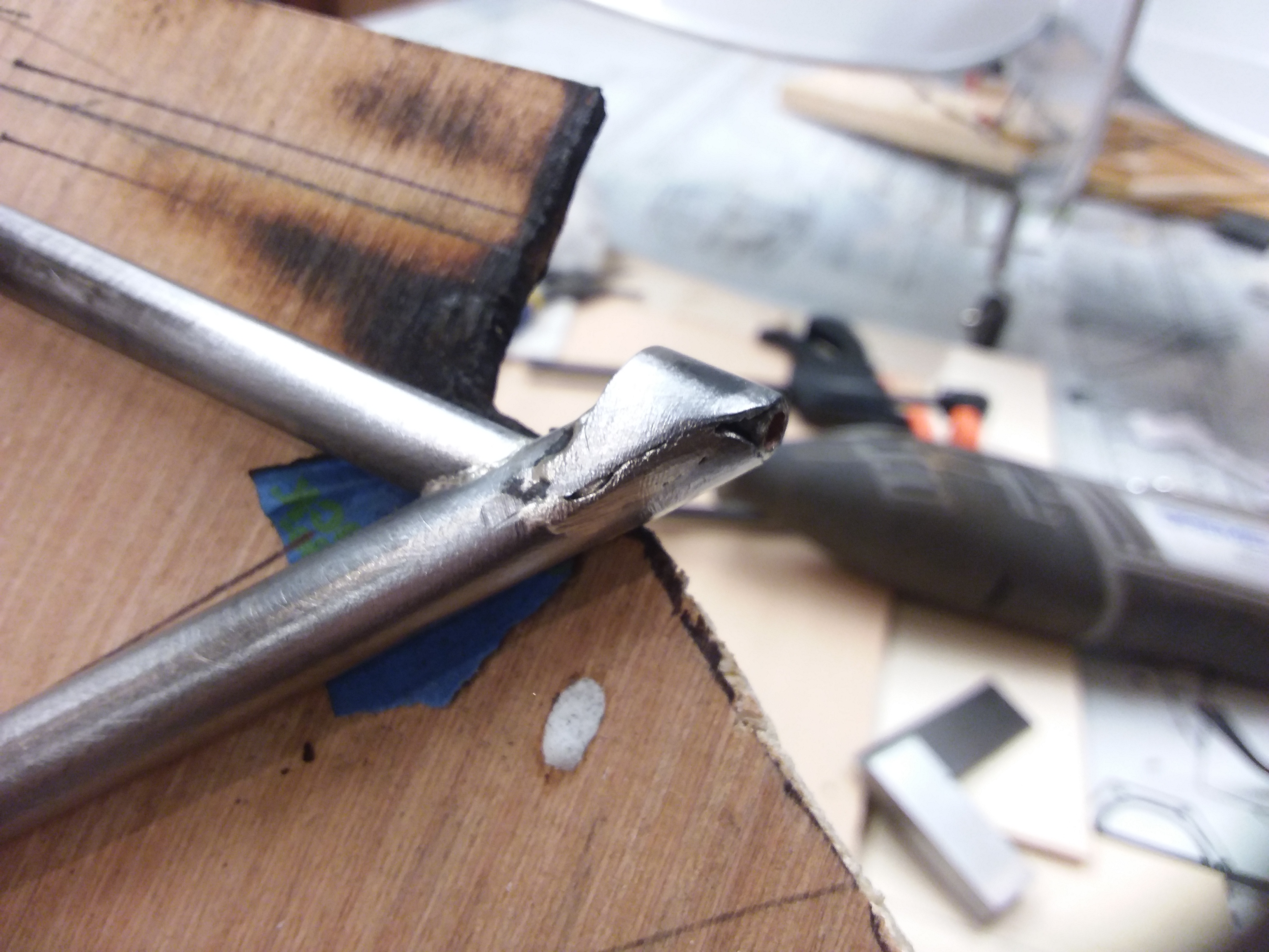

Continuing work on the landing gear piece. Polished the blackened flux away to expose a few holes in the solder. Much easier to fill in than the actual soldering, different thickness metals are not easy to solder.

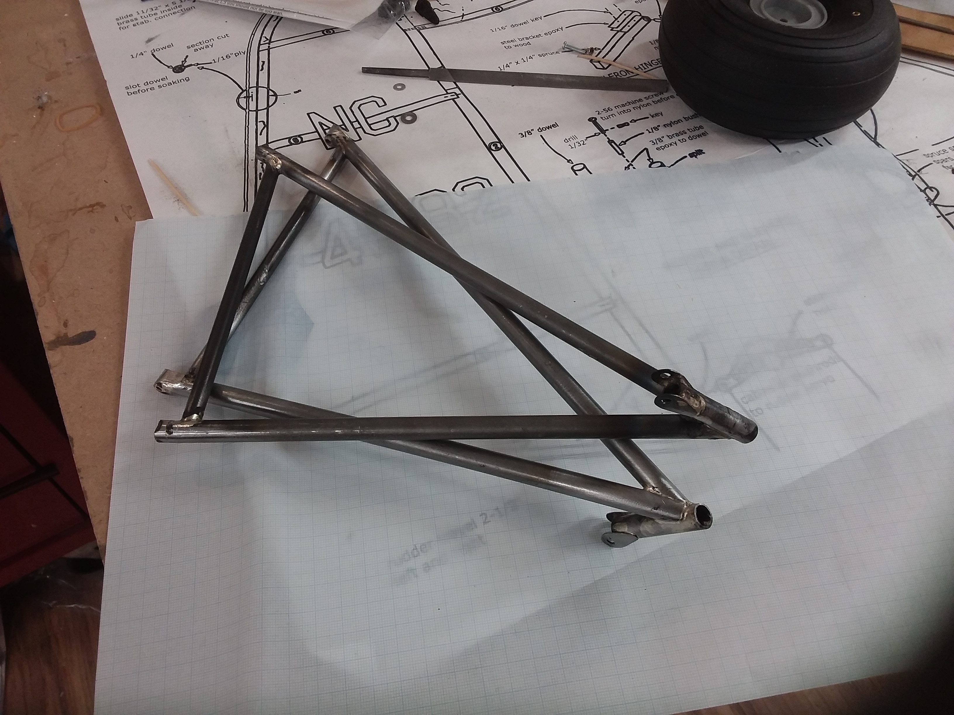

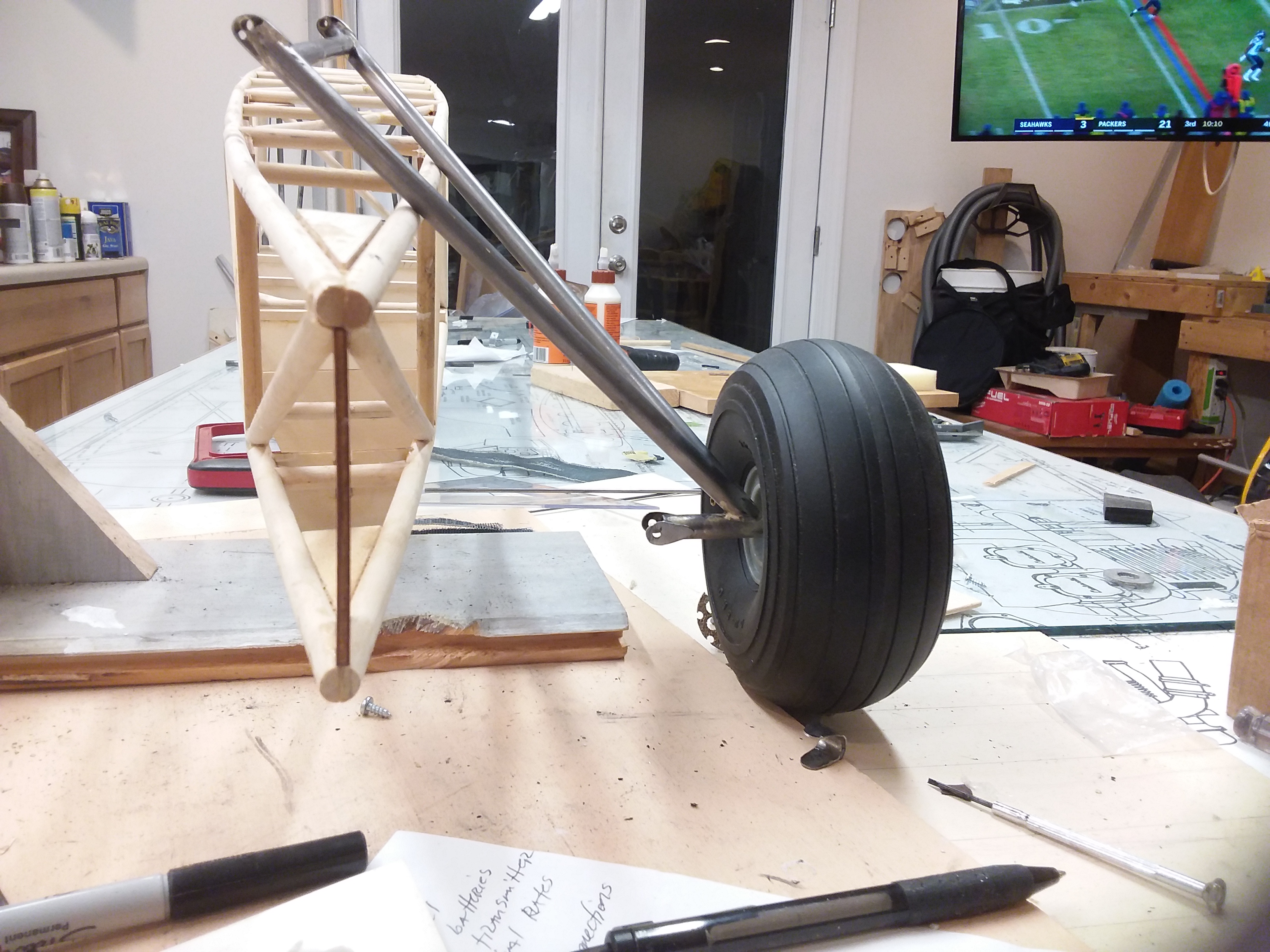

Looking at axle options. Tried a Dubro 3/16 axle. It threaded into my 3/8" tubing so tight I had to use a vise. I was worried it would split the tubing. Anyway, close enough for the moment.
