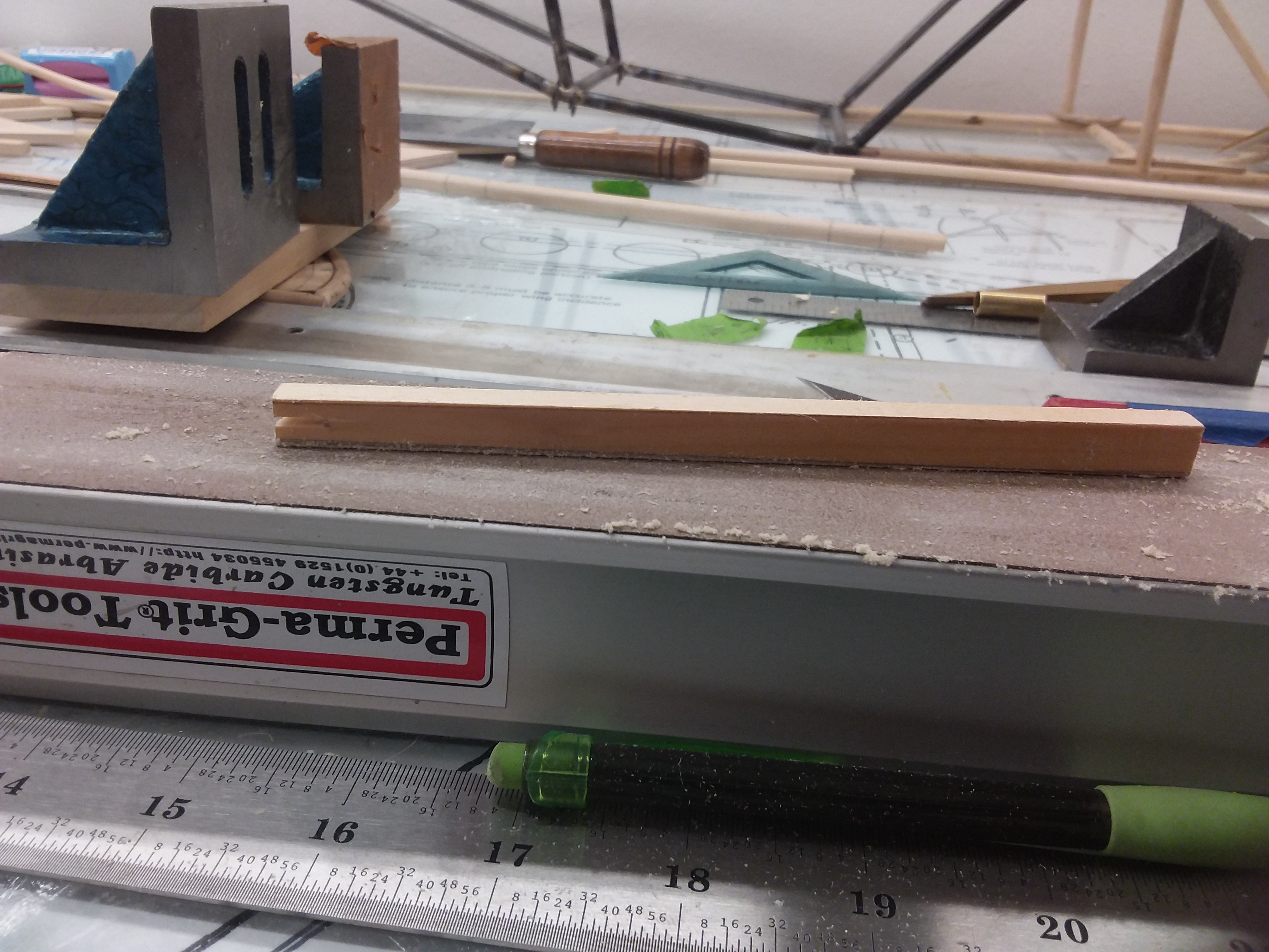

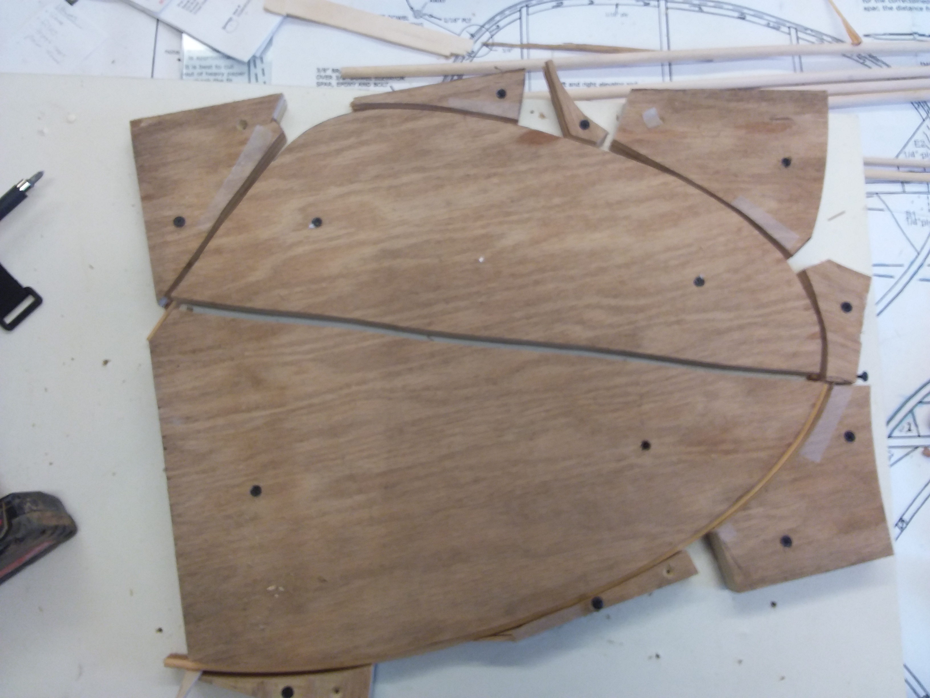

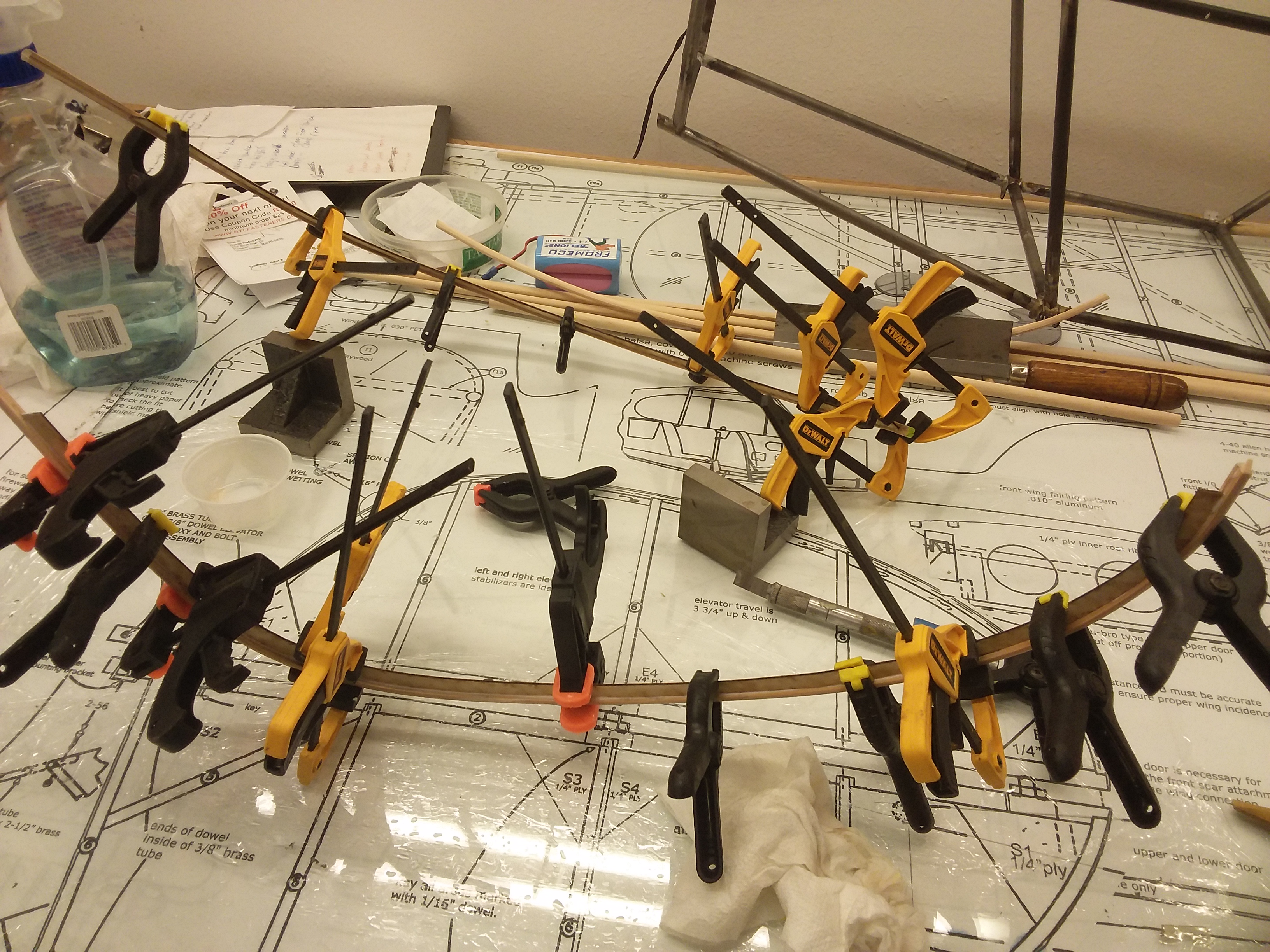

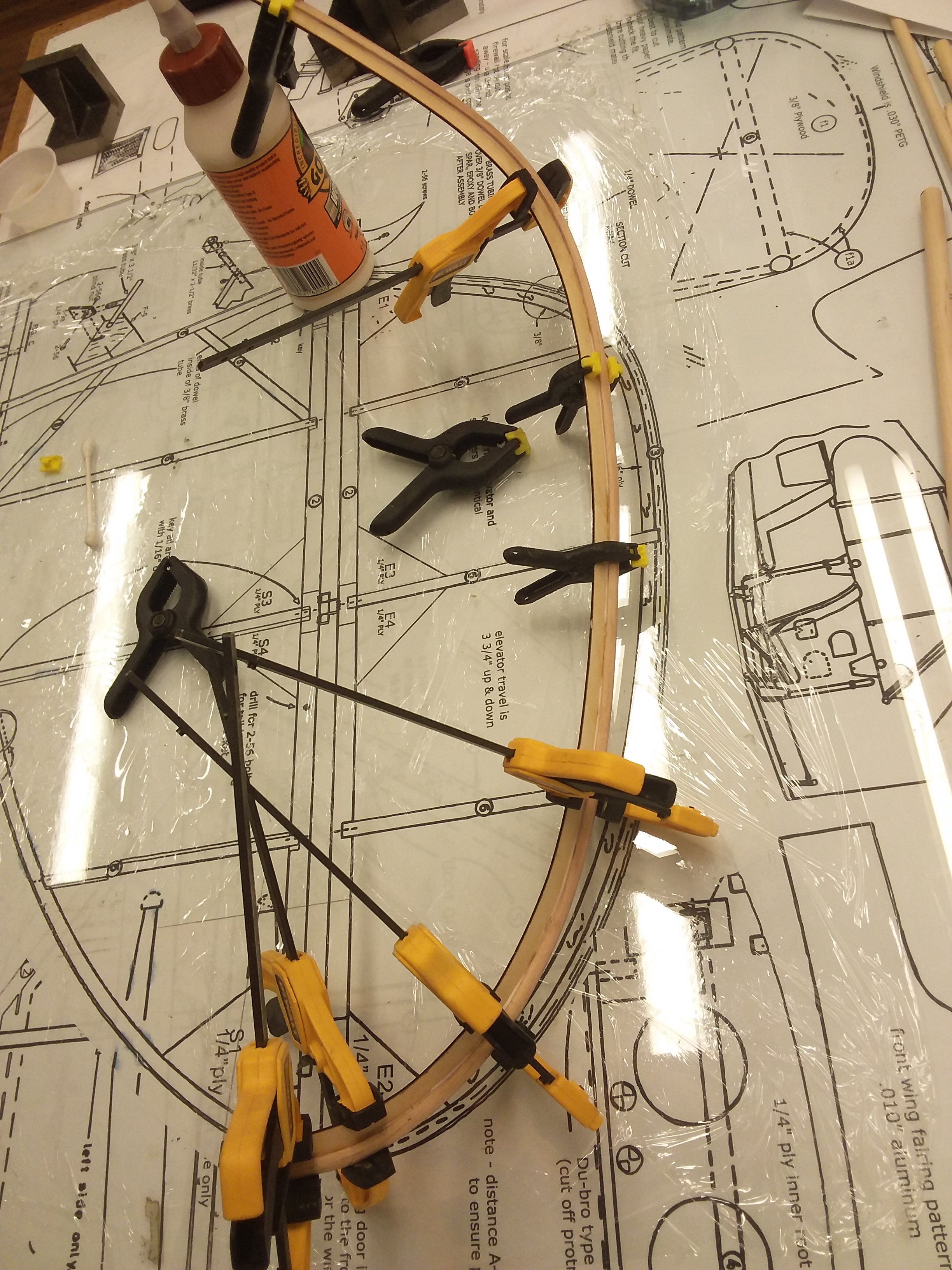

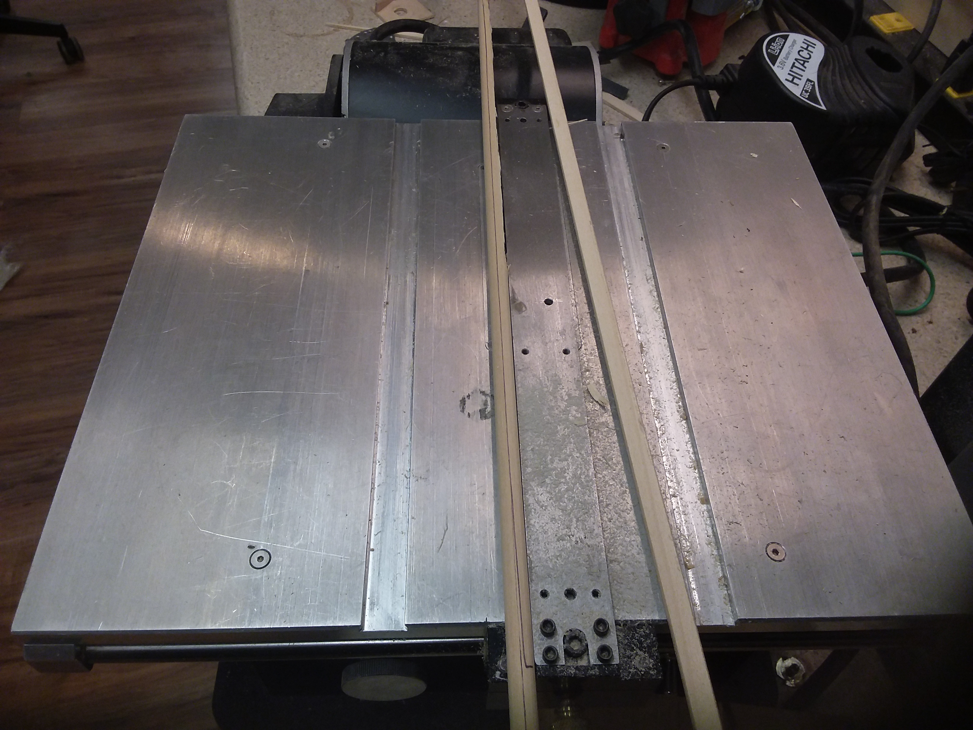

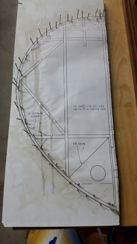

Lots of nice progress since I tuned in. I edge glued 2 dowels stacked on the edge of a 36" long board and skimmed the flat off on a table saw. I don't know where the tail feather pattern is but I attached the one for the wingtips. Enjoy your build. I'm thinking everyone has some spare time on their hands.
