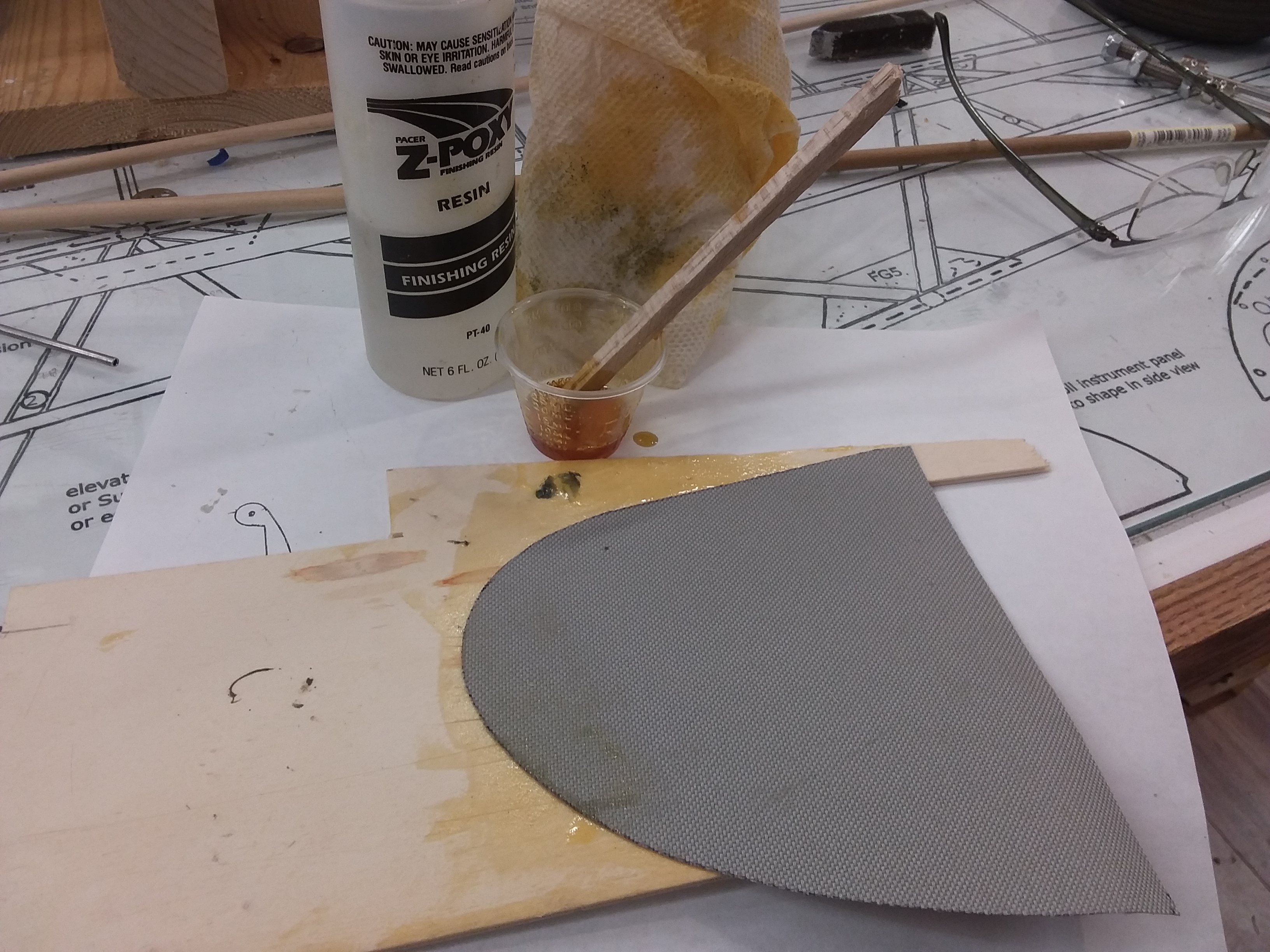

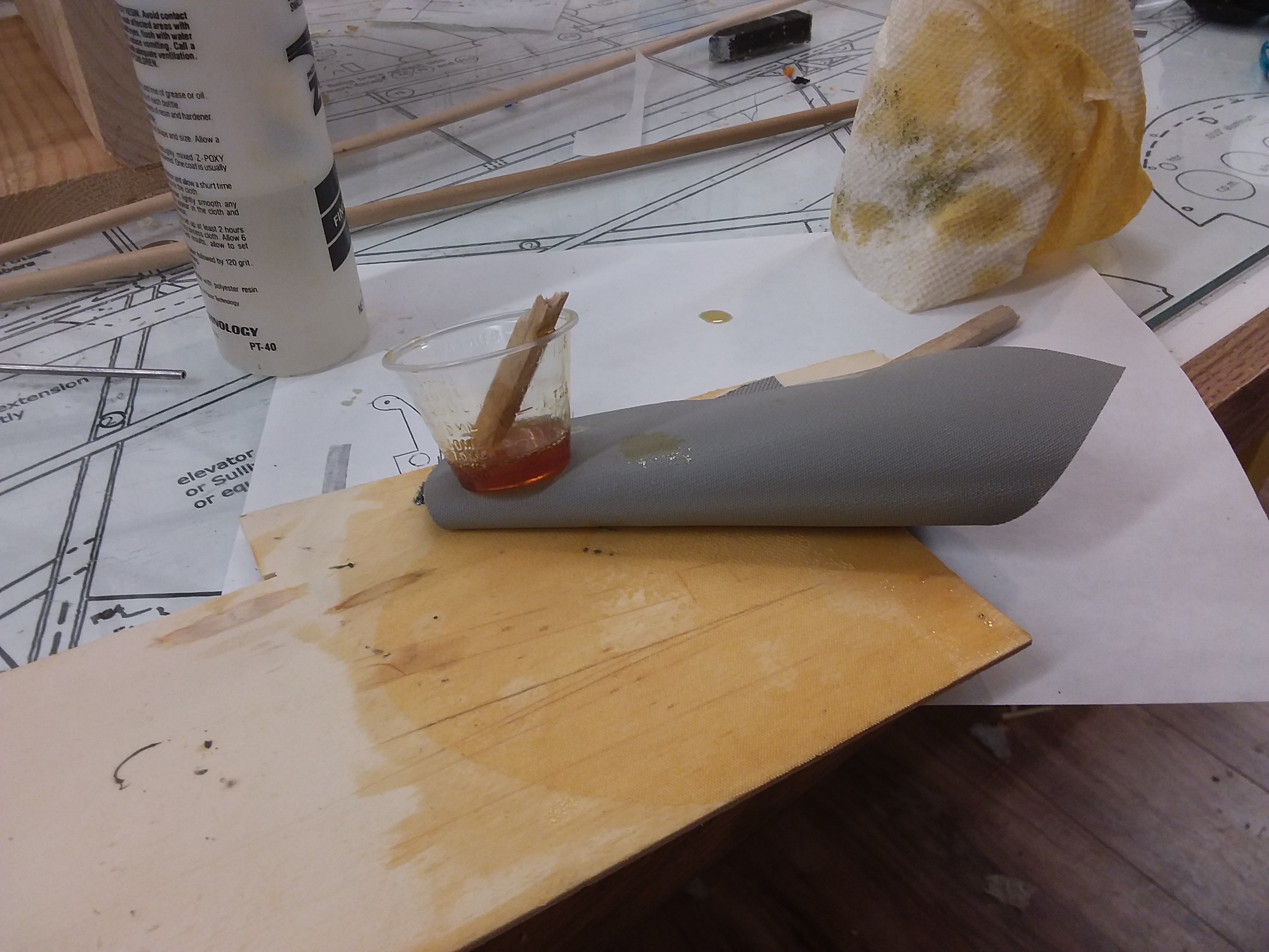

Trying finishing epoxy to stick the interior lining to balsa.
The backside of this canvas is a problem as I have another fail. The canvas peeled off like Peel ply or something. I might consider getting a different fabric.1631230783147884251377.jpg

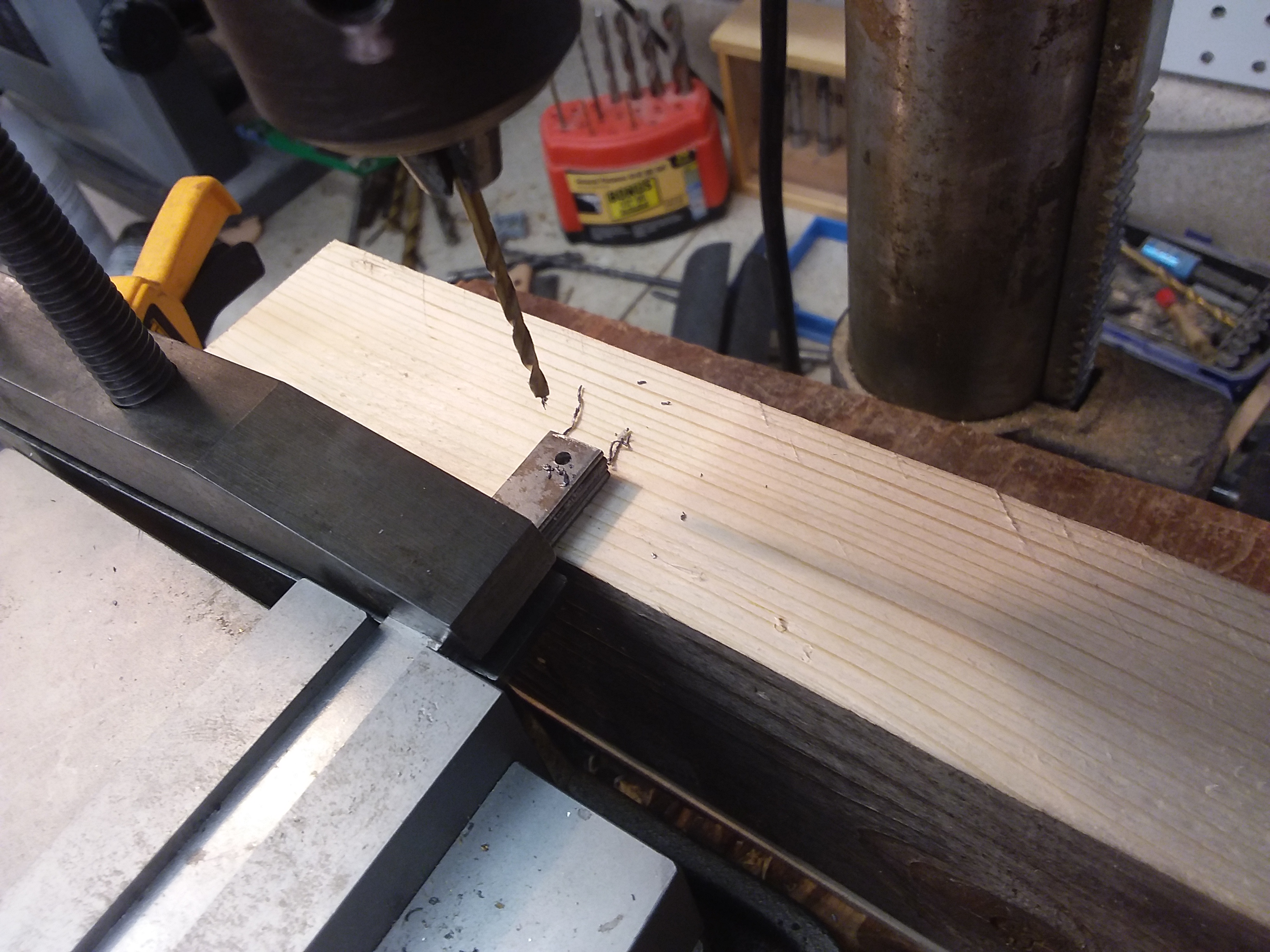

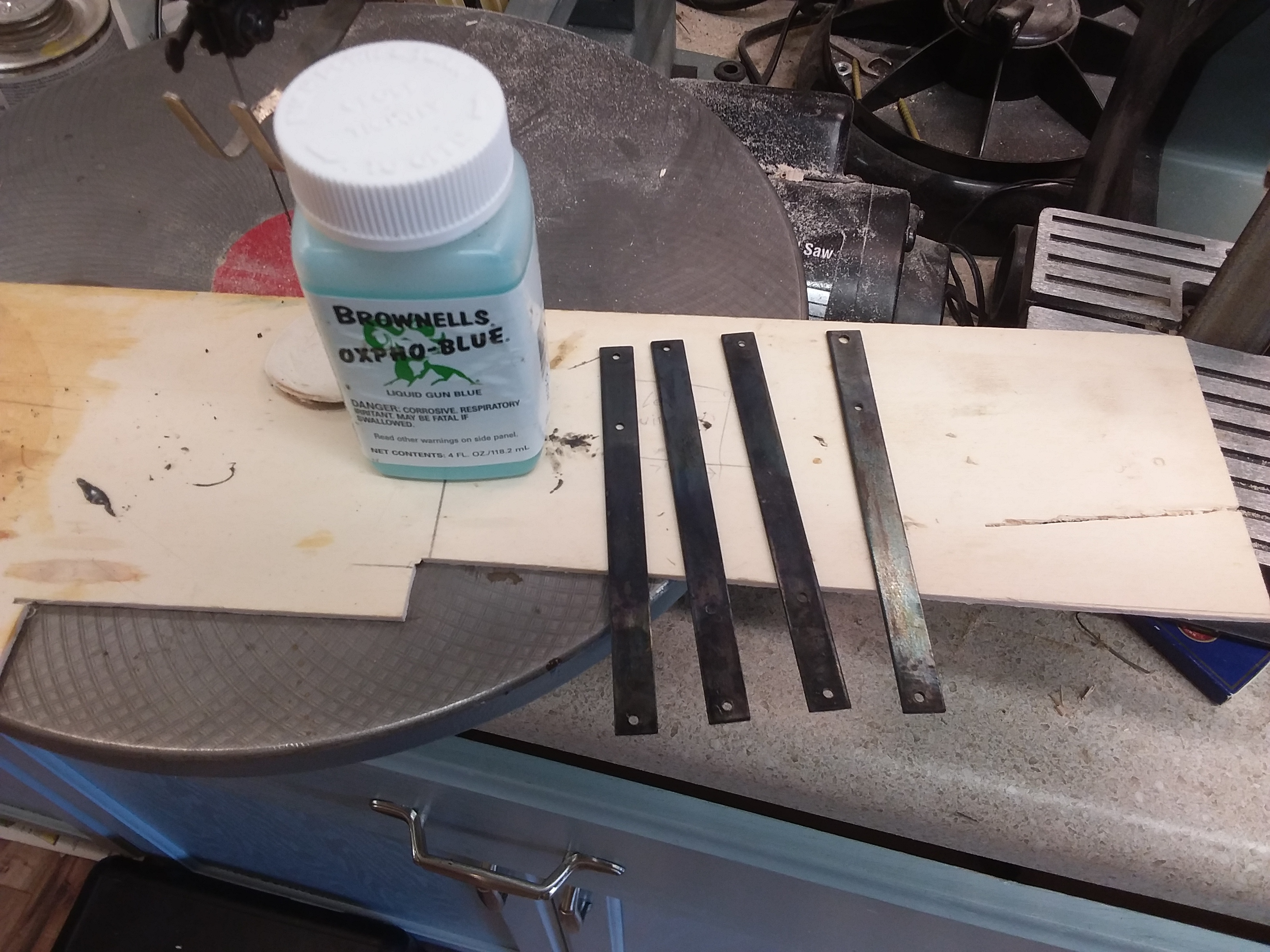

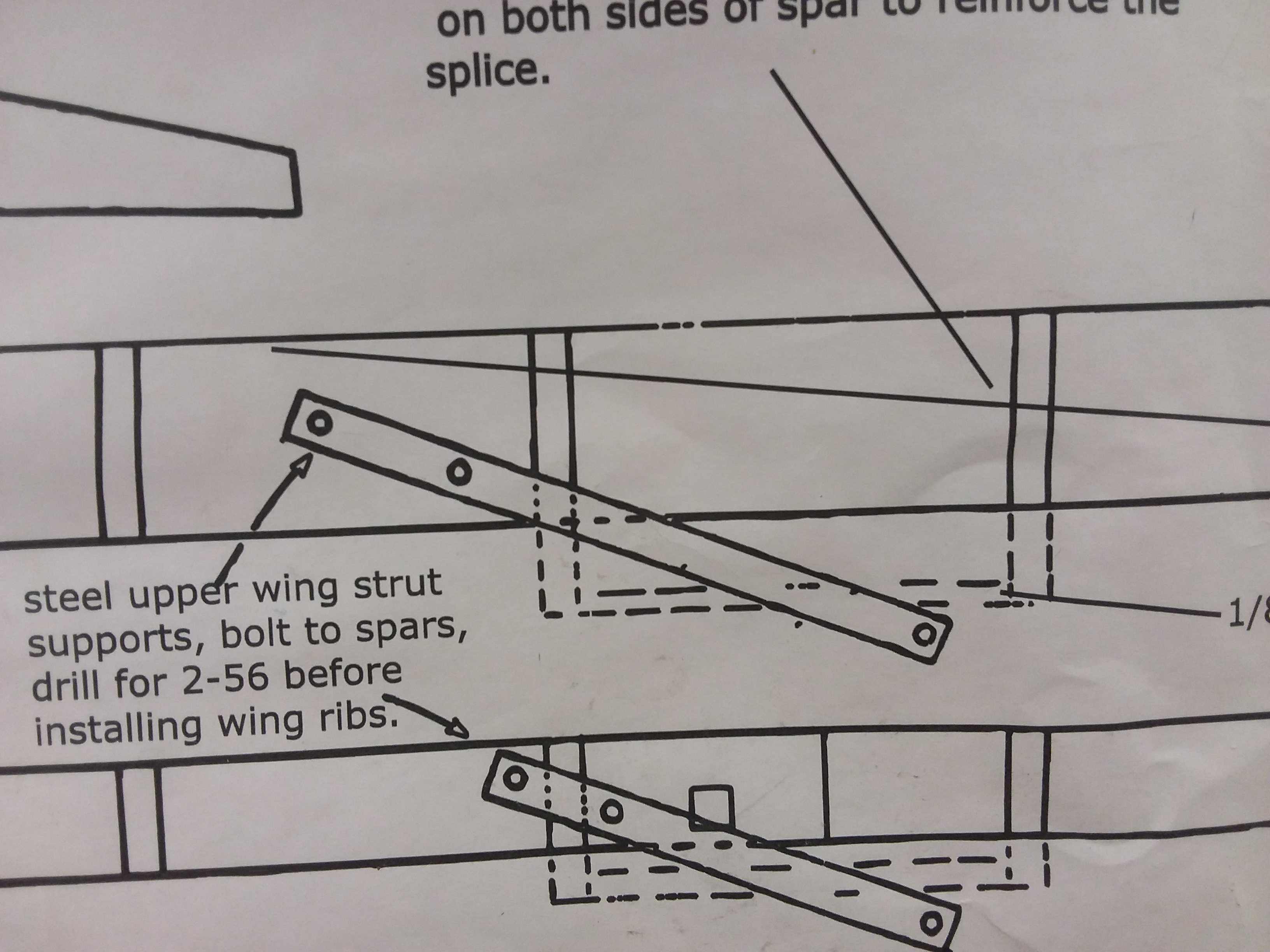

Back on the Cub. Working on wing strut clamps. Cut, sand, drill and I decided to blue them. I can always paint them later.
