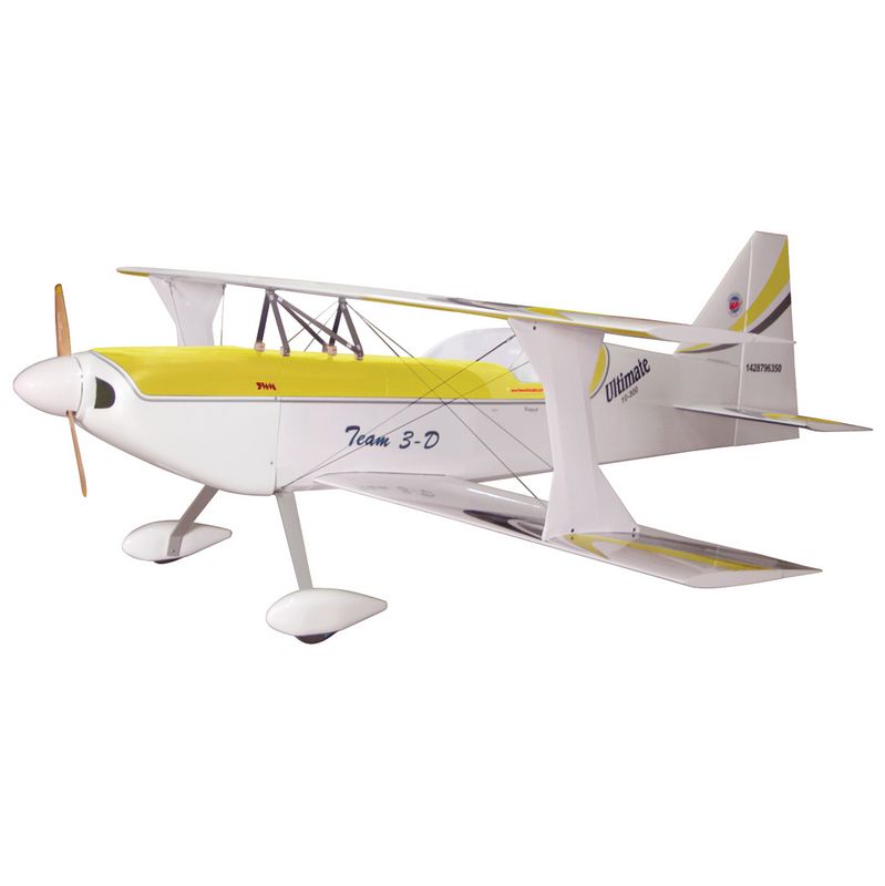

PAU Ultimate assembly
Not saying anything more until it is in hand.
As for comparing the Ultimate and Pitts, depends on which version. This PAU Ultimate has a thinner airfoil and smoother lines than a standard Pitts so it flies a little faster. The control surface's are also bigger than a standard Pitts so it is more aggressive at maneuvers. Now compared to the Challenger with it's larger control surfaces and thinner airfoil it is somewhat similar. Another difference and probably the most notable is the distance from the bottom wing to the top wing of the Ultimate. That larger separation give's the Ultimate a more stable envelope, less turbulence between the wings. I have viewed this difference before with onboard video where the canopy is centered. The Pitts canopy rattles like crazy whereas the Ultimate does not. Then add in that the Ultimate has a longer fuse which makes for better line's.
So, I would have to say that all in all the Ultimate in general is the better flier, it is cleaner, smoother, and more aggressive. But the Pitts is by far the better looking one.

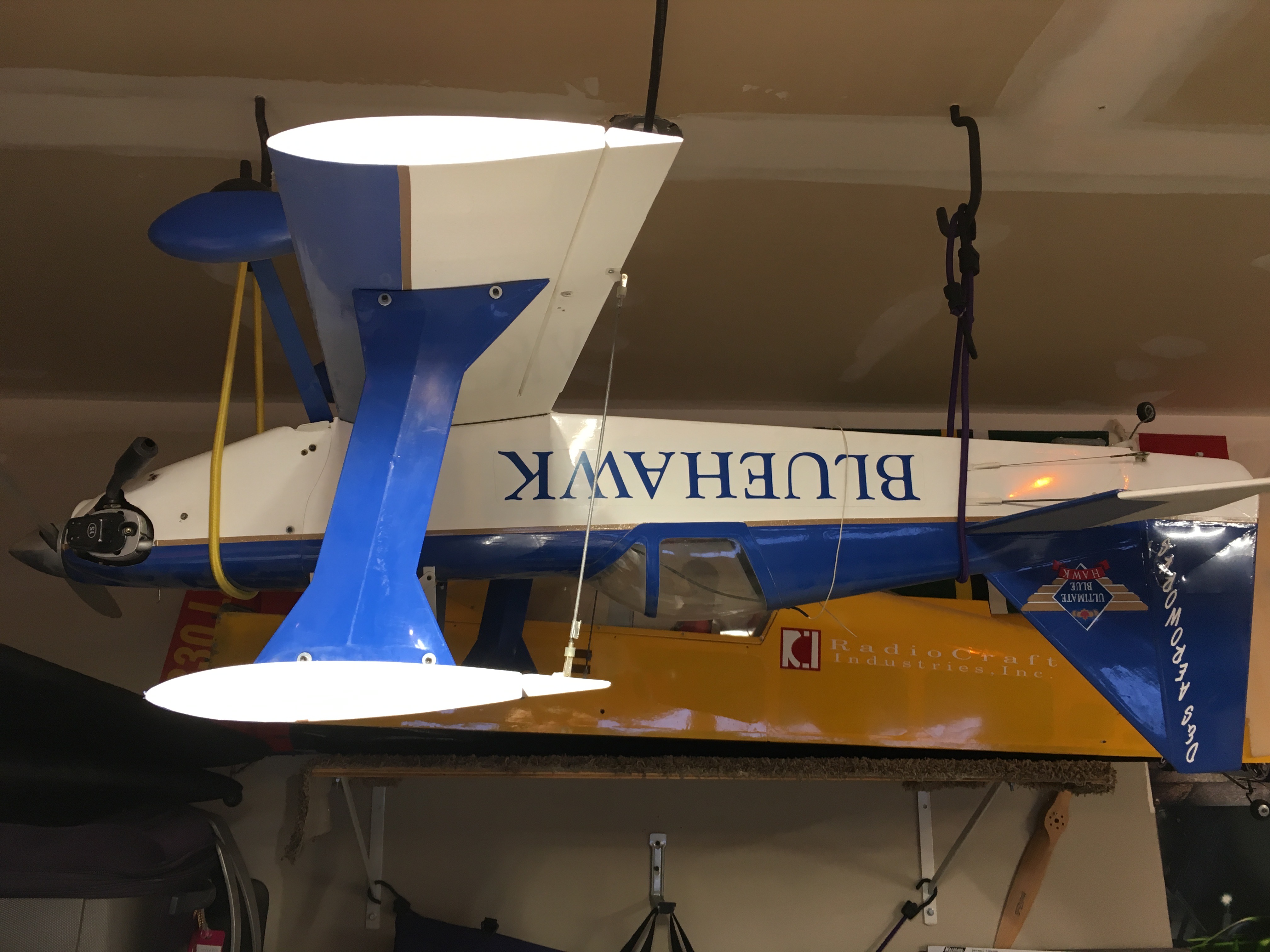

Here's a biplane my father flew with a YS 140 in the cowl . Its a D&S Aeroworks ultimate and hasn'y flew seen 2008 .
It flew very well and have no desire to fly it, I'm keeping it in memory of my father flying years we had with each other.
Still has the old servos airtronics an a Jr ch 52 receiver wish is obsolute along with the Jr 10 transmitter .

Nice looking plane should take the engine off and oil it up and fill the pump with YS oil . I am still flying a 10x in the winter.

We always used after run oil , air tool oil worked great . I believe its oiled up ,if i need parts i will get from Richard Verano who the YS rep and i who him from my racing days .
