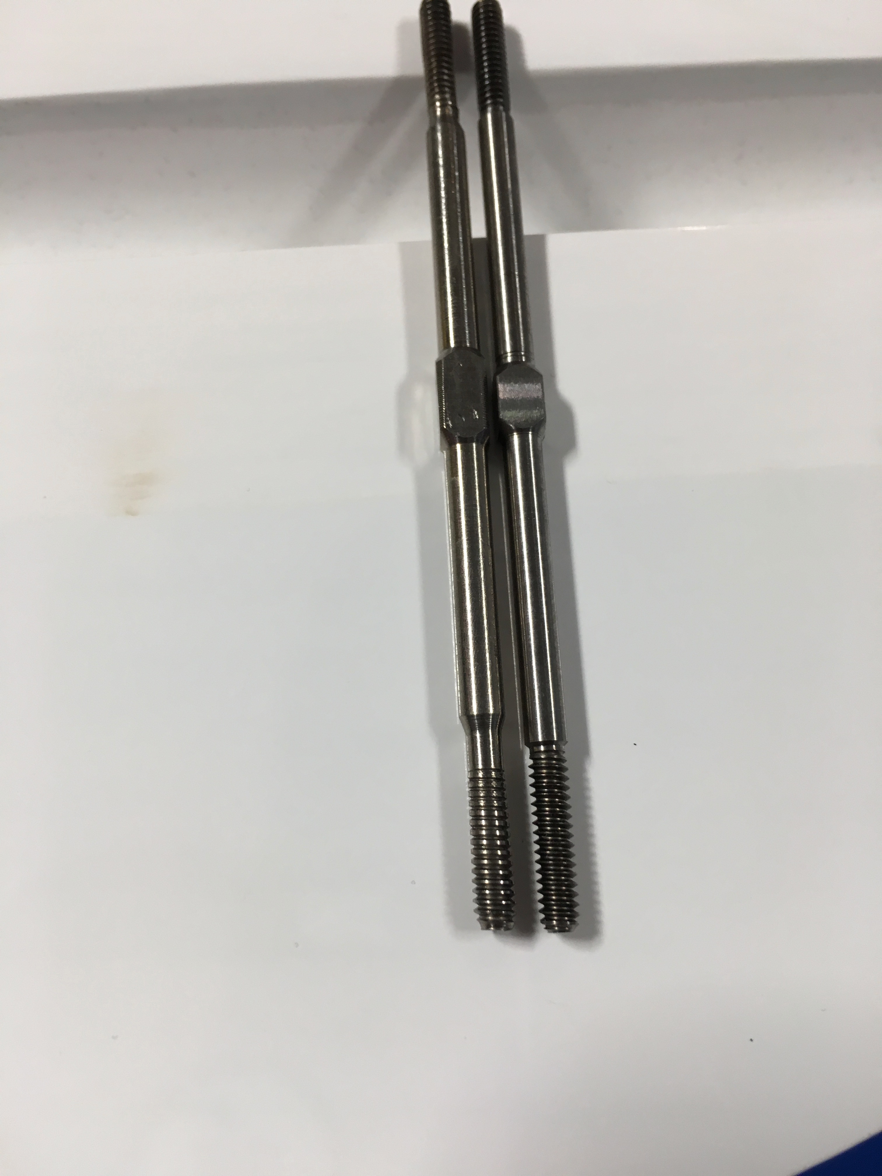

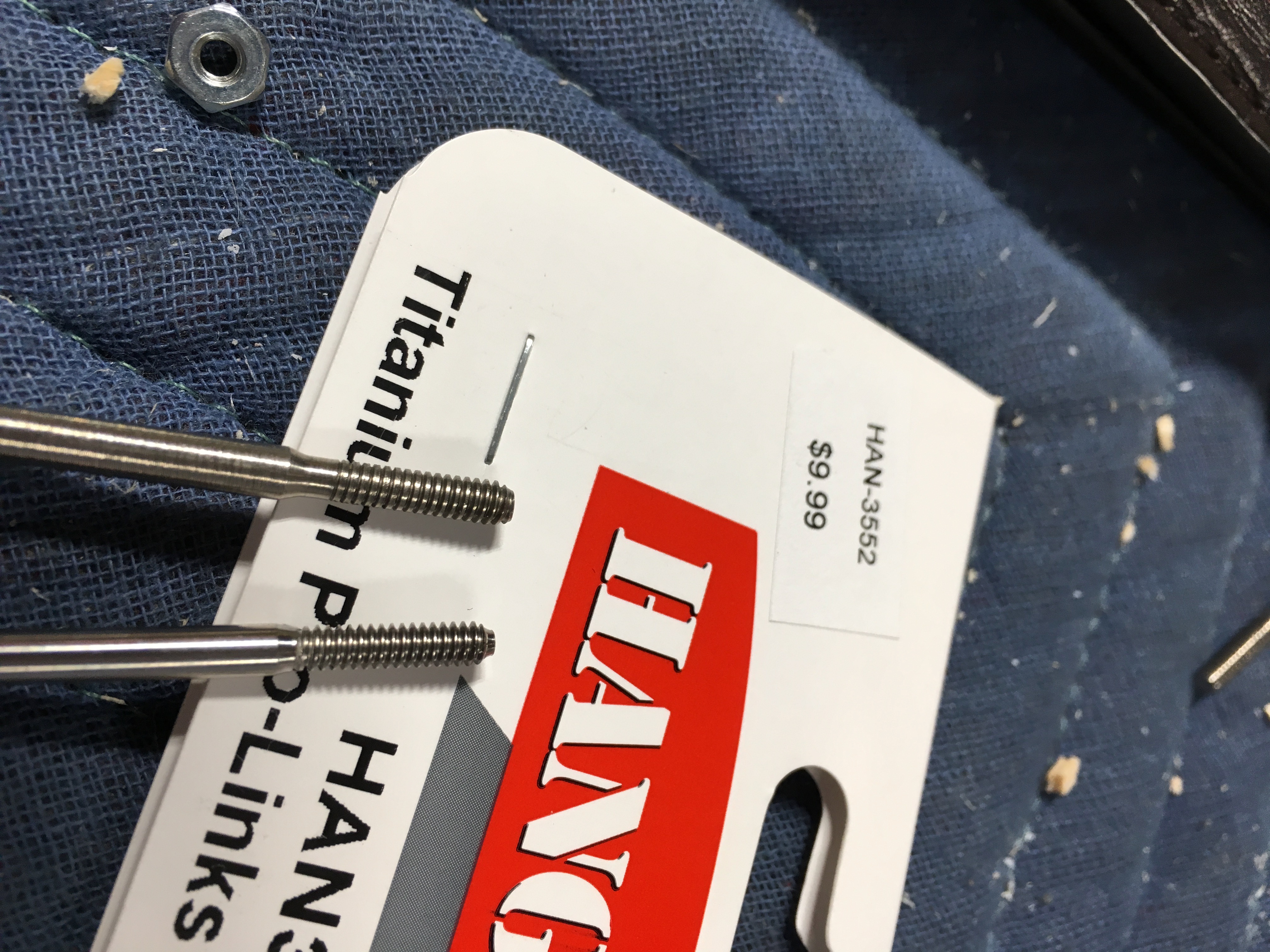

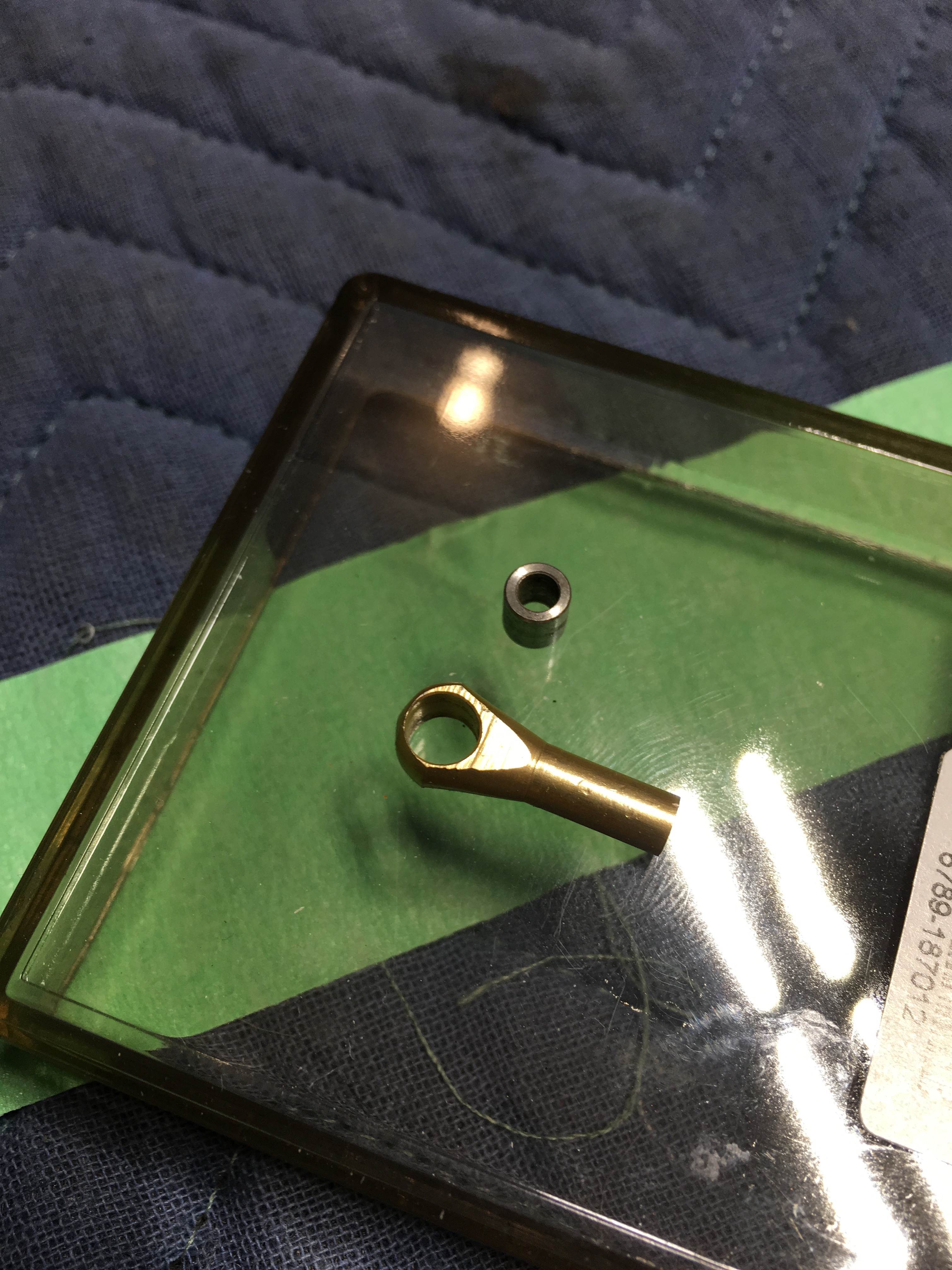

Ace I did get one of the first Extra from the new version in 2016 .As you can see in the photos the thread weren't cut all the way down . I replace all turnbarrels with hanger nine . The play i was talking about is the sleeve that fits into the clevis which had play to prevent sloop in the linkage . I did spend a few hundred dollars in linkage replacements something Herve looks to have improved on the new version of the 300lx Extra .

I just ran a tap into it, links bottom out now. The wheels fit just fine and will stay until they start the wobble then a set with bearings will go in. The tailwheel I am not sure about as it looks good but very light, time will tell with it also, I also have a backup for it. I don't toss what look's to be ok until it tells me other wise and so far with several ARF's a lot of the products that appear cheap are holding up fine.

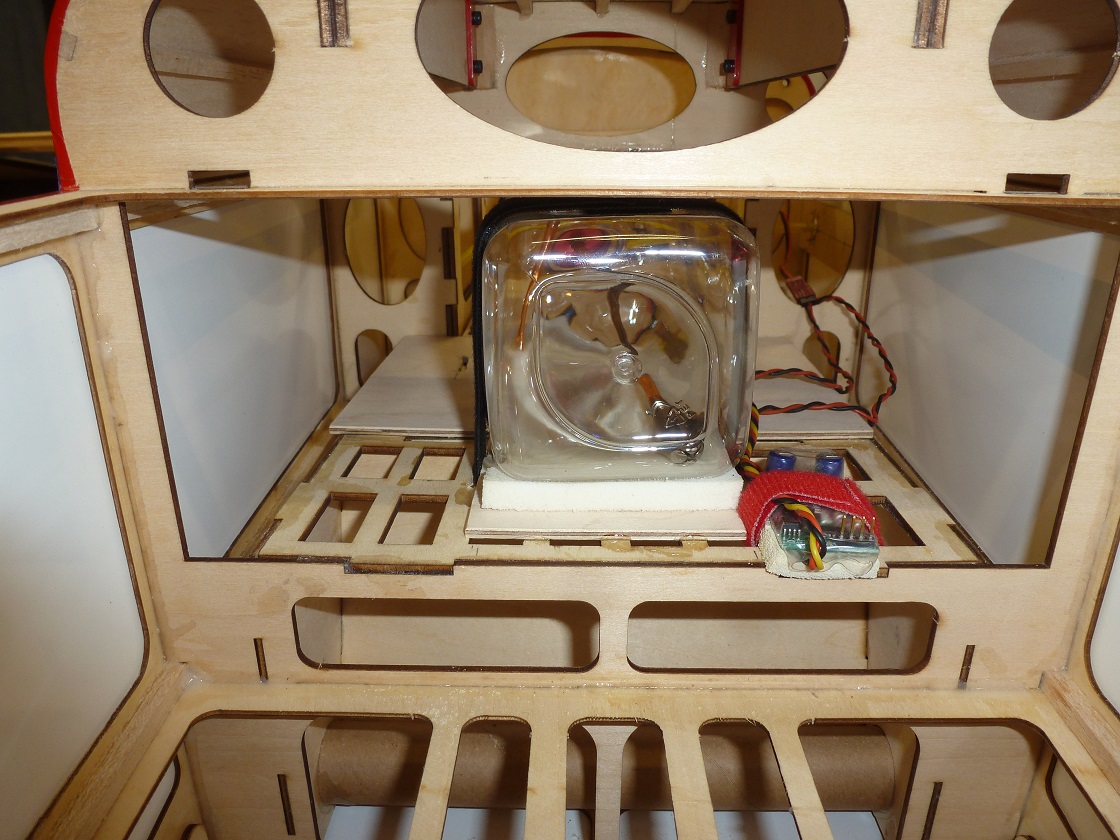

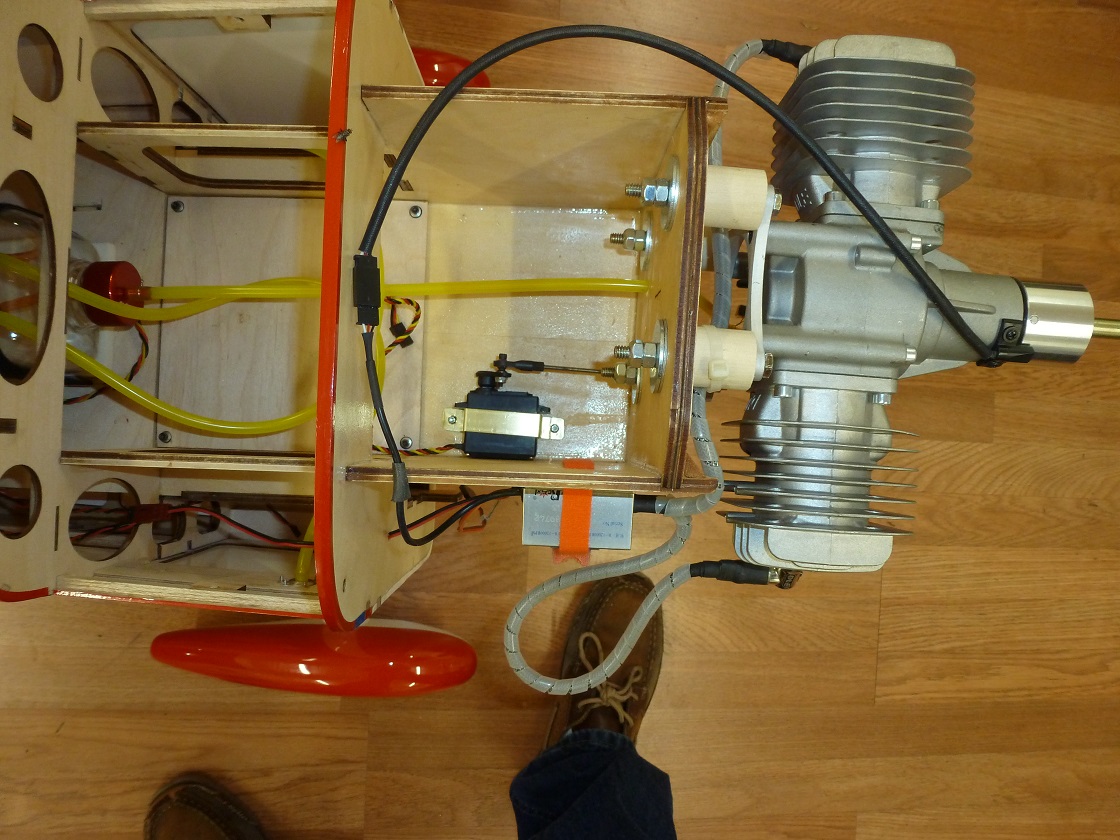

The ignition is in, the throttle servo is in, the choke will be a simple rod out the front. The fuel tank is plumbed and installed as well as the Tech-Aero.

Is there no hatch cover for behind the engine , could have some hot engine air getting into the fuselage during flight .

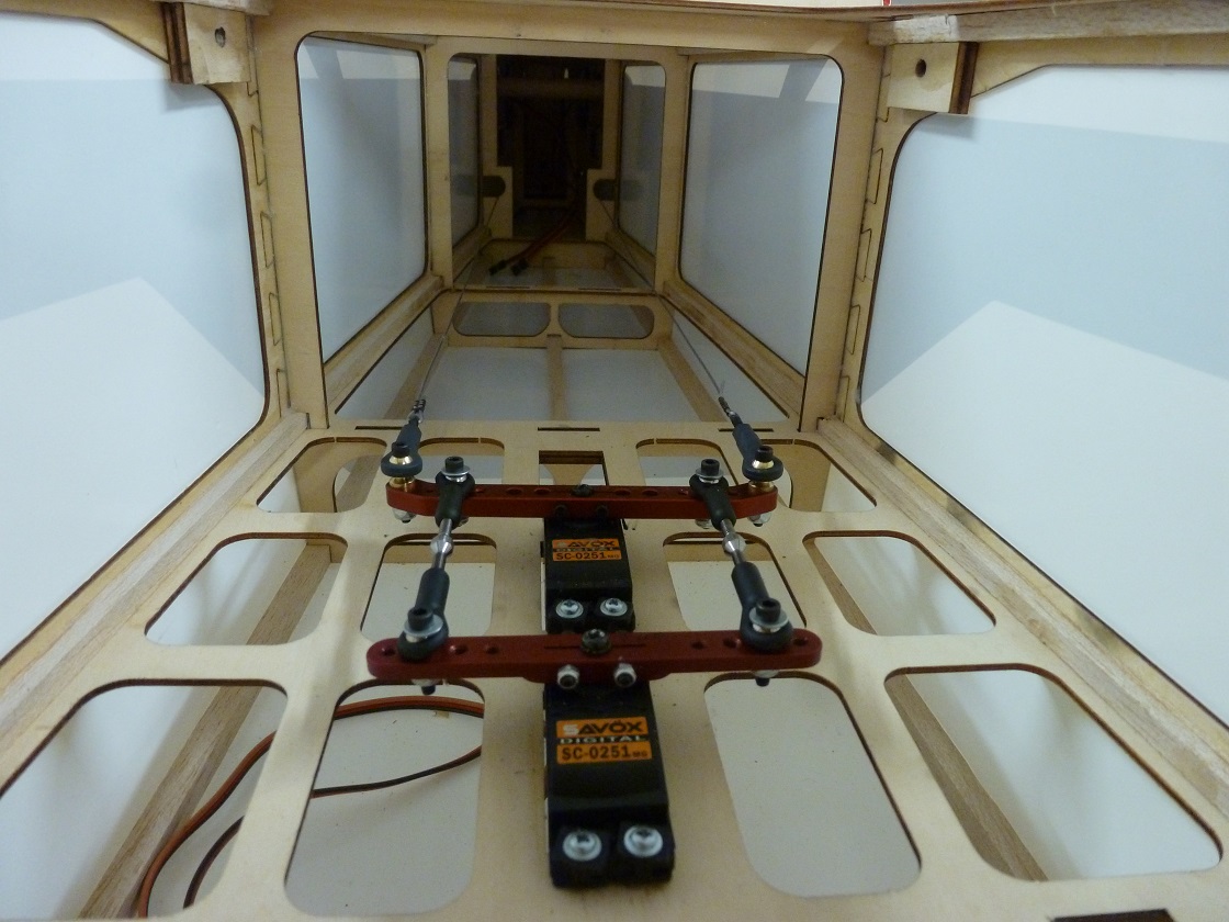

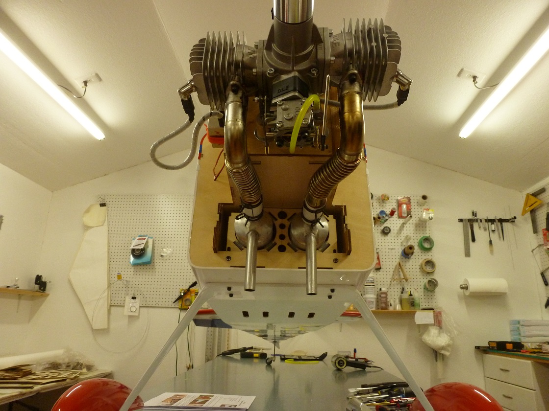

The engine and exhaust is buttoned up, the pull-pull installed. Now to get the wings on, install the struts, and tighten up the cabane. That will be followed by balancing and placement of batts and Rx, then start cutting some wiring.
