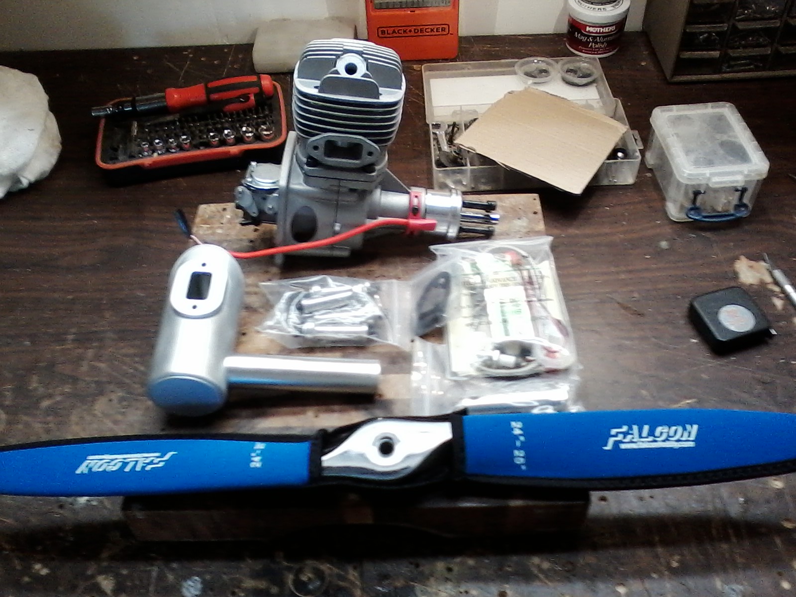

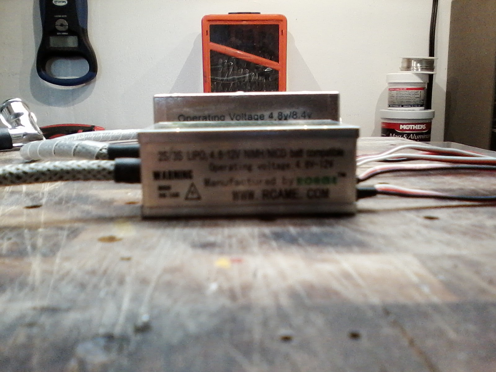

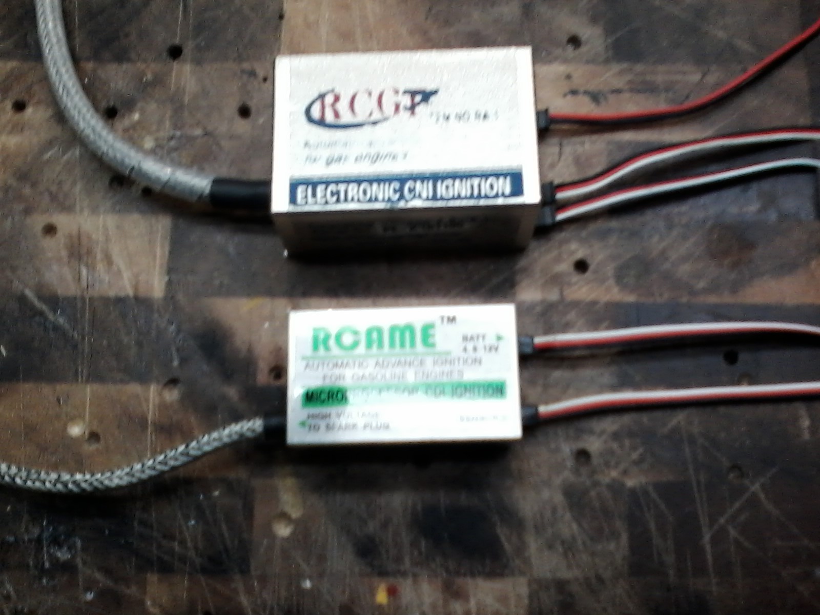

Alien performance upgrade showed up today :). I like the new smaller footprint and wide voltage range of the RCAME ignition too! The HV lead has a smaller diameter as well and is much easier to manipulate around tight spots. The plug cap is 10mm so a nice snug fit with a CM-6 plug.
So I finally got off me duff and started the engine change out. Been talking with a friend via email who has two of the 72's. He is currently flying one of the two in an EF91 Extra. Reports are positive but the second engines ignition was faulty (RCAME). DJ has come out with a new ignition for this engine. Had a picture of it but I forgot to save to my computer :ugh:. Looks similar to the MSR ignitions made for MVVS.
So looking forward.....I'm looking at going from 5.5hp to 7.5hp to haul a 20 pound plane :big-grin:. Looks as if it will be "Drop In" ease :).

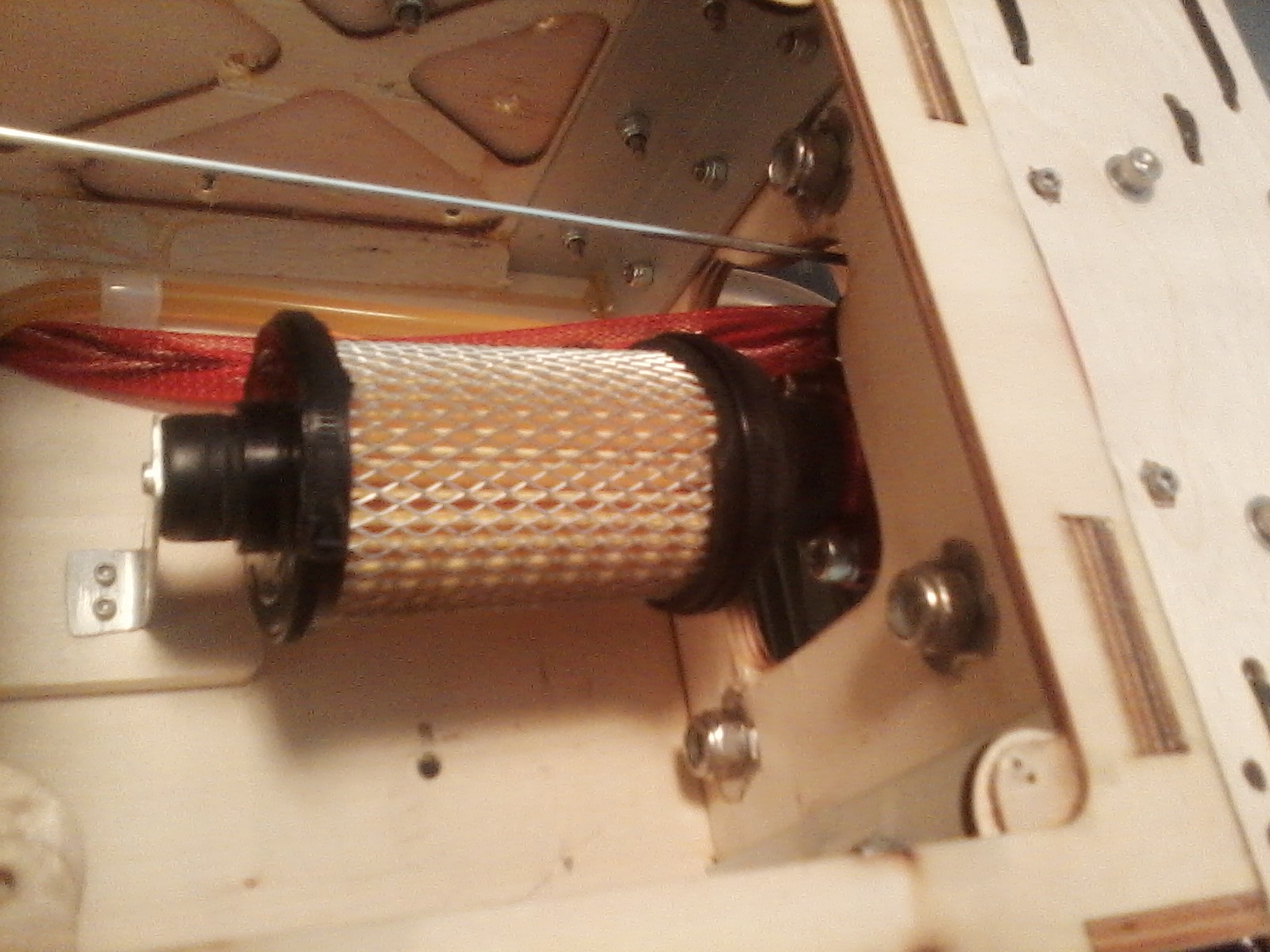

Oh! The 72 will be getting the same filter / velocity stack treatment as the 50 has. This has been a great asset keeping the internals of the plane nice and clean and keeping the internals of the engine from wear due to dust and debris. To date the Alien has 32 flights of about 7 minutes each.

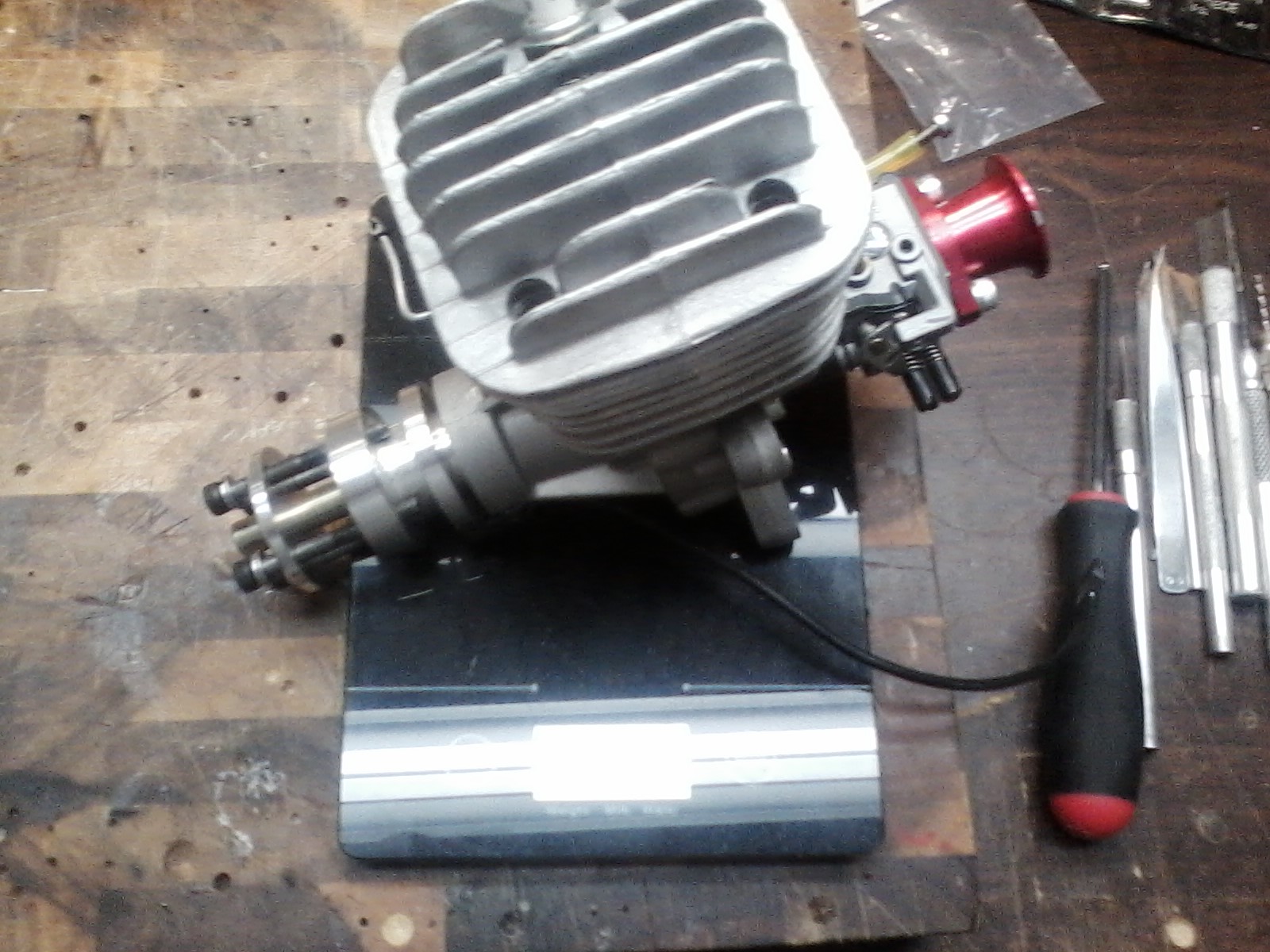

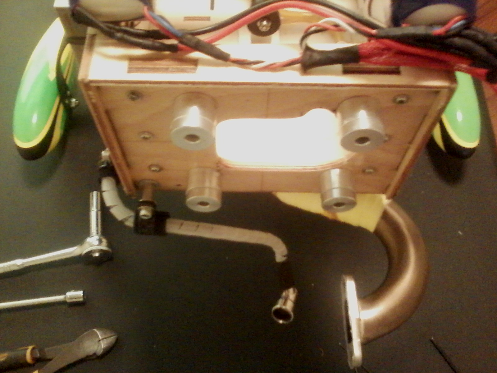

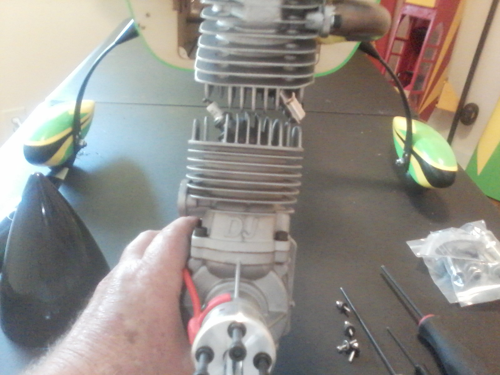

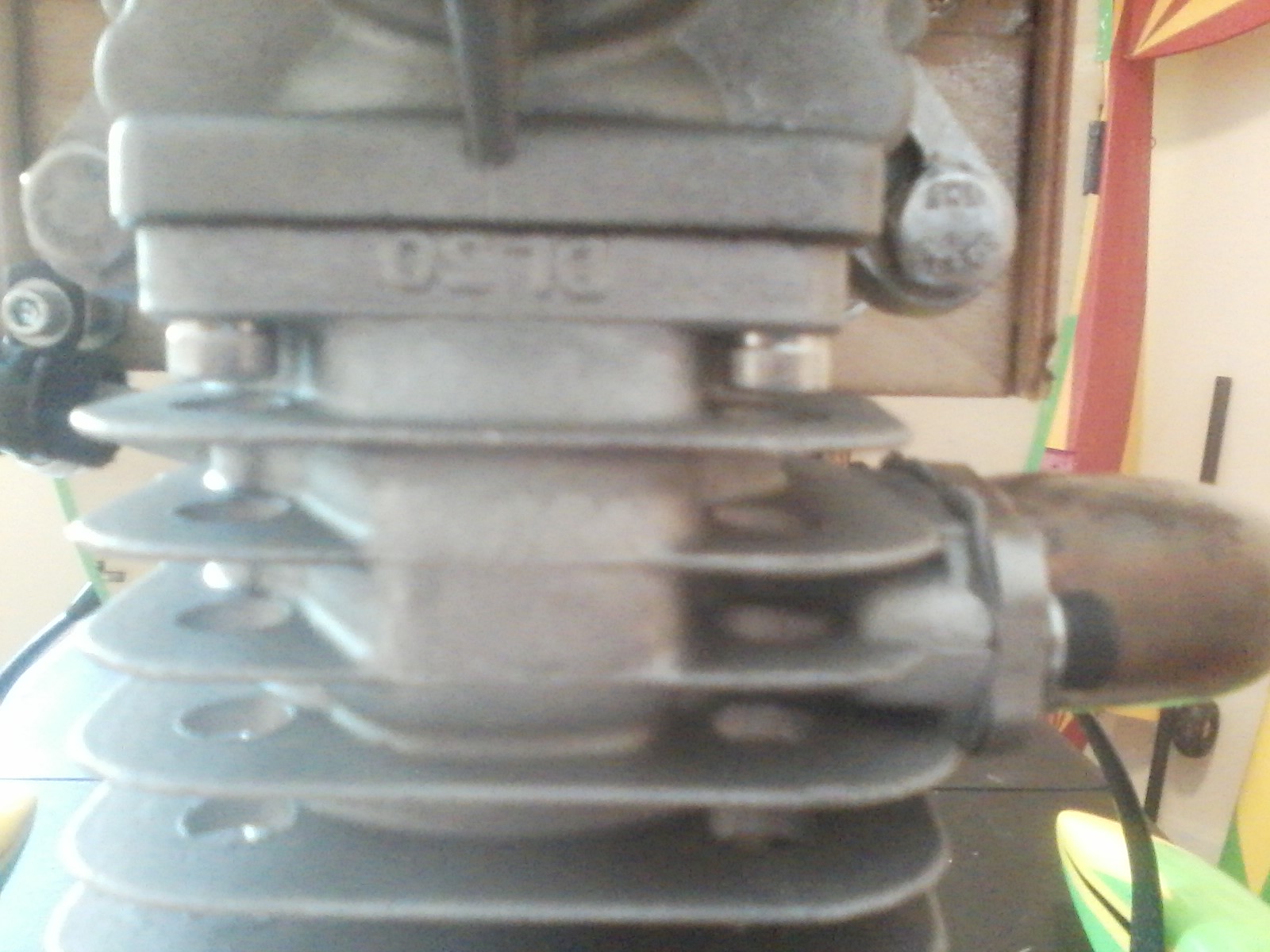

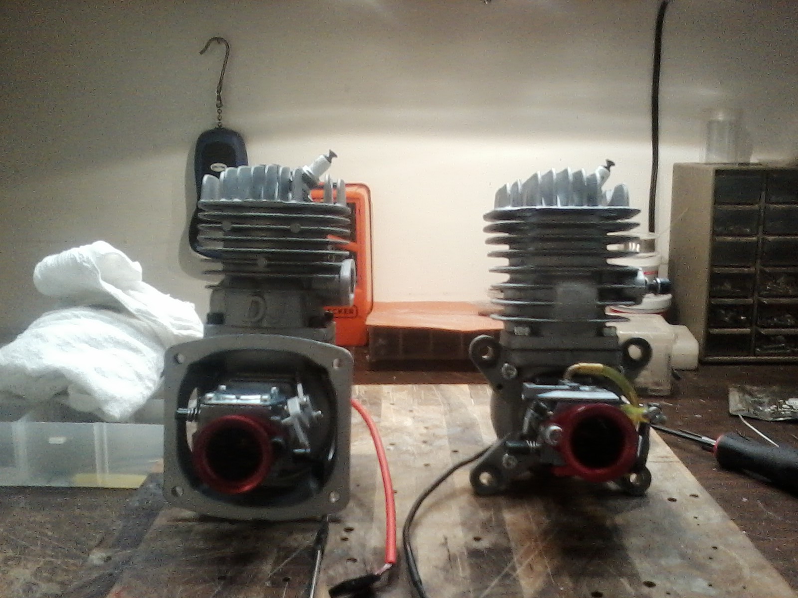

Got as far as getting the 50 off the airframe and installing 3/4" inch stand offs. This will put the spinner back plate about 1/8" off the cowl.

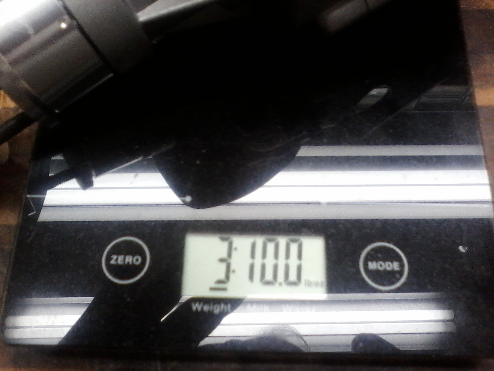

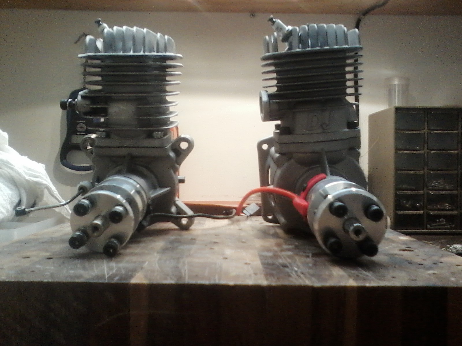

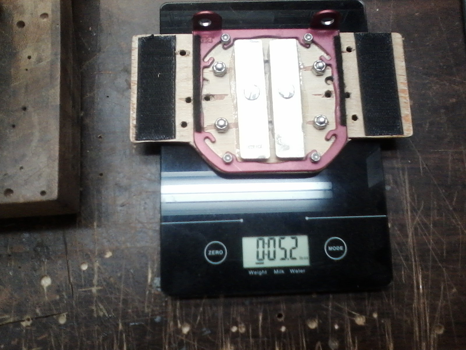

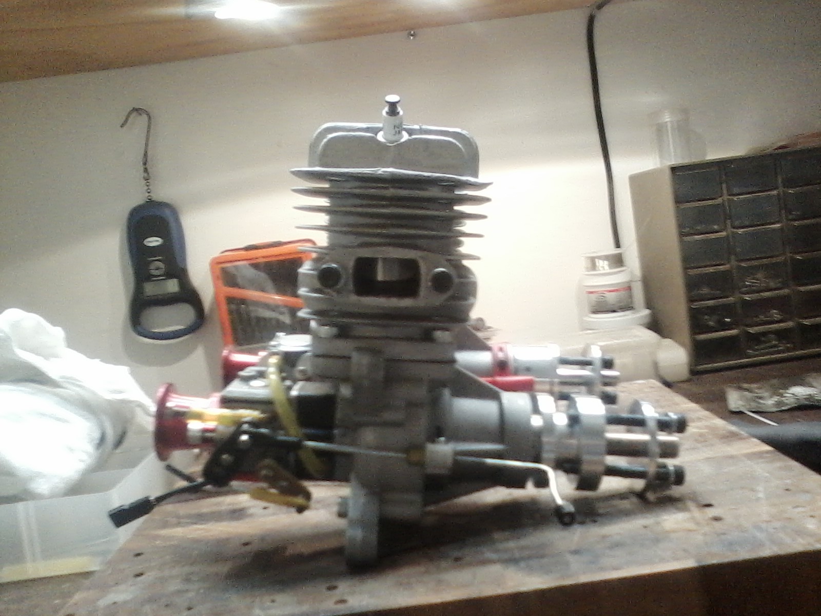

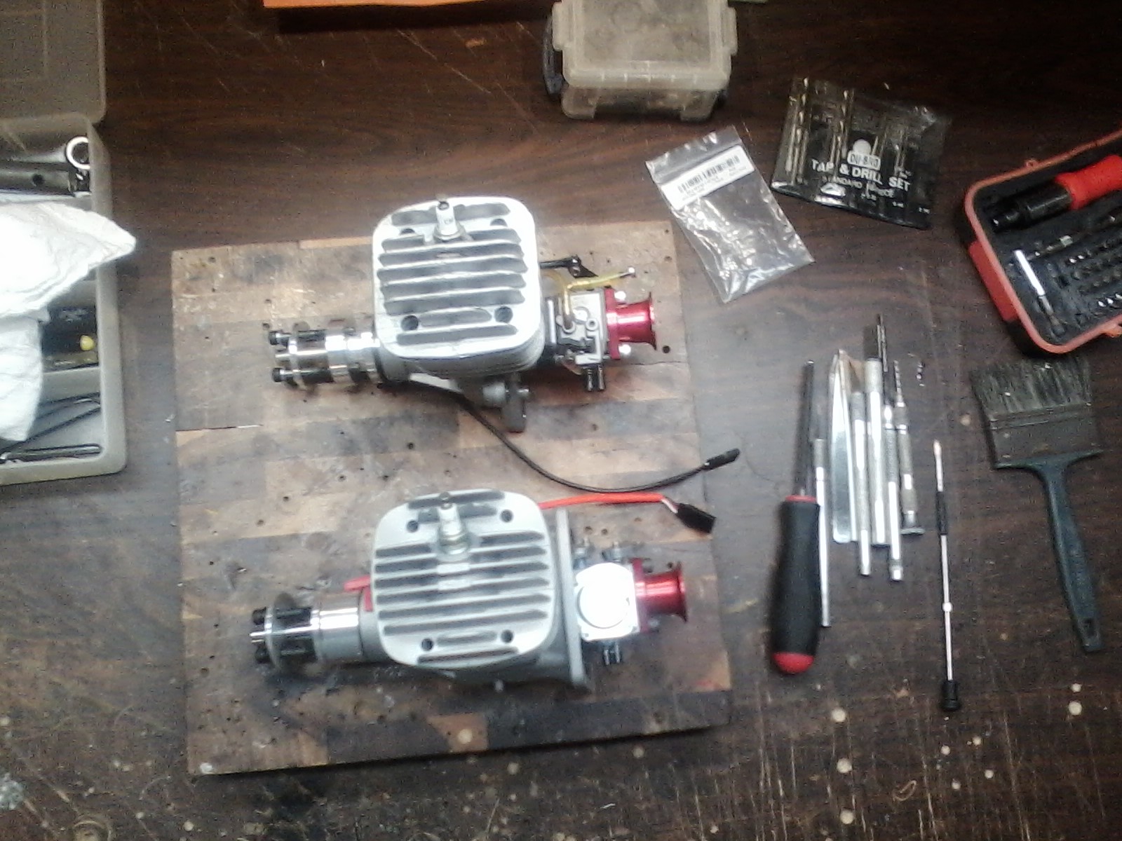

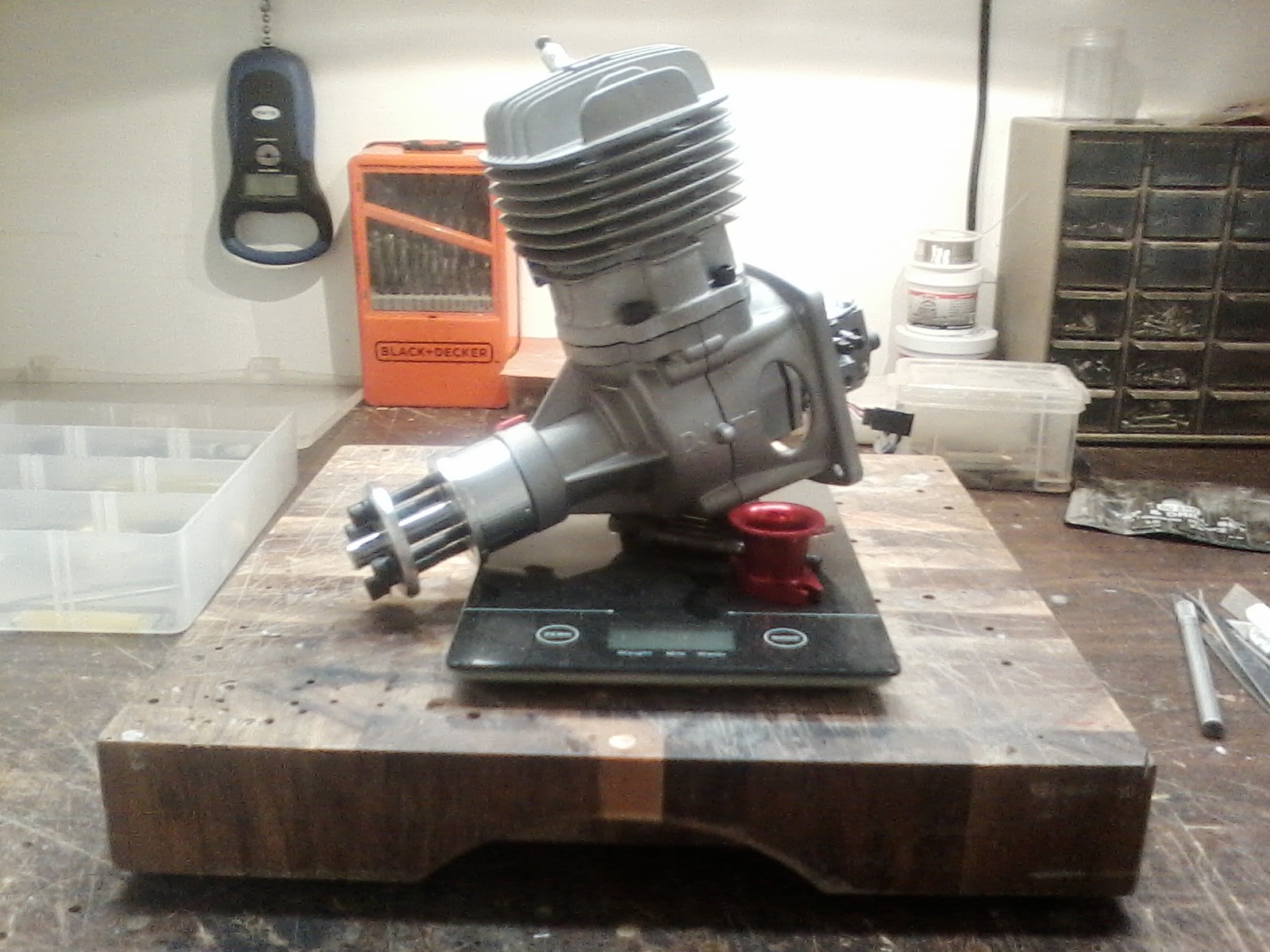

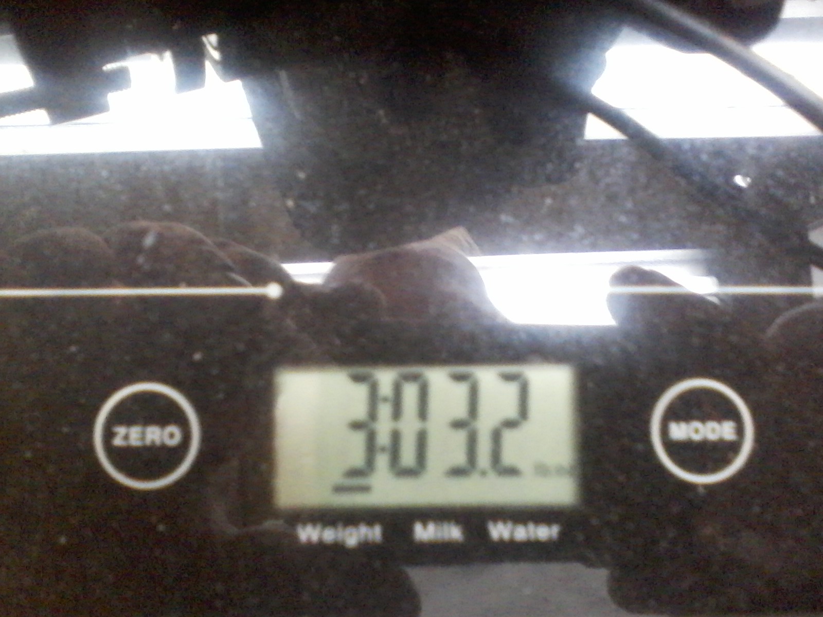

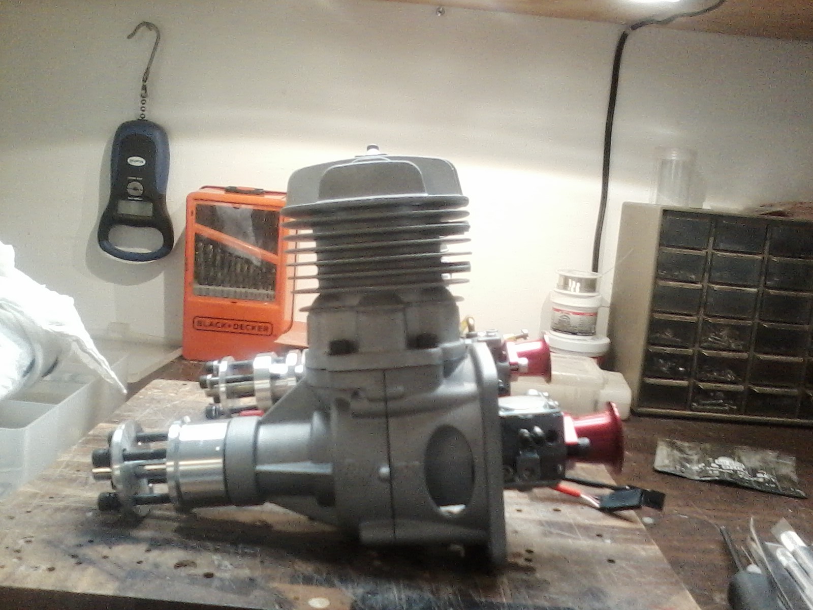

The difference in weight of the two engines is 6.8 oz.

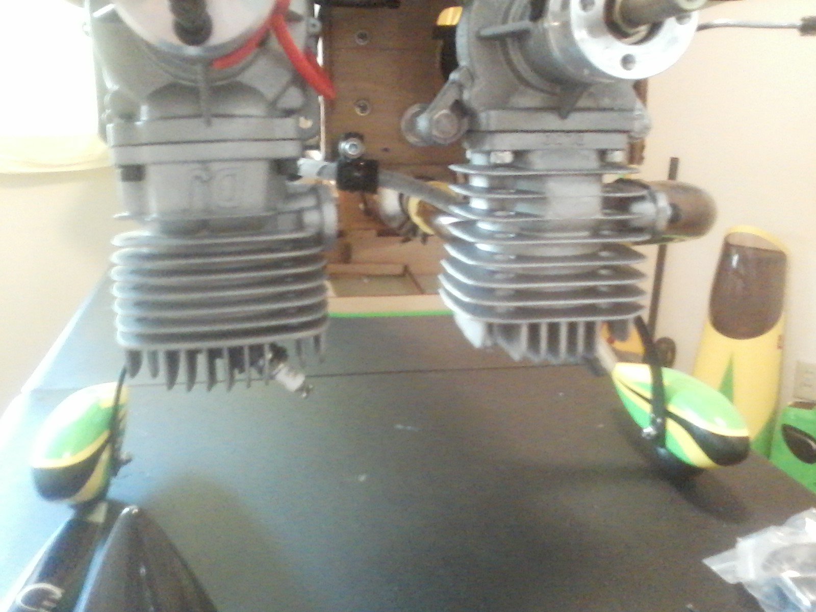

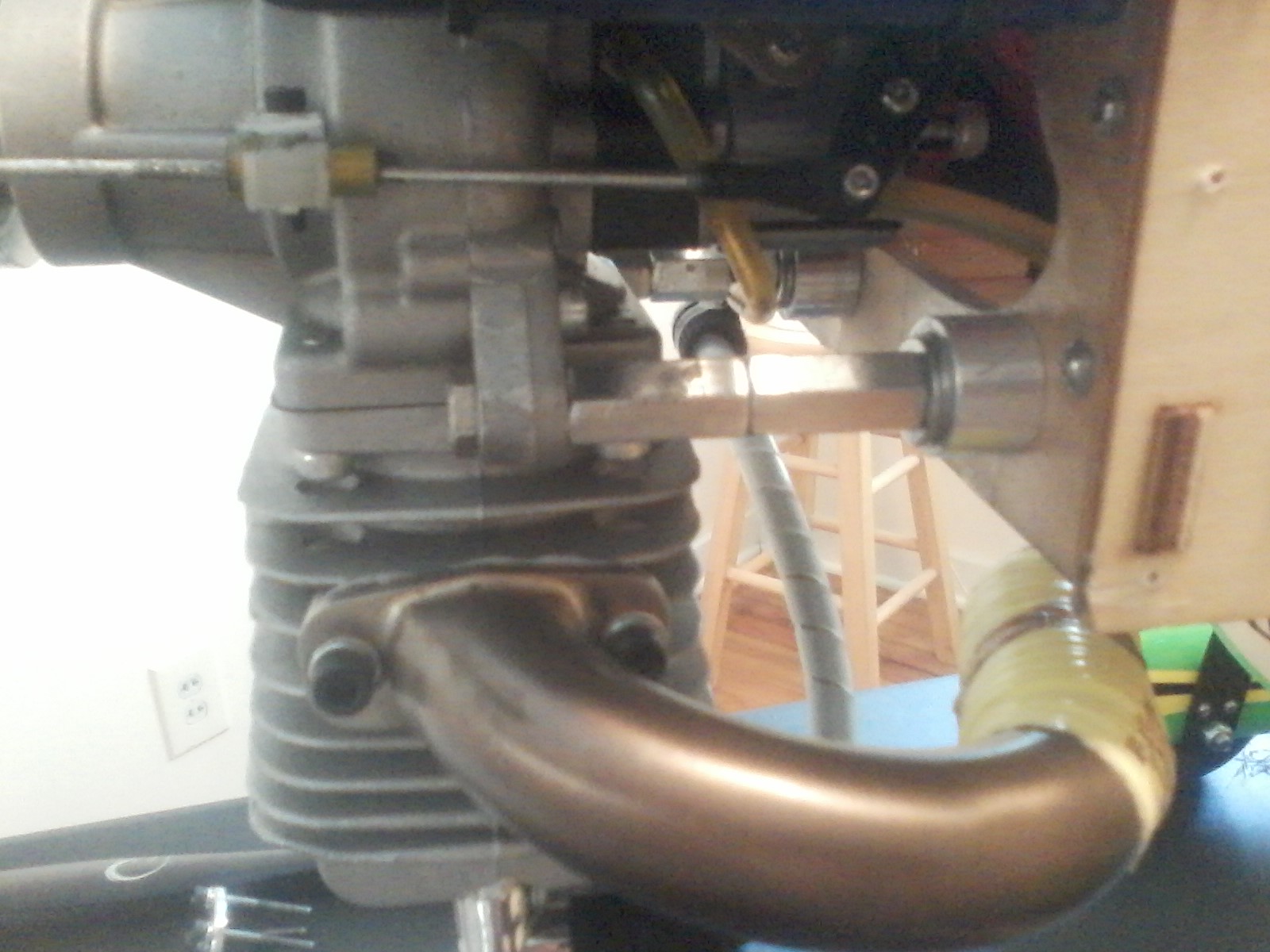

The battery tray I made weighed 5.2 oz. Putting both batteries back to the left side of the motor box should make it a wash as far as CG goes :). I also got some side by side shots of the two engines for those who may be interested. Fit and foot print are " drop in". Will have to re configure choke and throttle control rods. The up down position of these controls on the new engine are reversed ie...Choke rod on top, throttle rod on bottom.
