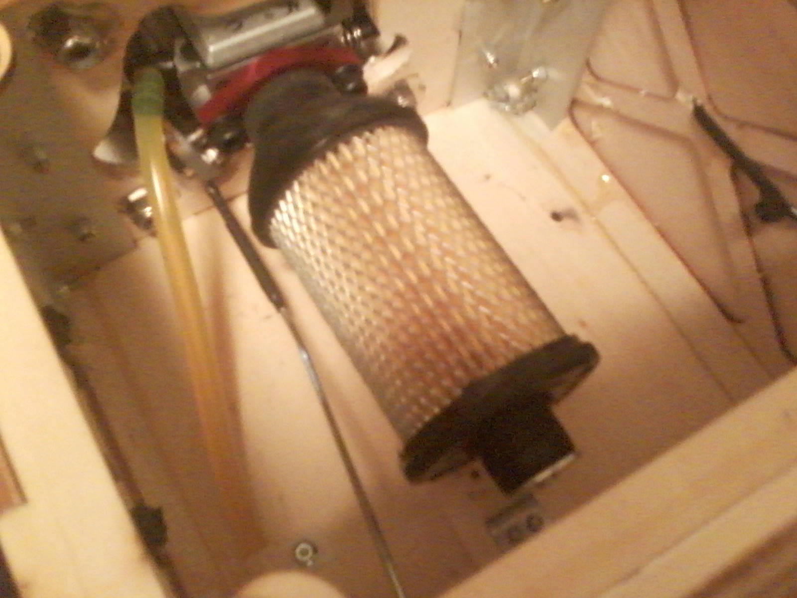

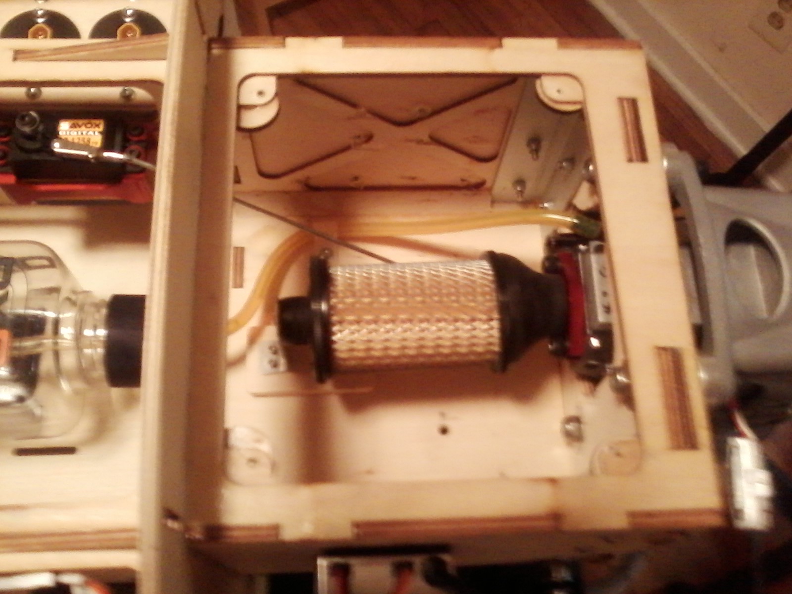

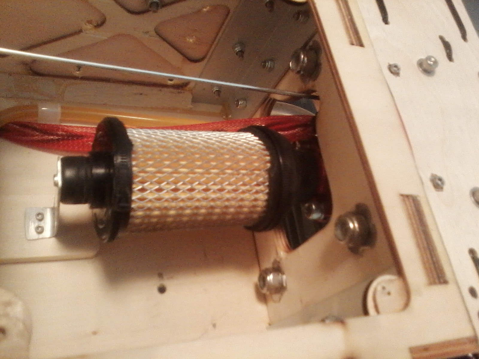

Getting closer to a first start :). Engine is bolted up to firewall and air intake filter / throttle and choke control linkage completed. Was concerned at first with the air filter fitting because the 72 sets the carb about 3/4" further back. Had plenty of room after all.... :fist_pump:.

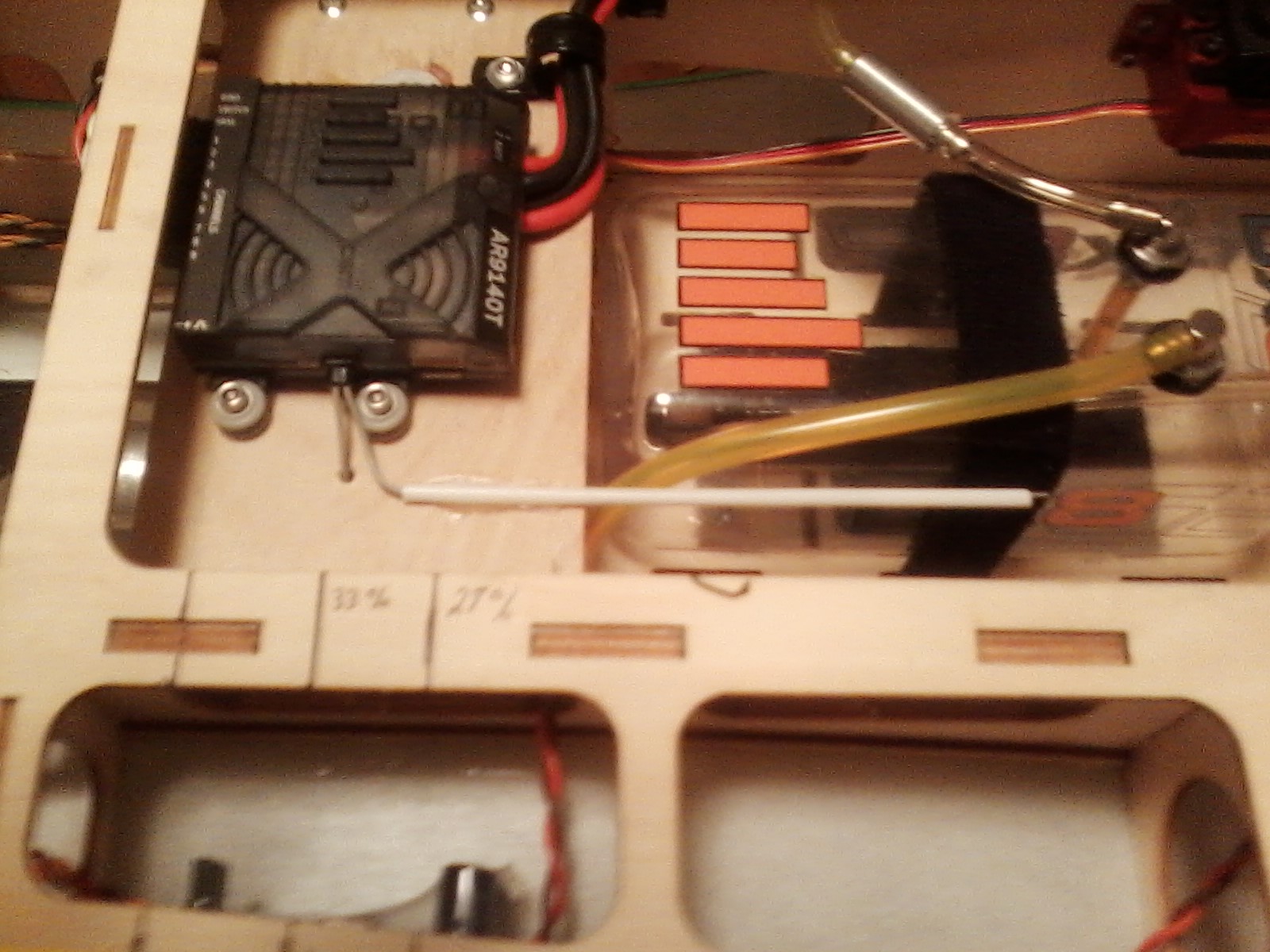

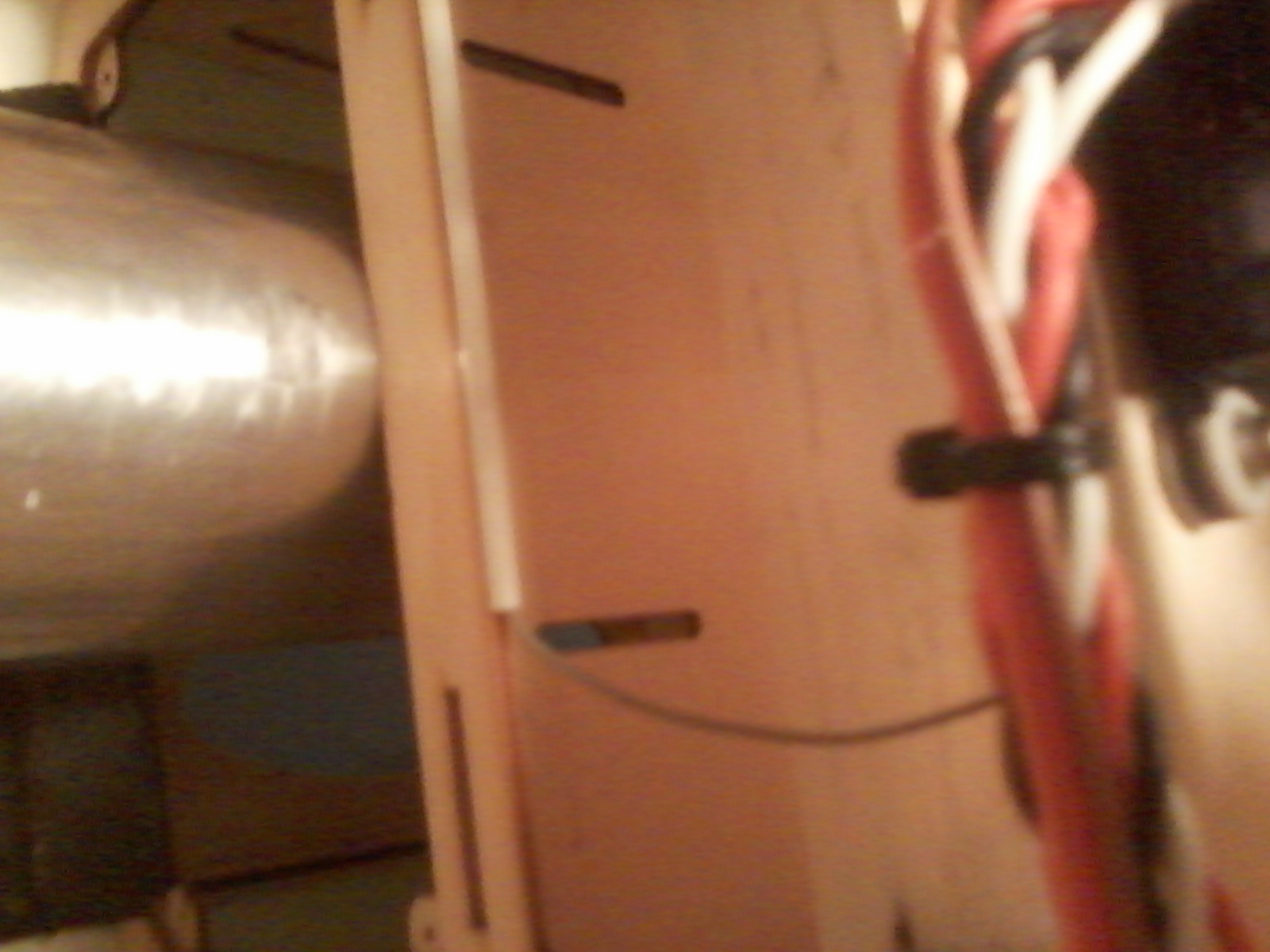

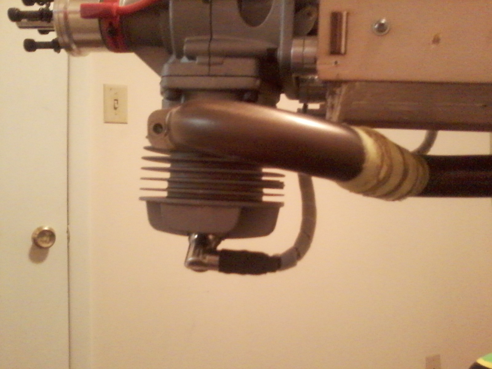

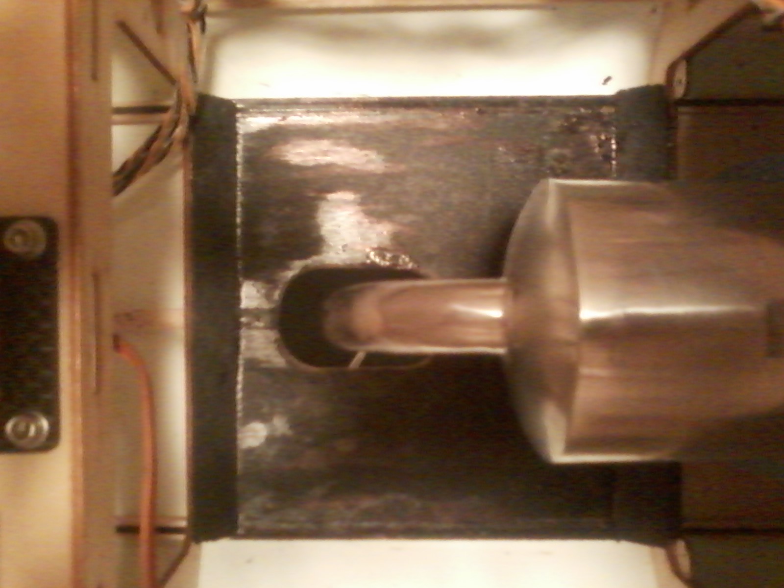

I did away with the "exhaust chest" on the airframe and will be using a simple 22mm Teflon tube extension to route exhaust away from the bottom of the plane. It was noisy and messy. I also took the time to re-route the main Rx antennae's for better reception. My flight logs where consistently showing 200 to 250 data packets being lost on the main RX. The three remotes would only show 10 to 25 packets being lost. According to Spectrum anything under 100 data packets being lost is acceptable. Just need to bolt on the header and install the batteries back to the side of the motor box. Then It will be time to drill and fit the Falcon 24x9 CF prop and fill the tank back up :).

DL50 View attachment 104113 DJ72 View attachment 104114
View attachment 104115 View attachment 104116 View attachment 104117 View attachment 104118 View attachment 104119
I likes me a clean install. Good job cheeseburger man. Now go reward yourself.

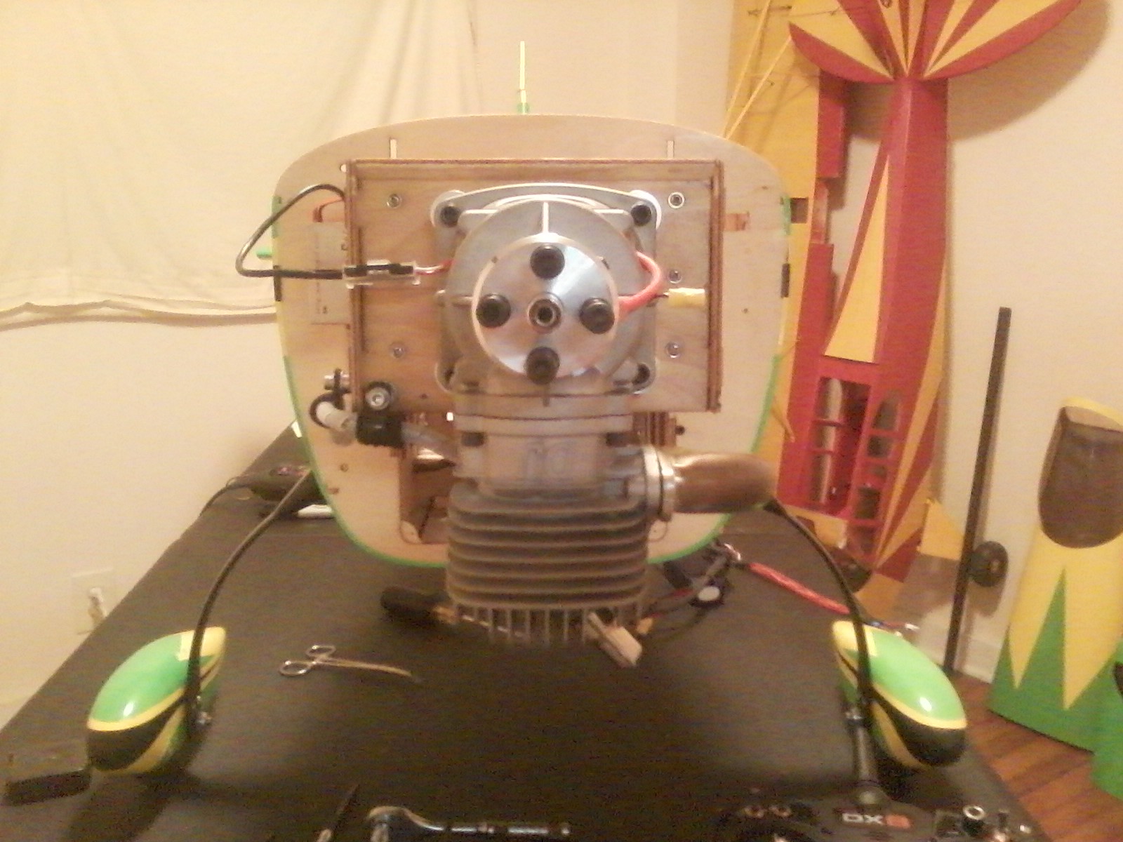

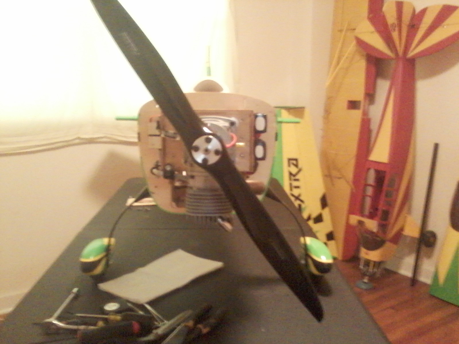

It's ready for its first start and run :brian-banana:. Will need to trim the cylinder opening on the cowl just a wee bit since the DJ72's cylinder is about 5mm taller than the DL50 and the cylinder also sets back about 3/8" over the DL50. Nothing that my trusty Dremmel drum sander can't handle. Now to the really good news so far about this engine and getting ready for its first start and run. As I stated in the past I removed the carb and reeds for internals inspection and overall condition of a new engine. I found the reeds not seating properly and the inside of the engine needing imo a bit more lubricating oil prior to starting the engine. Well it all paid off doing this inspection because once I got the prop mounted and a bit a gas in the tank I was literally astonished at the cold compression and how fast the engine drew fuel up to the carb from a completely dry state!. It took only 4 flips to get fuel to the carb with the choke on and throttle set 1/2 open. And every time I pulled the prop through compression the tail of the plane wants to lift up because it's so strong. I will definitely have some one with me for the first start of this Beasty engine :yesss:.

View attachment 104131 View attachment 104132
