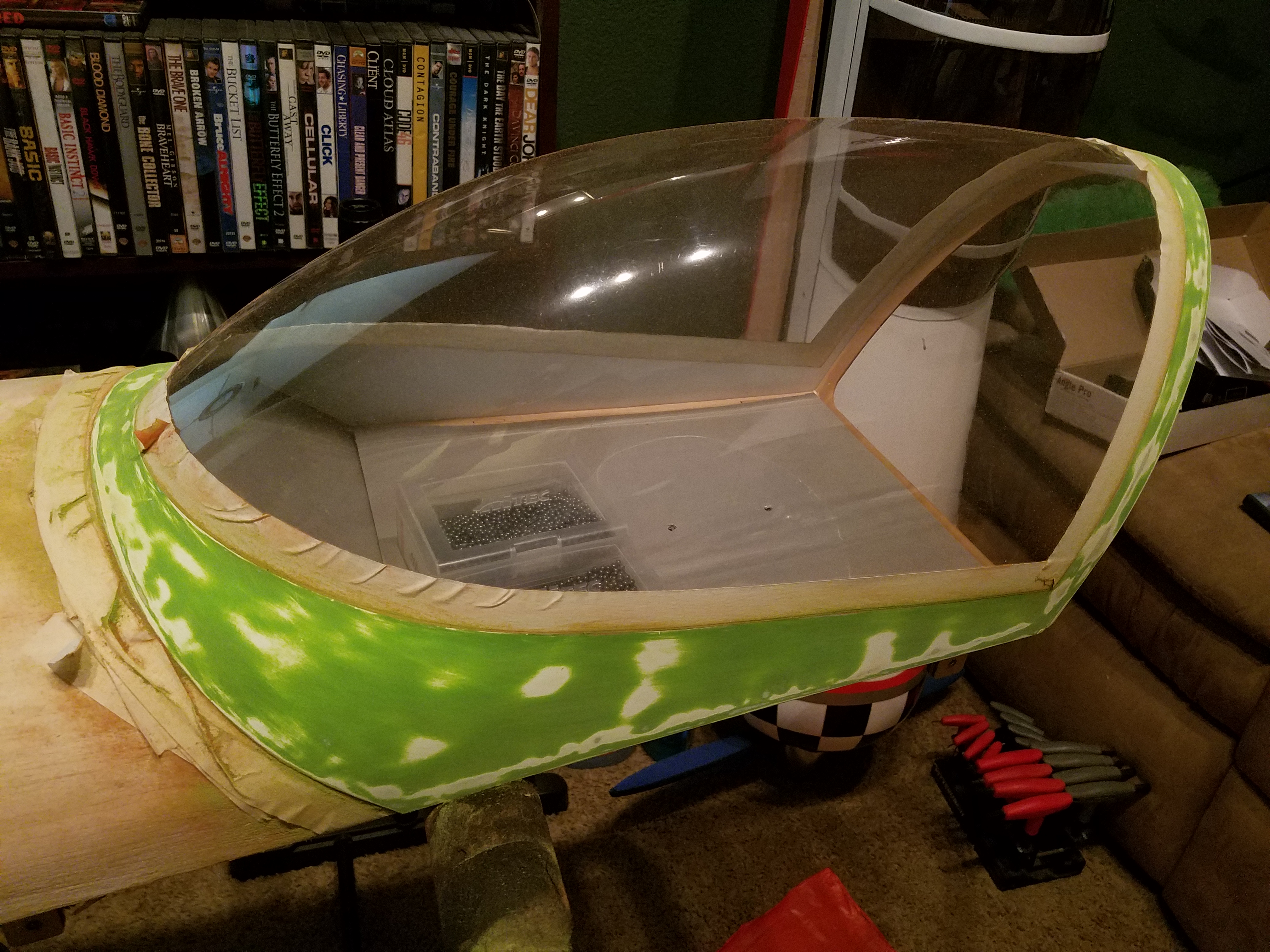

My guess is the canopy was green originally and was painted red to match the airplane. Probably didn't have any red canopies ready to go.
That is what my thoughts have been. But very perplexing as it is, I have never seen a Pilot RC Extra 330sc in any green schemes. I have been thinking that there was an error in the factory and someone mistook it for an Edge canopy. Either way, very mysterious. I may... contact Tony for a new unpainted canopy and unpainted split cowl. I don't know... just want no "damn its"!

So would it be safe to assume that @Xpress hit the nail on the head? No red, so repainted a green? This is actually very helpful. Now I know how to proceed with said canopy. I am going to shoot it with primer. (Once final sanding is done) if the primer stays down with no issues, I will then paint it and be done with it. Lol

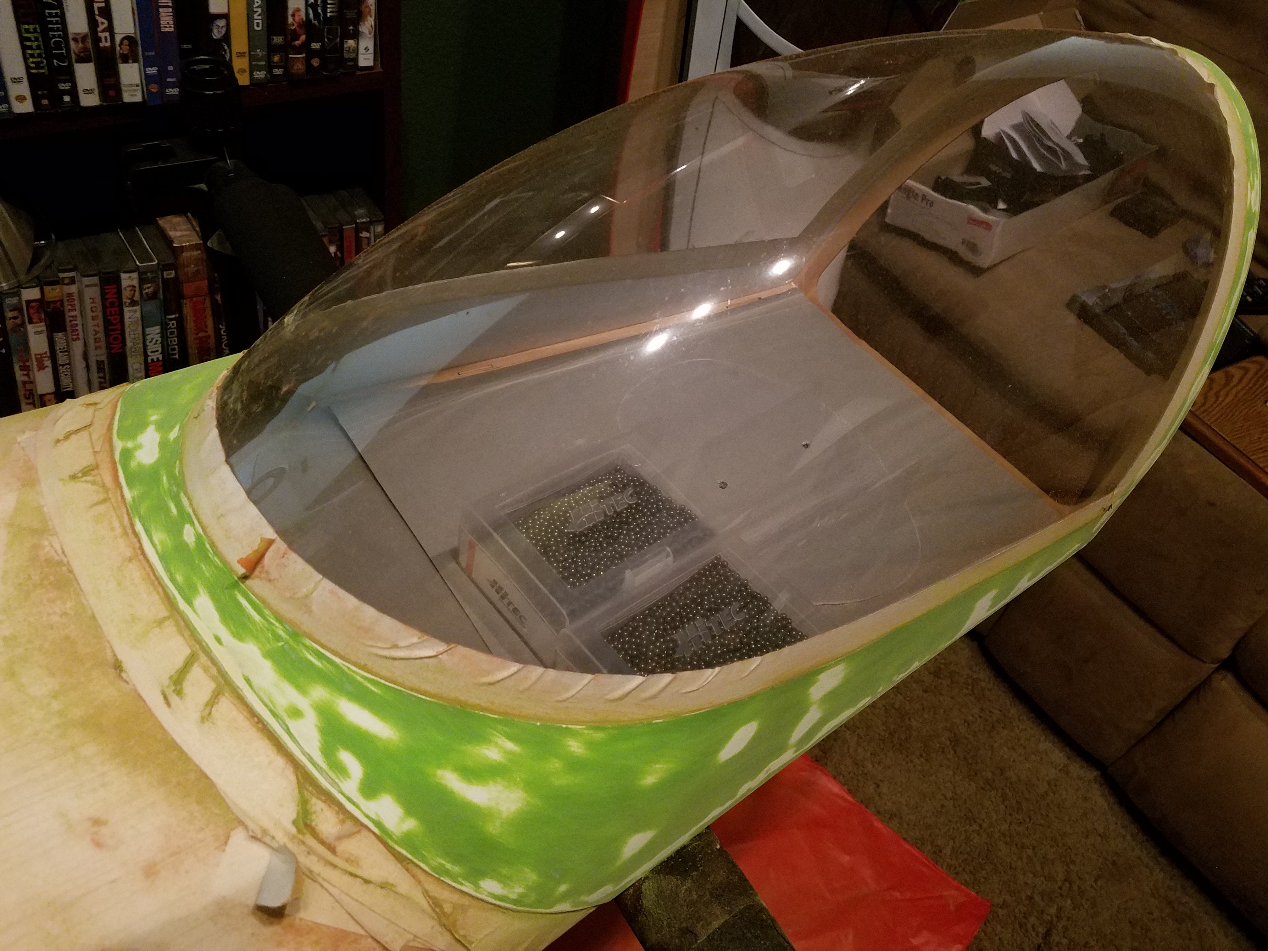

Well, here we go. I'm going to "attempt" priming the canopy tonight. Wish me luck fellas.
(I'll need all the luck I can get!)

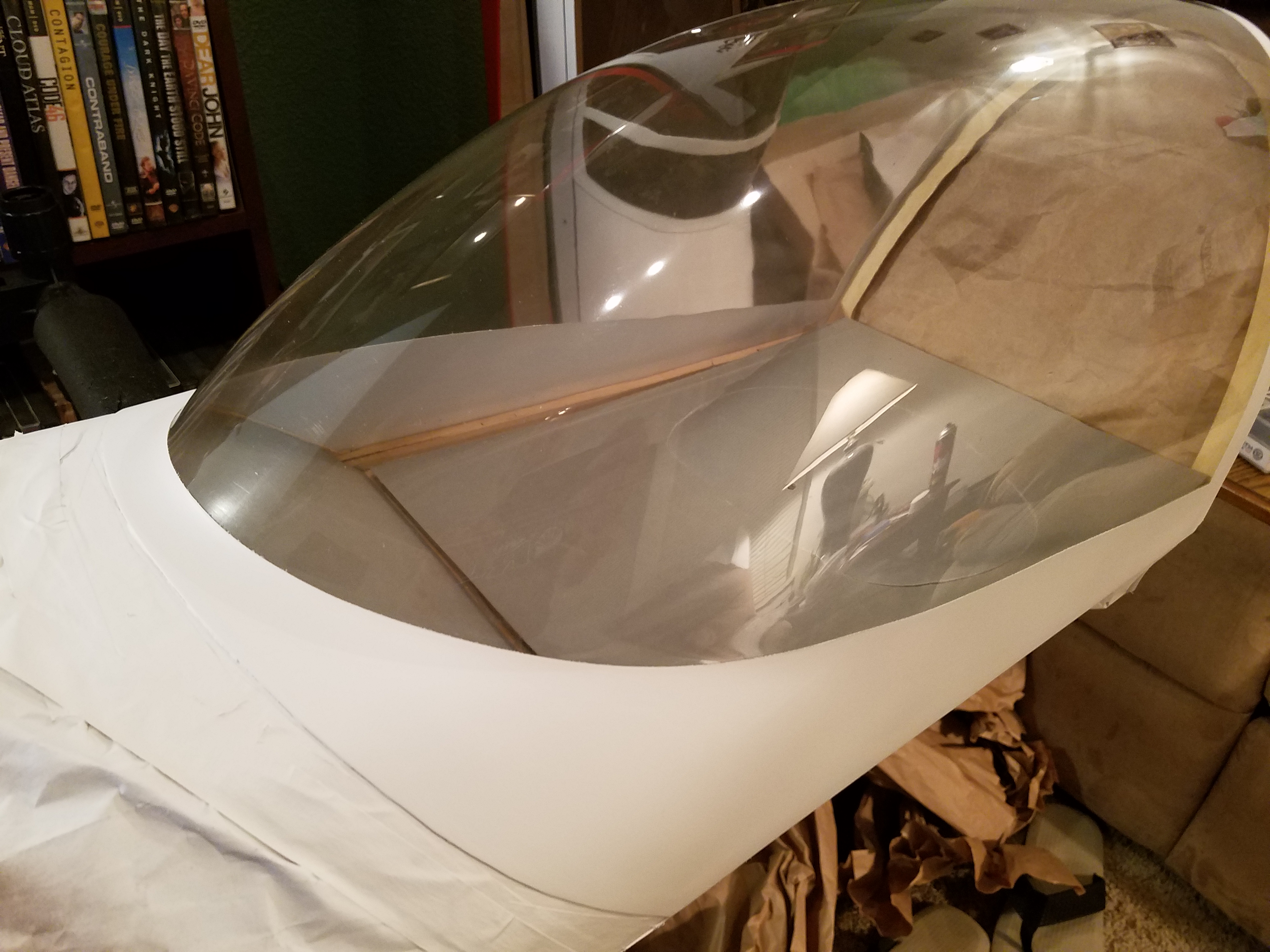

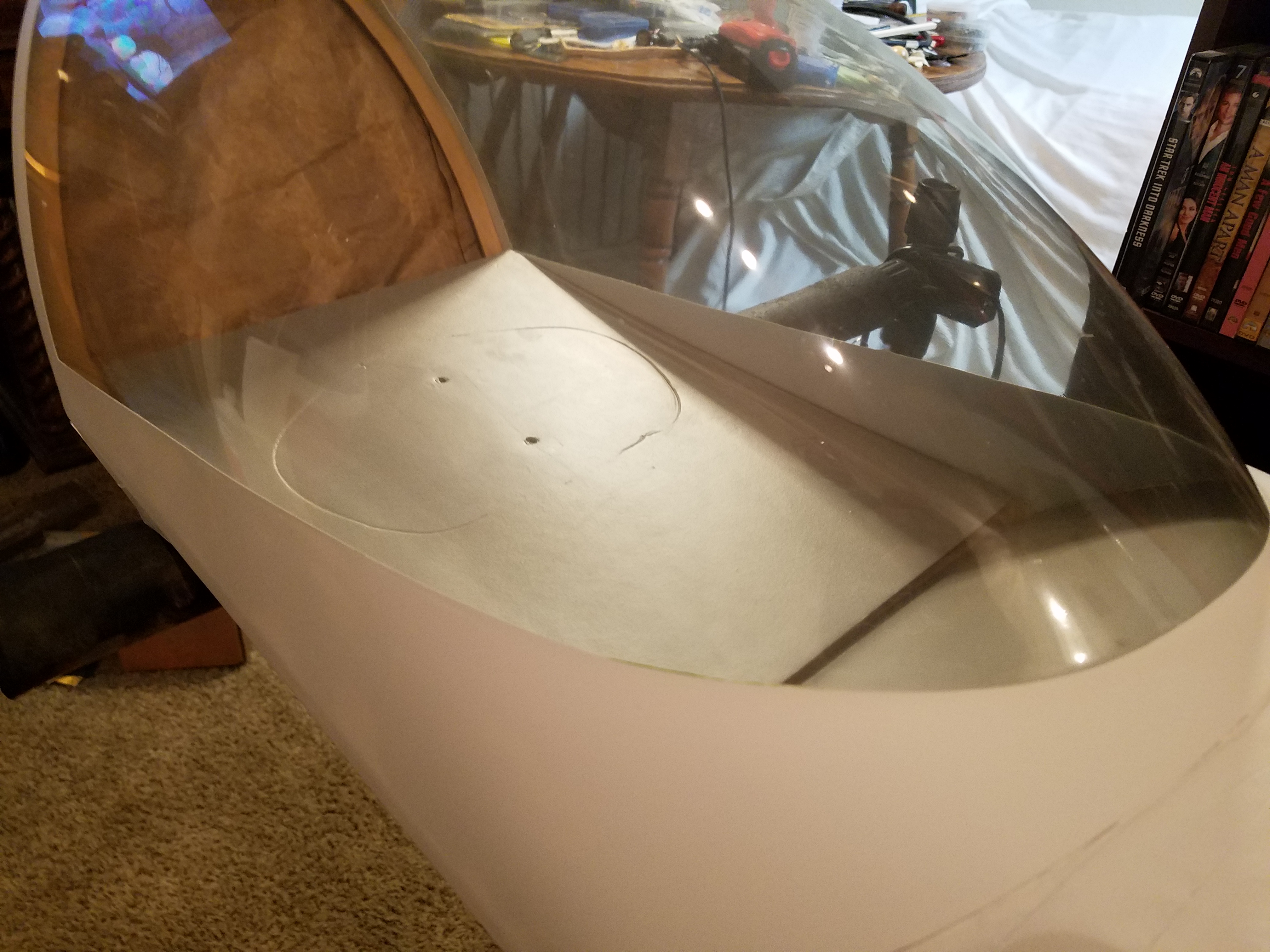

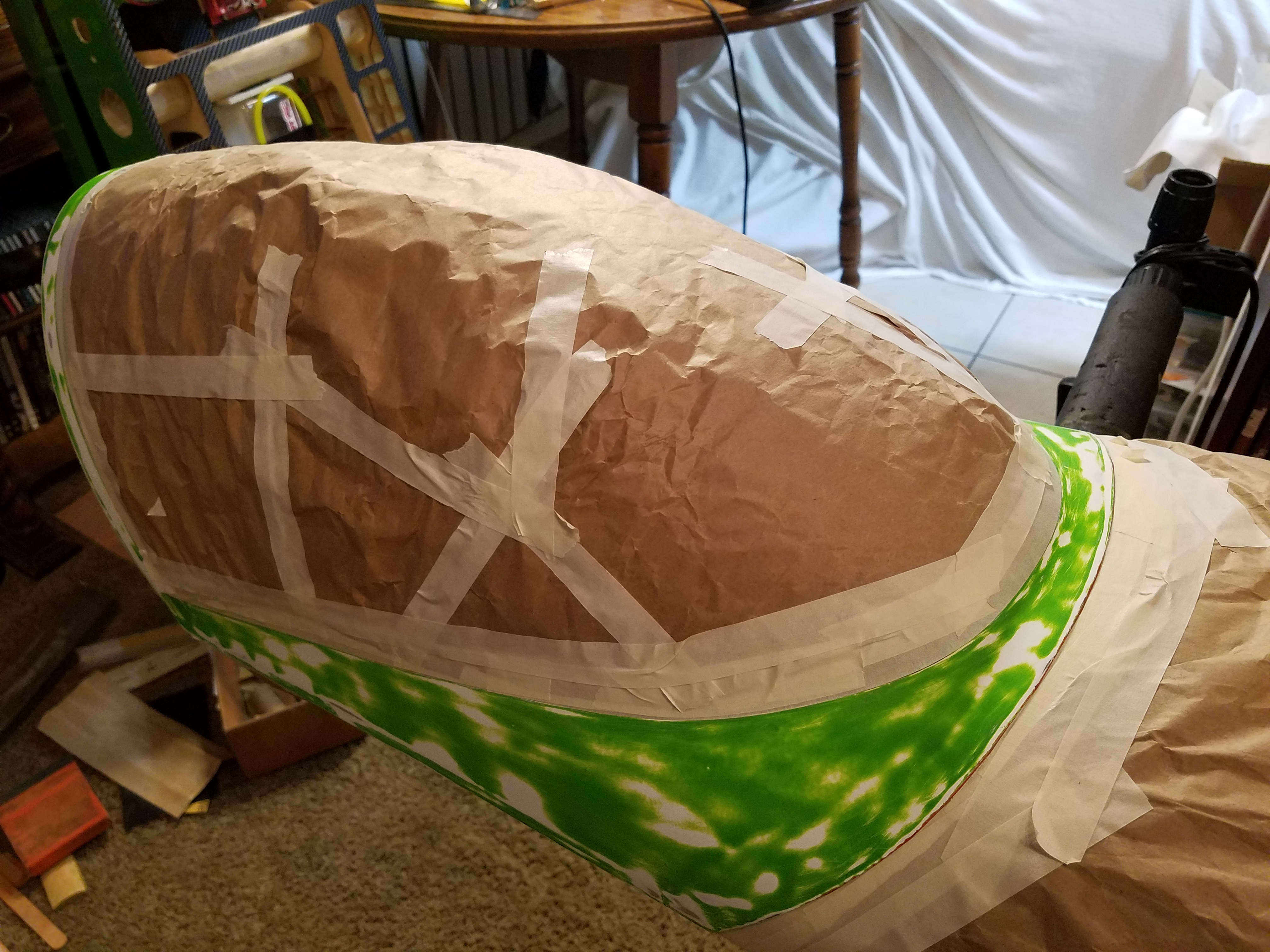

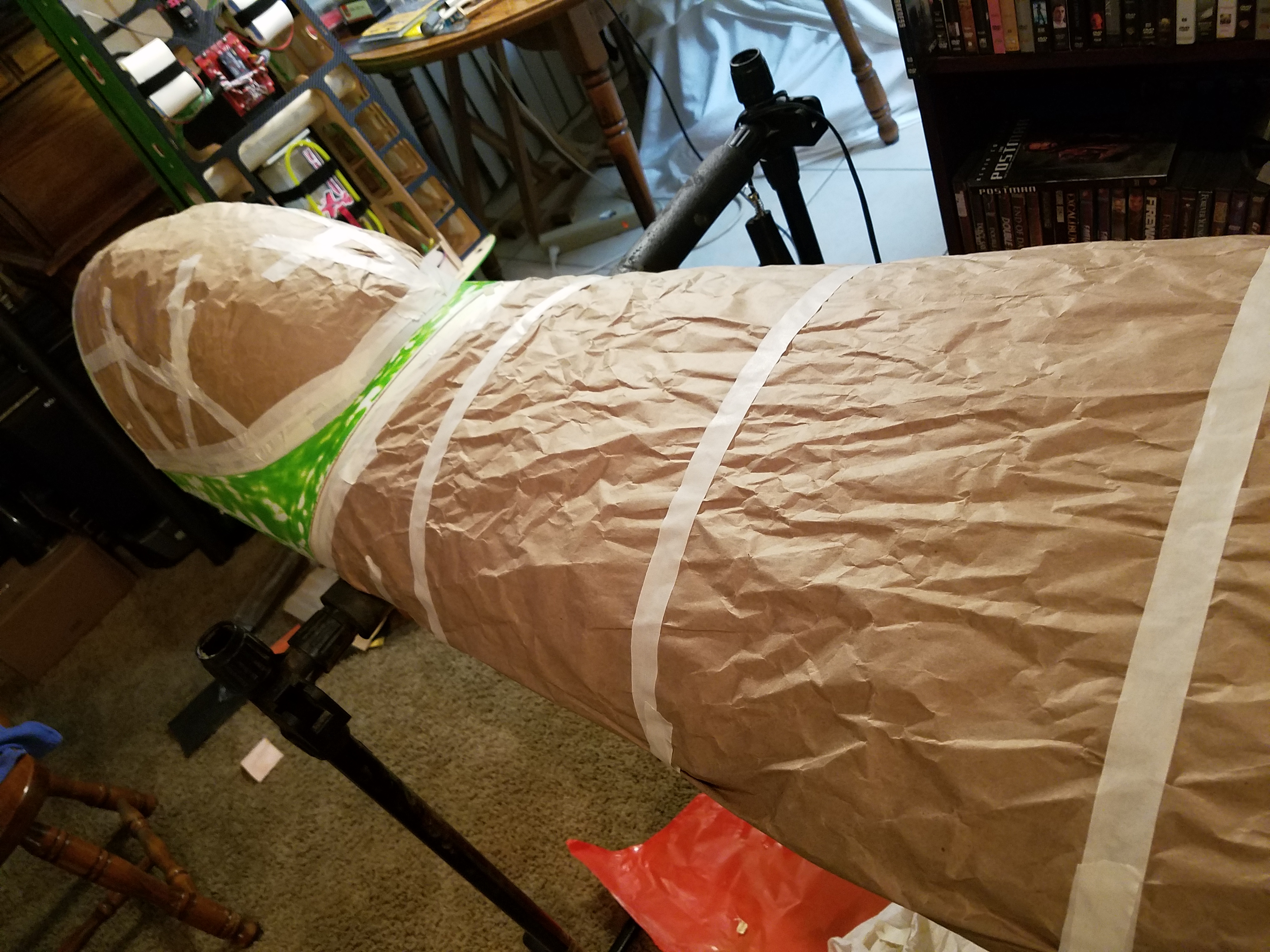

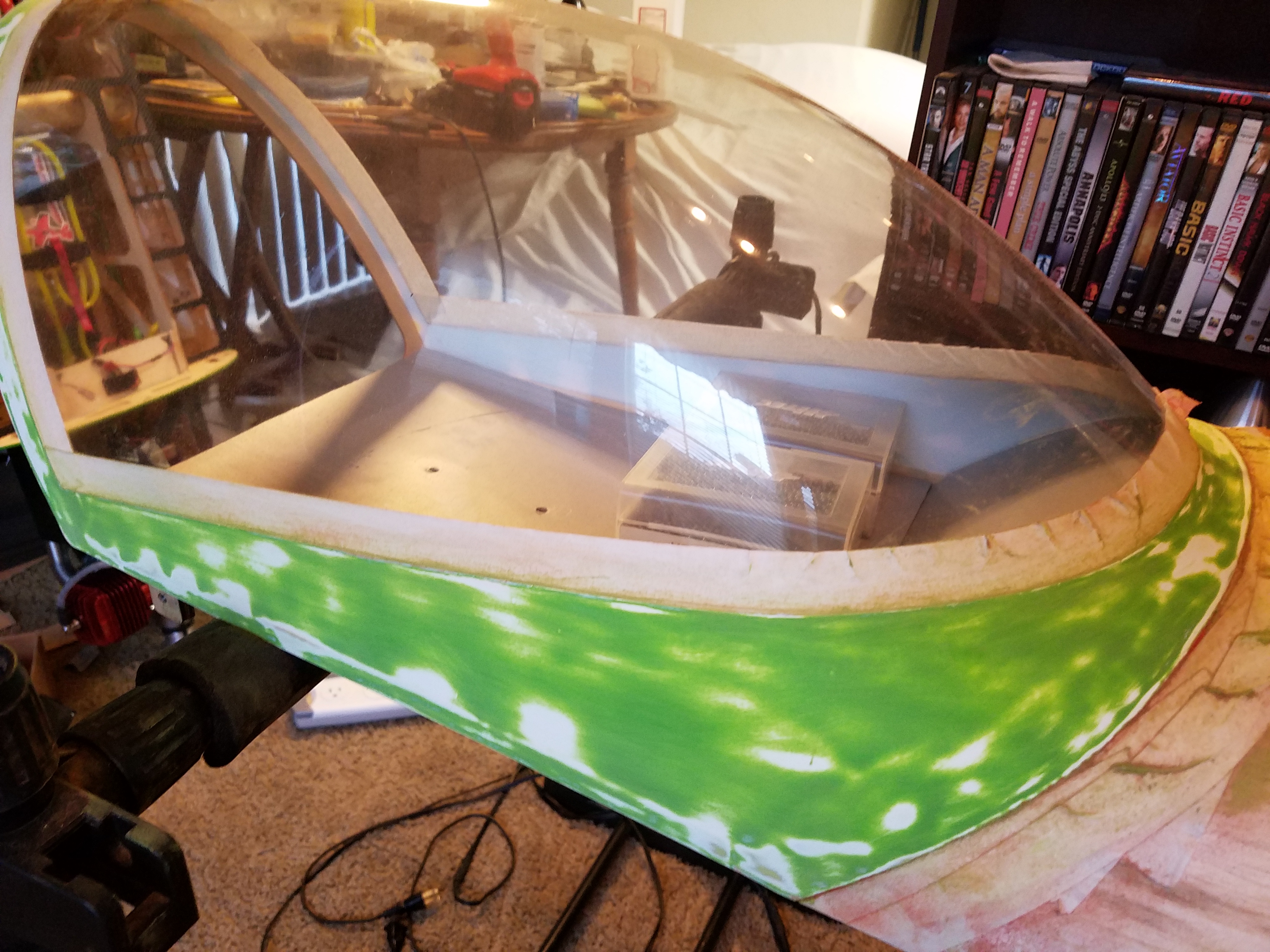

Before masking the canopy, I wet sanded the canopy with 400 then 600 grit wet/dry sandpaper.

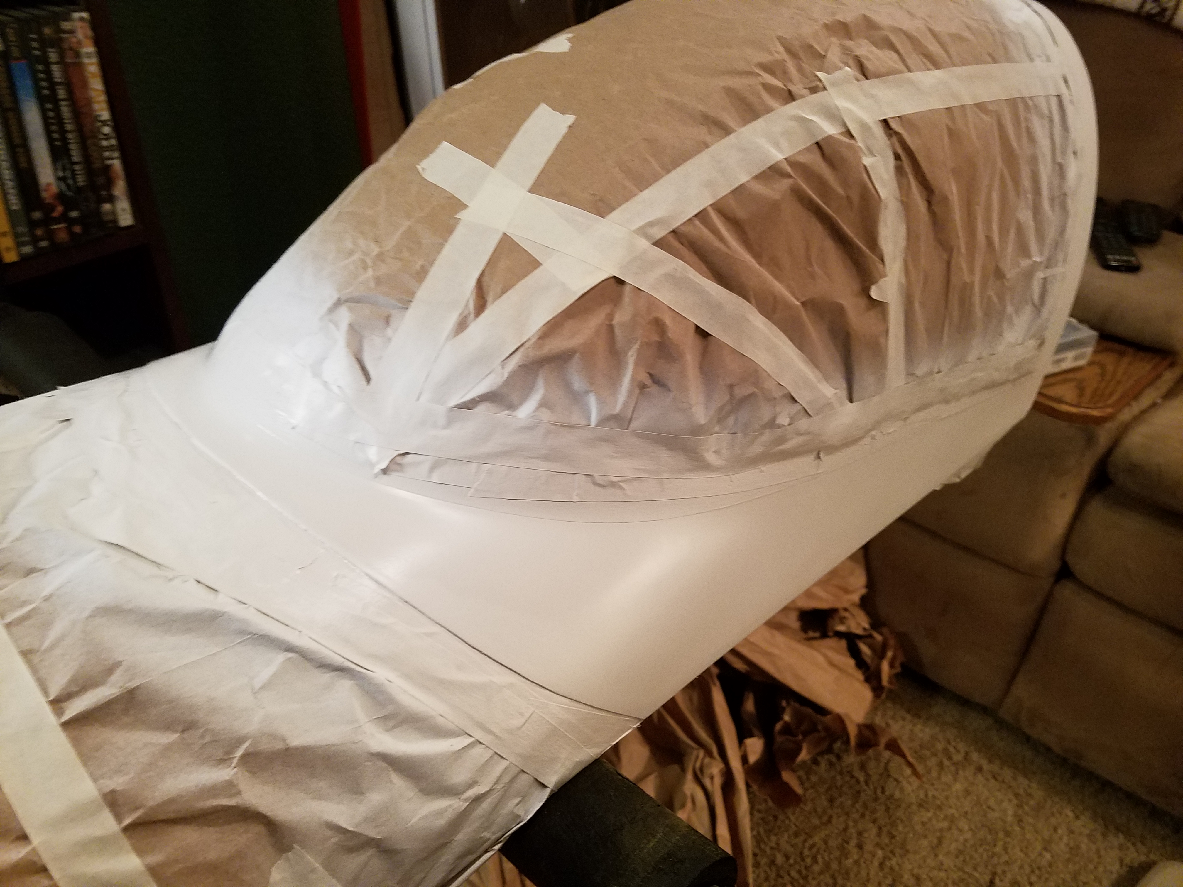

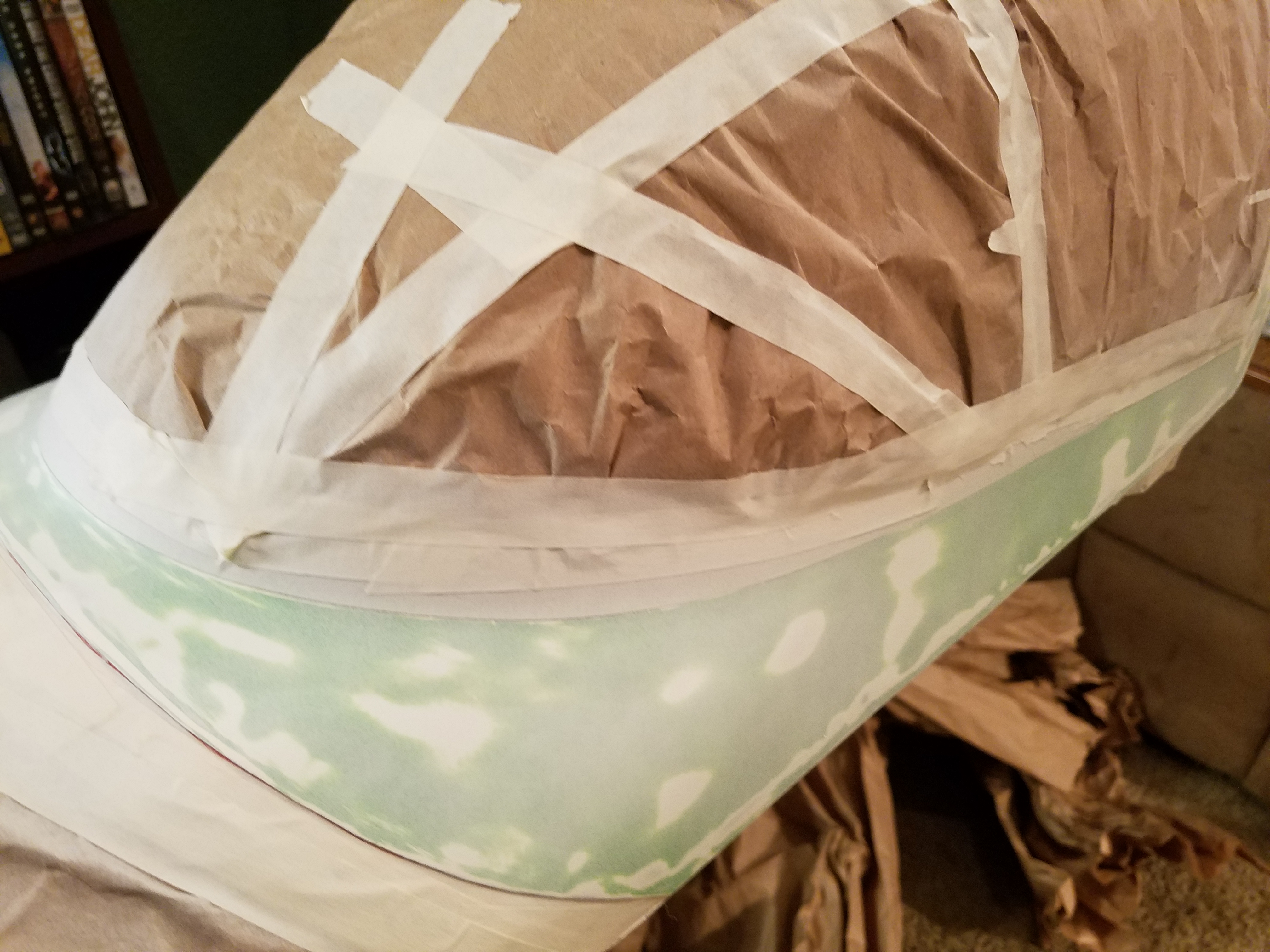

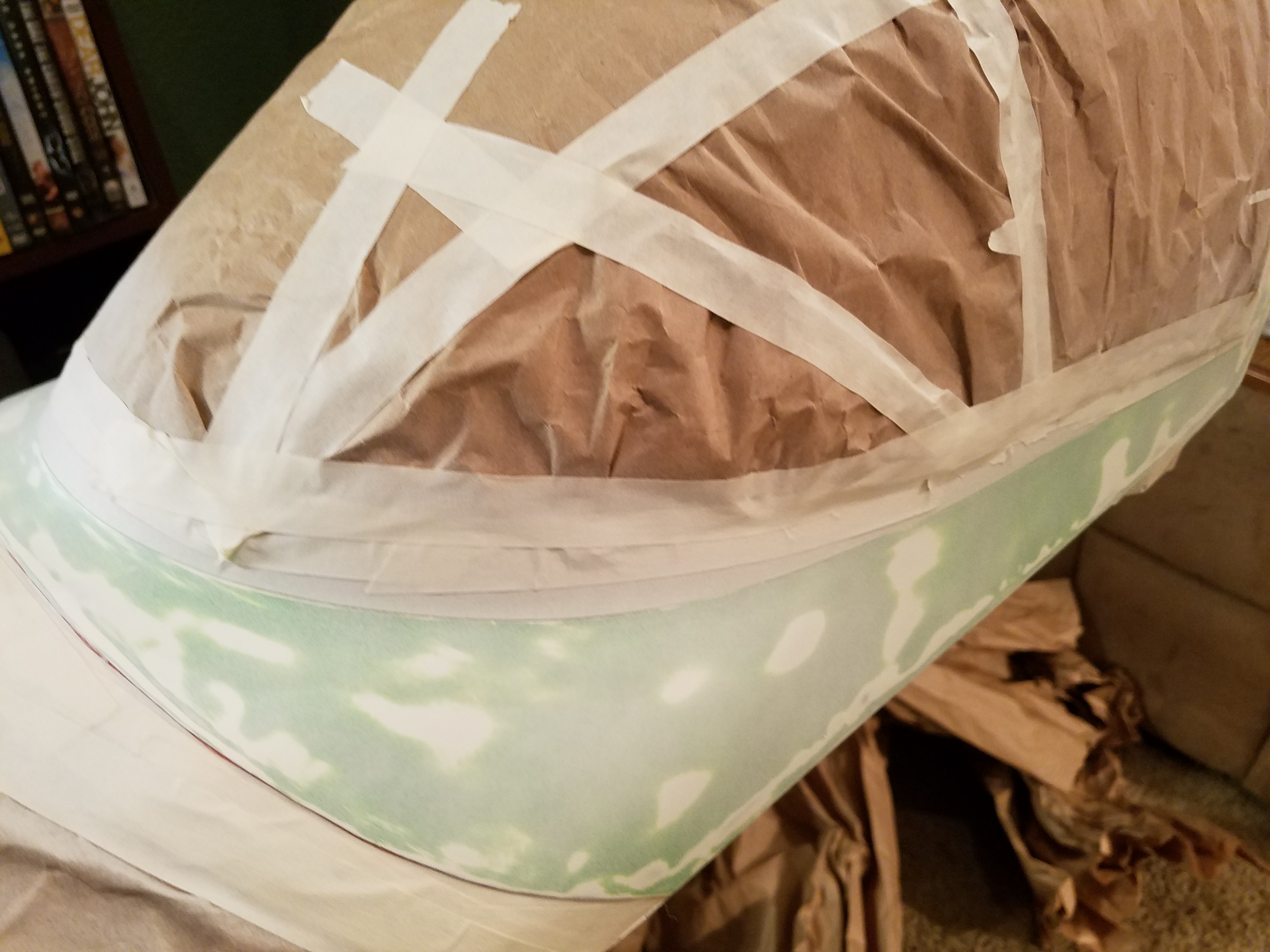

Masked off and ready to shoot.

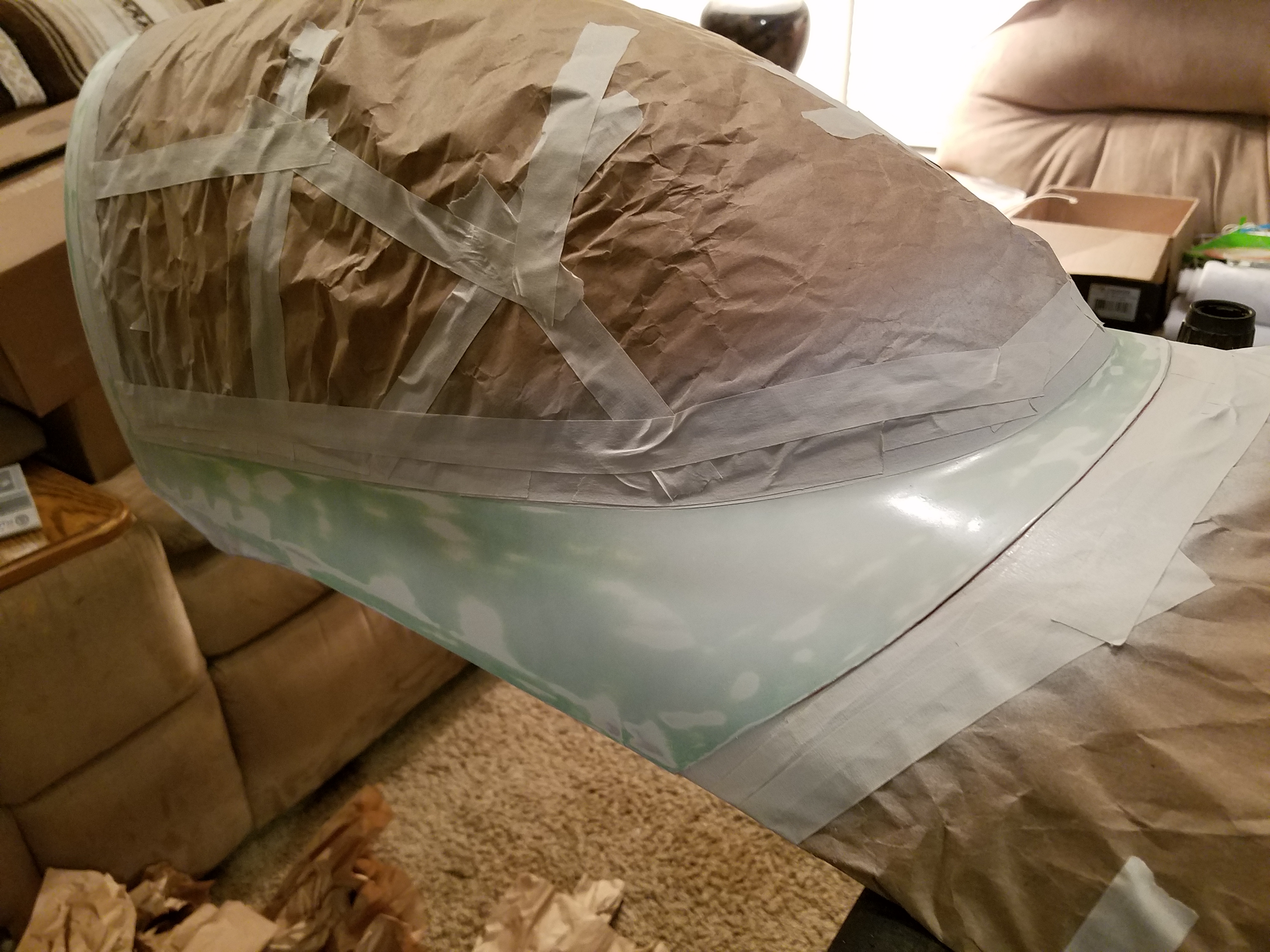

After the first shot of primer...

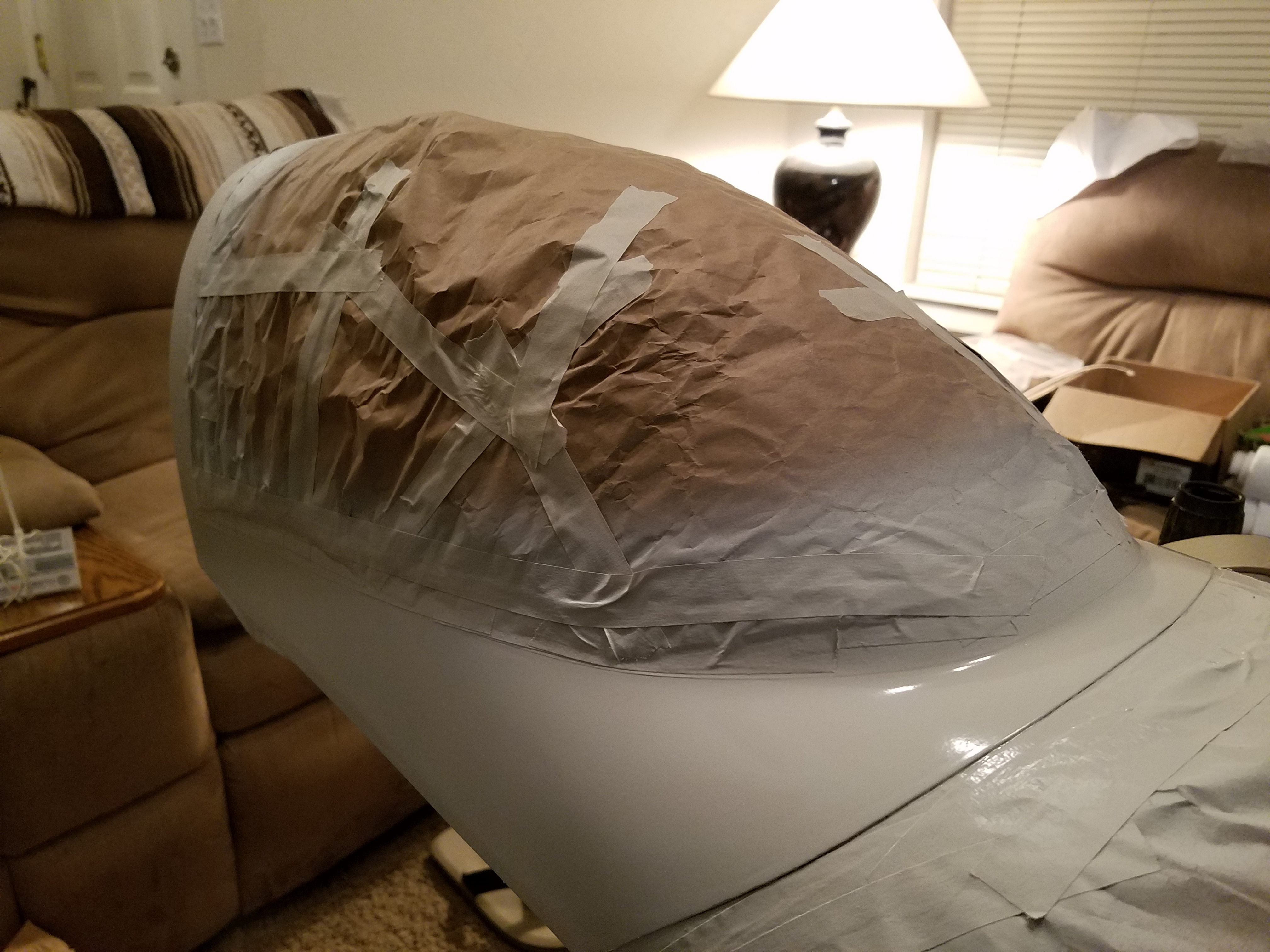

And after the second and then last coat of primer...
I have to reiterate a comment about the Wings West RC paint and primer that I made back when I built/painted the Jtec Pitts. This stuff goes on so good and so damned easy that it makes even a complete novice as I look like a 40 year veteran and professional. Not a single "damn it"! I hope the paint and clear coat goes on just as nicely.
