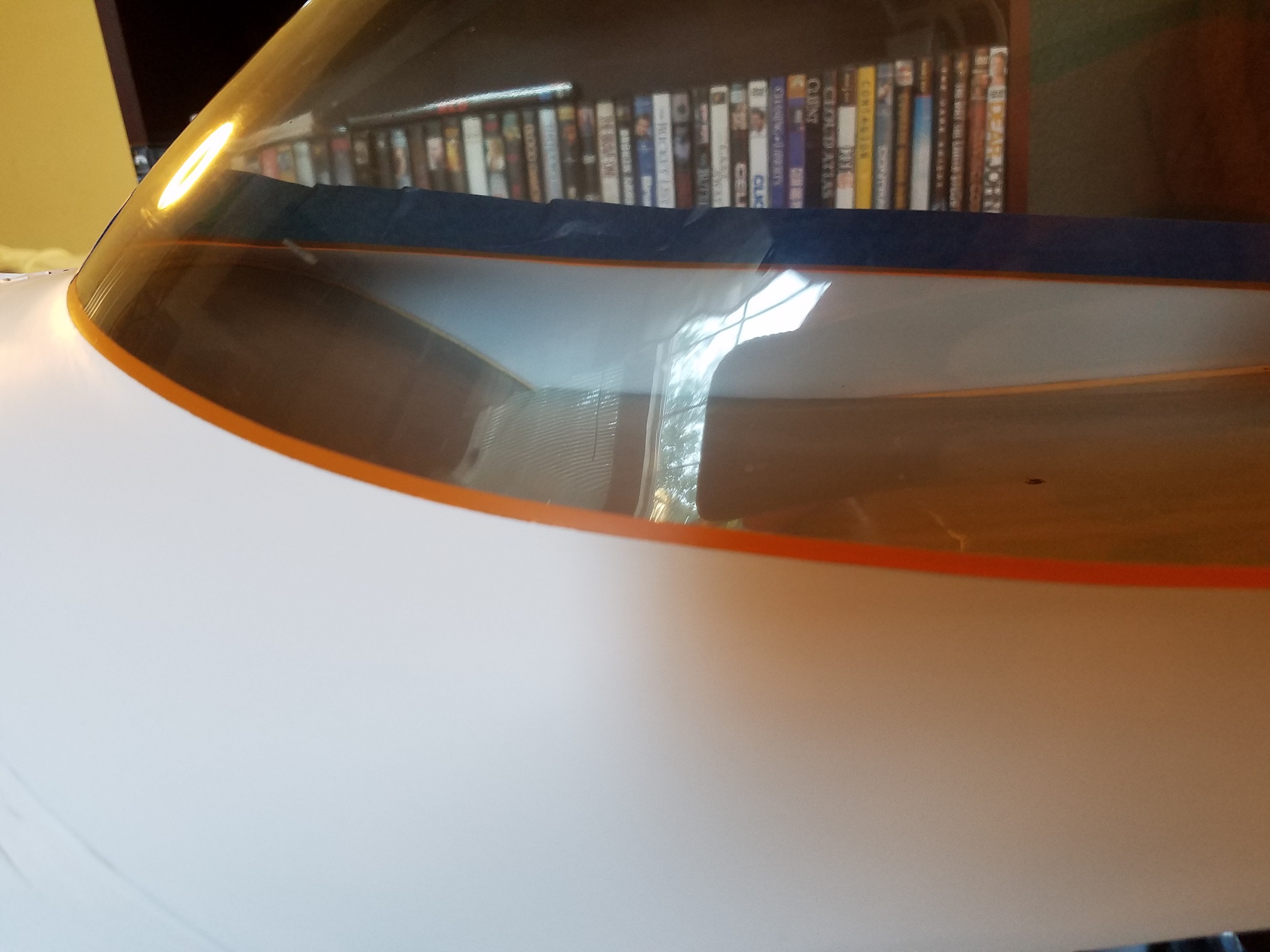

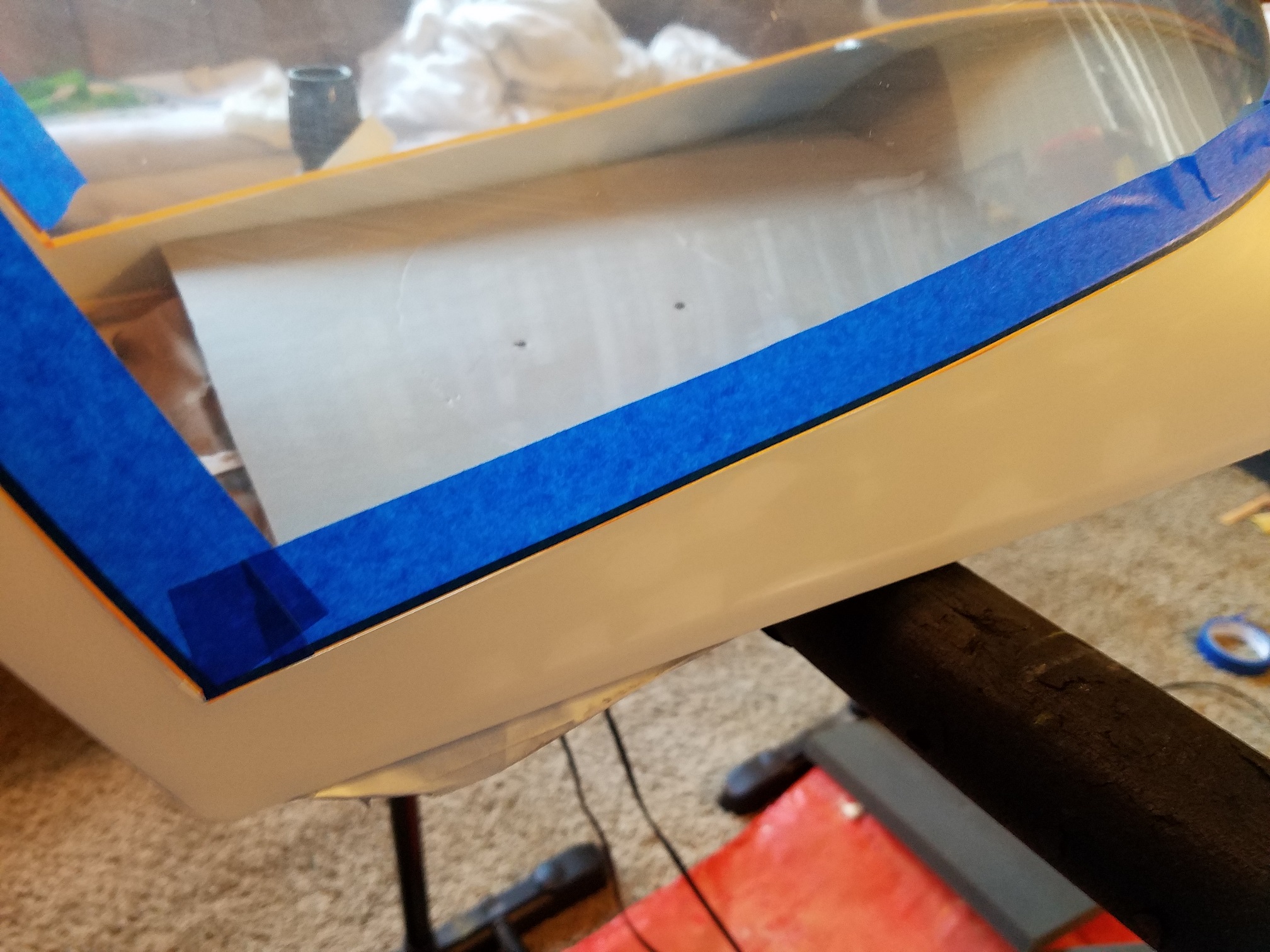

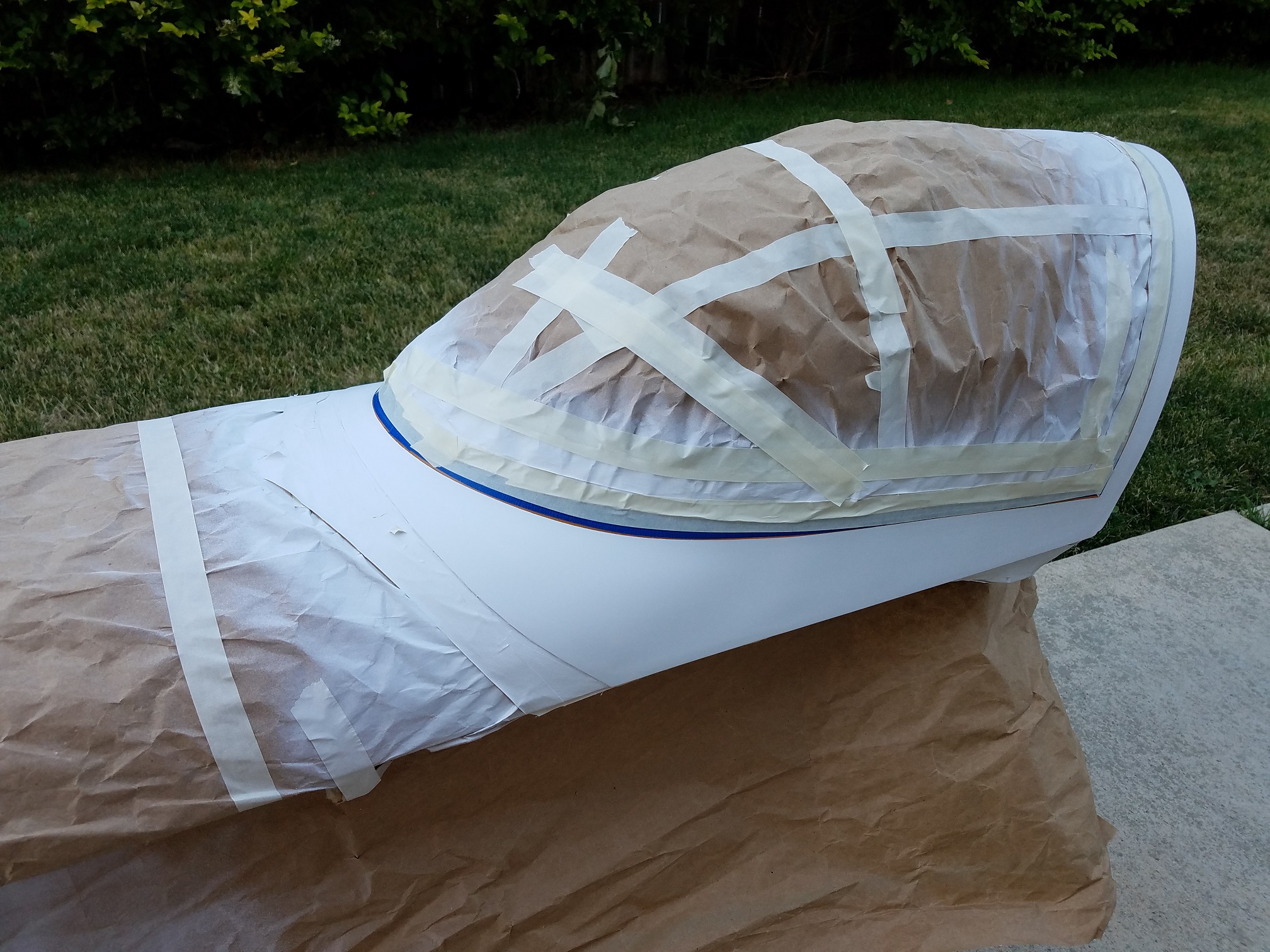

It looks as though I have become a painter. LOL. I have now gotten past phase two of this mind twisting endeavor of painting. First phase of getting the canopy prepped and primed. That came off great. Second phase of getting the canopy green. Hmm.... I think I quite like this stuff. It makes me work hard for a great outcome. And I have been learning a lot too. Stumbling along the way, but making progress. So, first thing to do was to get some "pinking' tape on the canopy. I just hate "bleed" lines. That is "after" I wet sanded the primer with 600 grit wet/dry. I was assured from WWRC, that sanding the primer to get a babies butt smoothness was ok. So... I did. LOL

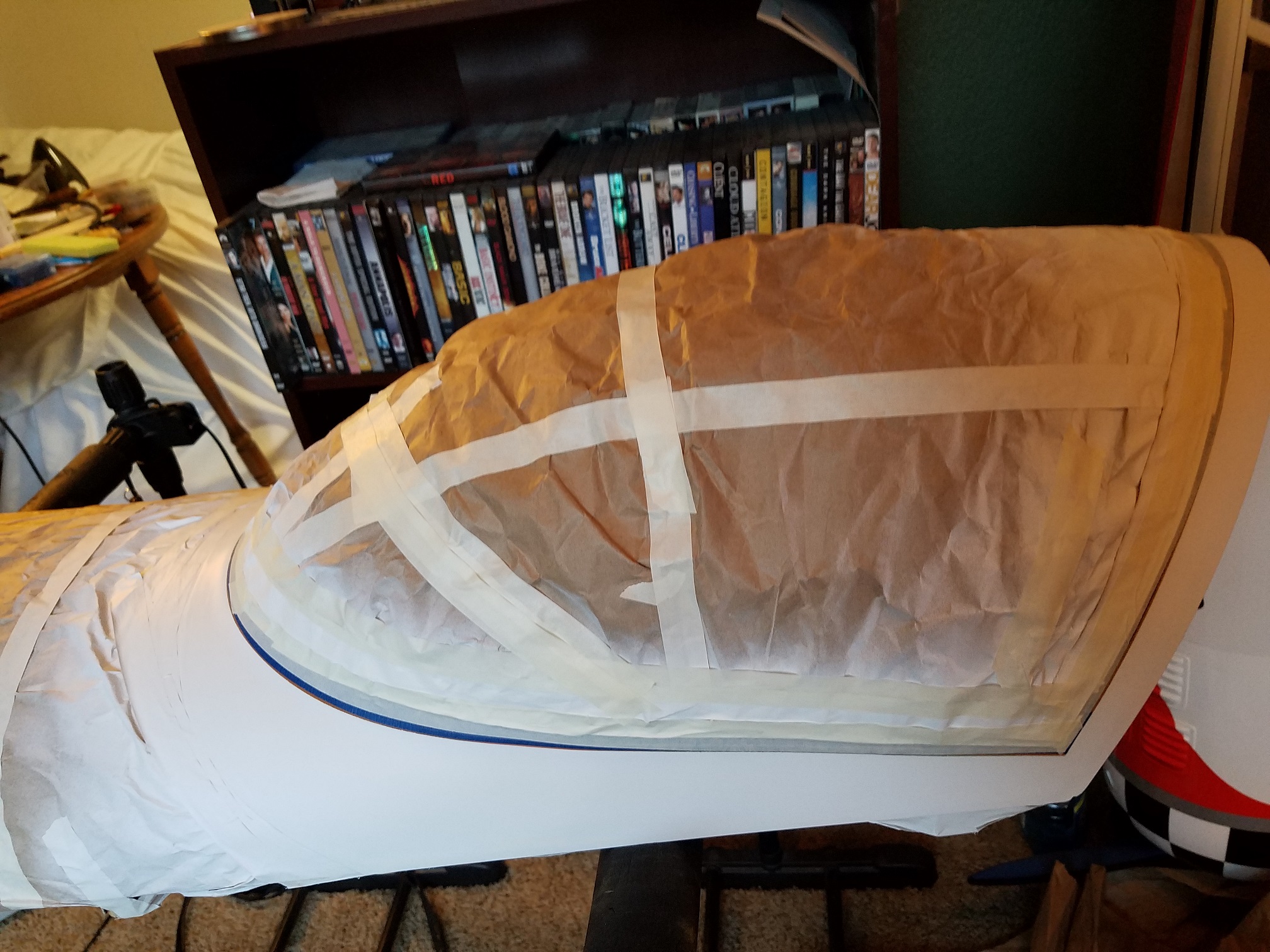

Next, barrier tape over the top of the pinking tape.

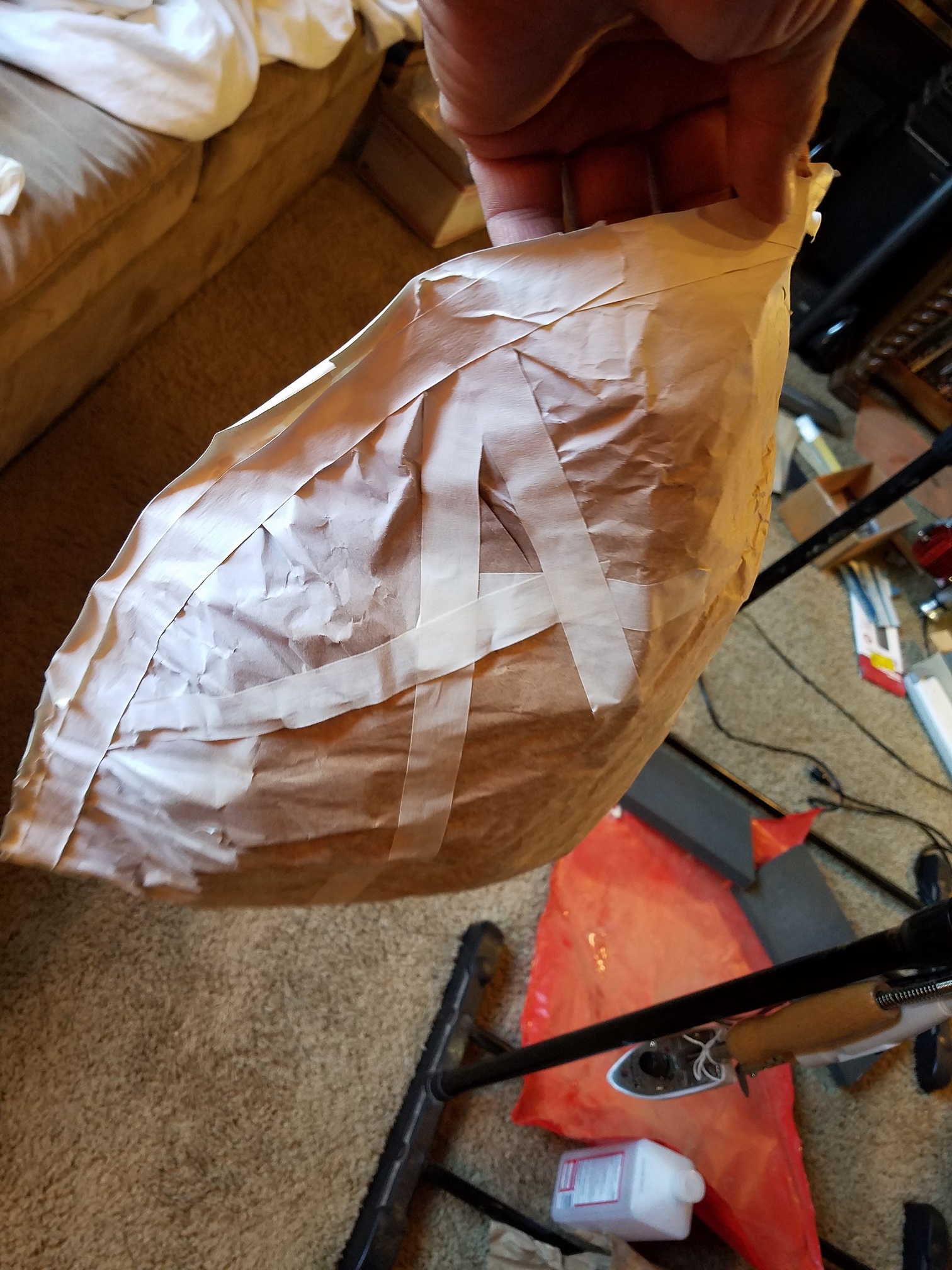

And here we have yet another lessons learned. When I painted the canopy on the Pitts and the replacement canopy on the Behemoth Yak (2), I threw away the protective paint bonnets between priming, painting and clear coating process. Not this time.
With the bonnet replaced and another strip of masking tape around the edges to keep it in place, I went to painting...

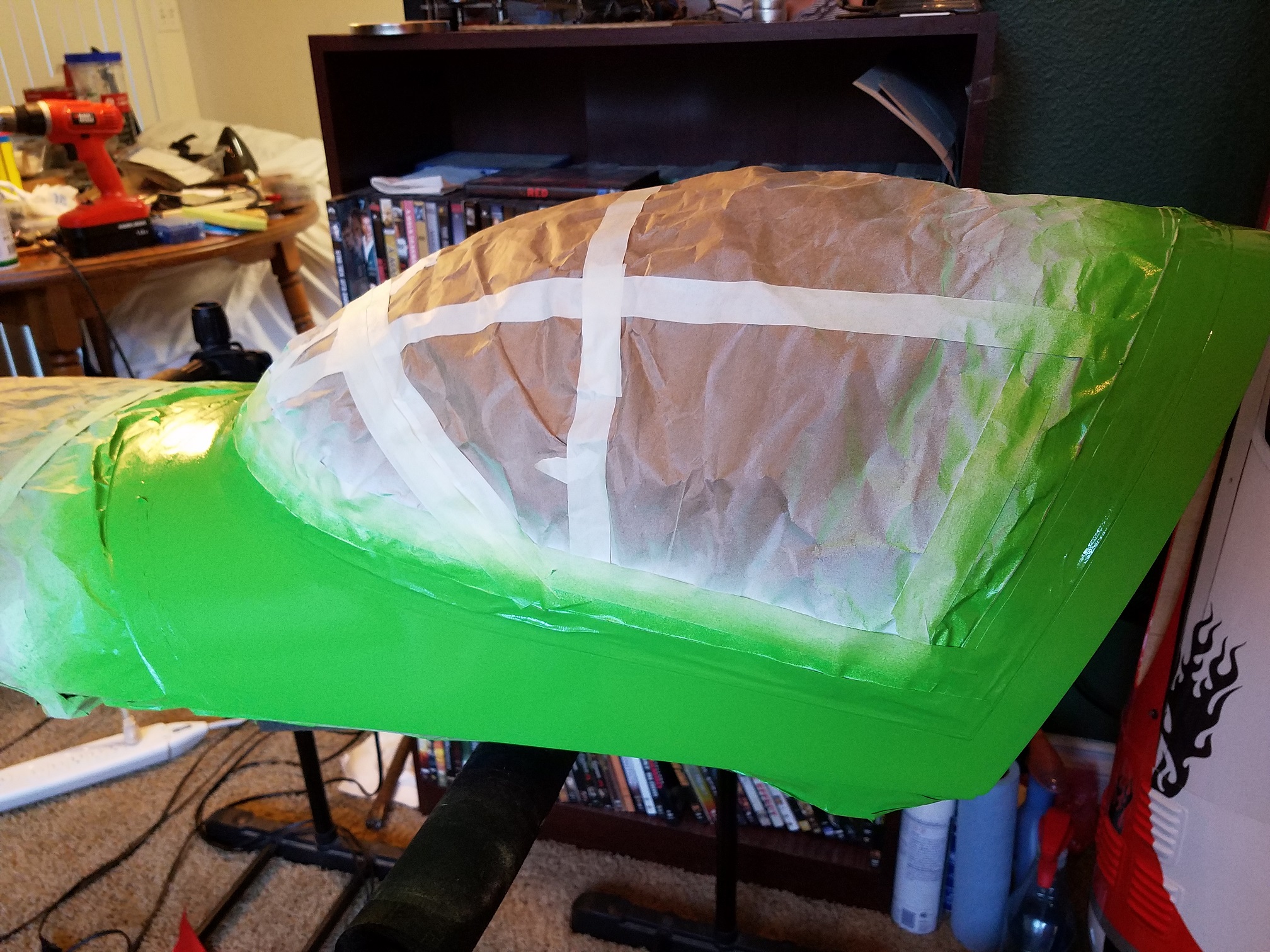

View attachment 104047 View attachment 104048

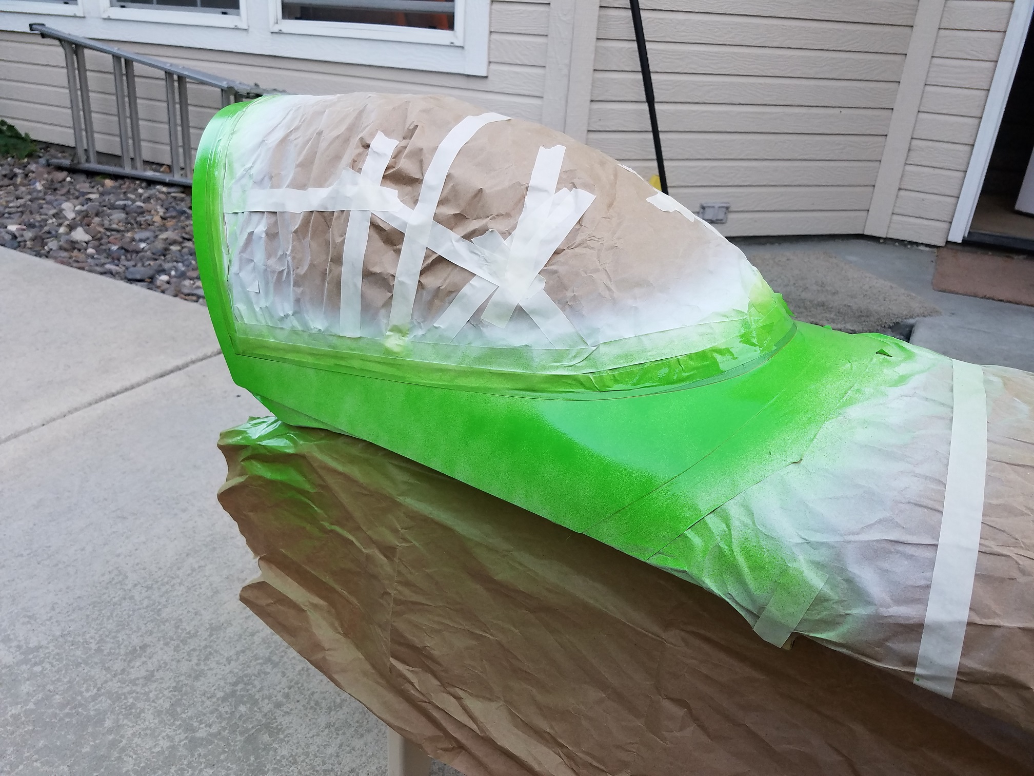

First coat of Apple Green paint applied.

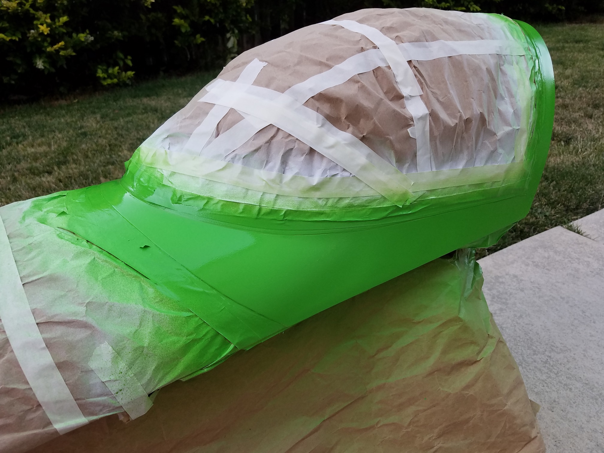

View attachment 104049 View attachment 104050
Two coats applied and the color is beginning to show...

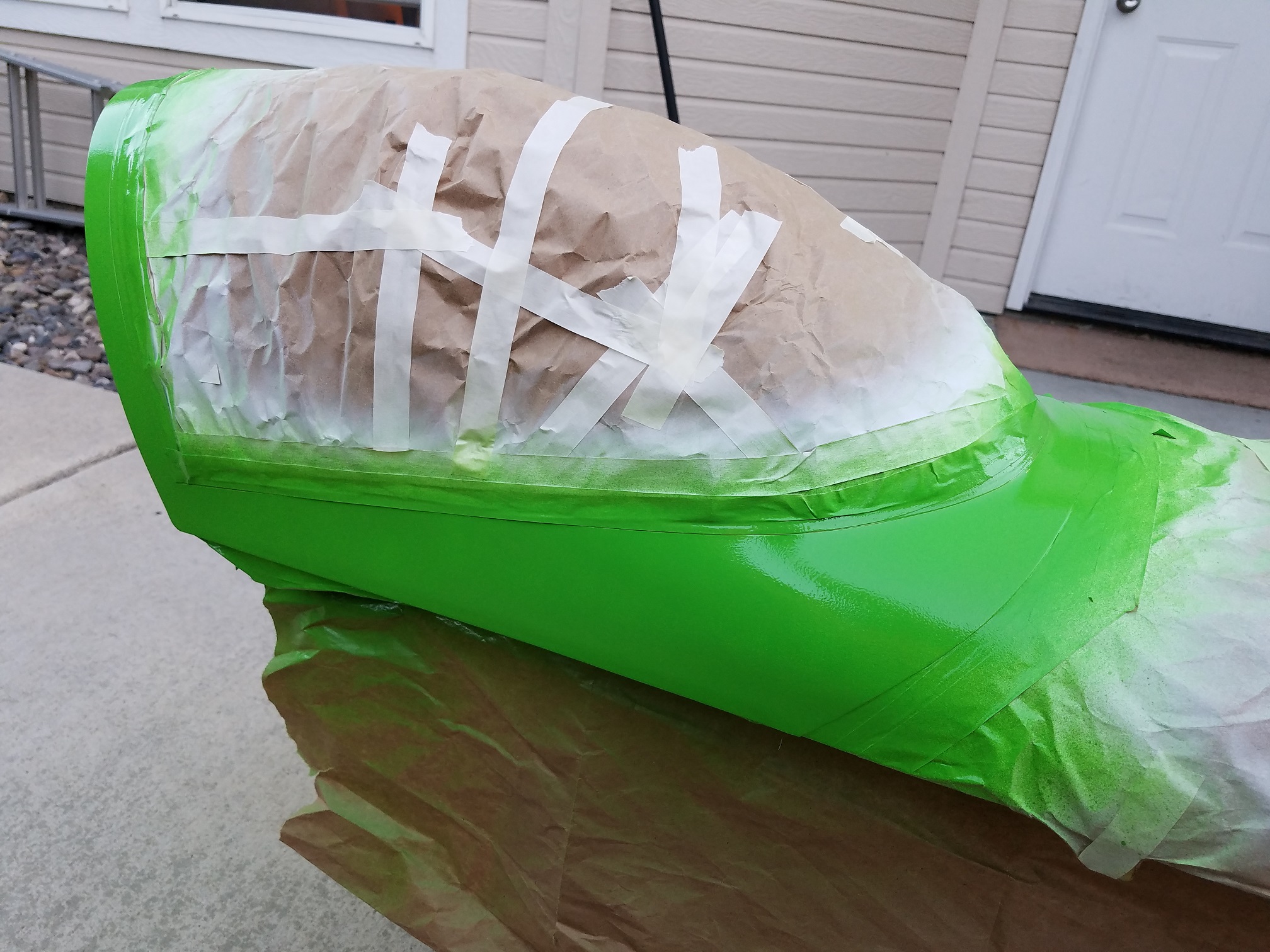

View attachment 104051 View attachment 104052

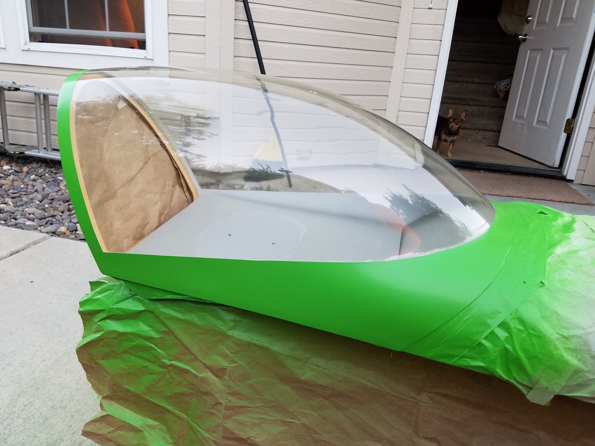

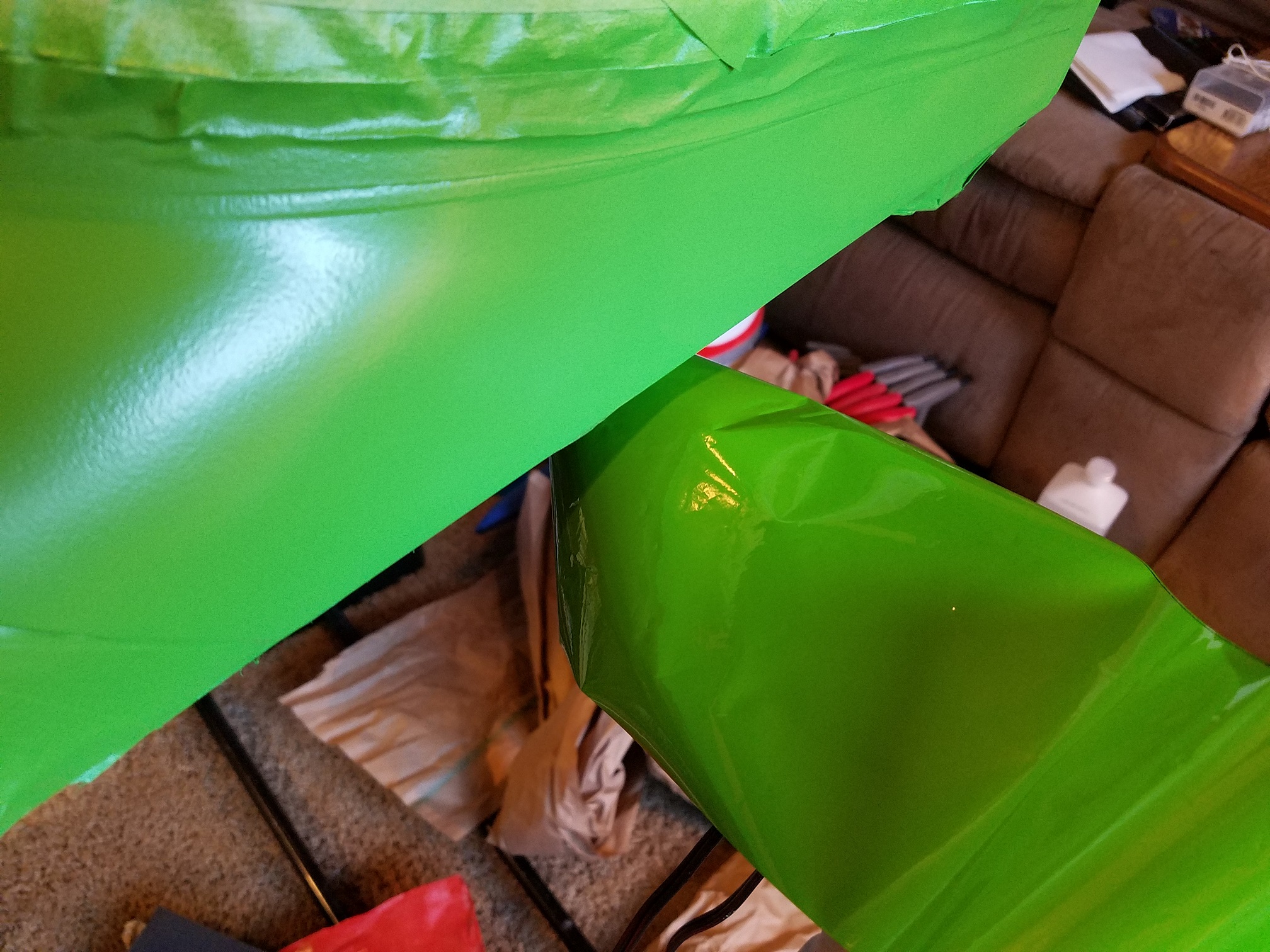

Three coats on and I think we are pretty close. Next to the scrap of Ultracote Apple Green, it is really looking pretty close. Maaaaybe….one more coat?!?

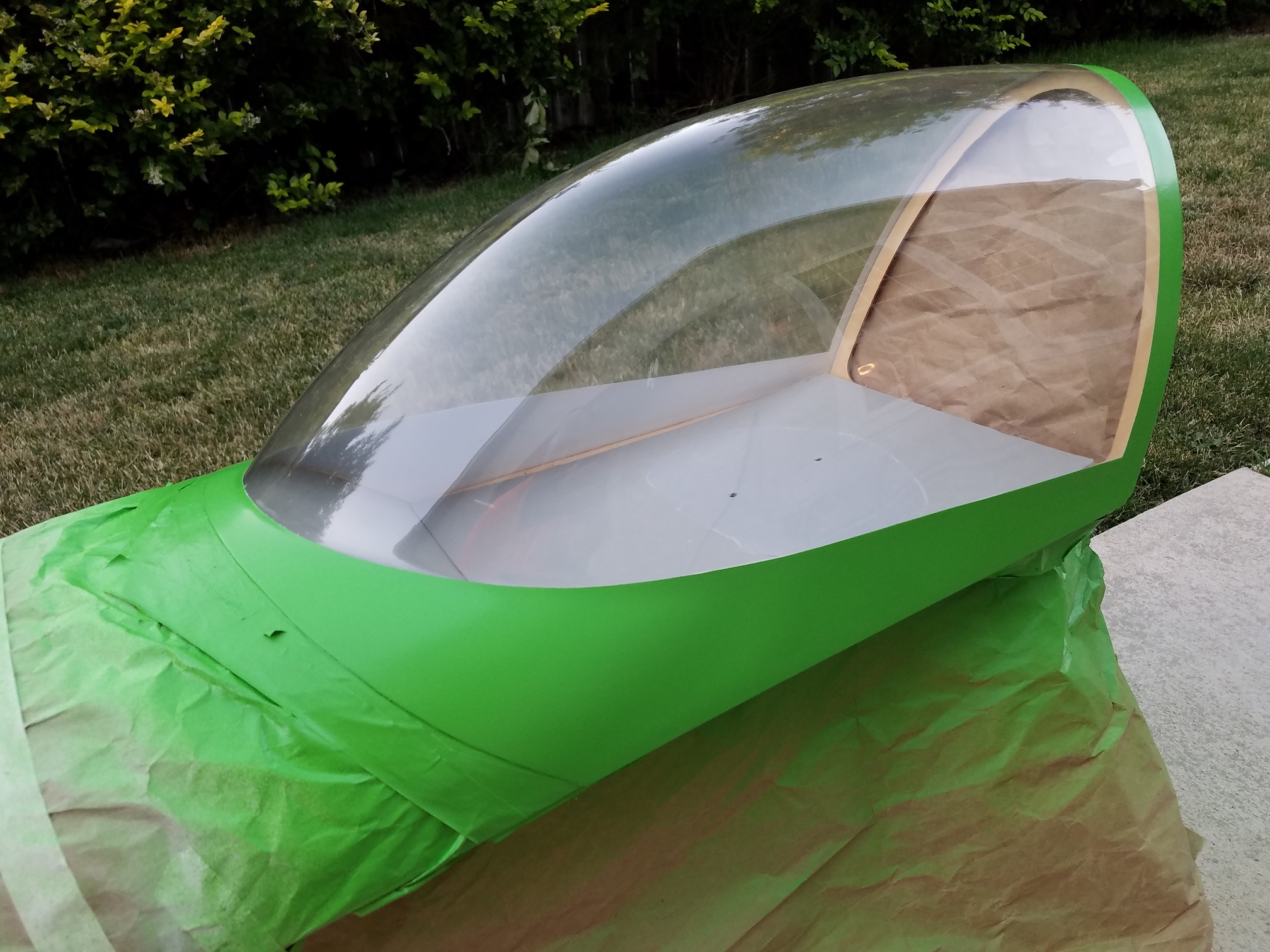

Yup, I think that is it! The paint will not "sheen" up and match perfectly until the clear coat is applied. But I think we are pretty darn close. I am not going to go any deeper with the paint. Four coats looks like it will be just enough.
I removed the protective paint bonnet and all the tape. I will let the canopy cure really well before I shoot the clear coat. I will probably shoot both the canopy and the cowl at the same time. The catalyst activated clear coat will not keep long enough for me to shoot the canopy then work on the cowl and get it ready for primer and paint. So for now, we will just let the canopy hide in a secure dust free, dark hidden place. (Under my stairs in the coat closet. LOL) Crazy thing about this paint, (Wings West RC) is that it doesn't look like it lays down smooth. It gives the impression of an almost "Orange Peel" effect. But true to their word, Wings West states that once the paint cures and dries a bit, it becomes smooth as silk. We all know the Pitts painting sage right? And once it was dried and the clear coat on, it was simply beautiful. Still is to this date. Looks as fresh and crisp as the day it was shot over a year ago. I am certain the 330 paint will turn out the same way.
