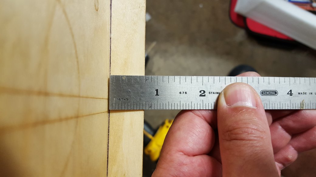

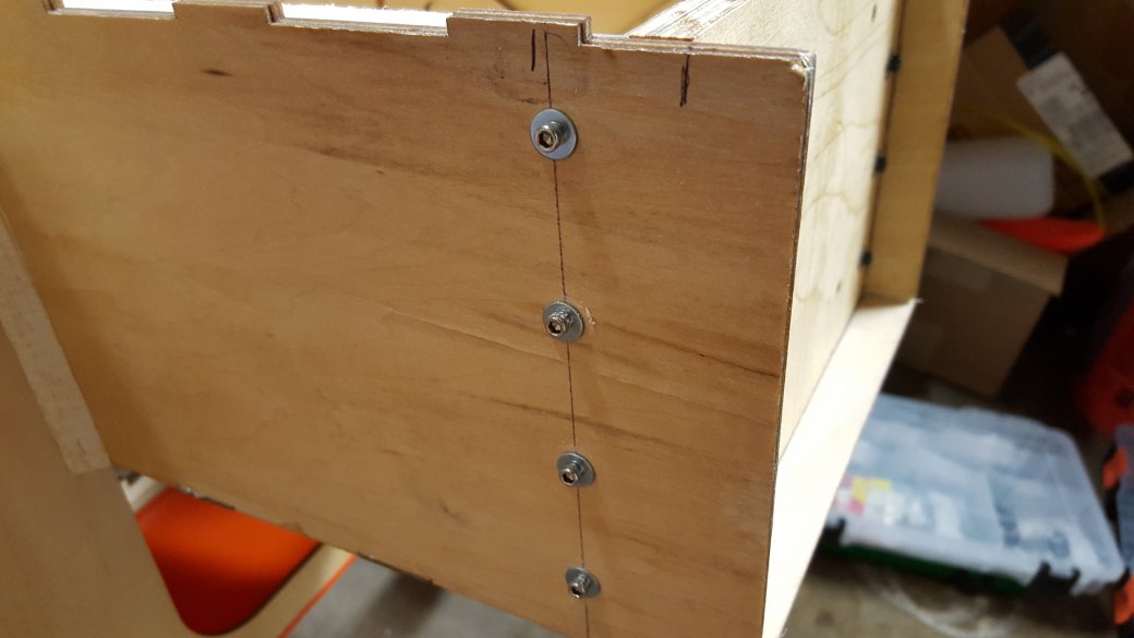

I decided I didn't want any spacers off the firewall (like on the H9 Sukhoi) so I measured 1/2" in on the motorbox sides and bottom and marked that:

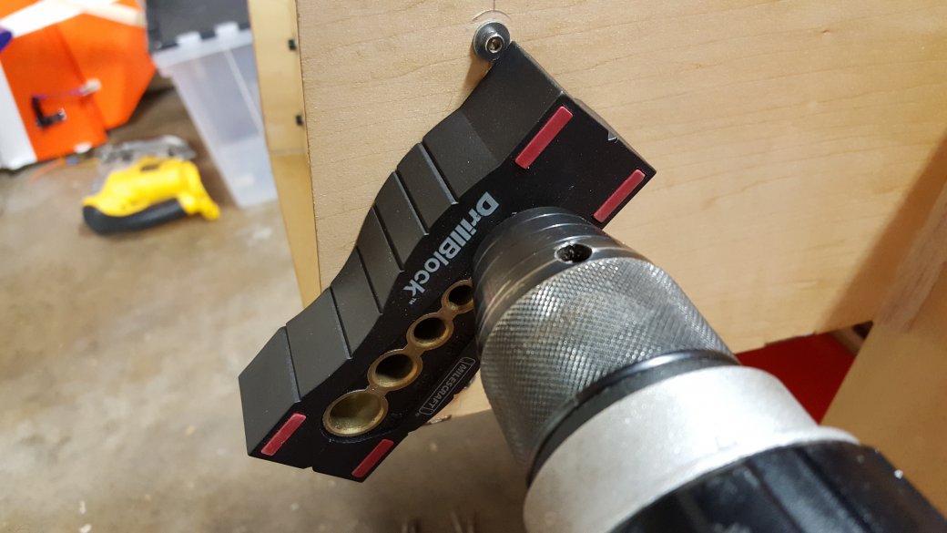

Then I lined up the firewall there and bolted it on. I used my fancy drill block to keep the holes straight:

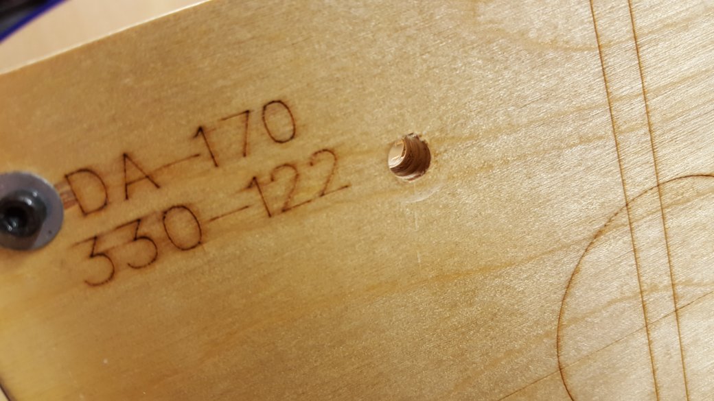

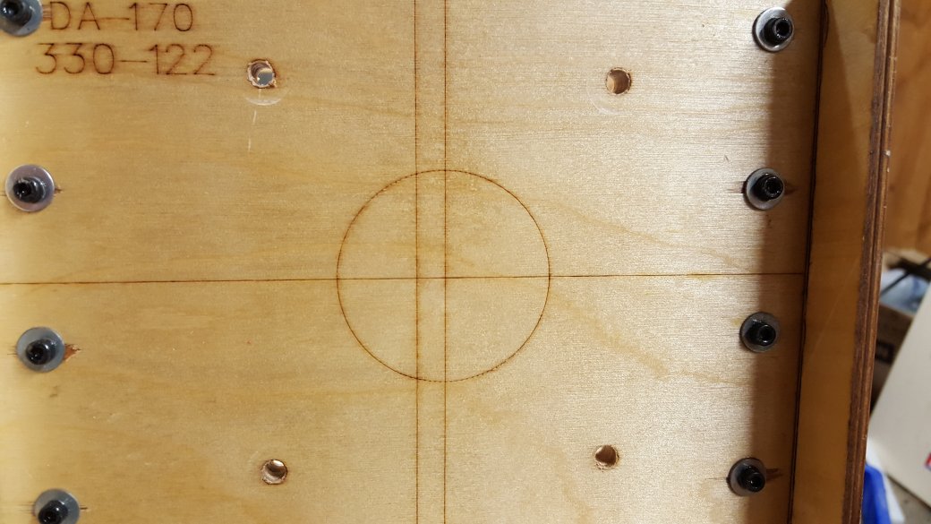

I drilled pilot holes for the pilot holes, haha, and was pretty accurate drilling the Pilot RC laser marks for the DA-170.

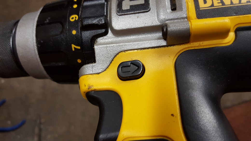

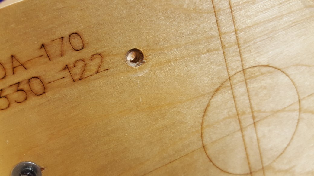

Once you have your pilot hole you can run your drill in reverse to start your final hole and it will keep the wood from getting splintered up. Then switch to normal drilling direction and finish the hole off. You can start it in reverse on each side of the hole for a nice clean result:
Final hole after reversing trick:

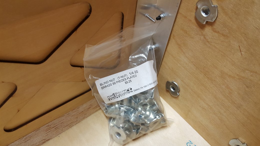

I used 1/4-20 blindnuts for the engine bolts:

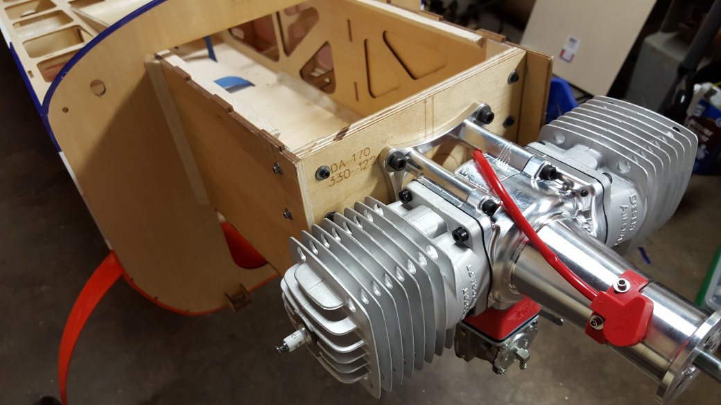

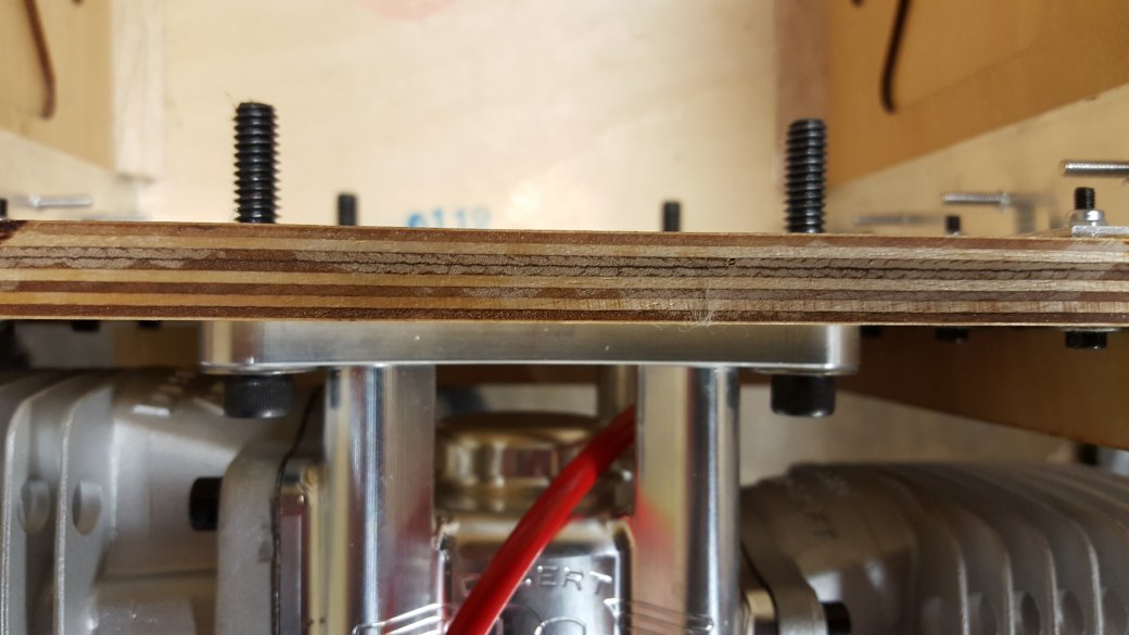

I trial fitted the motor without gluing in the firewall:
The Pilot manual said to space out the engine 1/4"-1/2", but I went with an 1/8" for looks. :sneaky:
Also, I wanted to make mention of the material used for the firewall. It's much harder and has many more layers than either the H9 Sukhoi or AW Yak. It has at least 8 layers and is super hard. I usually epoxy in my blindnuts but I thought to myself, "no need."
