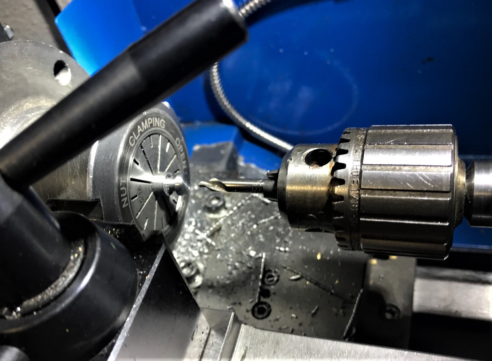

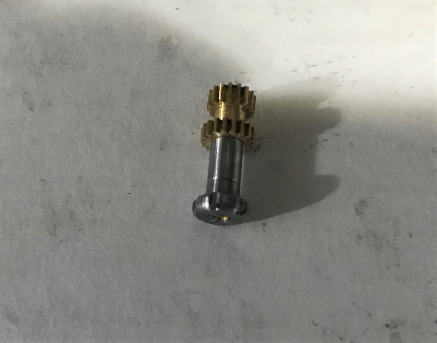

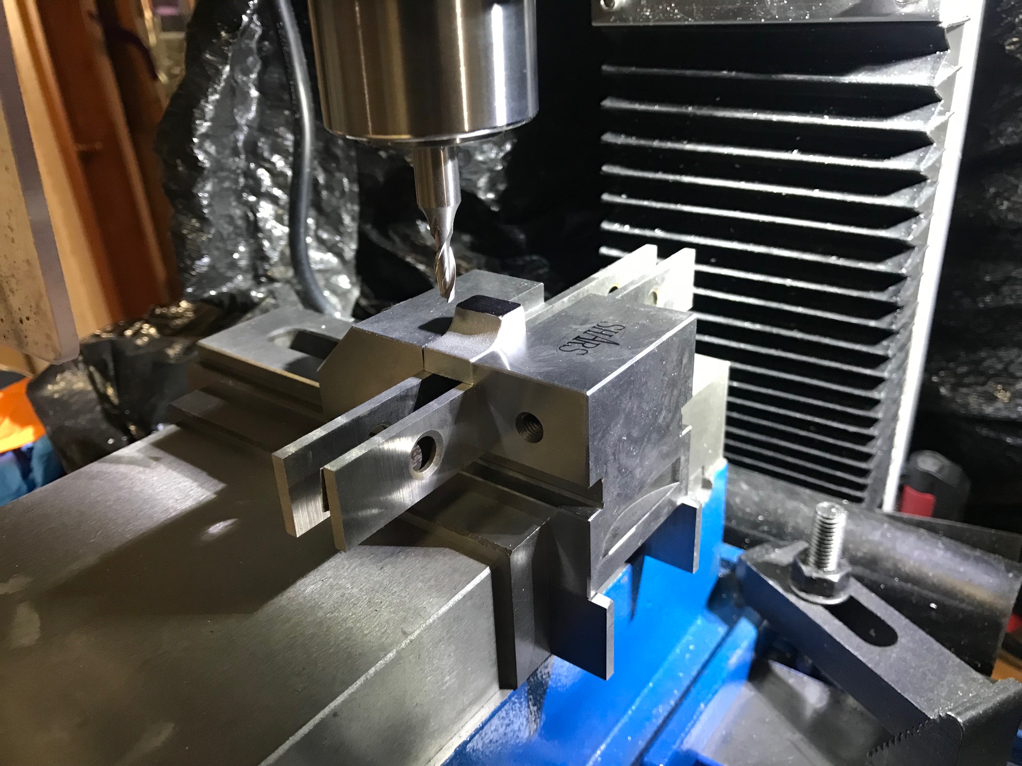

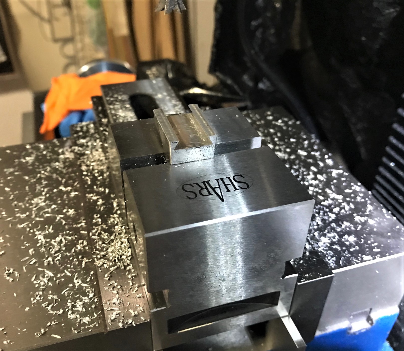

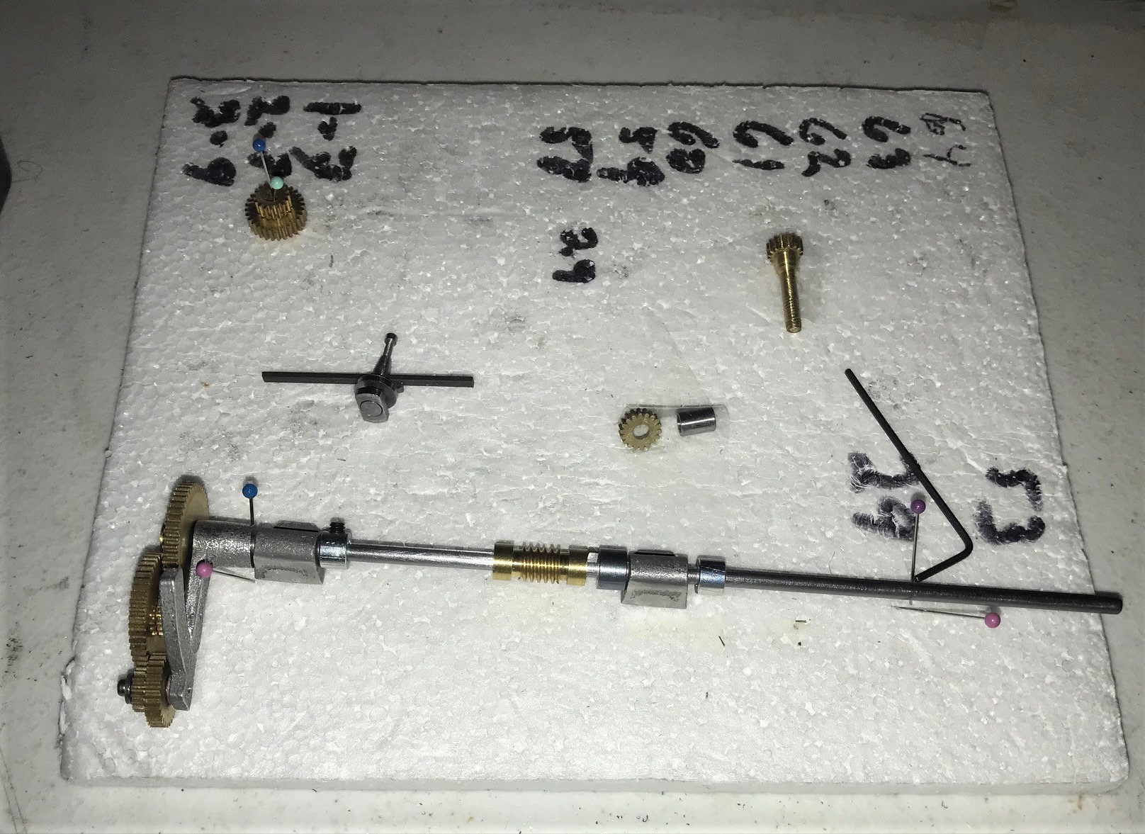

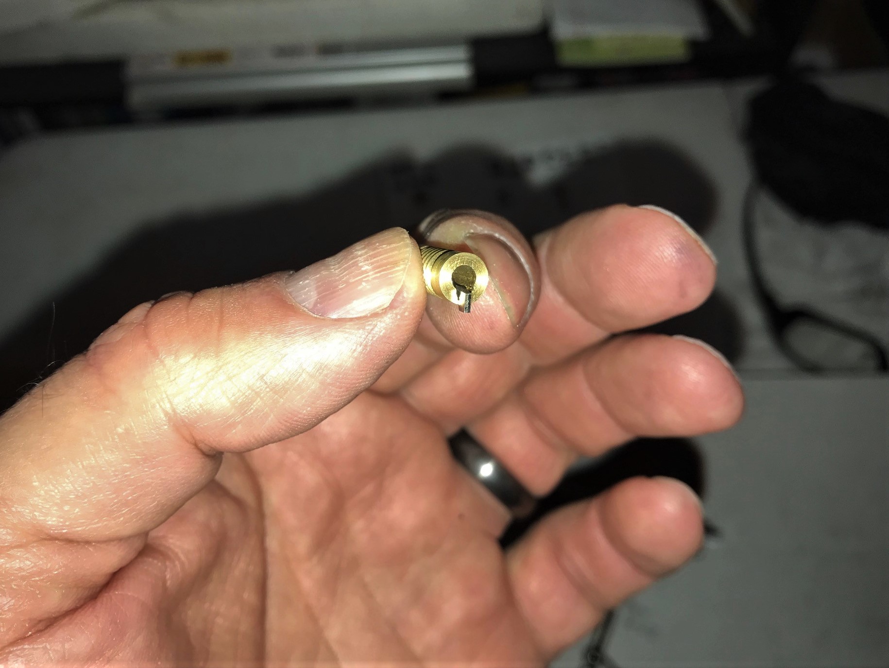

Got some work done on the tool post and lead screw components.

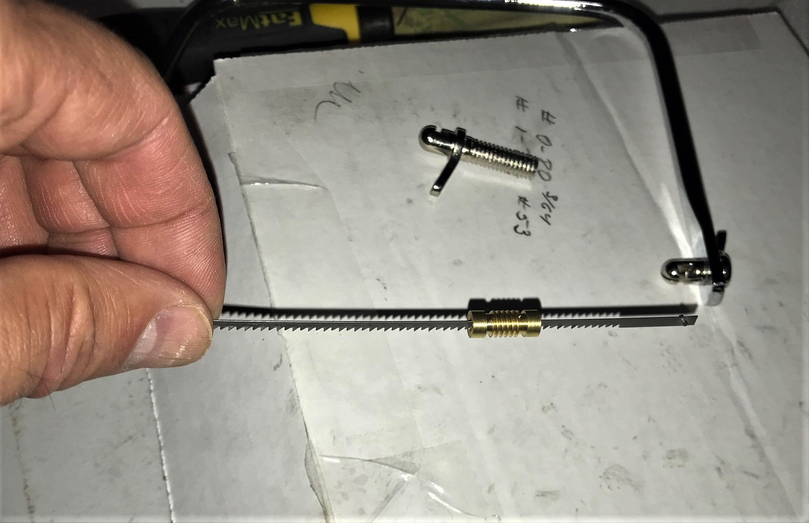

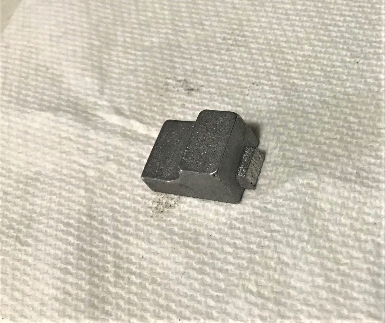

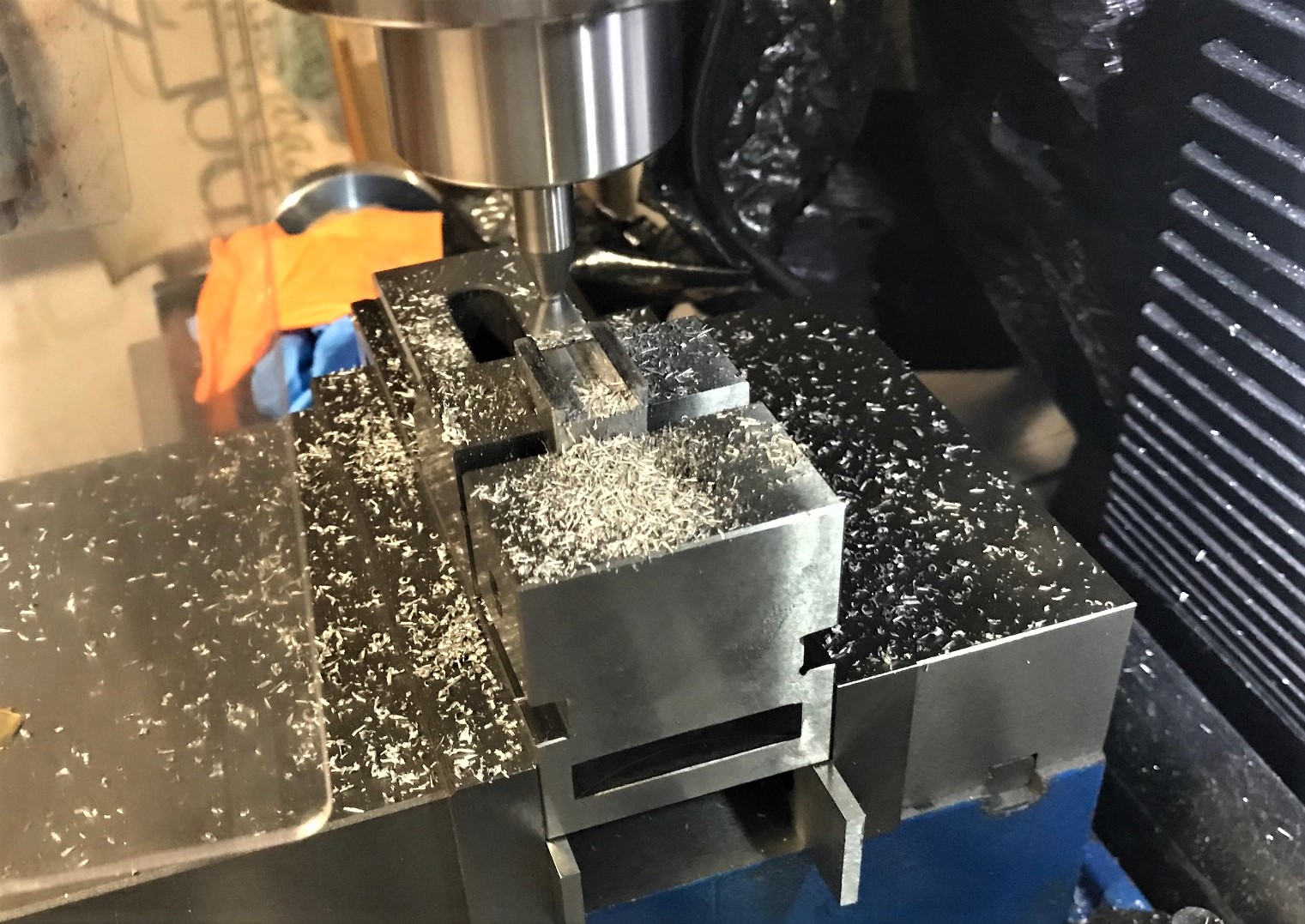

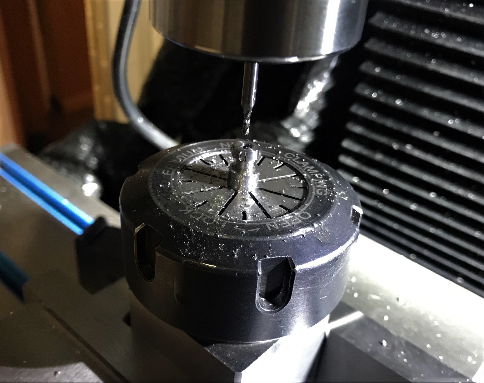

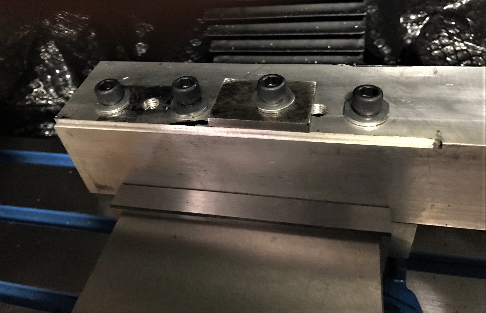

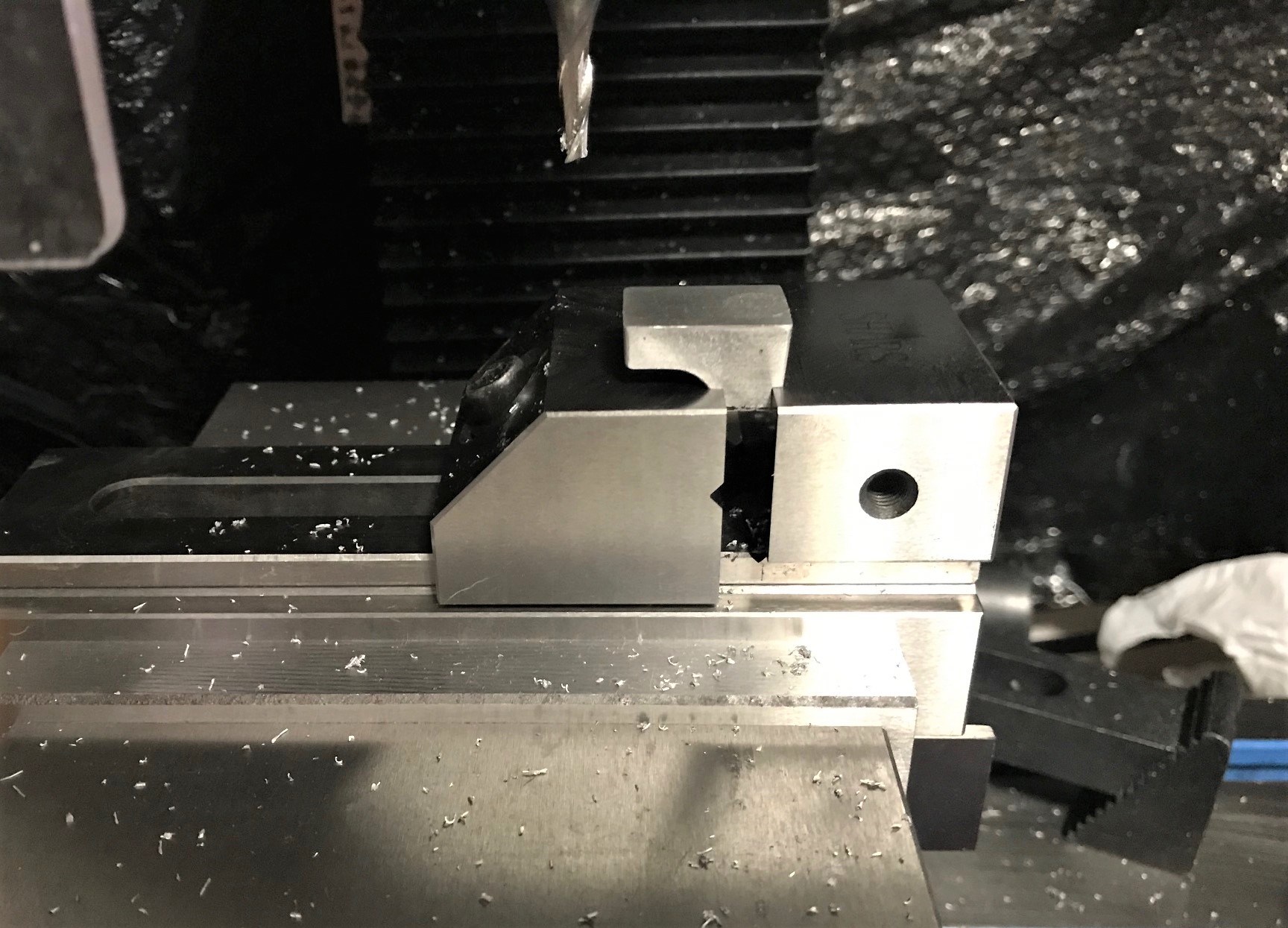

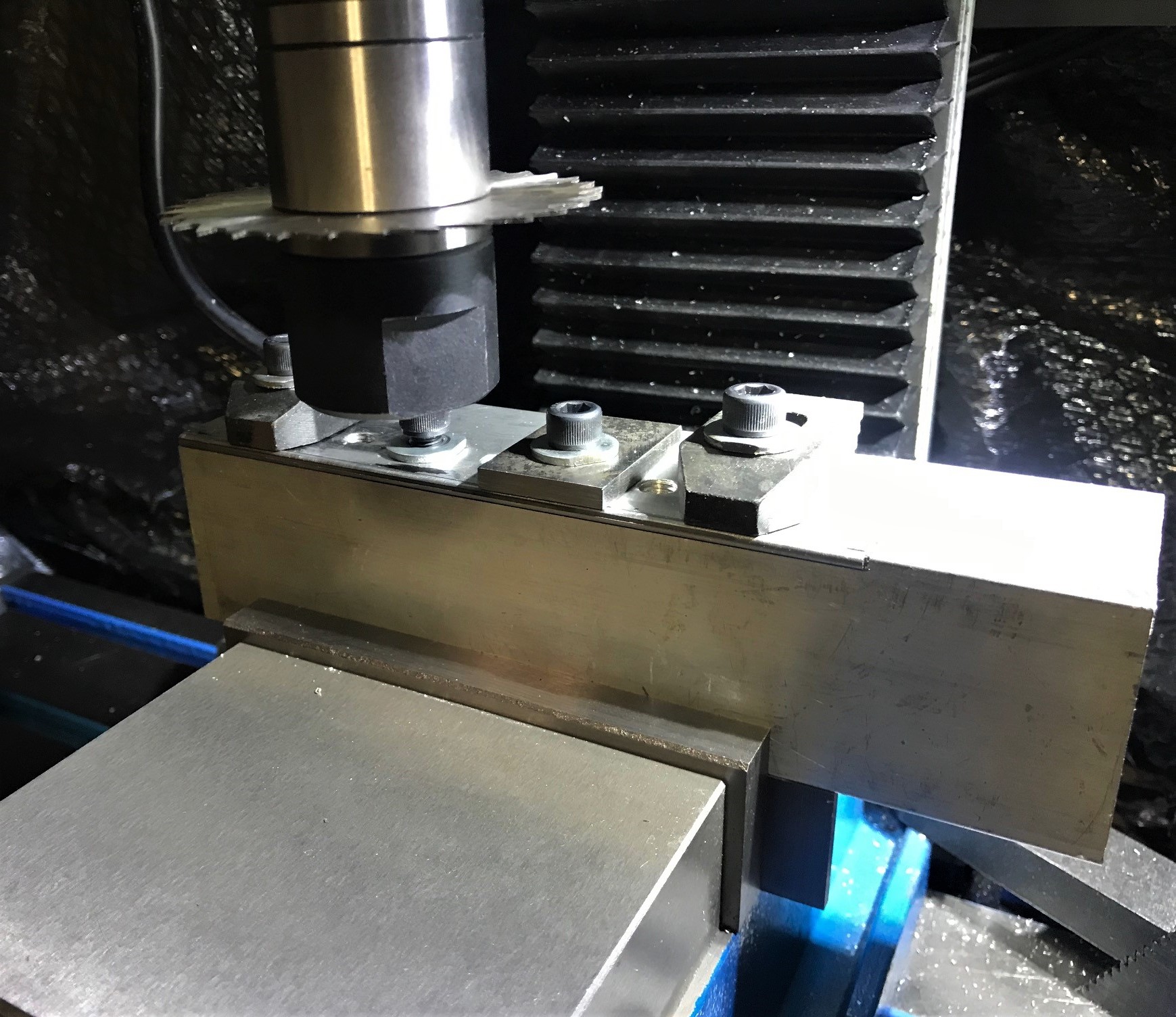

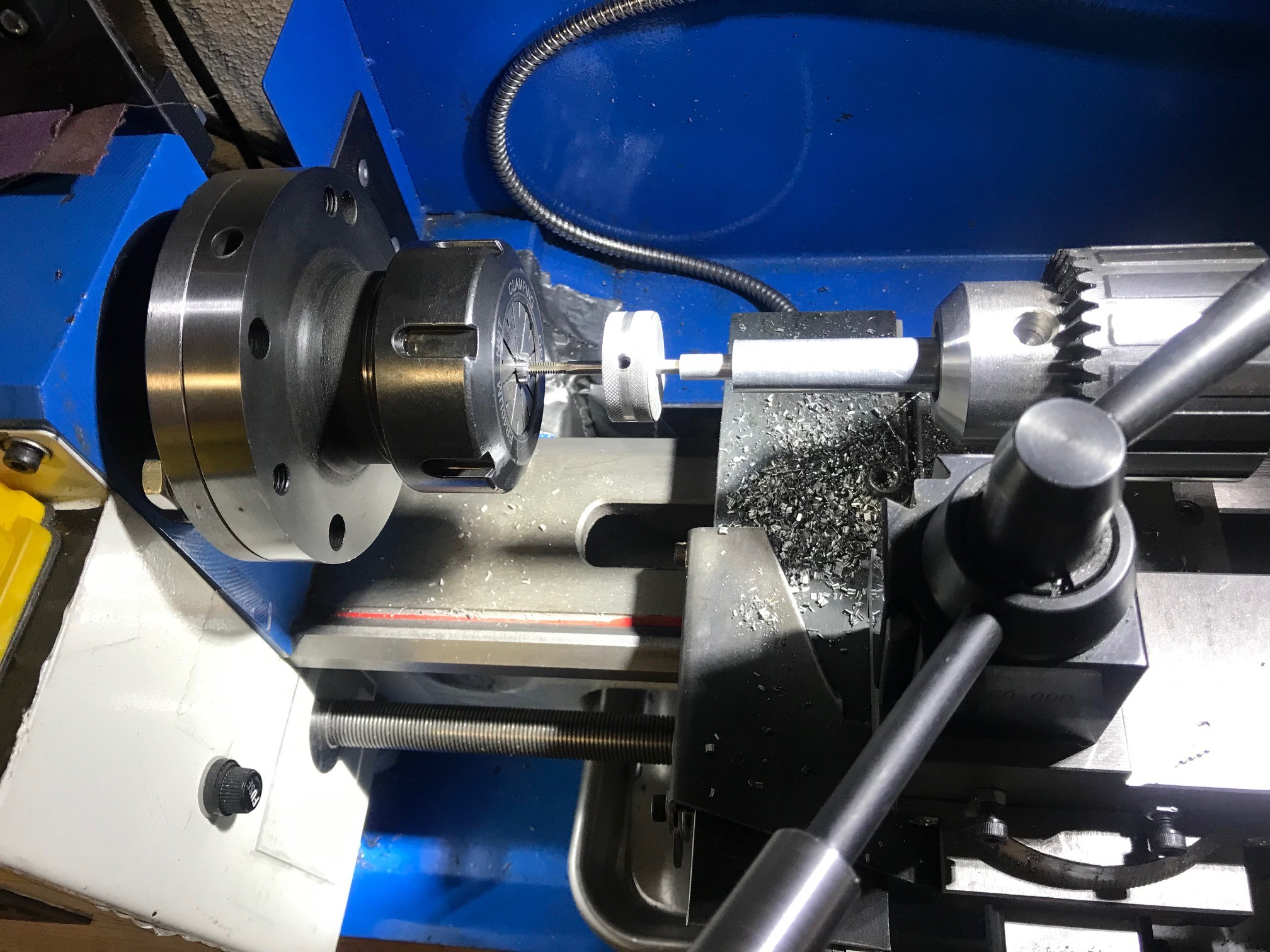

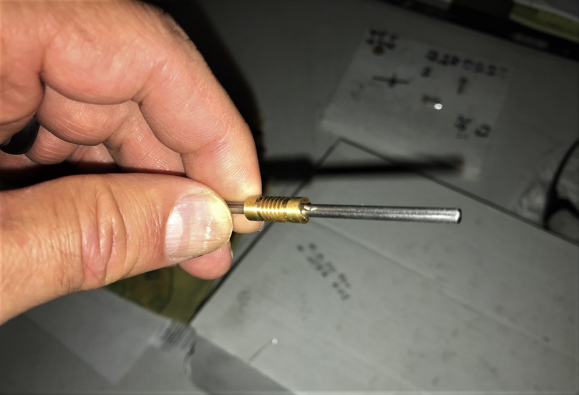

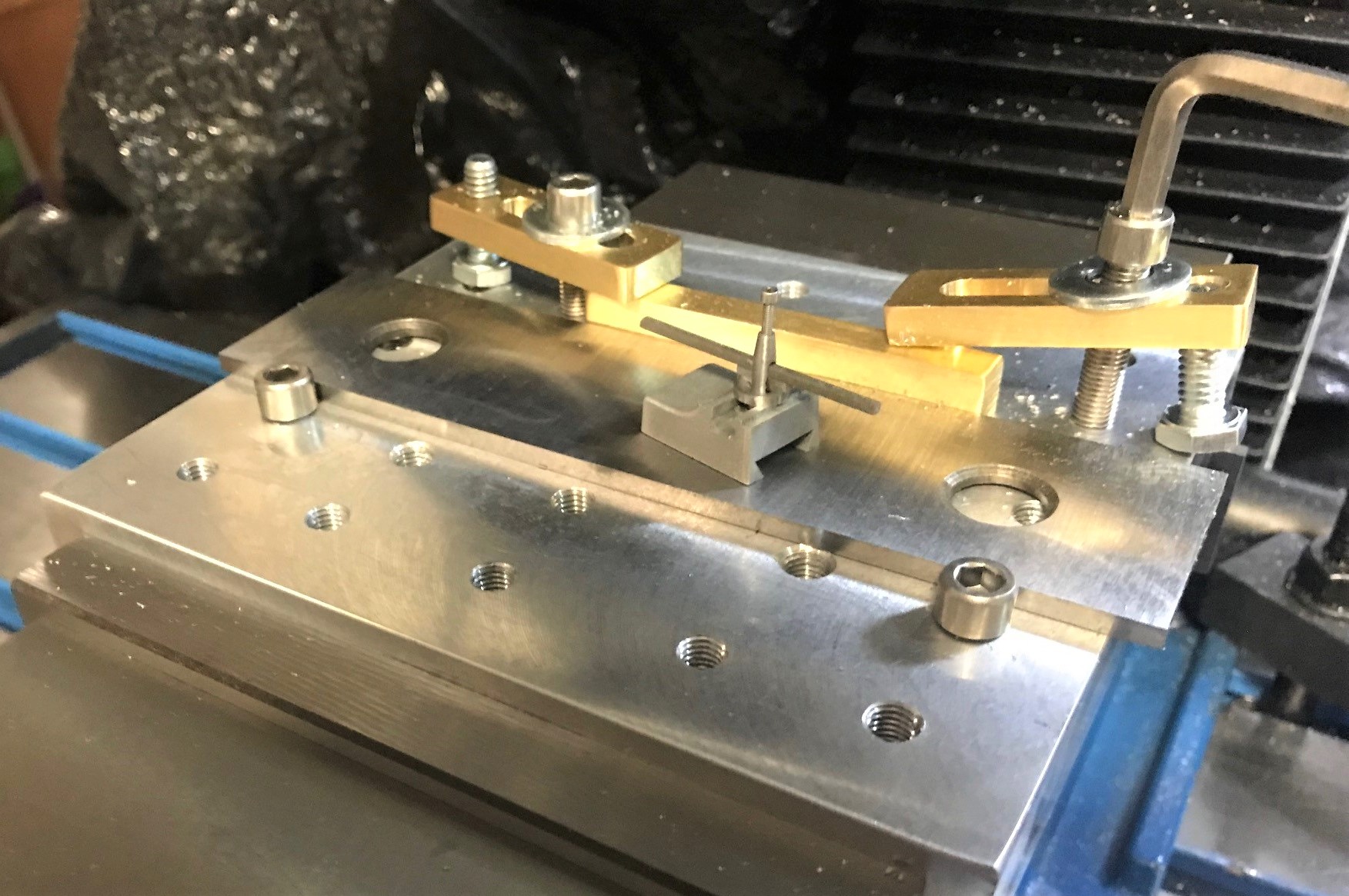

Hey Tony,
To cut the slit in the lead screw I used the same fixture I used on the lathe bed. I just cut a pinching groove in the side of it and clamped the lead screw in and cut it with a slitting saw. I used a coping saw to cut the groove in the worm gear you made, for the worm gear key. It worked out good. Your only dealing with a 1/32 on each piece.

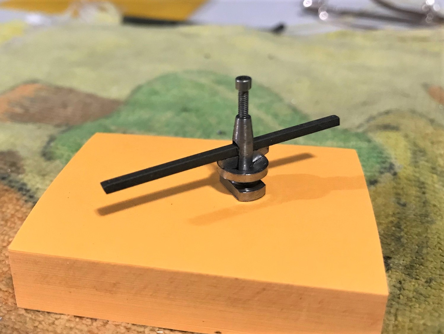

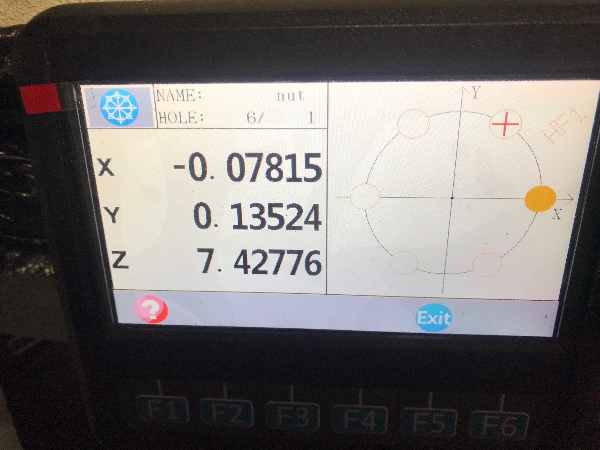

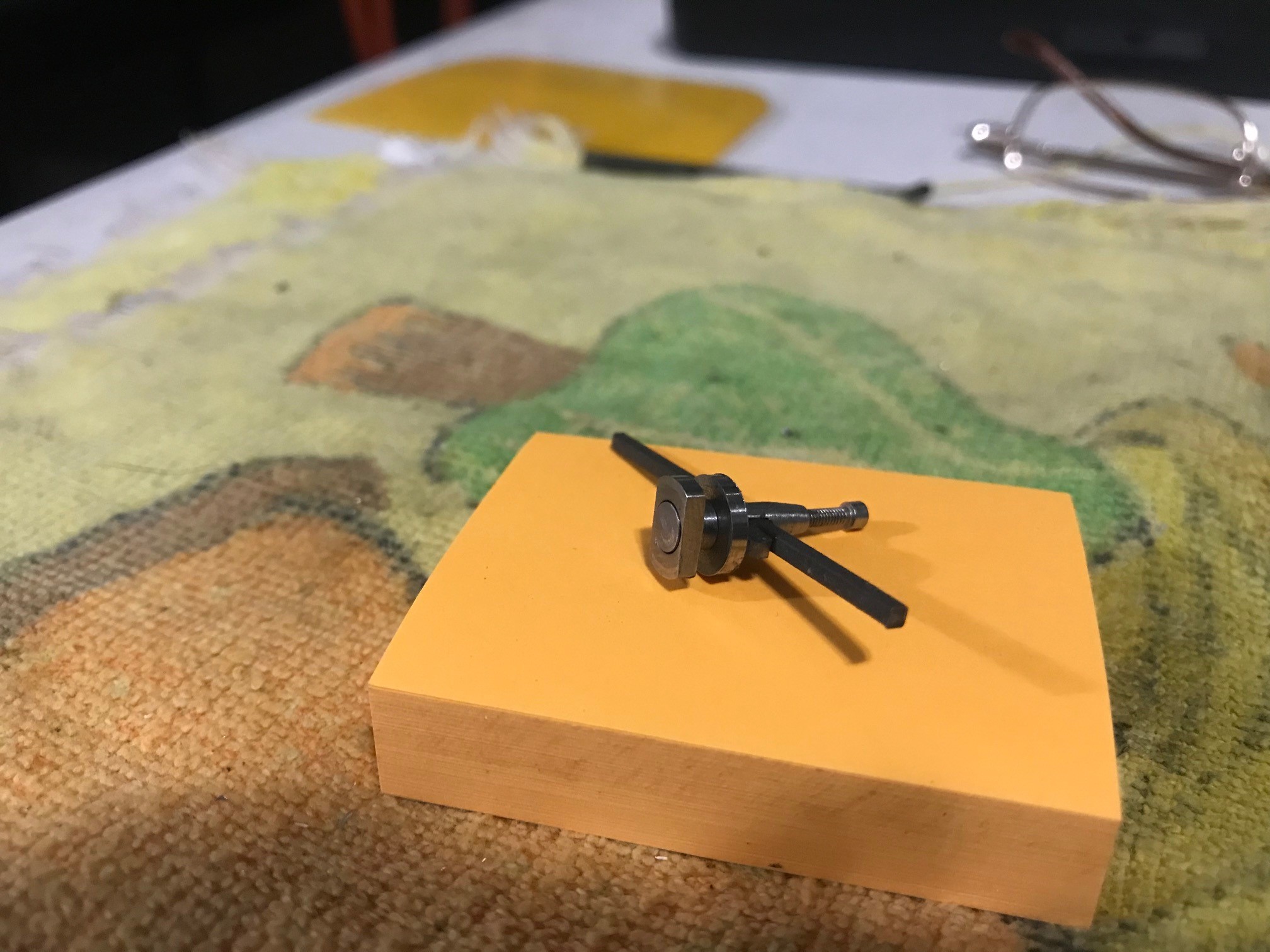

Got the carriage clutch assembly done. I'm really liking the DRO functions!!
