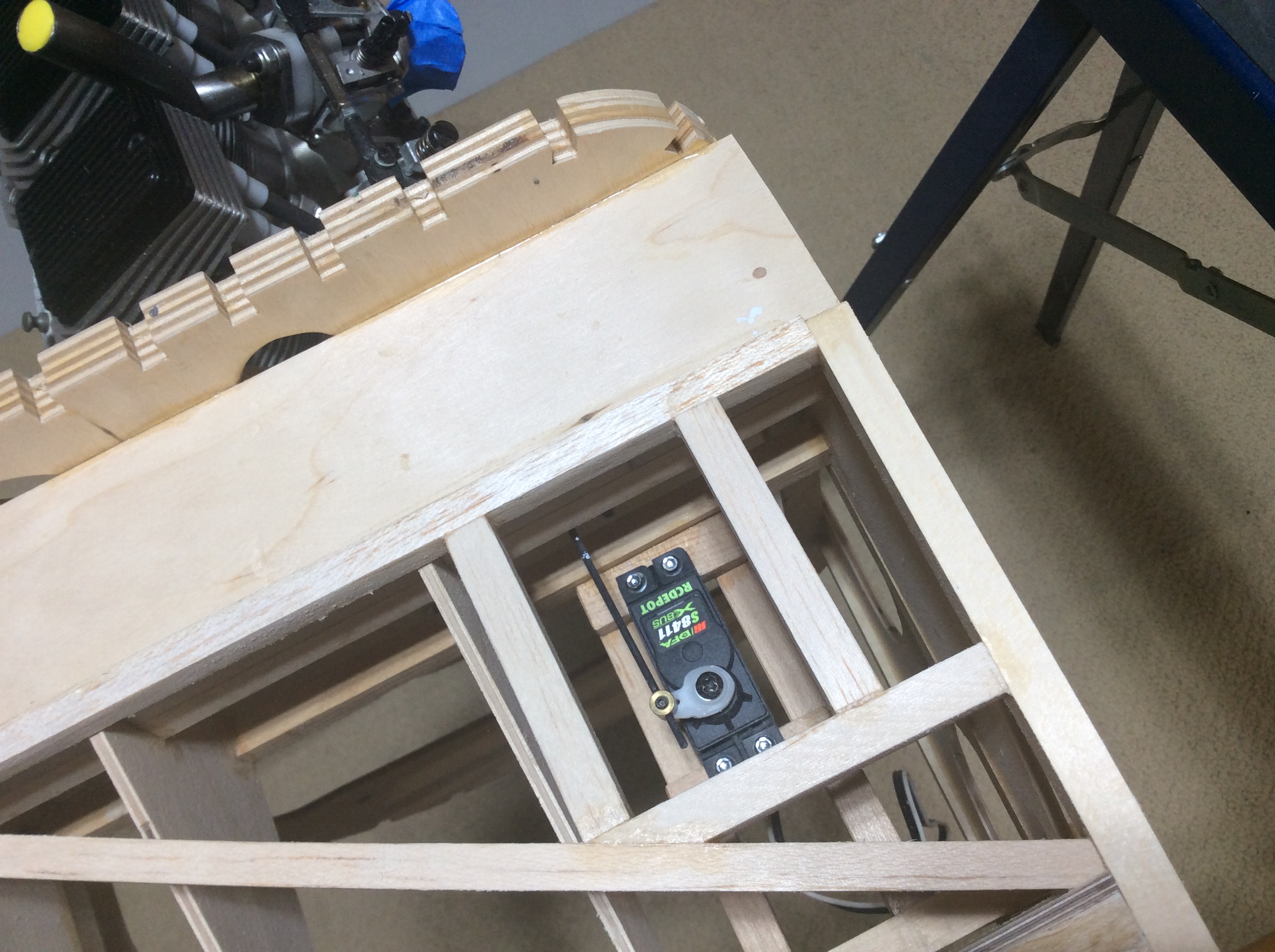

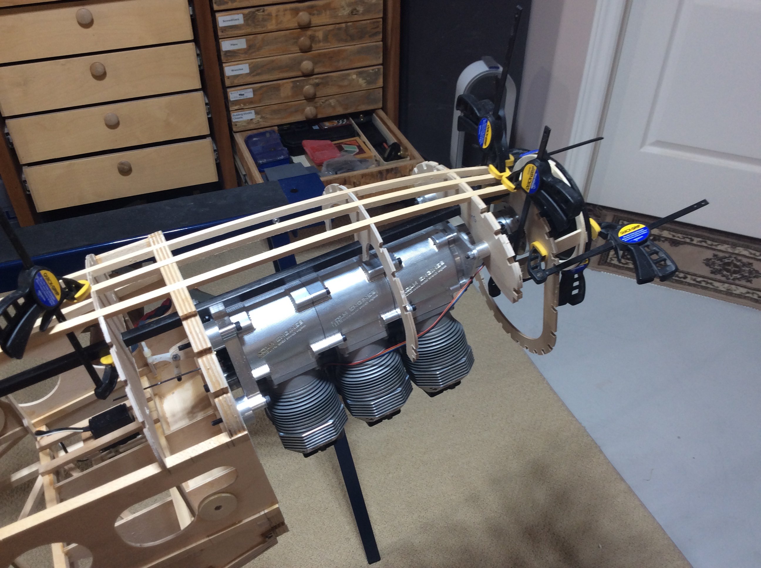

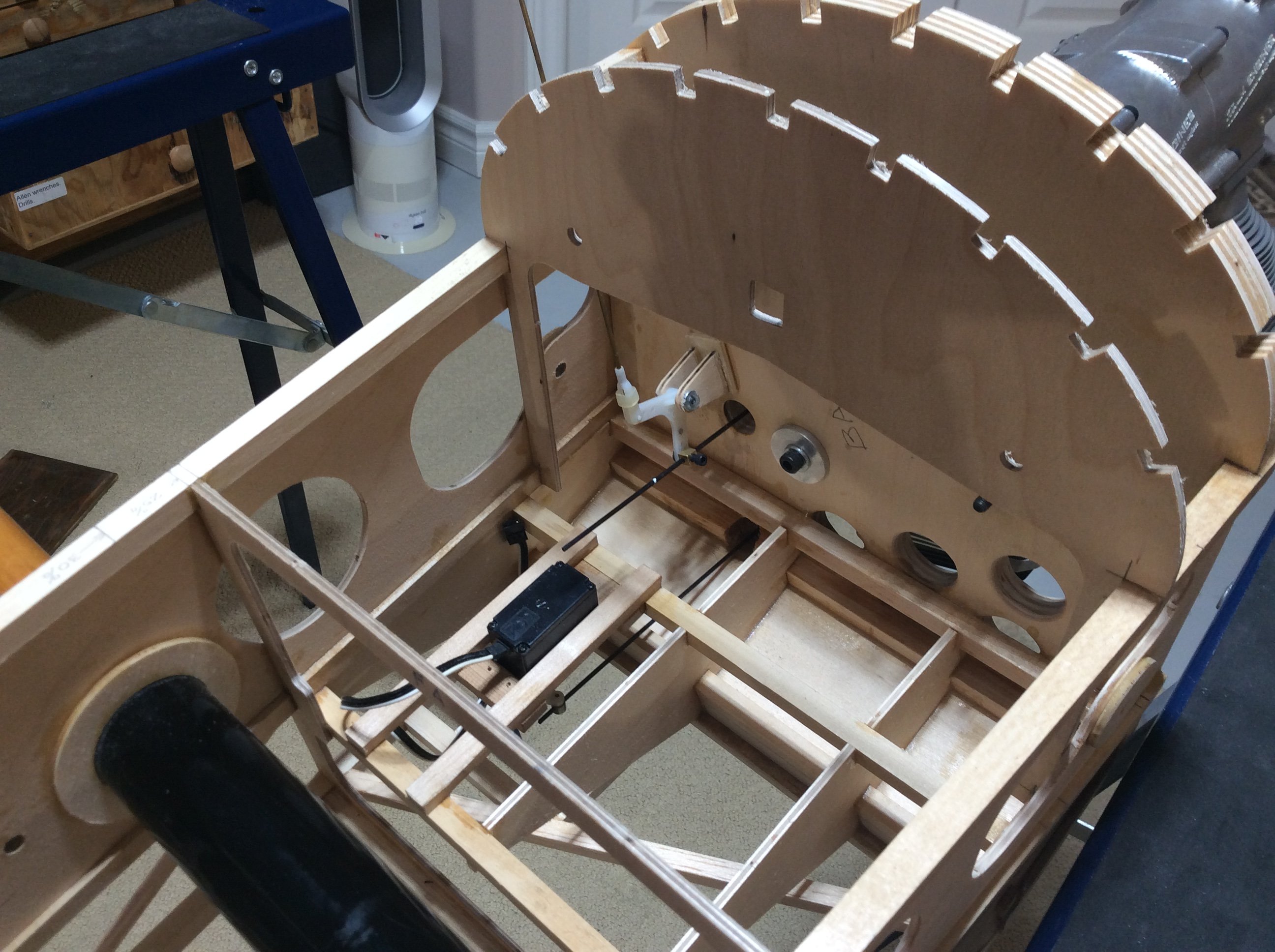

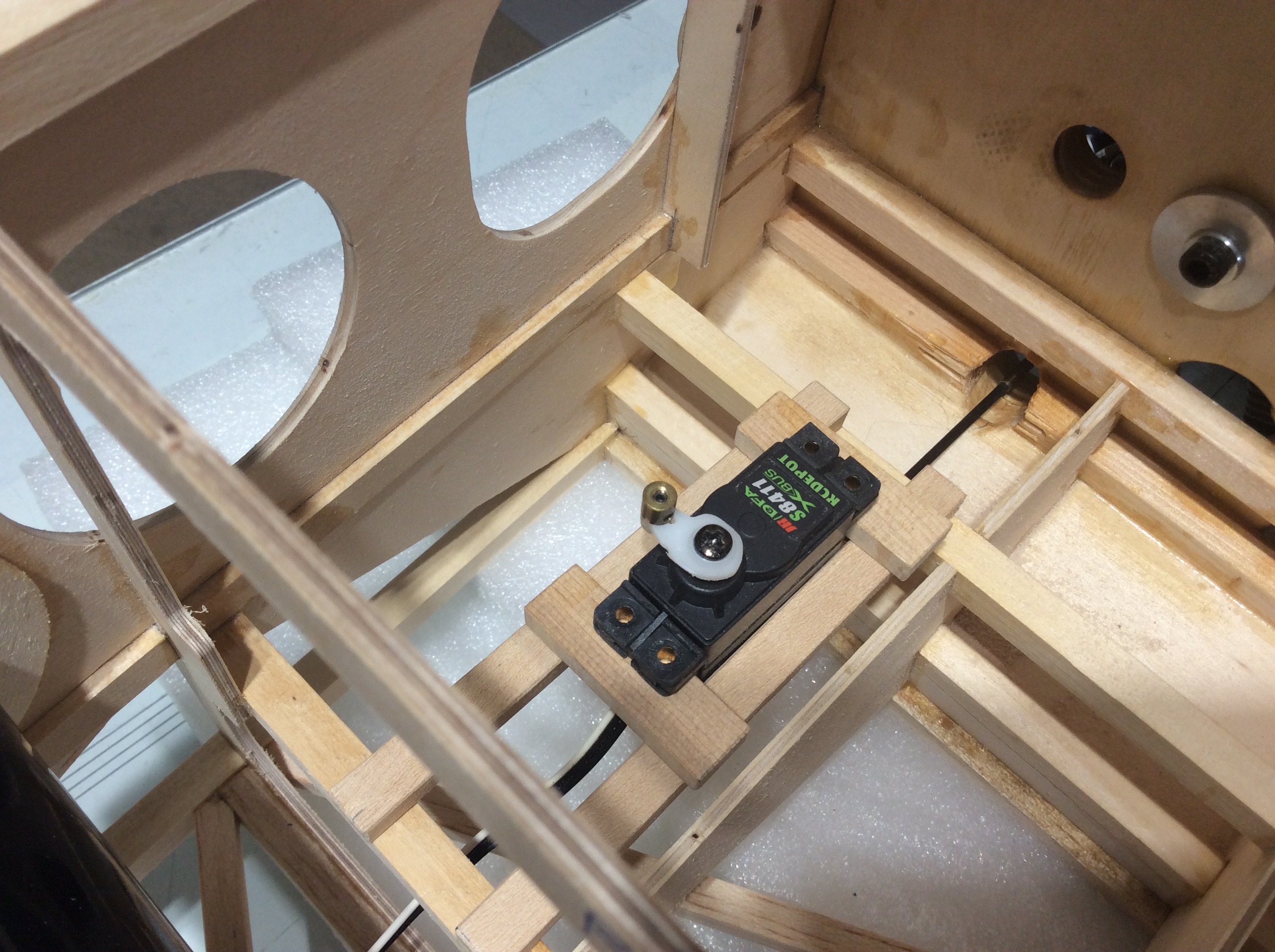

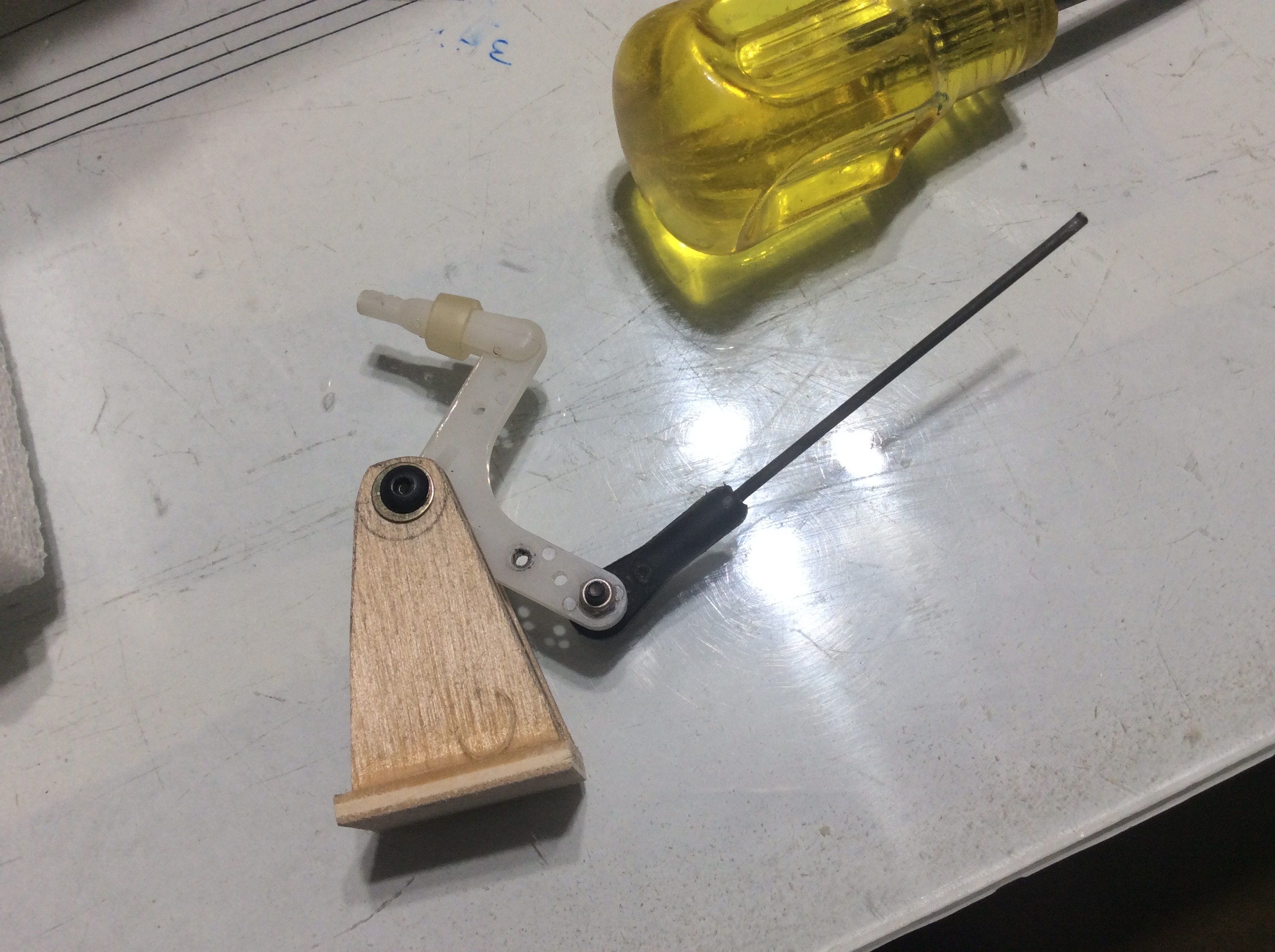

Made some progress. The second picture will work for the choke but it will have come out the top of the fuselage. Not great but it will work. The first photo is the throttle servo it needs to be installed upside down with a hatch on the bottom. Hope fully at that position it lines up with the motor, tomorrow I will find out. You can see the black rod coming through the firewall.

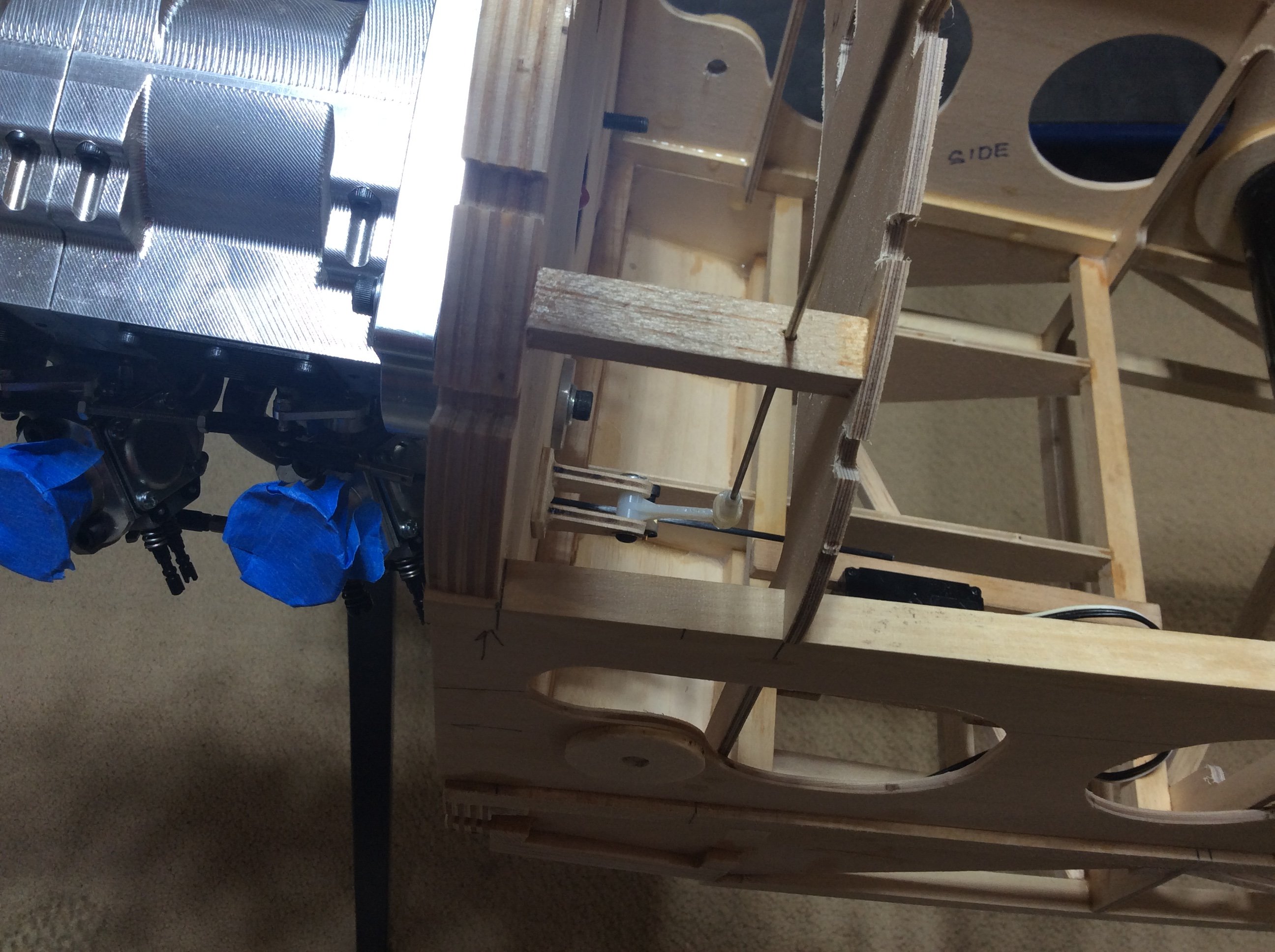

Looks like it all going to fit, just did a quick setup to see if it all fits and lines up. Now I have to remove the motor clean up everything clean up the firewall and give it a coating of epoxy and start assembling and glueing all the parts in. Top half.
One important thing I must not forget is to seal off the top of the engine and the cowl before closing it in, air cooling.
