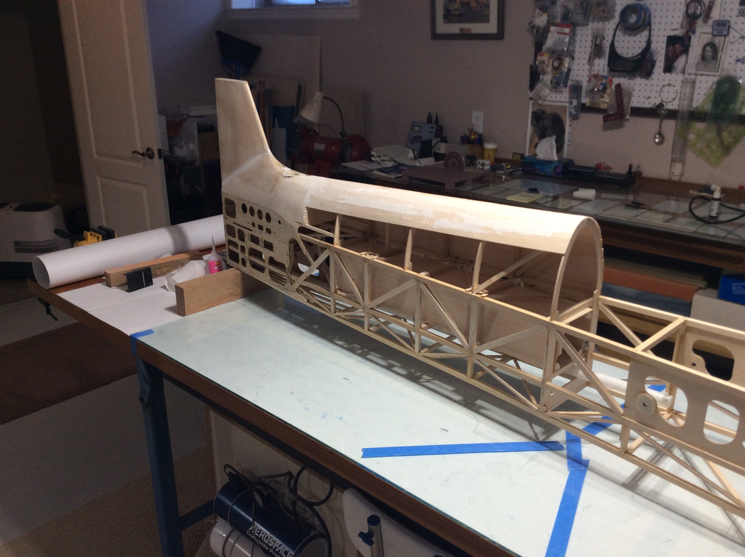

This is what I ended up with. After fiddling with bracket and supports and sponge and flaps so that the air tanks would stay in place and not rattle it looked like a mess and not workable over the long run, and was, starting to get heavy. Scrapped that and build a box from 1/16 balsa. Made the just so that the air tanks could be slid in and out. Best of all it turned out less weight than all the supports and sponge. That does not happen often.

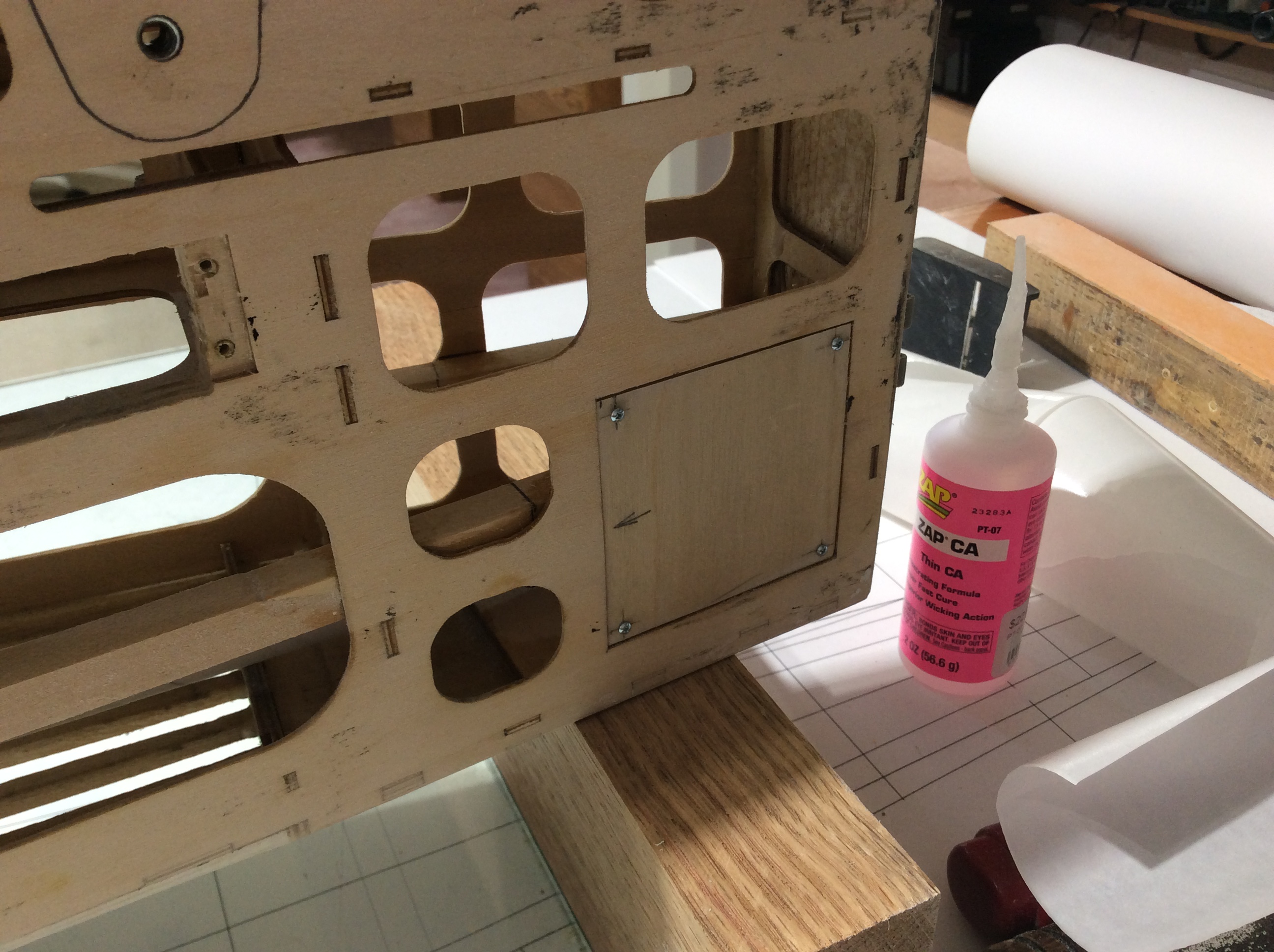

Interesting nobody asked how did I get the air tank box in.

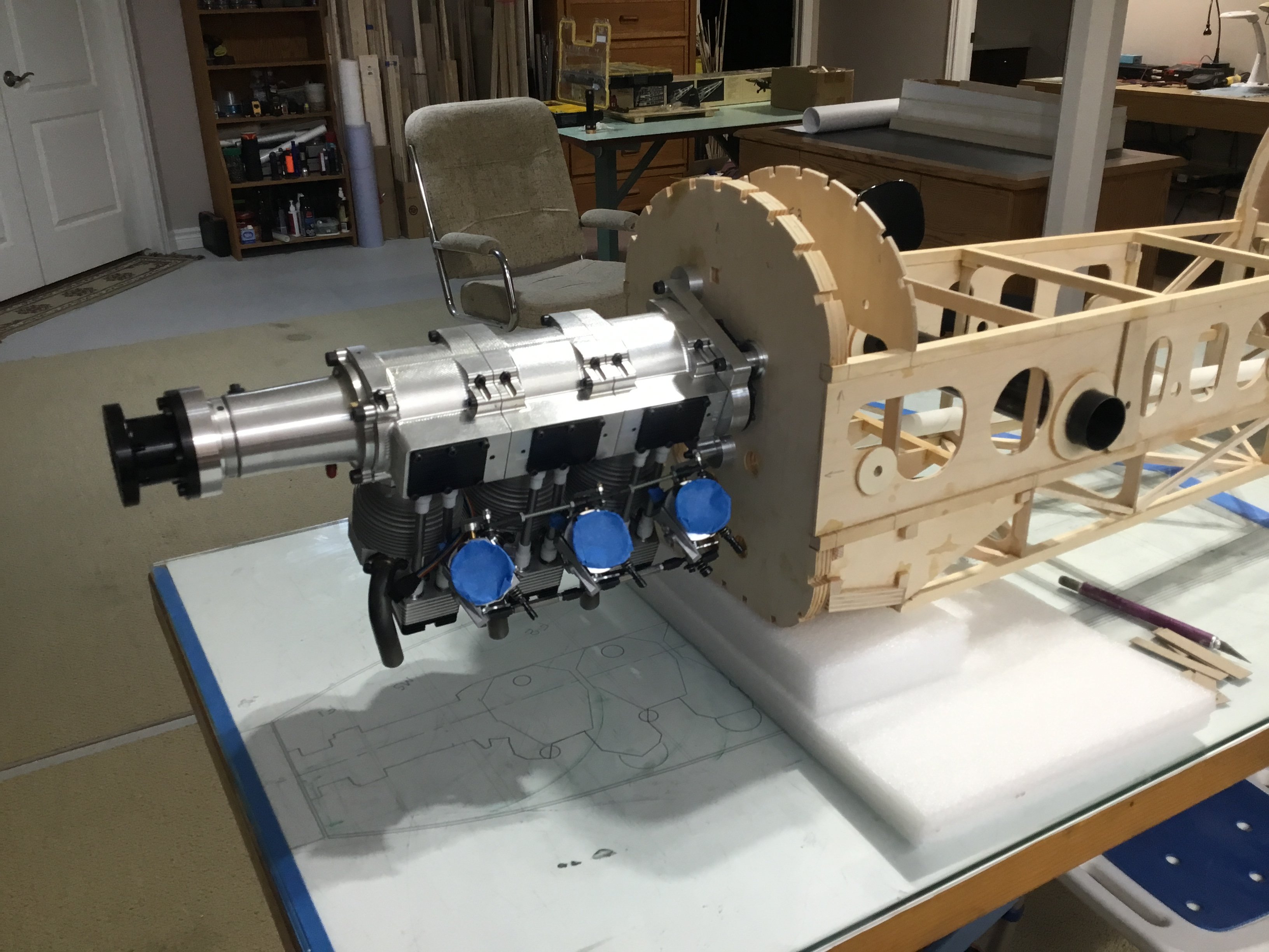

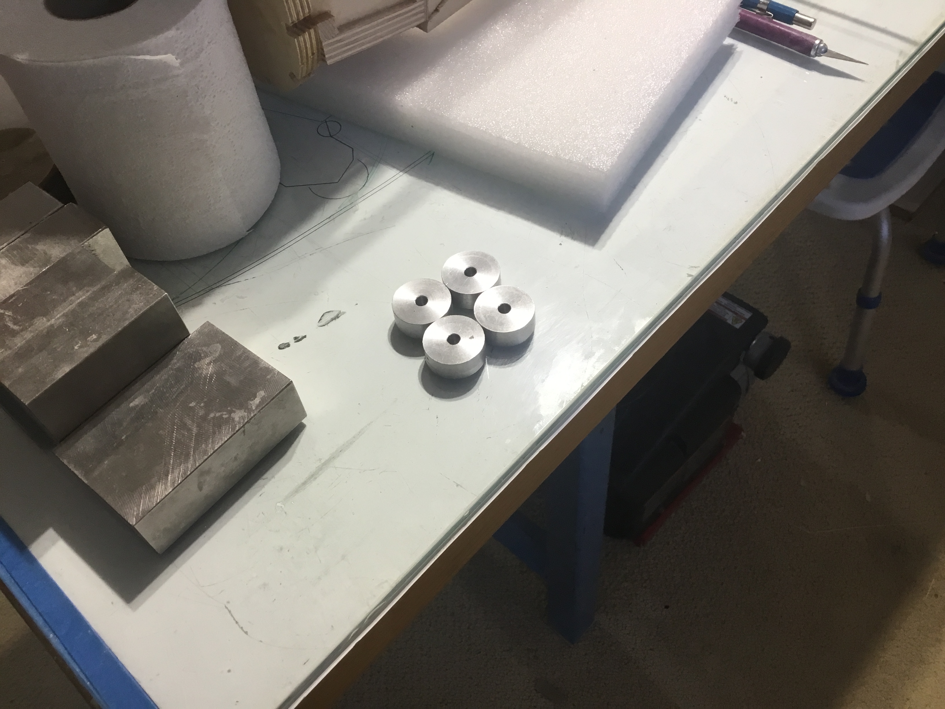

Did some number crunching and I believe I need 10.2mm motor spacers. Made them up and see how it all works out. Need the spacers to be able to get the engine in out of its location this will become apparent later on in the build.

I would like to know how you pulled off that trick!
Unfortunately I did not find the trick. After I had built the air tank box and you are standing in front of the plane then you all of sudden realize you cannot get the air box into the plane. You feel so foolish At that time. So no I had to remove a lot of bracing to get it in and then put the plane back together. Not fun. .
