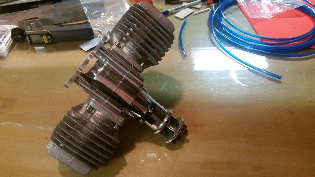

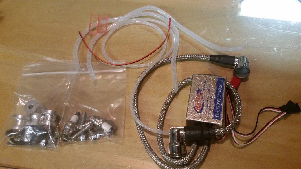

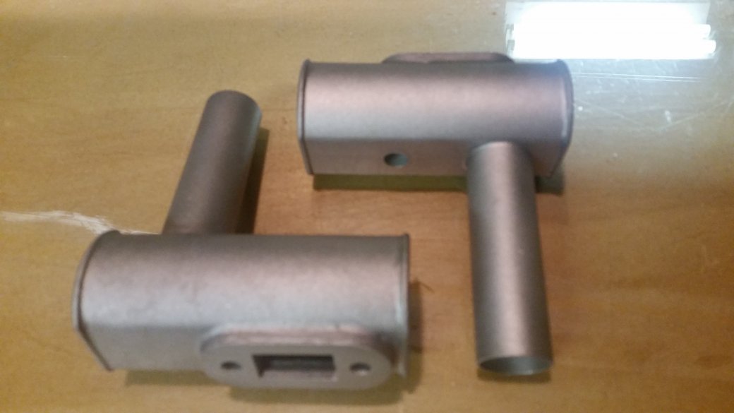

First thoughts...... Packaged nicely, they even included 2 JR E Switches for me. Awful nice of them to do that for me. Those switches are for my 93" AJ Laser 230Z. Fully CNC machined case. DLE/EME styled cylinders with large transfer ports. An ignition system capable of 8.4V. Thin, tinny sounding mufflers. I will use those until they arent usable any longer. Then you have you hardware baggies, screws, plugs (file 13 bound), exhaust gaskets, servo end keepers, spiral wrapping.

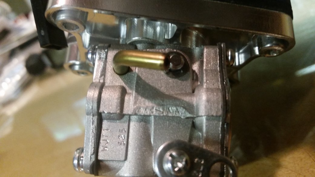

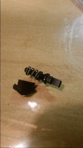

Throttle arm is a must! I would really like to see a carb arm included with the 120cc engines, regardless of brand. So, I will have to manufacture one of my own until I can get an arm for a WJ71 carb. Broke off that little spring loaded return latch on the choke, and removed the idle stop screw. Then you have to rotate the carb inlet nipple around, it faces FWD when shipped. Be cautious of this, as you "could" damage it. I just took a pair of duck bill pliers, and rotated the nipple in its housing. Put it right where I wanted it.
