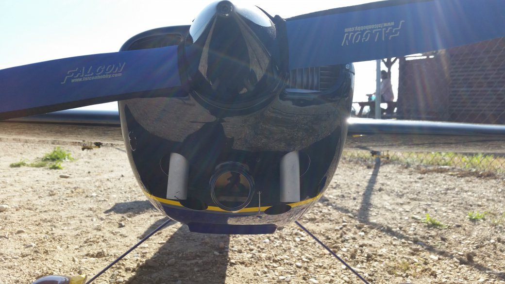

Stock exhaust and 28x10 Falcon started out at around 6500. I can assure this. She's well beyond that now.

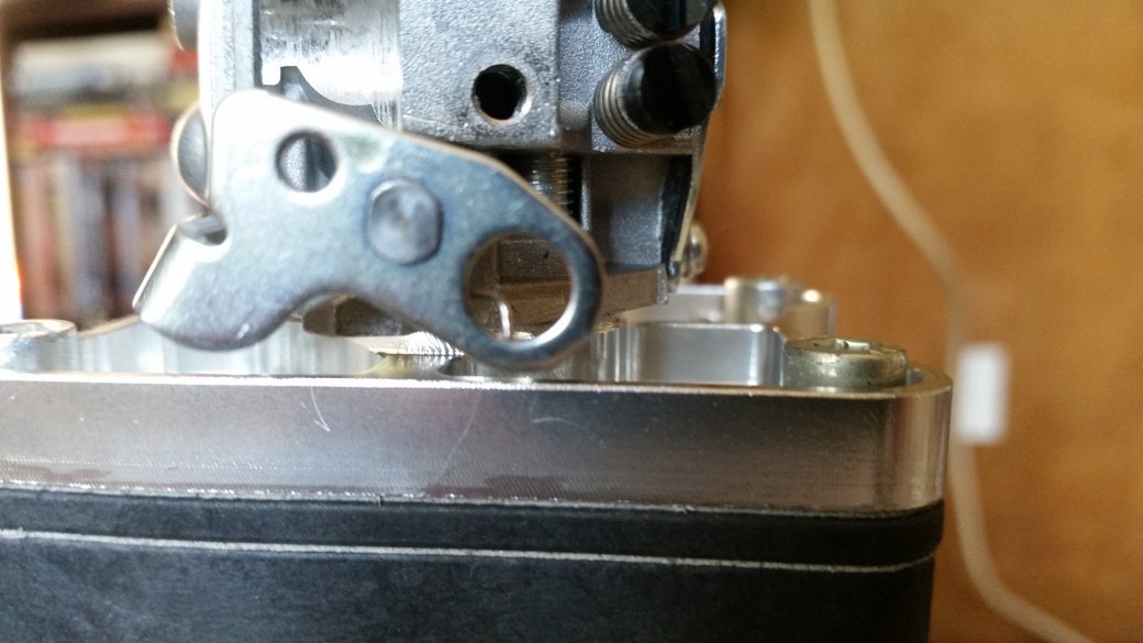

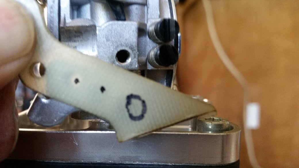

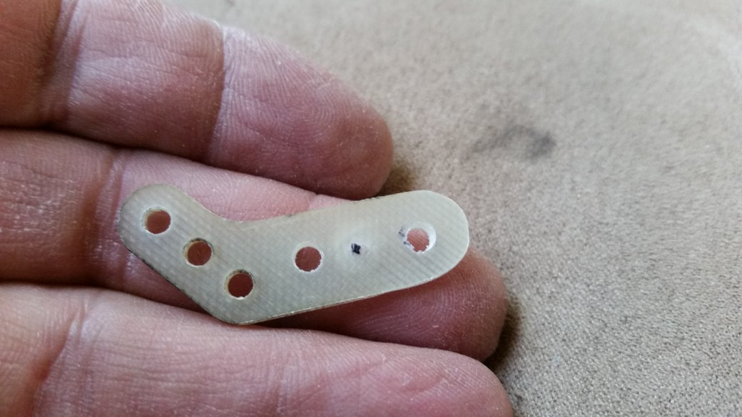

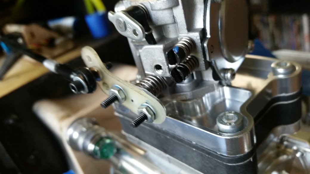

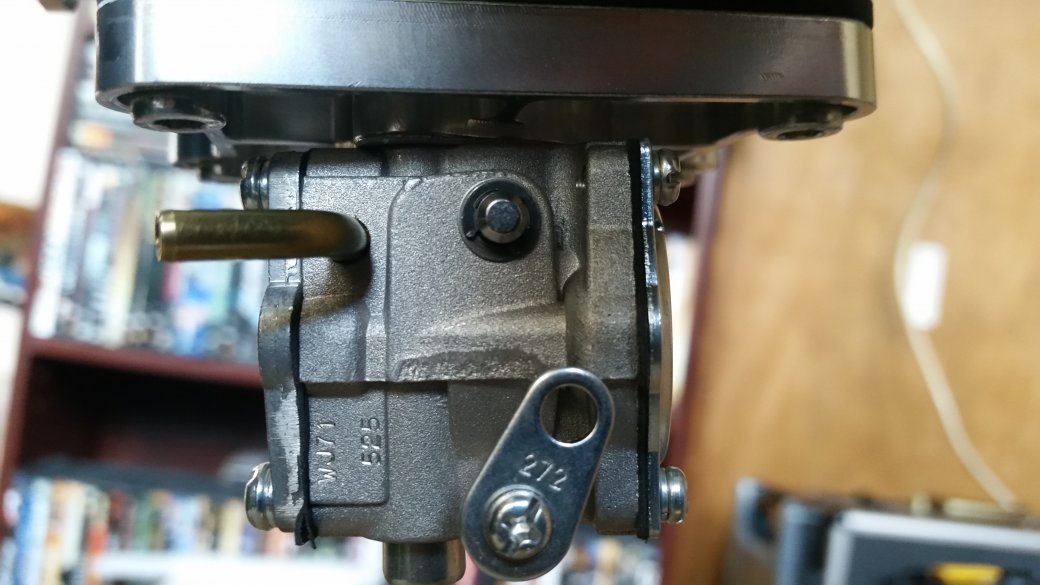

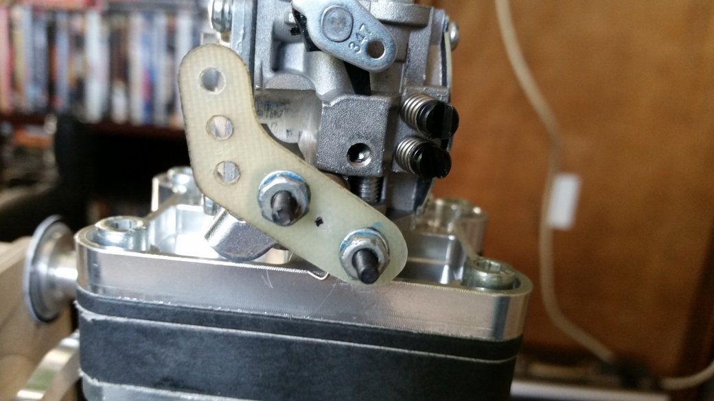

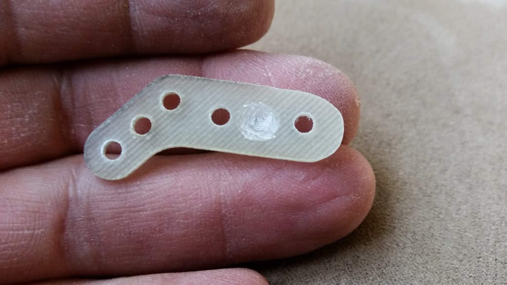

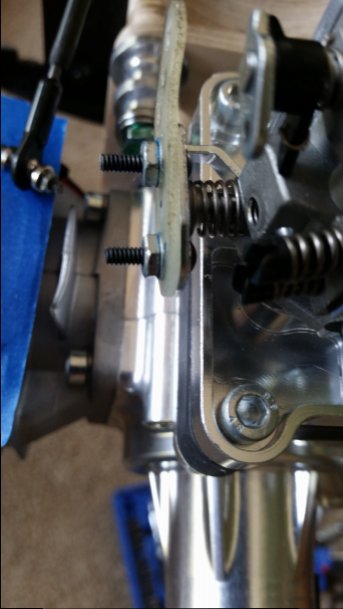

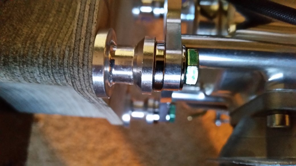

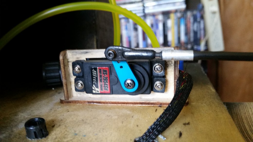

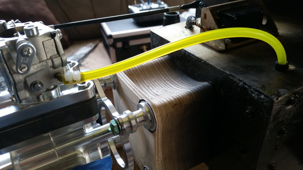

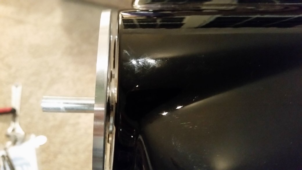

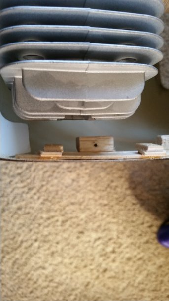

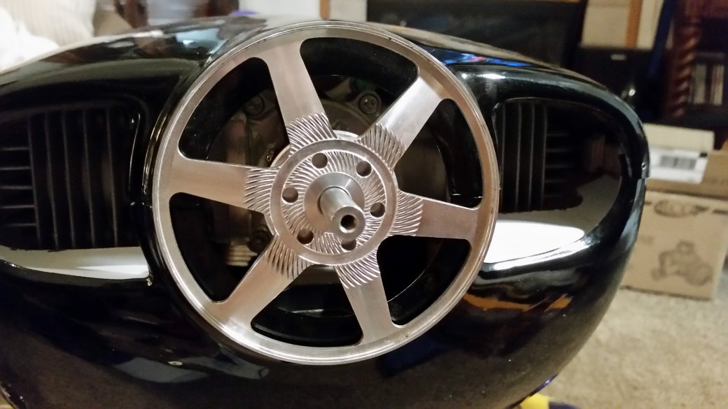

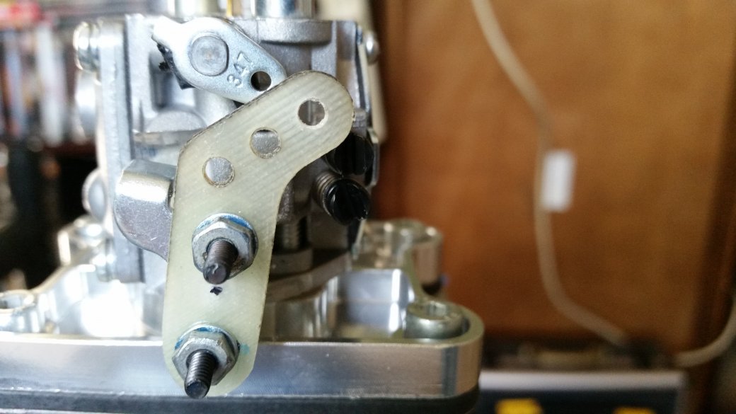

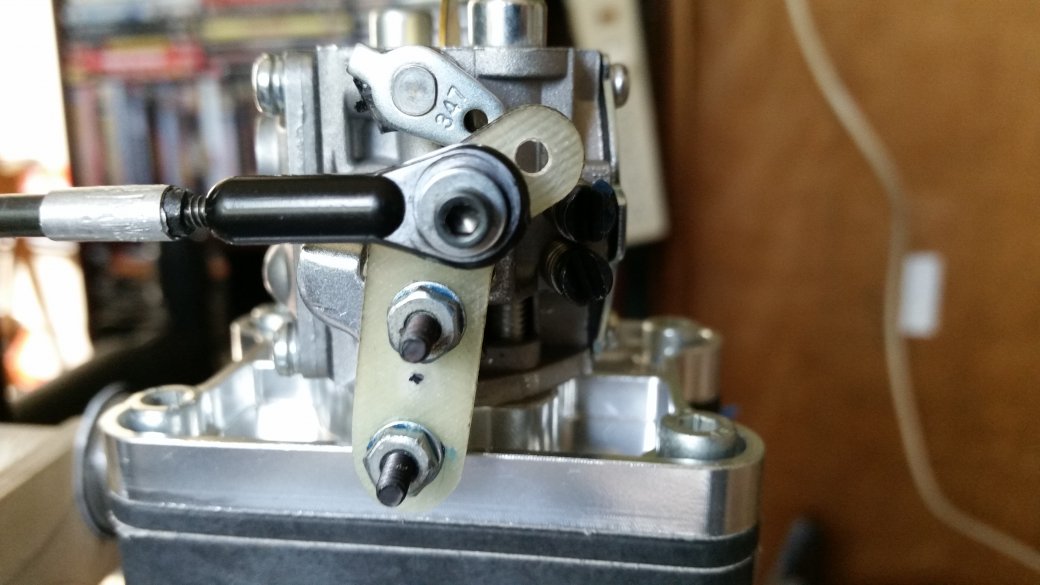

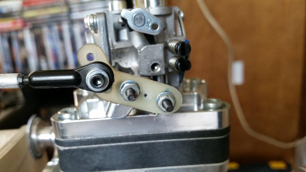

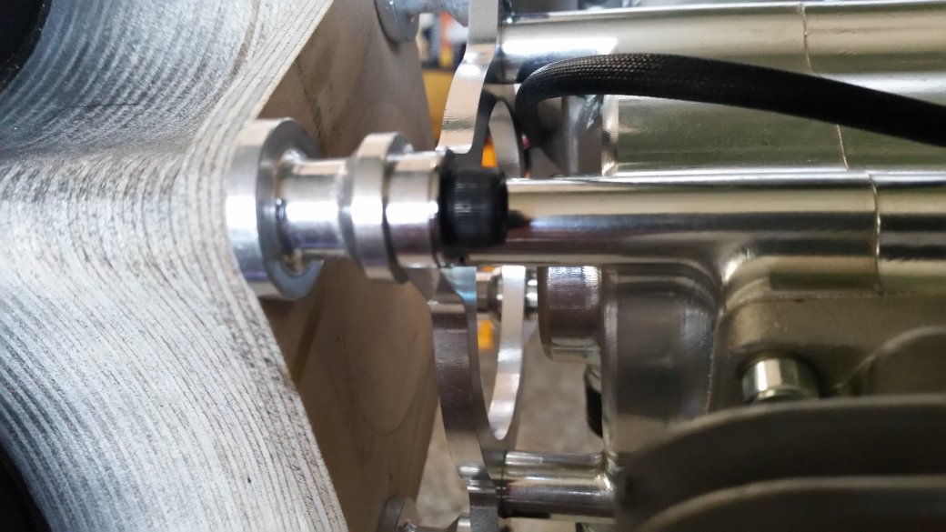

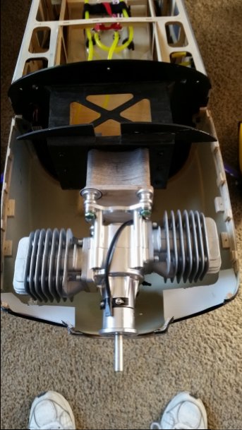

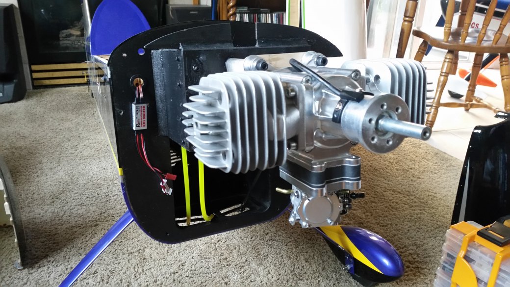

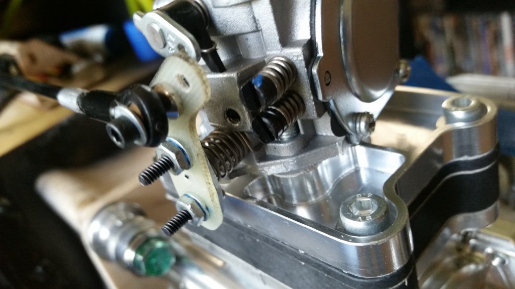

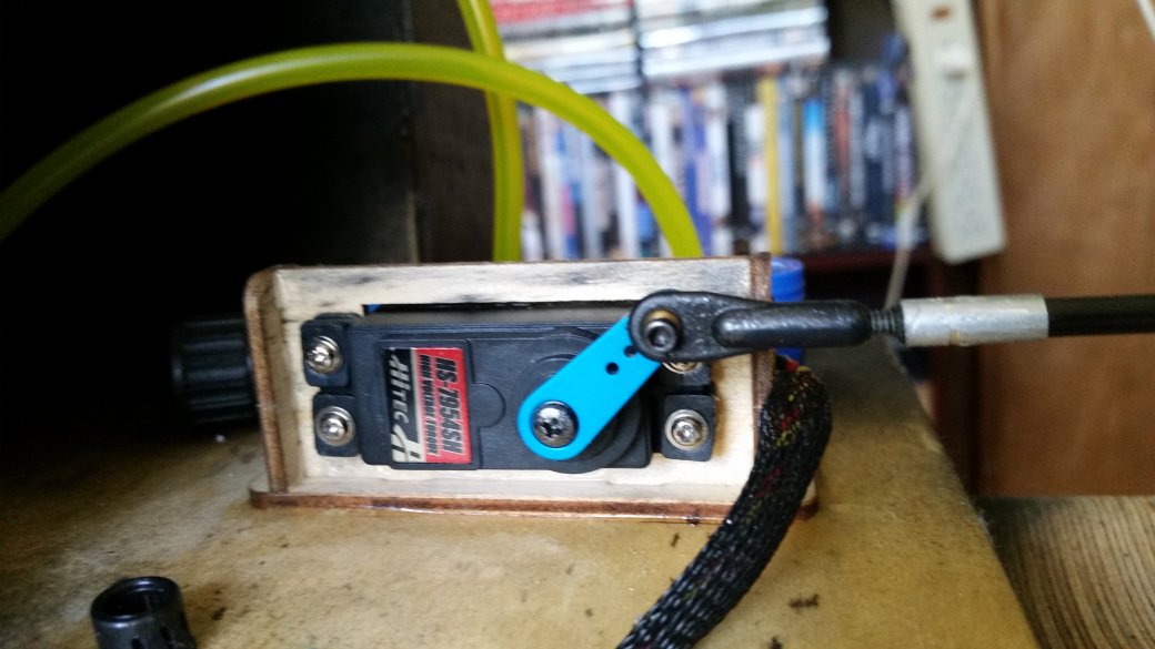

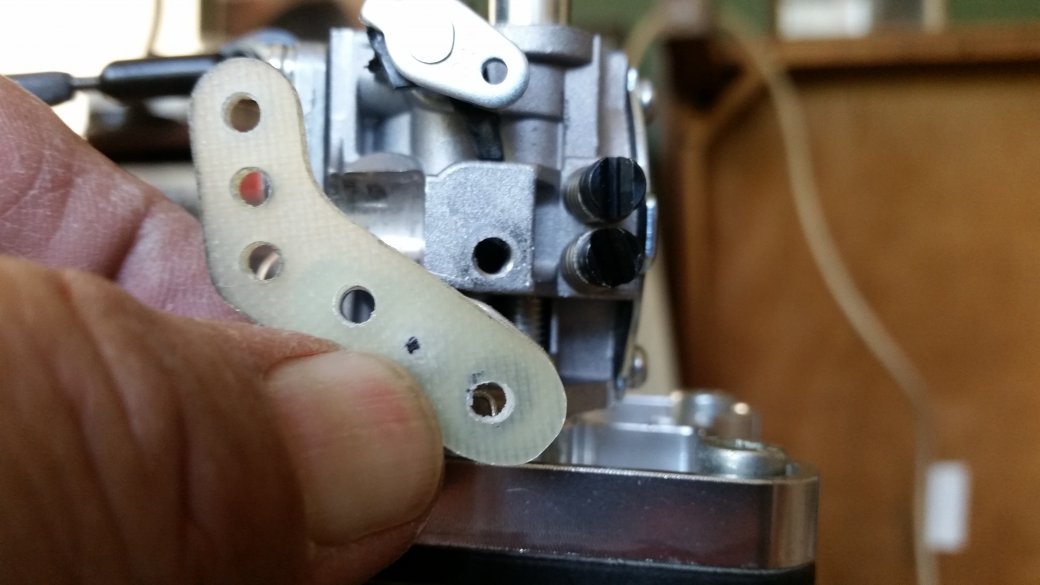

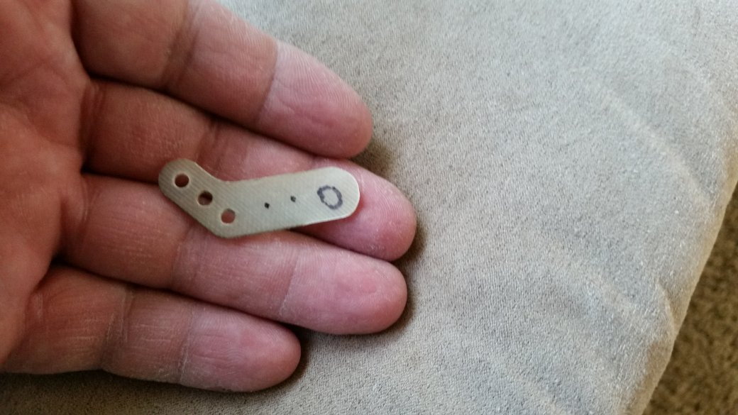

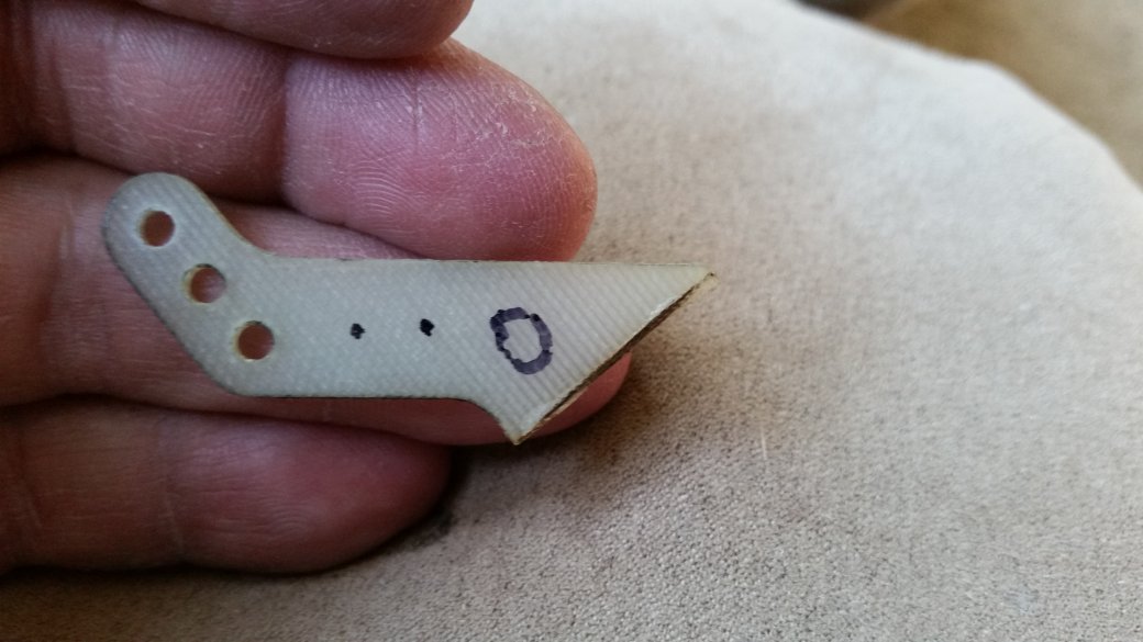

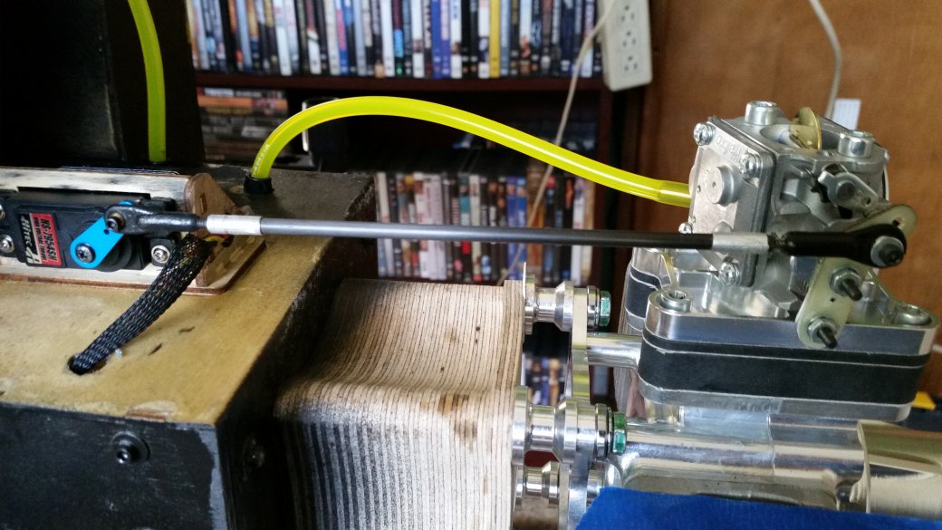

So the install of the RCGF 120 was pretty straight forward. Nothing really out of the ordinary. Other than the throttle arm that needed an addition. But no problem when ya got pieces parts everywhere from various other hoopties. I used a cut off control horn from my behemoth Yak when I did the restore on it. It just so happened it gave me the exact angle I needed for the throttle. The inlet nipple on the carb needed a little twist to put it where it was more user friendly. And the exhaust bolts for the mufflers are pretty much like the spark plugs that come with all the Chinese motors. I use them for shooting baskets. Litterally....the trash can basket. LOL.

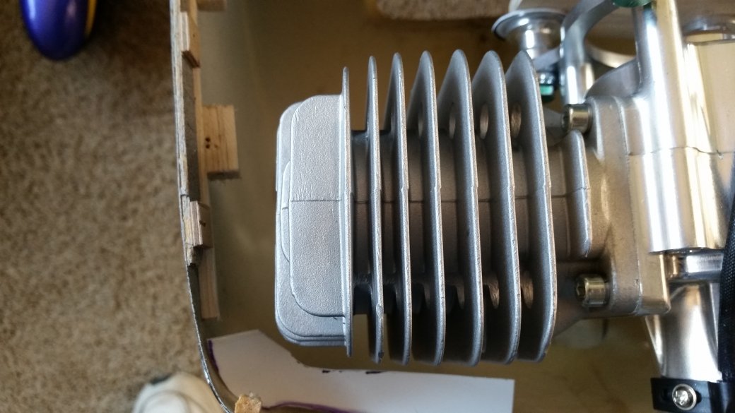

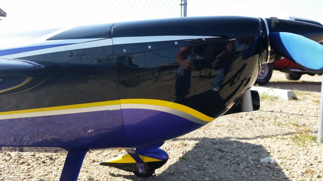

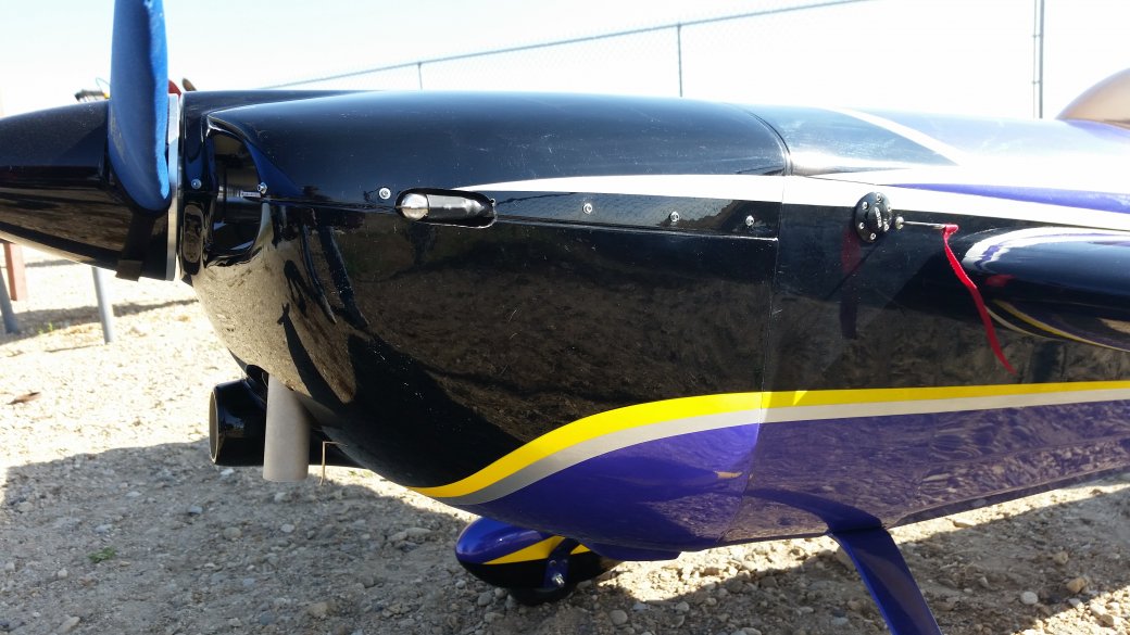

Other than that, it was pretty much just measure, bolt and hook up. Nothing spectacular. I did use the cowl from the DLA 128 4 cylinder adventure though. It already had gaping holes in it and I figured that if I didn't like the RCGF, at least I still had my perfectly good "UNCUT" cowl that housed the DLE 111 with cans.
Now that I know this 120 is some kind of little power house, and I do like the fact she (the Edge) lost almost 2 lbs. in the motor swap...(dumped the cans....LOL) I will probably go head and cut the new cowl in a more professional and precisce manner.

Ok, now that I read it. Sounds like you had a nice experience, that is good to hear. The off brands are slowly catching up or at least worth every dollar and then some. That cowl don't look so bad, with one eye closed anyway. The stock style muff don't do much for muting sound so I have been running straight headers for a while and for the most part they are not any louder.
