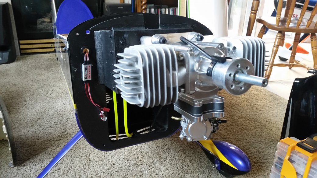

Truly a downer I'm sure. Upside? Mount that motor. Mine is mounted...working on a throttle arm. Photos to follow.

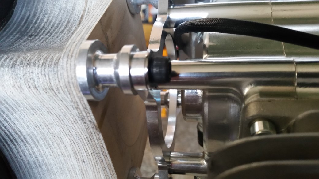

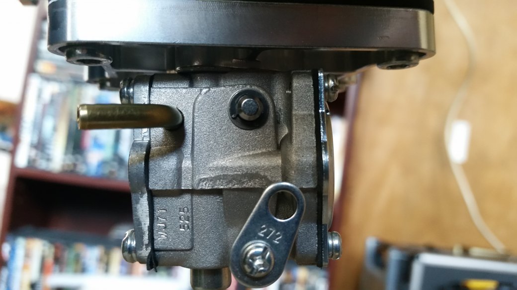

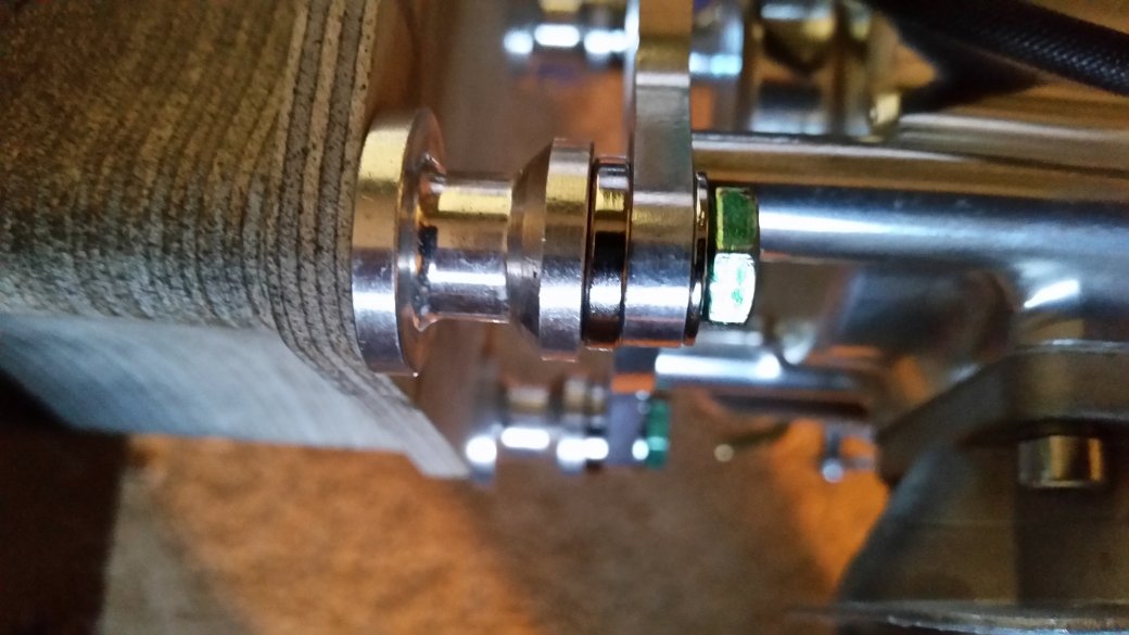

Initial mounting and an itsy-bitsy twist-a-roonie on the fuel inlet on the Walbro.
I will be adding another 1/8" aluminum spacer as the supplied standoffs are not quite long enough. Also had to get longer bolts.

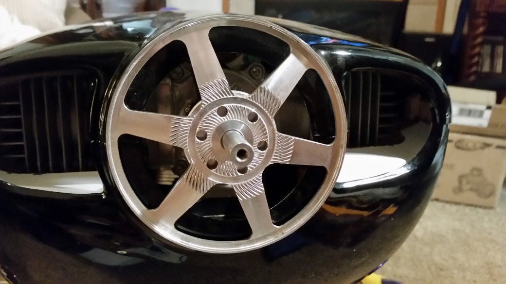

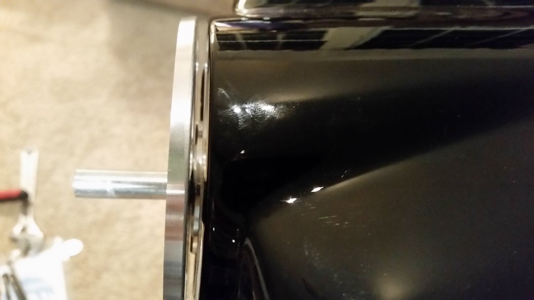

Calling it a night. Adjusted, readjusted...and readjusted once more. Got my final cowl to back plate spacing set. Right at a slight 1/8" clearance. Centering came out pretty good too.
Ya'll know how anal I can be. So with that being said, I decided to use the original cowl that was cut up for the 128 4 cylinder. I'm going to have to make cutouts for at least the left side spark plug boot. Possibly the right as well. Not sure yet. I'd rather cut up this cowl and use it for a pattern like I did on the Cessna. To me that's more logical than hacking away at a nearly brand new cowl that housed the DLE 111.
