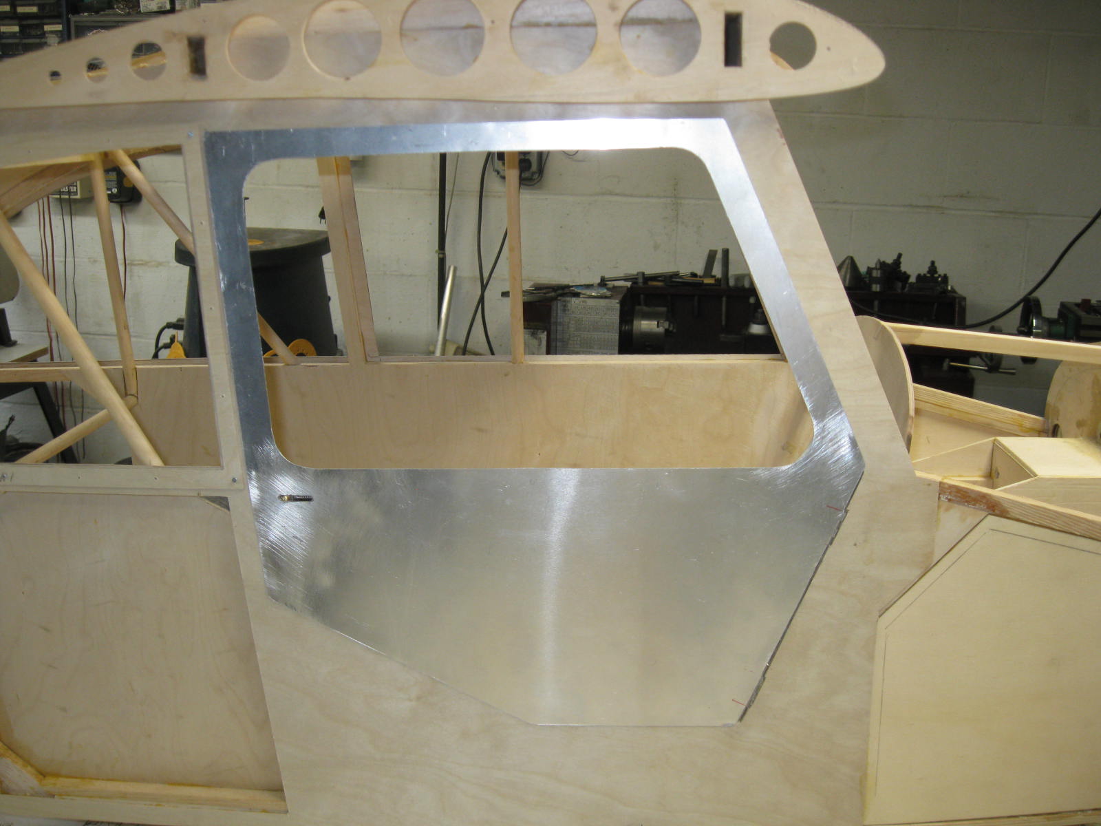

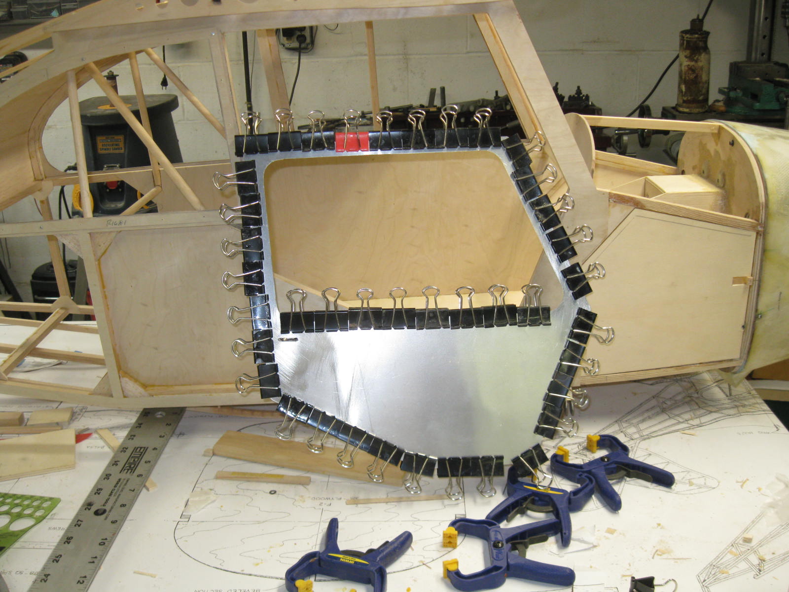

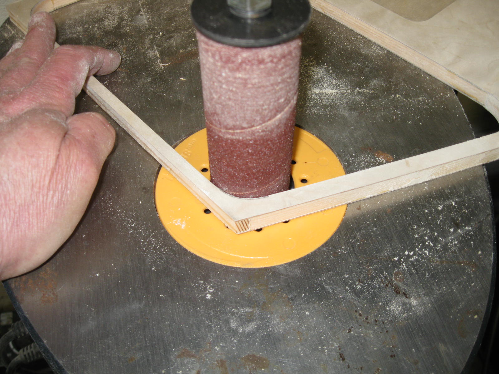

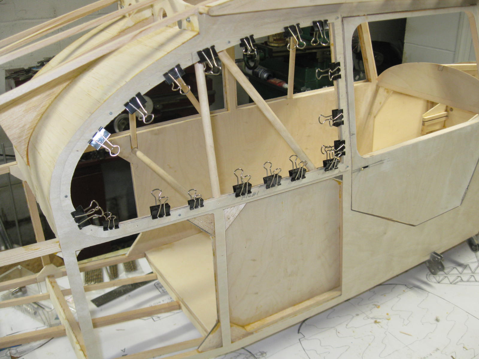

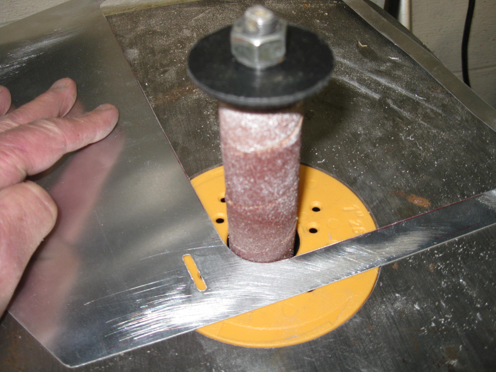

Got to use the drum sander again on this build, put the radius in the door window opening and the aluminum for the door skin. The aluminum provides a 1/8" flange for the window. Don't use it often but it is great for radius work. Was a little worried about the .012 thick aluminum sheet but it worked fine.

Here's the door installed
