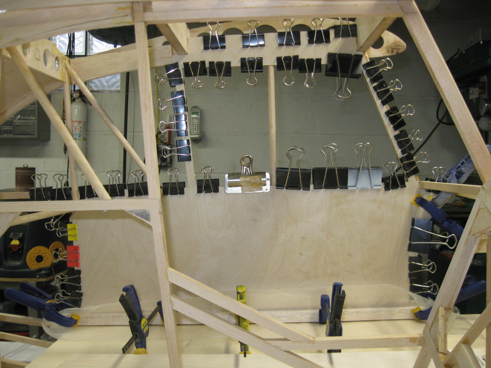

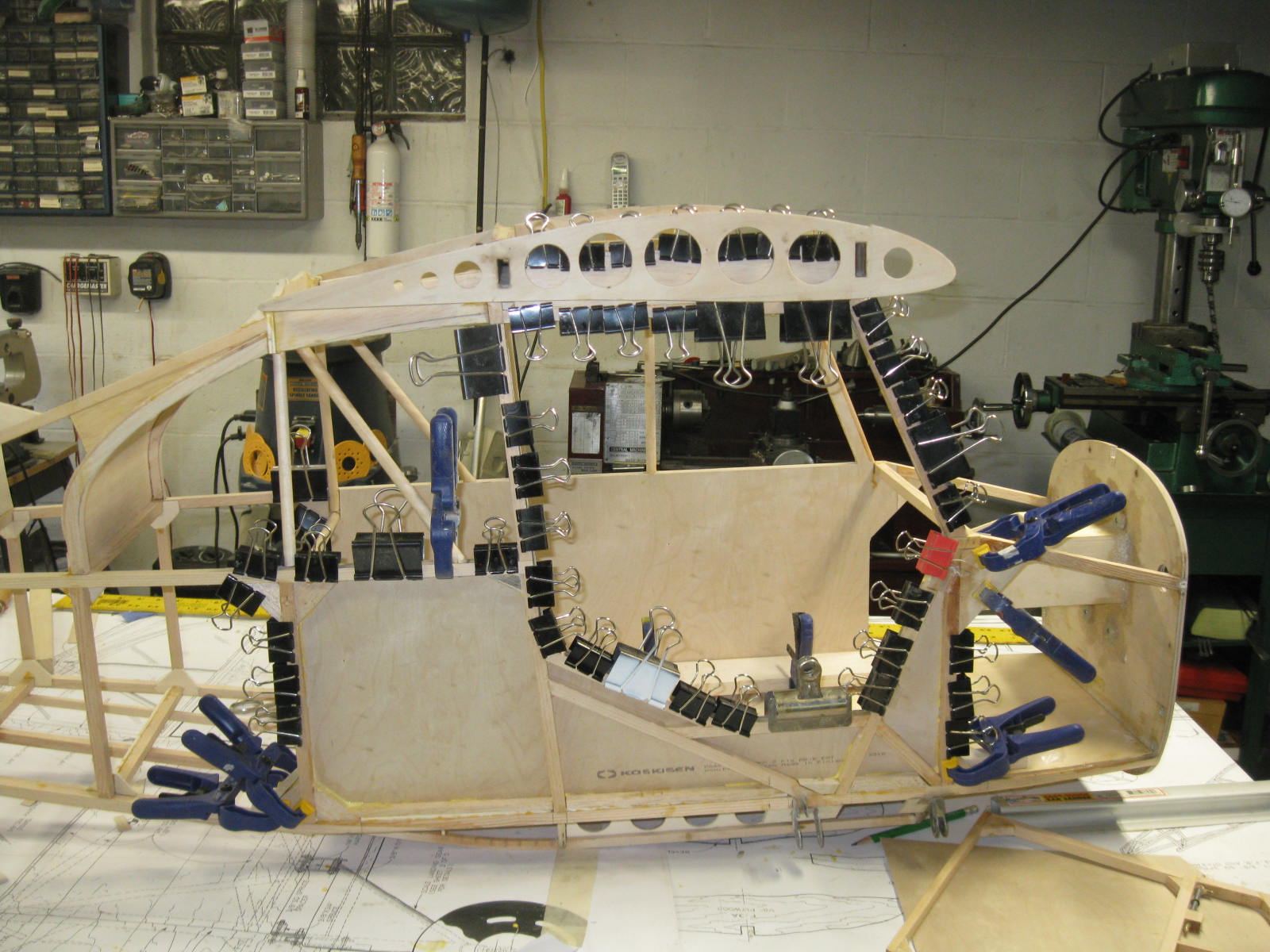

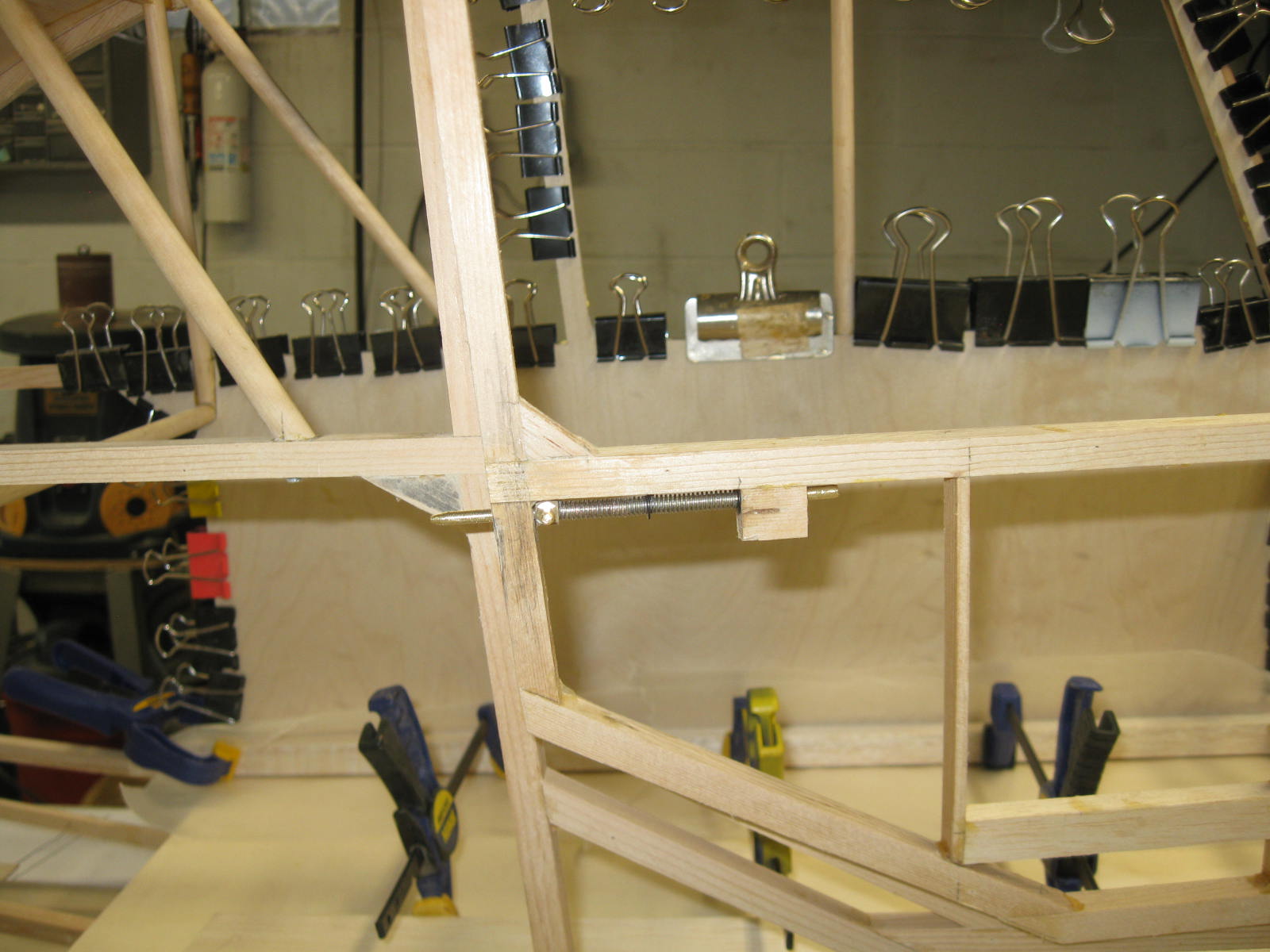

Order 2' x 4" x 1/32" plywood from Aircraft Spruce, UPS delivered it yesterday. The interior and exterior get sheeted with 1/32" and I wanted the sheet to be one piece, started with a 18" x 21" piece for the interior. The exterior sheet also forms it the back windows. Have the door latch completed as well, 5/32" K&S brass tube and 1/8" brass rod.
Like Acerc said that is going to stiffen the plane. Working with ply is not easy it is not easy to make it conform to a plane shape. Looking god.
TonyHallo
Got the interior completed after a Friday Fun night, hope to get a few flights in tomorrow morning and help a friend get his new plane sorted out. Then get the exterior sheeting on. Boy do I have a lot of scrap 1/32" ply for the scrap drawer. I hope to take the fuselage to our club meeting on Monday night for "show and tell".
