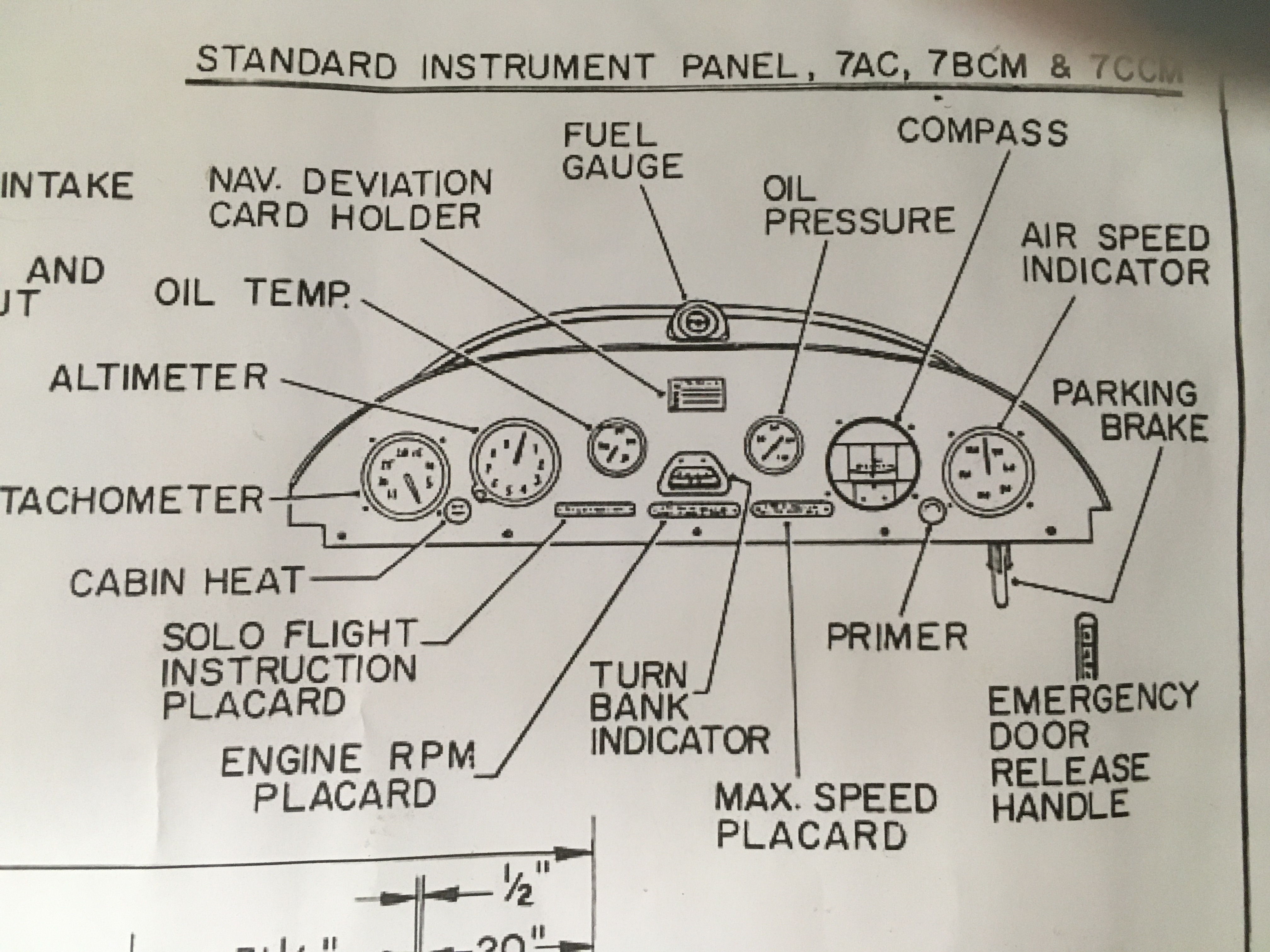

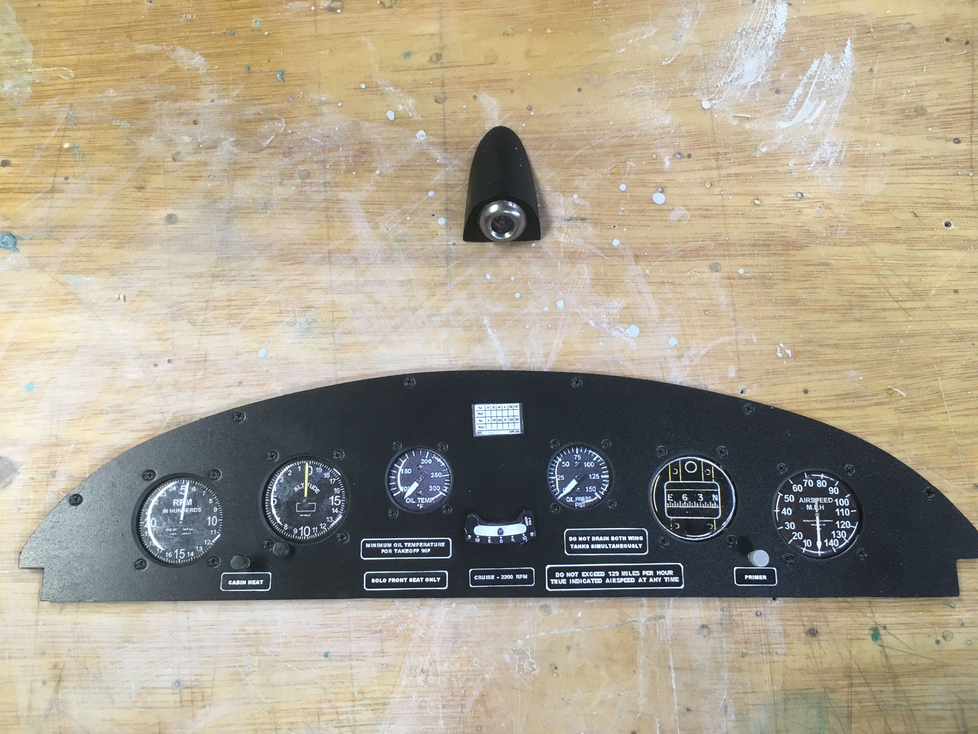

I had received the quote from SACMidwest.com last week for the Champ dash, I sent them a dash template and the attached photo from the 3 view I'm working from along with the fuel level gauge mount that mounts to the top of the dash. Received the completed dash today in the mail. Even included the primer and cabin heat knobs. Very happy, will be using their service for future projects.

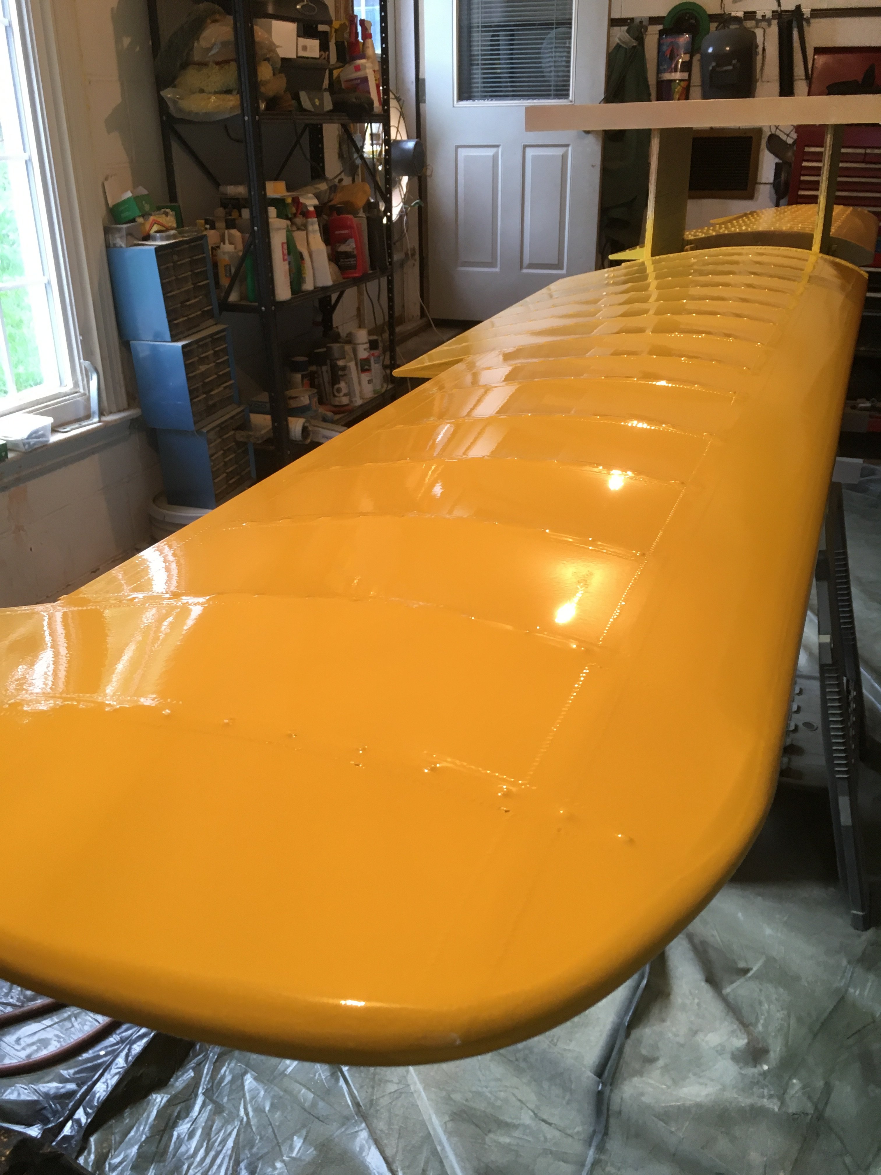

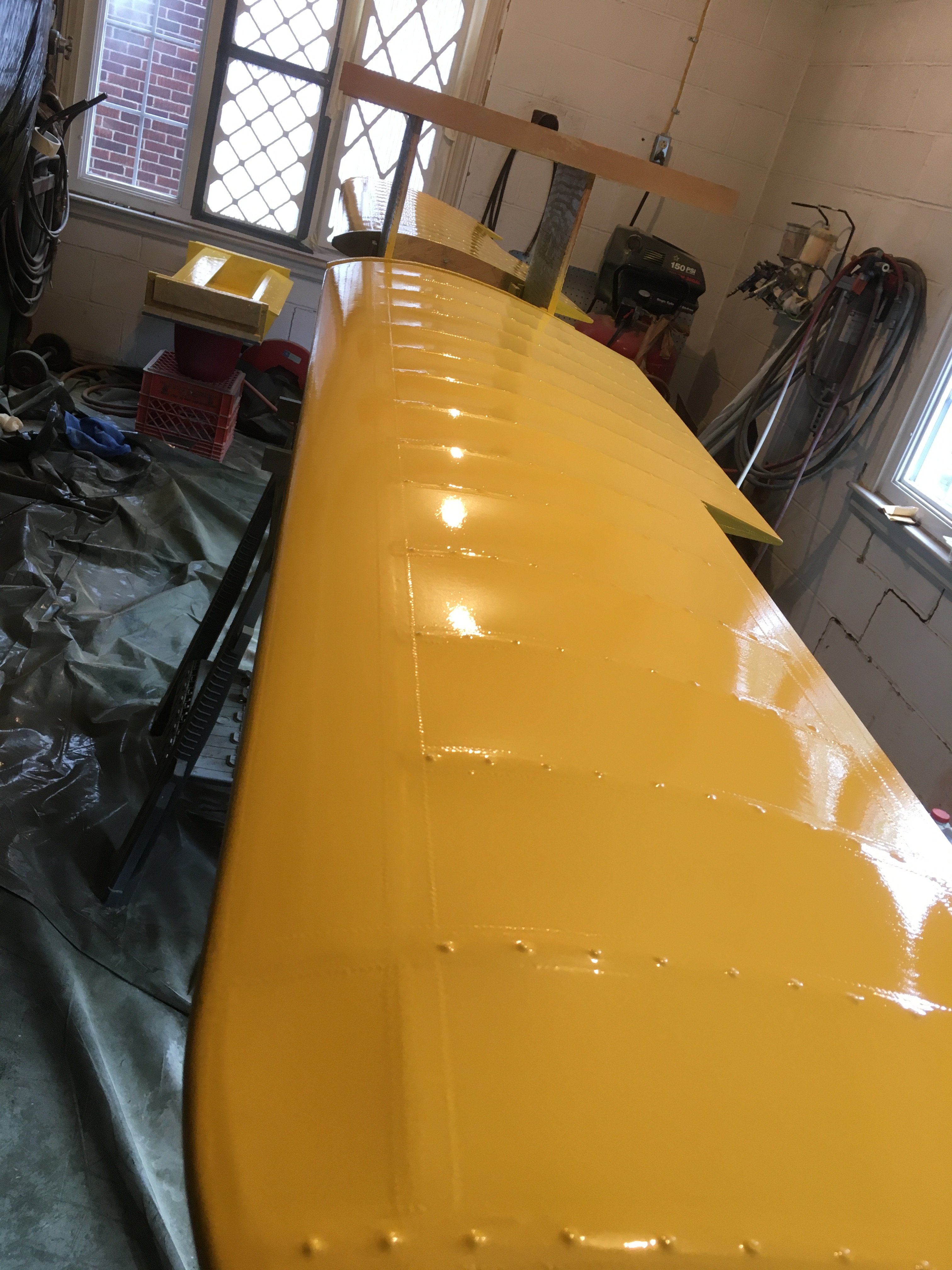

The paint is water based so no solvents fumes to worry about. The exhaust fan that I use was salvaged from a overhead furnace from by brothers auto repair shop, believe it is 1/3 hp, it moves a lot of air, previously used a box fan. It is mounted on a piece of plywood that is the same size as one of the windows in the storm door, remove the glass and pop the fan in, seen in photo 1 below.. The garage is about 18' wide, I hang the plastic from the ceiling and drape it across the floor. In the second photo you can see where two window panels are removes and 4 25"x16" furnace filters are installed. I have a homemade air dryer made from salvaged parts when I was employed, it was a steam sample cooler, the housing is stainless steel and weights about 30 pounds, filed with used desiccant, might have a gallon of volume, regenerate the desiccant in the oven when the wife is on, it lasts a long time. Everything was developed over time from previous failures, the air dryer by far was the best addition. I want to add a steel piping header that will cool the air before it goes to the dryer, I have the pipe on hand just need to install it. The dryer is so massive it does a good job without the header so I'm in no hurry.

View attachment 117426 View attachment 117427
Looks GREAT!!! Nice work!
