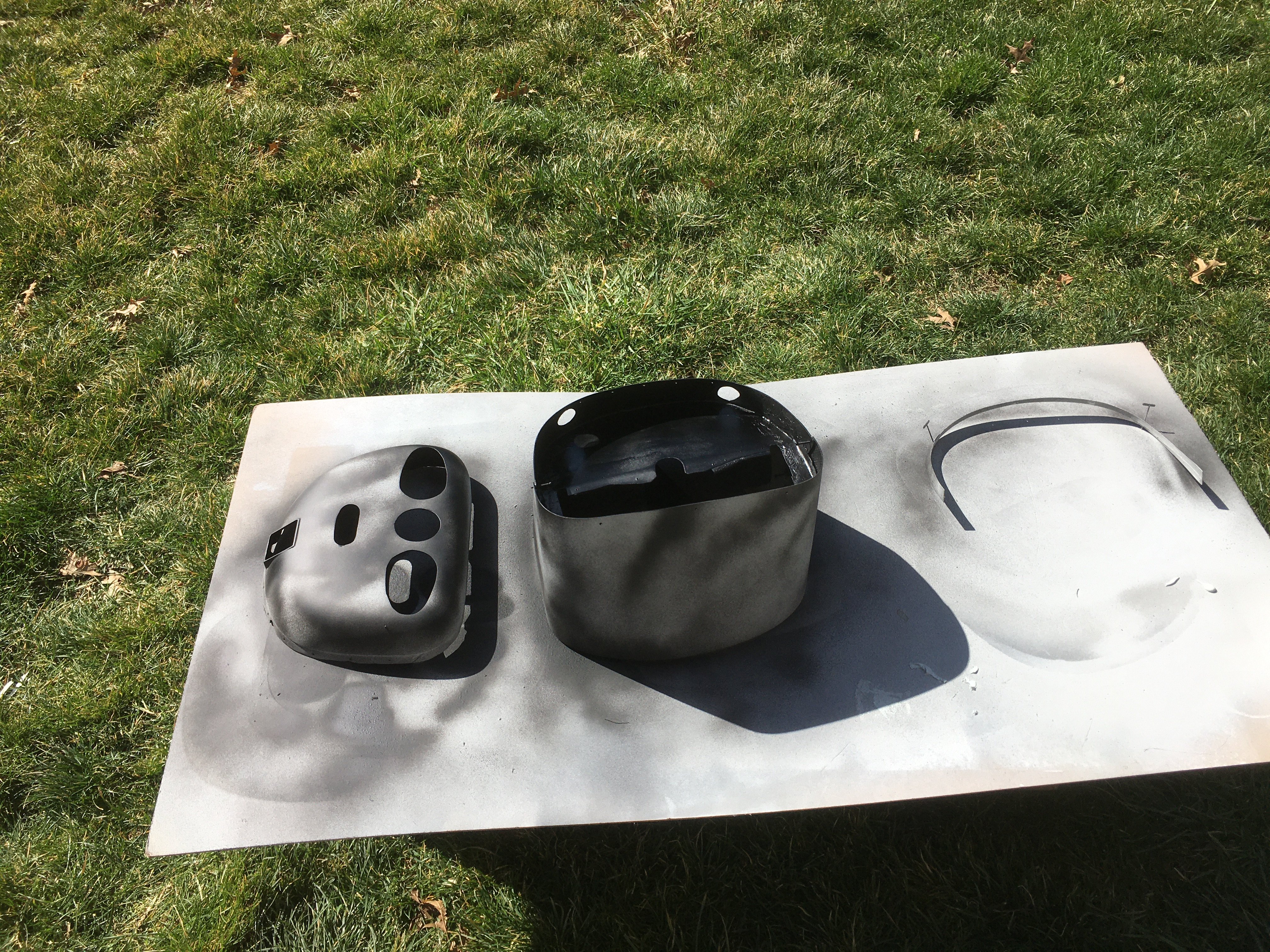

Got the last coat of primer on the cowl today, no pin holes or other flaws, ready for final block sand before applying the Ekopoxy water based primer. Before switching to the water based paints I sprayed the cooling baffle and the inside of the cowl ahead of the cooling baffle with flat black rattle can paint. Also dusted on some flat black paint as a guide coat. These will be set aside until show time, possibly next week weather depending. Gave the steel piping a thought as well, may just go a head and hang it to get it out of my way, made a list of fittings needed to get started. The pipe was salvaged from canvas awnings that we eliminated, 3/4" galvanized pipe, have about 60', should be long enough to get the air cool.

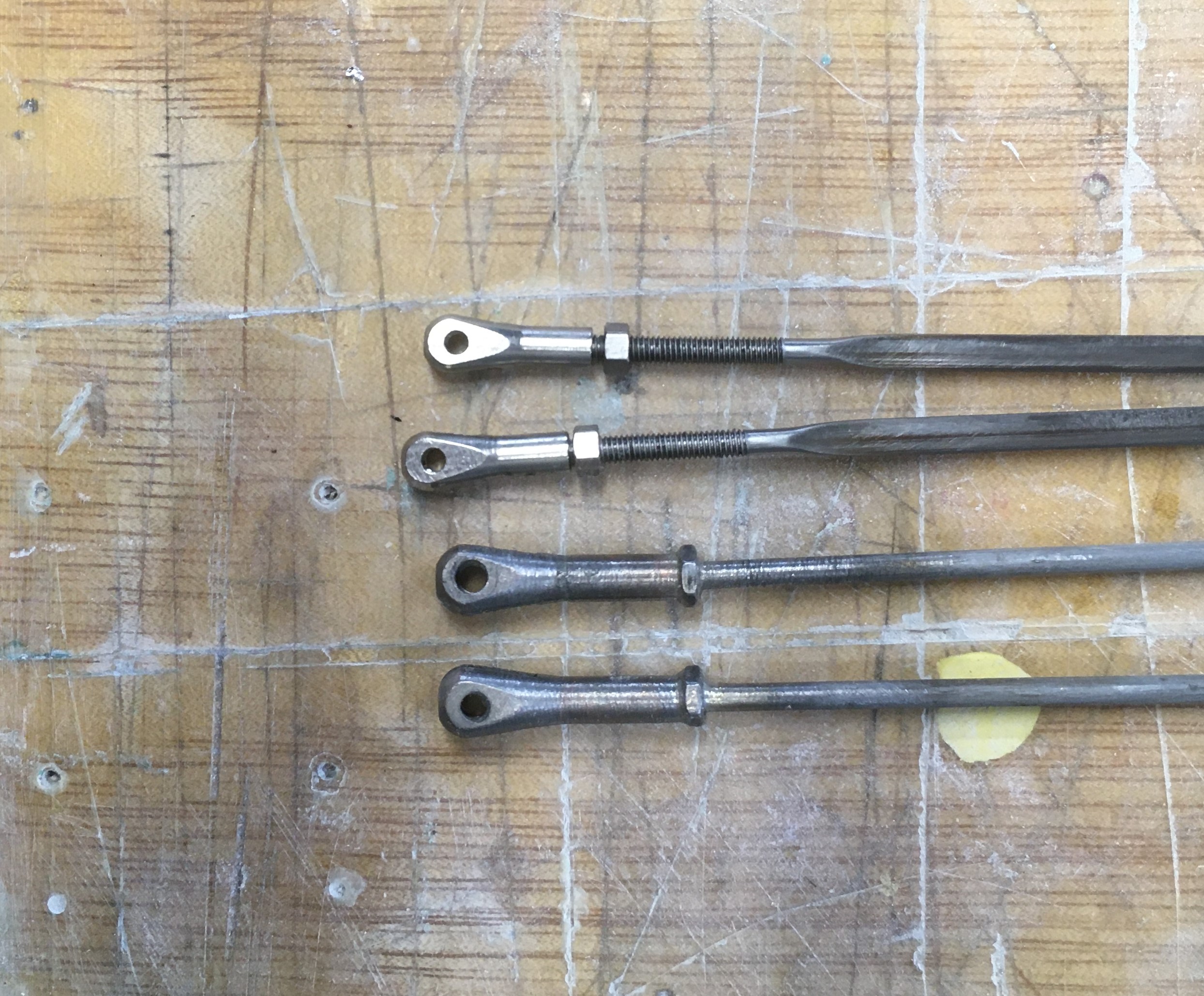

The flying wires arrived today from http://www.flying-wires.ch/flying-wires/index.html, all I can say is they are a thing of beauty in addition lighter than the wires I had previously built. The wires i made were 32 grams a pair while the Aero Scale come in at 18 grams a pairs. I'll be using these again. Plus left and right hand threads so easy to adjust. Might start making the spray area tomorrow mid 60's today, I want to paint some 7AC Yellow.

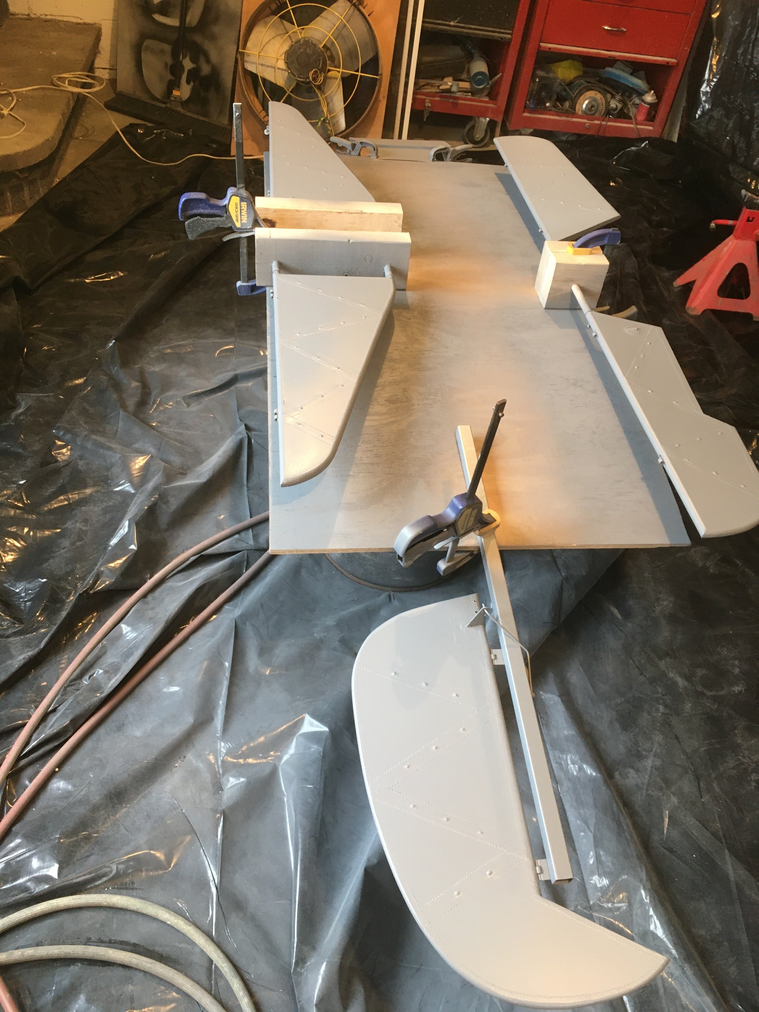

I hung the plastic today and sprayed a coat of Ekofill on the tail plane fabric parts, sand with 320 and one coat of Ekoprime and should be ready for color. The back of my garage looks like a Dexter Morgan cut room. My wife is not happy about that! Tomorrow I may etch the aluminum parts and get a coat of Ekopoxy on those, they should be ready for color then.
