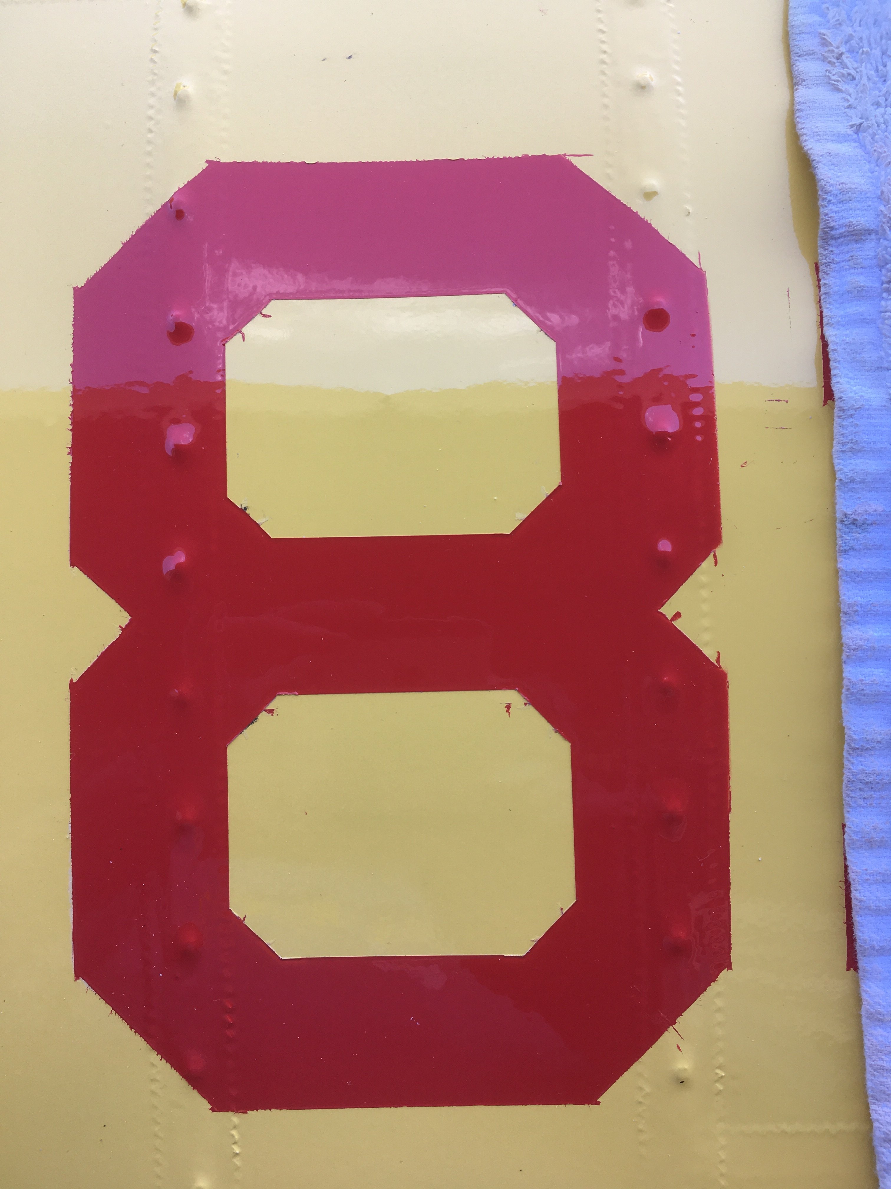

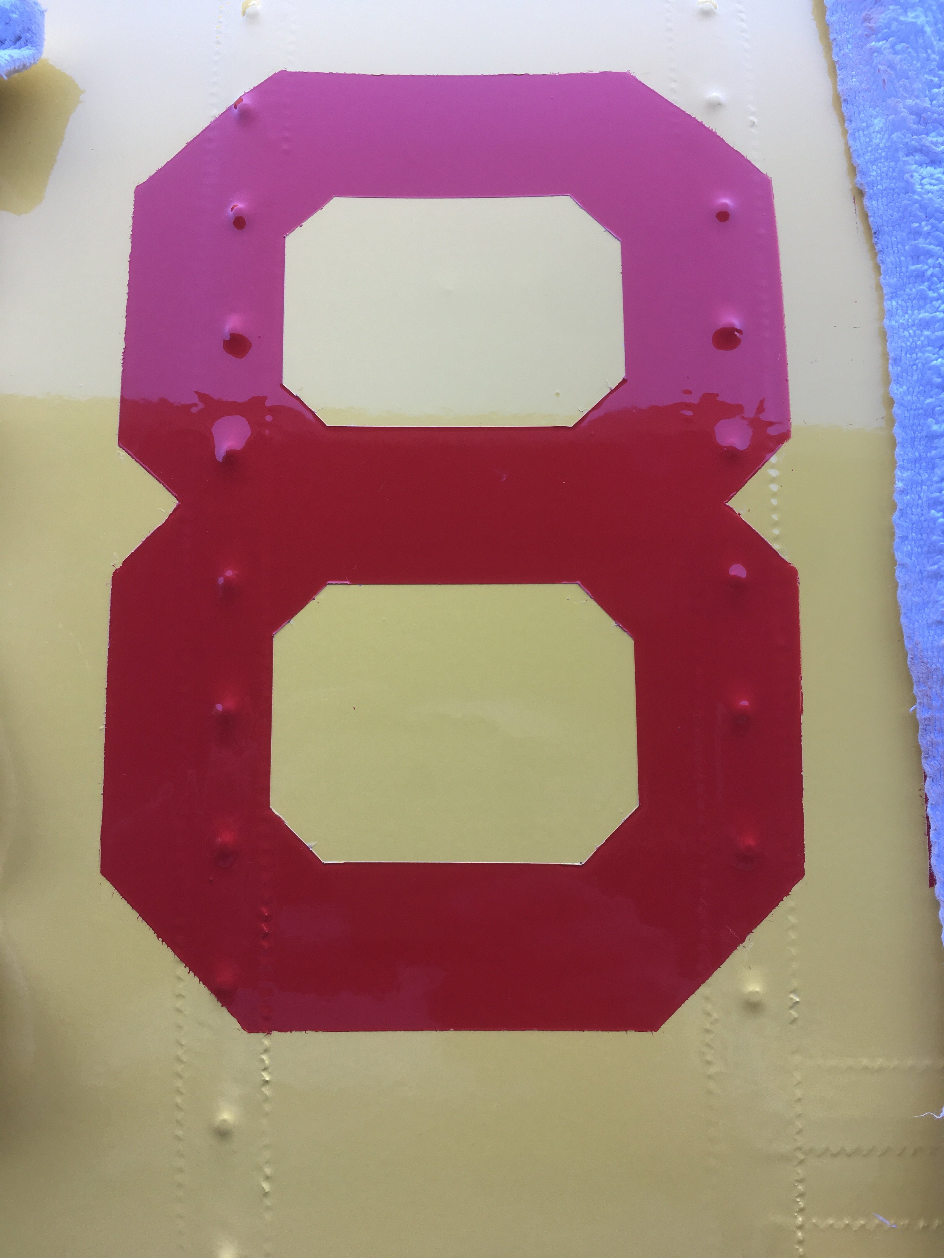

Started cleaning the bleed through on the wings today, before and after of the top number 8.

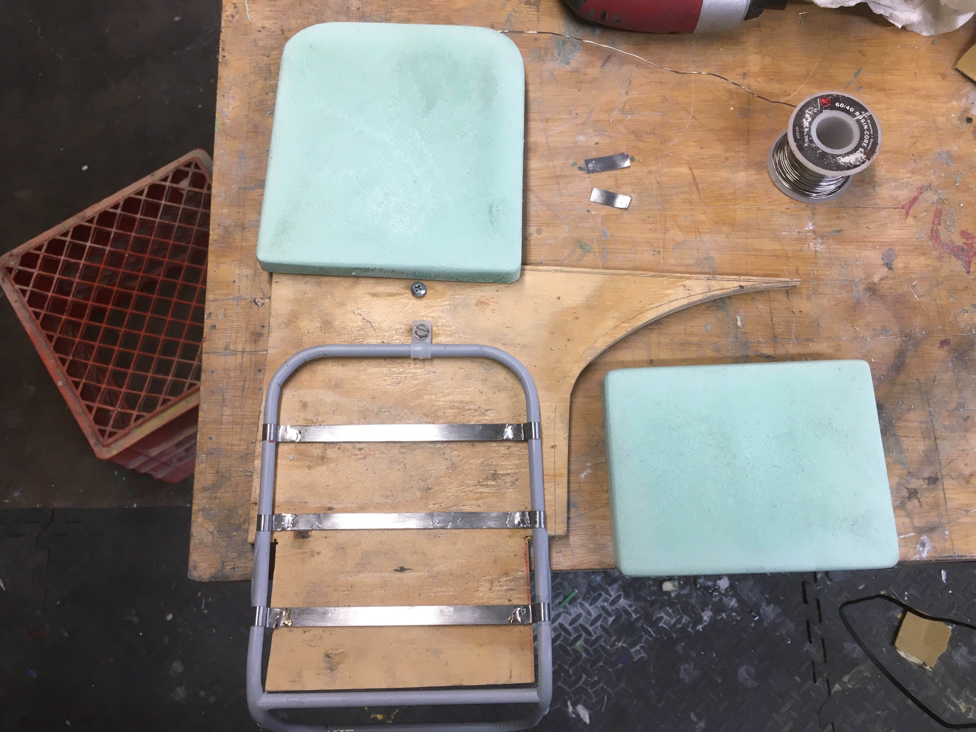

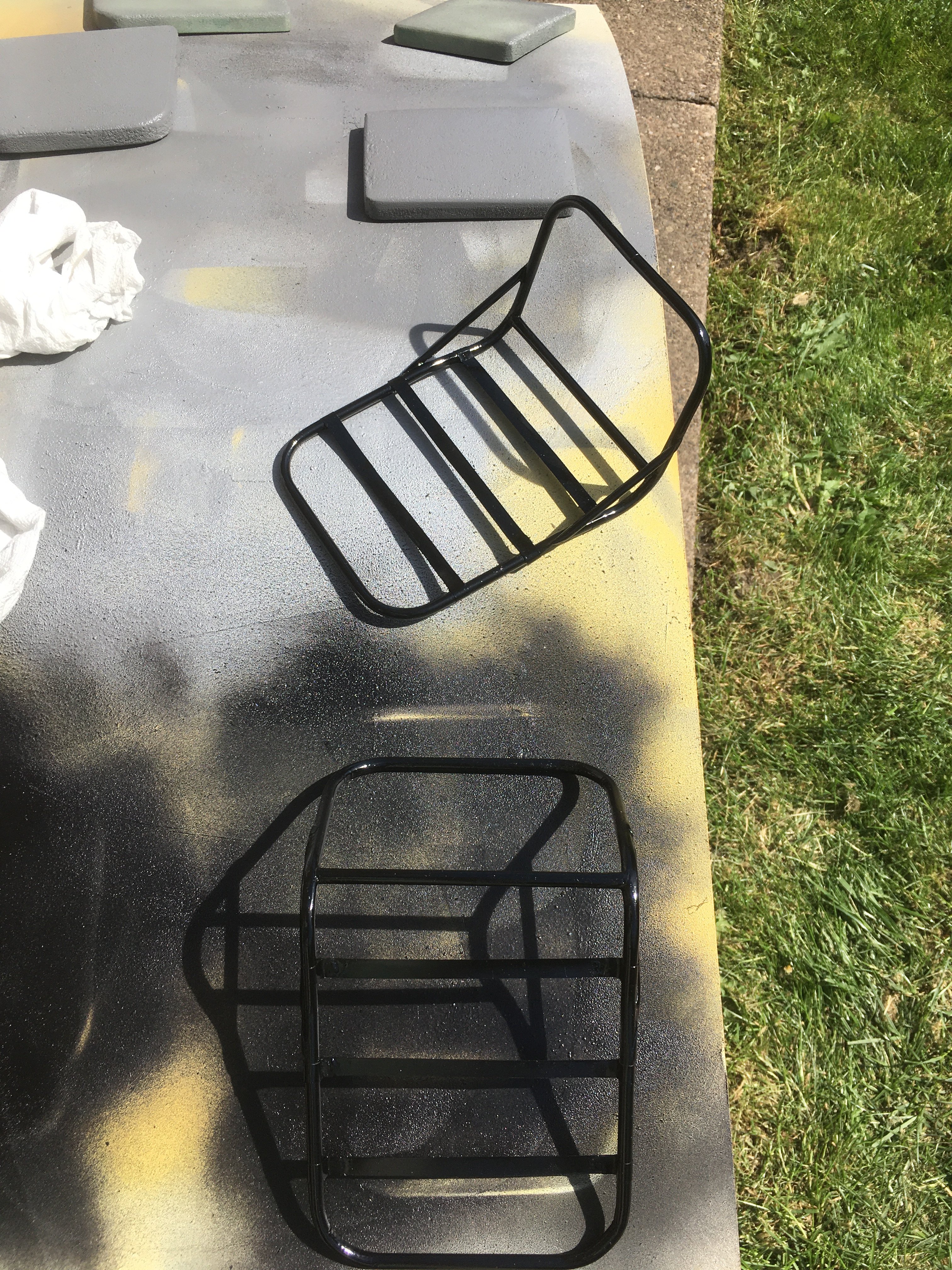

Spent some time on the seats today. I got the seat from i Fly Tallies but it just doesn't match the decor of the Champ so I will use it on a future project. I added the cross straps on the seat frames. The tin came from a gallon of WD40, nice and thin, sharp as a razor! The seat cushions were cut from 2# foam sheeting.

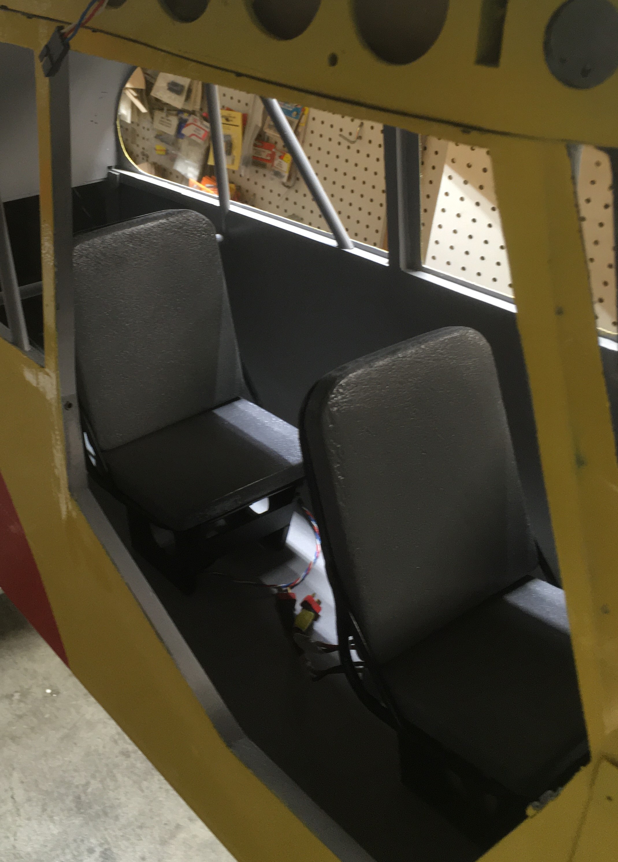

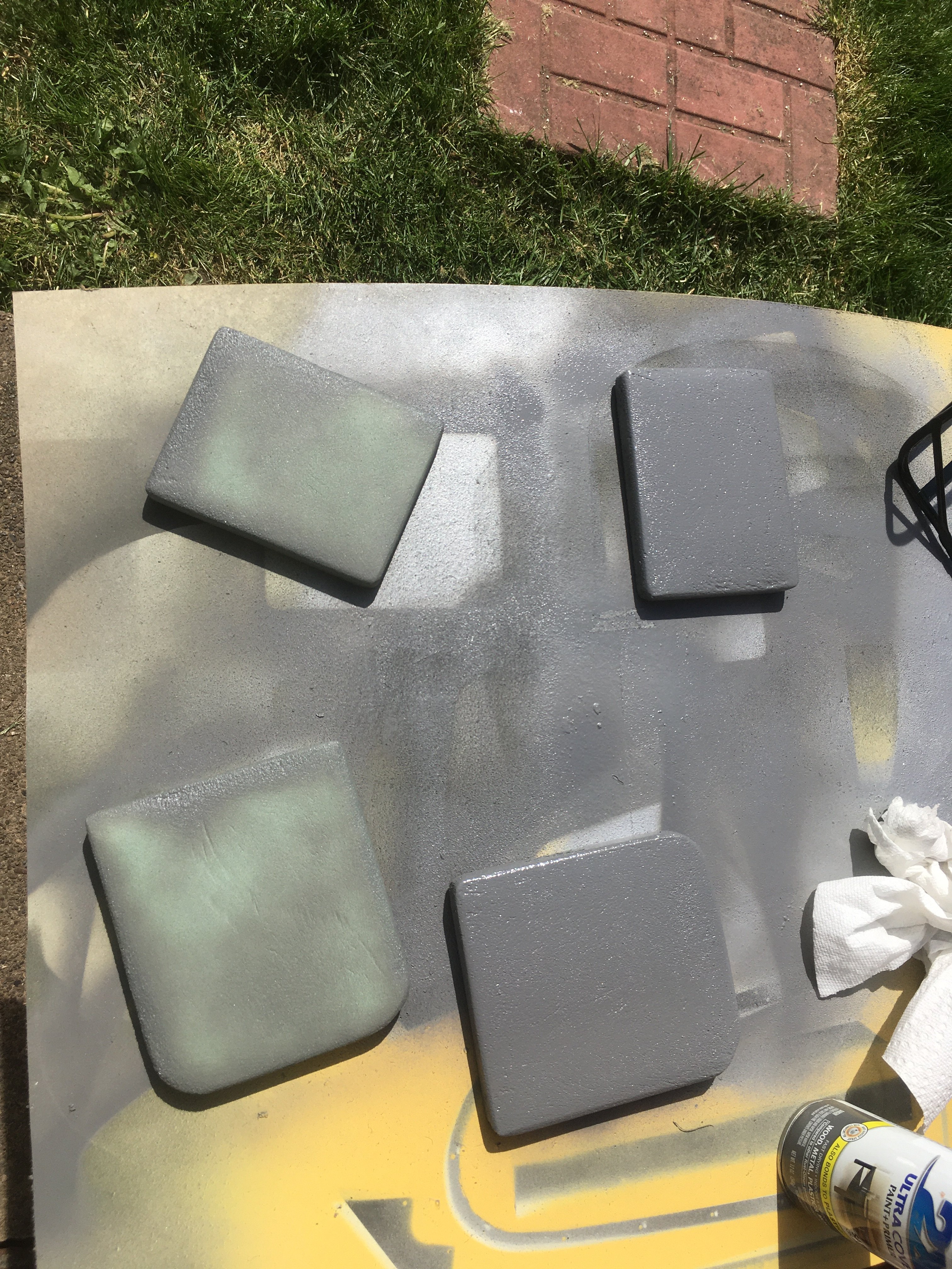

Well my wife's arm is back together and I did manage to sneak in a little work between ice bag changes. The seats are OK but I still looking for other ways to do this. I may wet sand again and apply more paint. It will work until something better comes along. My lighting is poor because three of my Sam's Club 4' LED light fixtures have failed. I had one of the original 8 fail that cost $29/ea. The price dropped to $19/ea and bought 8 more, I believe I'm close to 100% failure rate of the lower cost units, same brand, just lower cost.
