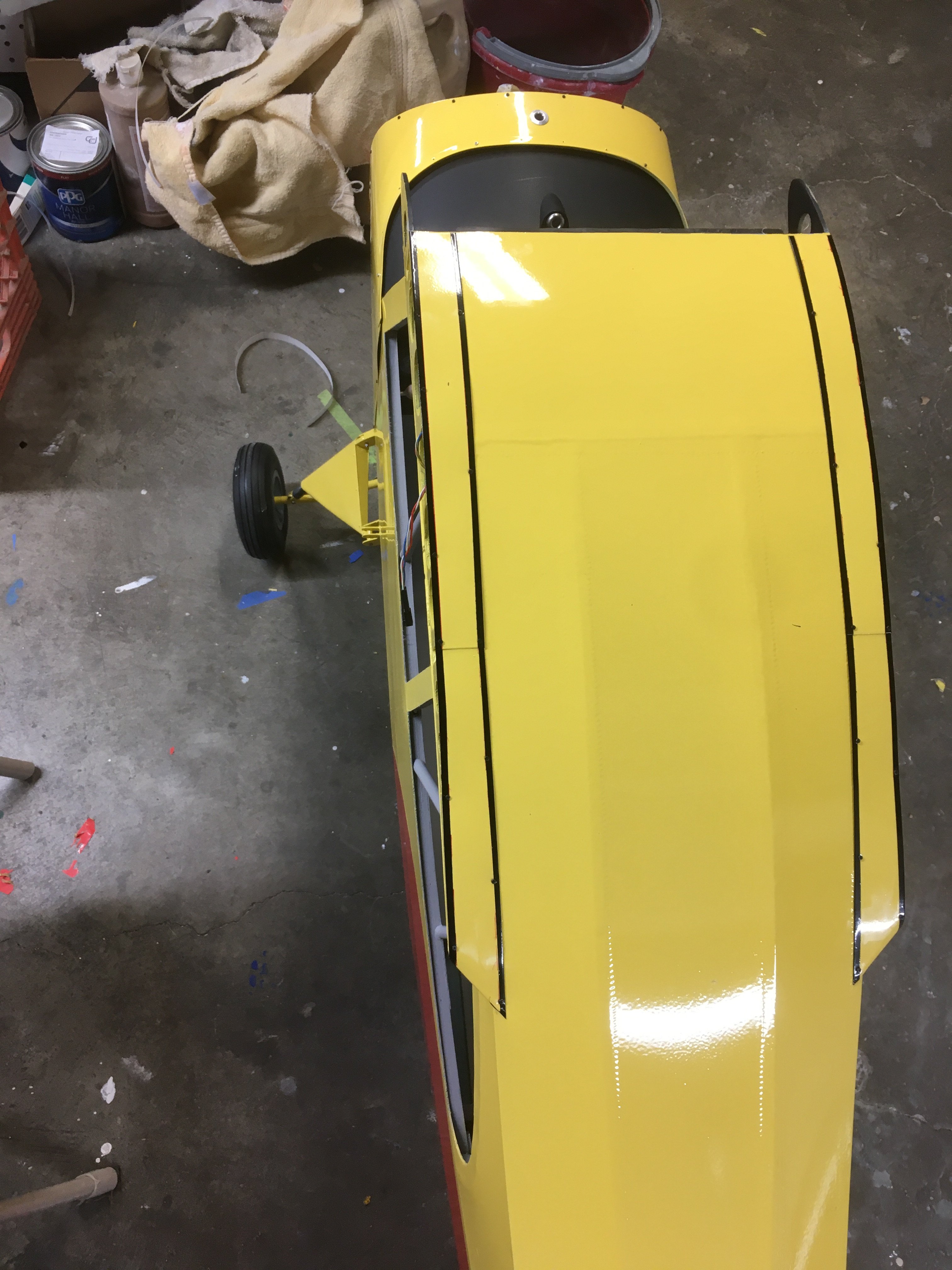

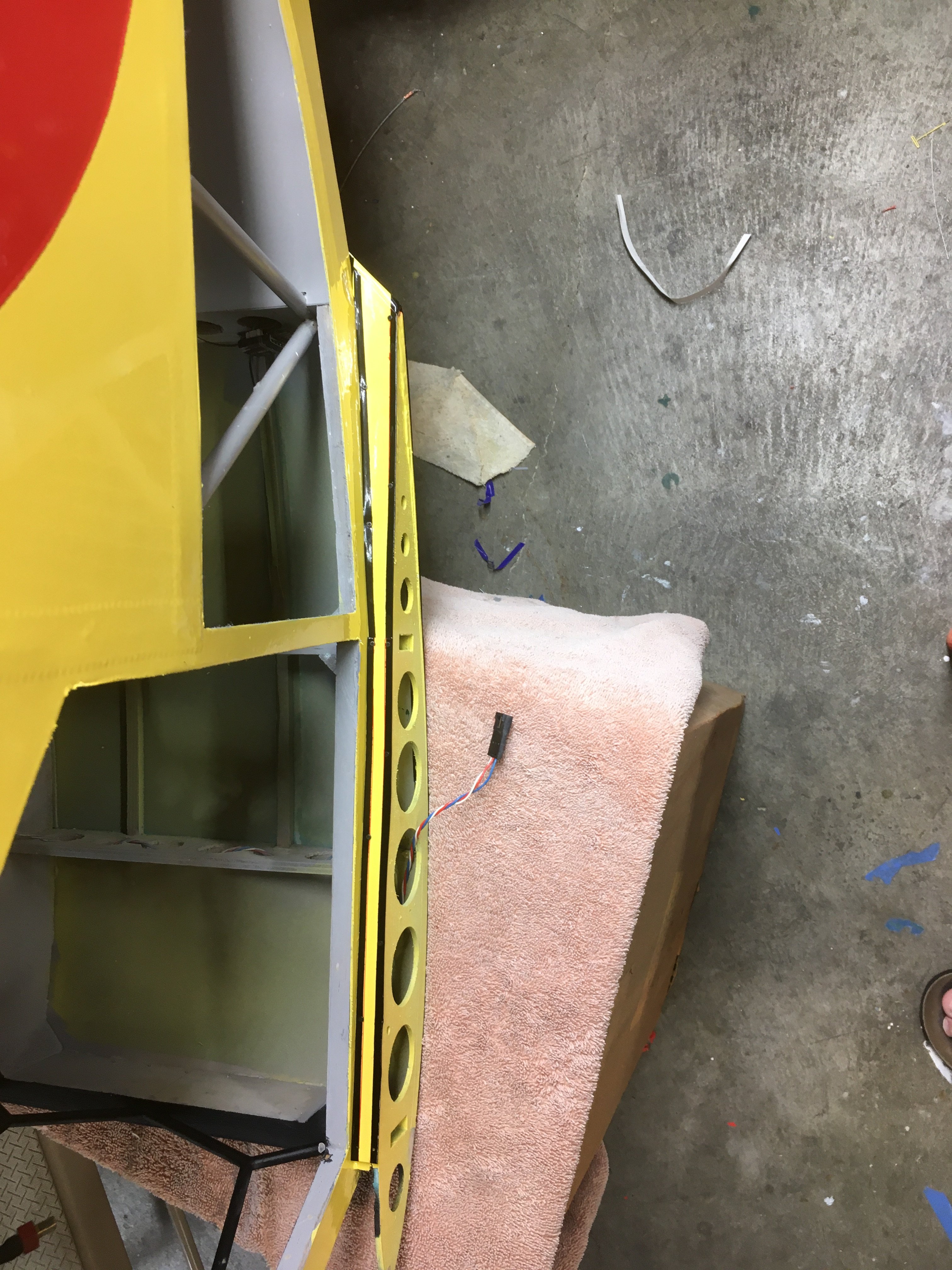

Got a little domestic work complete and squeezed some Champ work. Located the 1/2" black pin stripe that I had ordered. Applied to the aluminum fairing pieces and installed. There is no standard for this seal piece, some planes have it as I installed while some have none. I may remove the bottom and leave the top, it will protect the fabric from the sharp aluminum edge. Will decide once wings are installed.

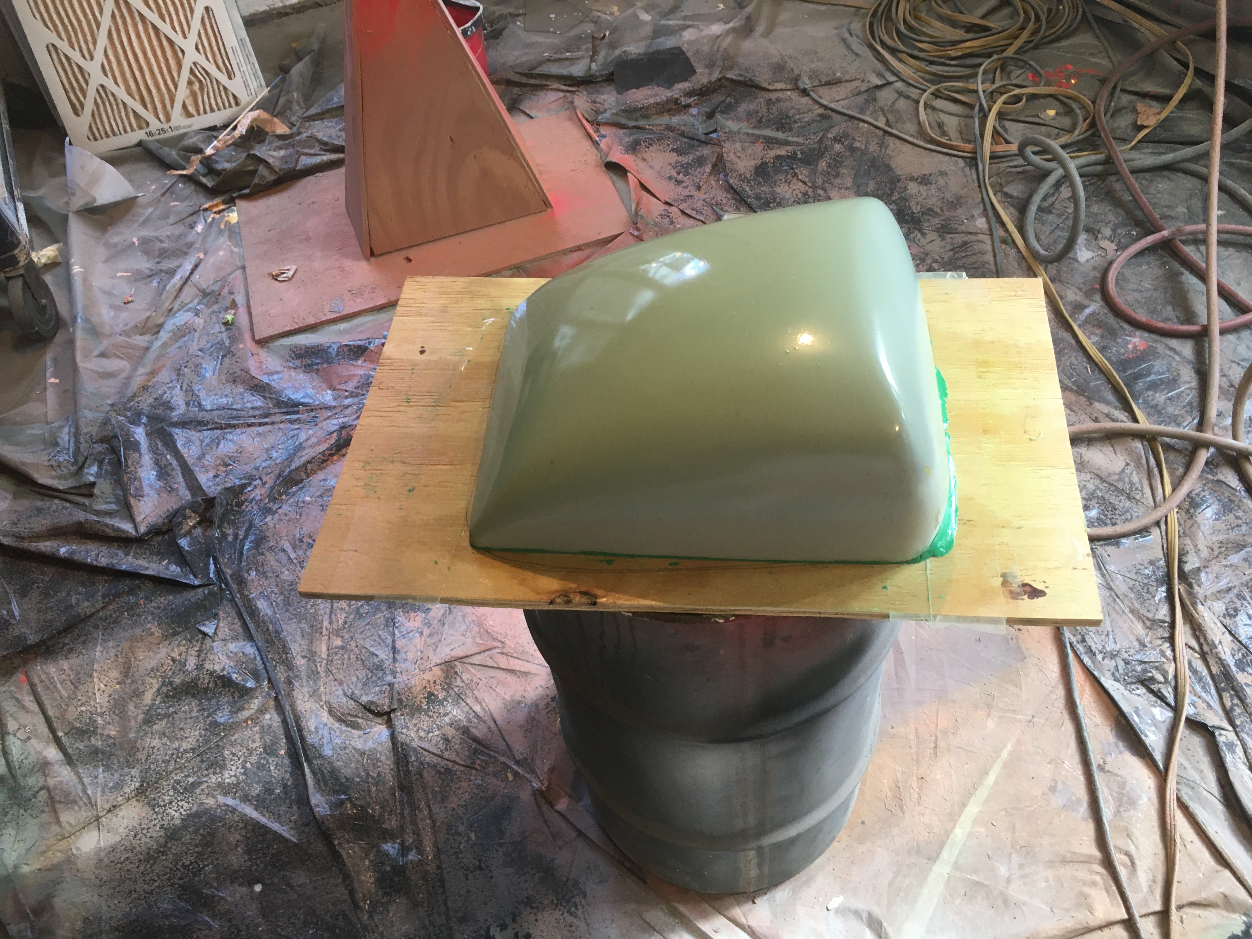

I bought two canopies from the supplier a while ago. I suspect the buck was the original from RCM plans service back in the early 90's, it was OK but not what I was looking for here. I cast a buck the original canopy out of Ultracal 30 and then glassed it and made repairs to the areas needing it. I pulled a canopy and it had little water marks for lack of a better description and the glass cloth telegraphed through onto the canopy. I have since learned the water marks were due to moisture in the plastic and you must hold the PETG at 170f for a while to drive off the moisture. Apparently using glass cloth on vacuum form bucks is a problem so a lesson learned as well. Need to make a new plaster buck. I'm going make a fiberglass mold of the repaired buck the cast a new plaster buck from the mold. I sprayed the PVA on the buck this afternoon. The PVA is over 30 years old, was left over from a project at work, still good? I hope so!
TonyHallo
You and me both. I hope it is repaired for the last time. I attempted pulling a .040" polycarbonate sheet over the plug and damage the plug and the plastic sheet frame, tuff stuff, have 5 24" x 32" sheets that I'm not sure what I will do with. I may try the pull again after I get a good PETG canopy, don't know. The failed part was very strong, don't believe it would crack in use, had high hopes for it.
I put a coat of epoxy resin mixed with carbon on the plug yesterday evening and have 3 layers of 6 ounce cloth over it now. I think one more layer of 6 ounce and it will be done.
