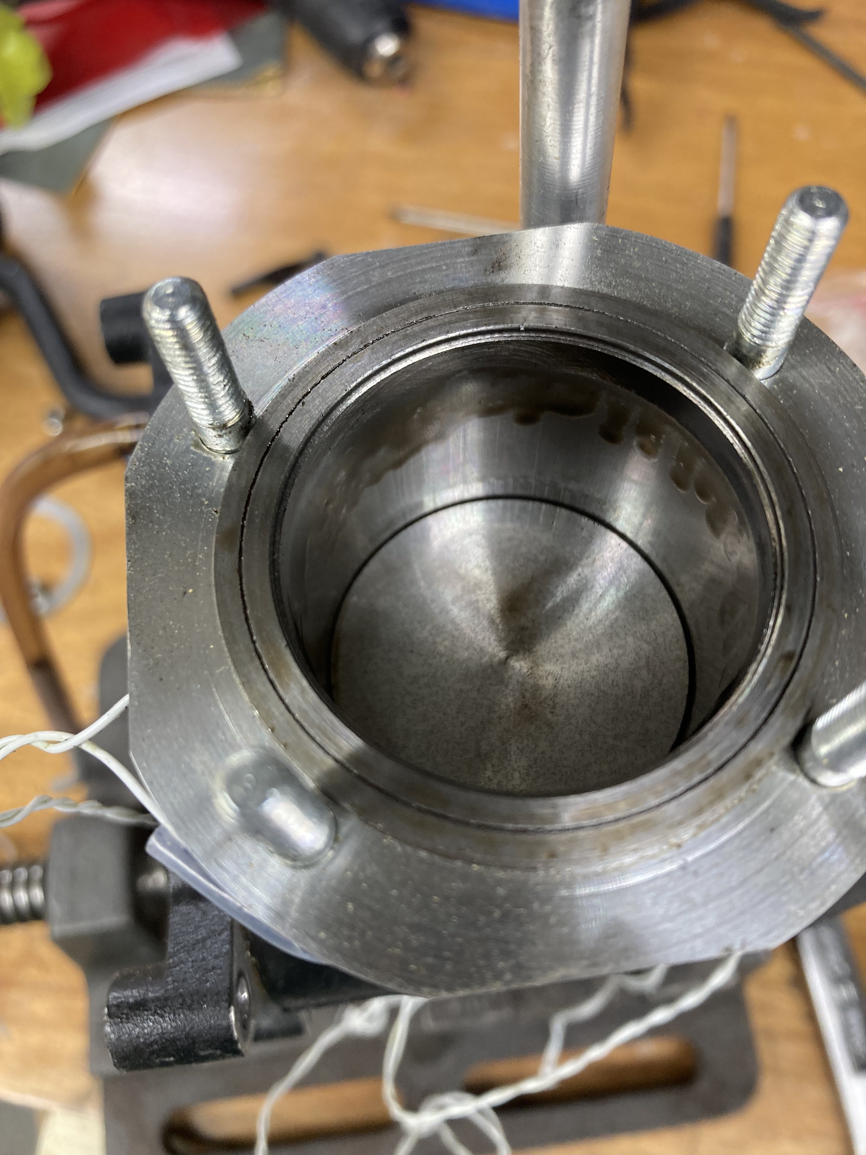

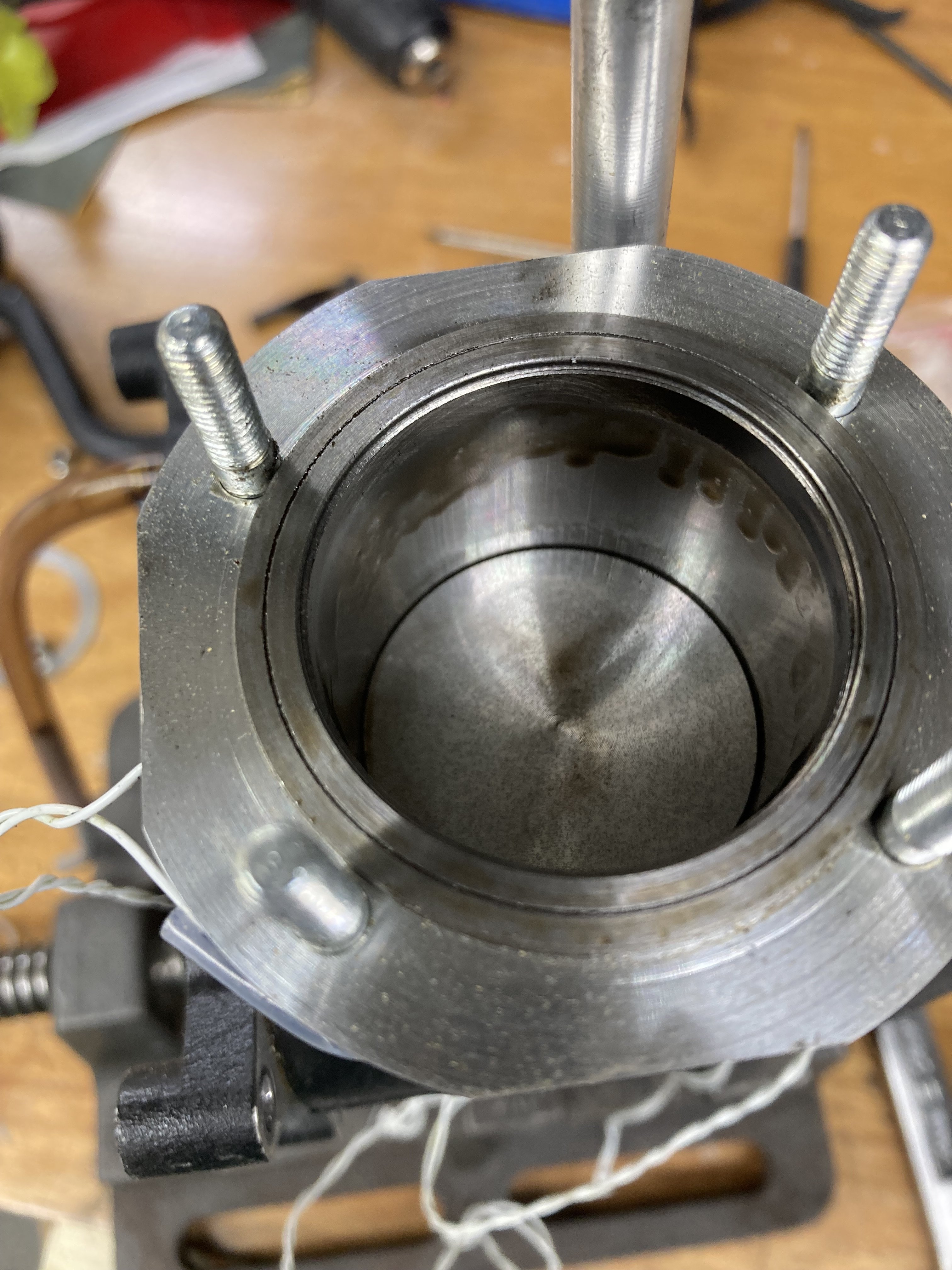

Picked up a miss in the engine, seems to be getting worse as time goes on. Decided to check the plugs. It appears the left cylinder is getting more oil than the right. I know when I took the left cylinder head off there was plenty of oil in the cylinder after sitting for almost a year. Note oil drops at top of cylinder.

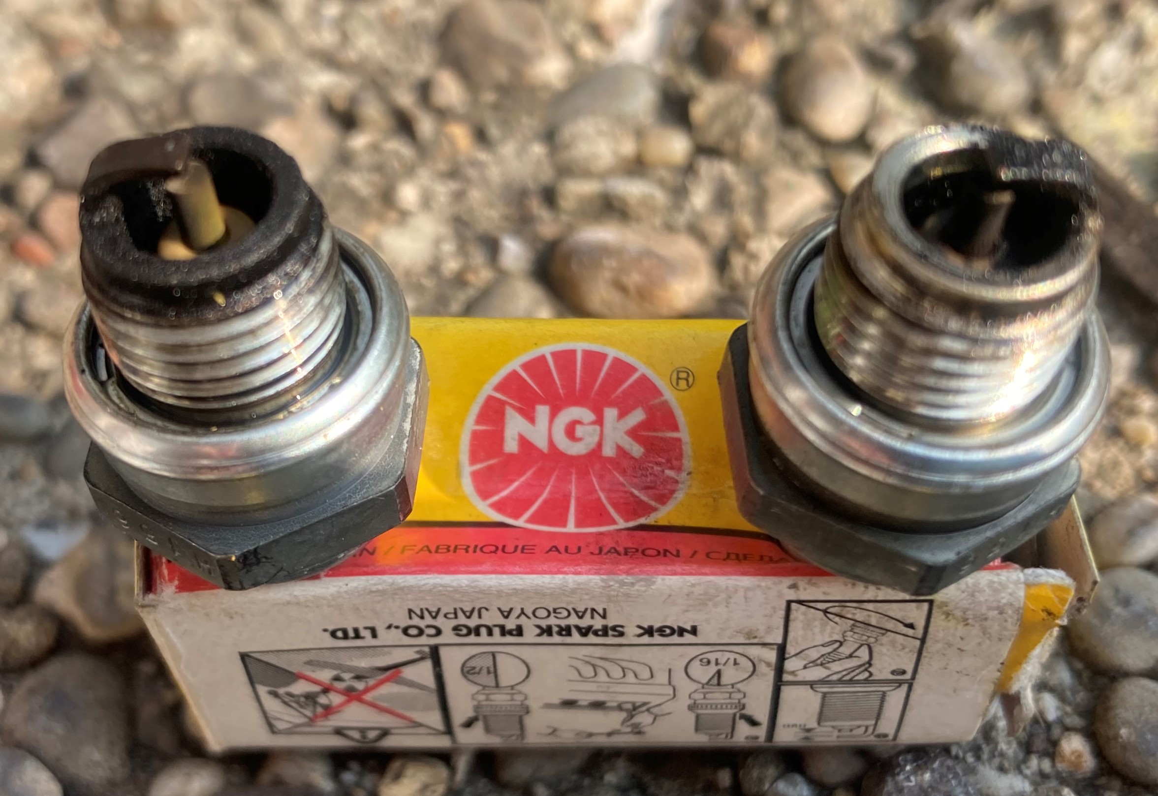

This is what the plugs looked like. The right side plug looks good while the left side is oil fouling. The engine idles and ran good at full throttle but would miss at cruising speed. At any rate put two new CM6 plugs in this morning and I'll see what happens later today. May need a slight carb adjustment as well but it sounds good at idle and full throttle
I have question before I try to help, do you believe the colour spark plugs charts work or indicate properly with our engines with the amount of oil we use. And yes I agree with you that one cylinder is oily and not burning as clean as the other. Be interesting to see what two new plugs will do. If I may suggest only change the oily one. You could have some oil blow by on the one cylinder or a sticky ring.
looking at the pictures again the oily plug the outer top part is clean and bright why? That is confusing me.
