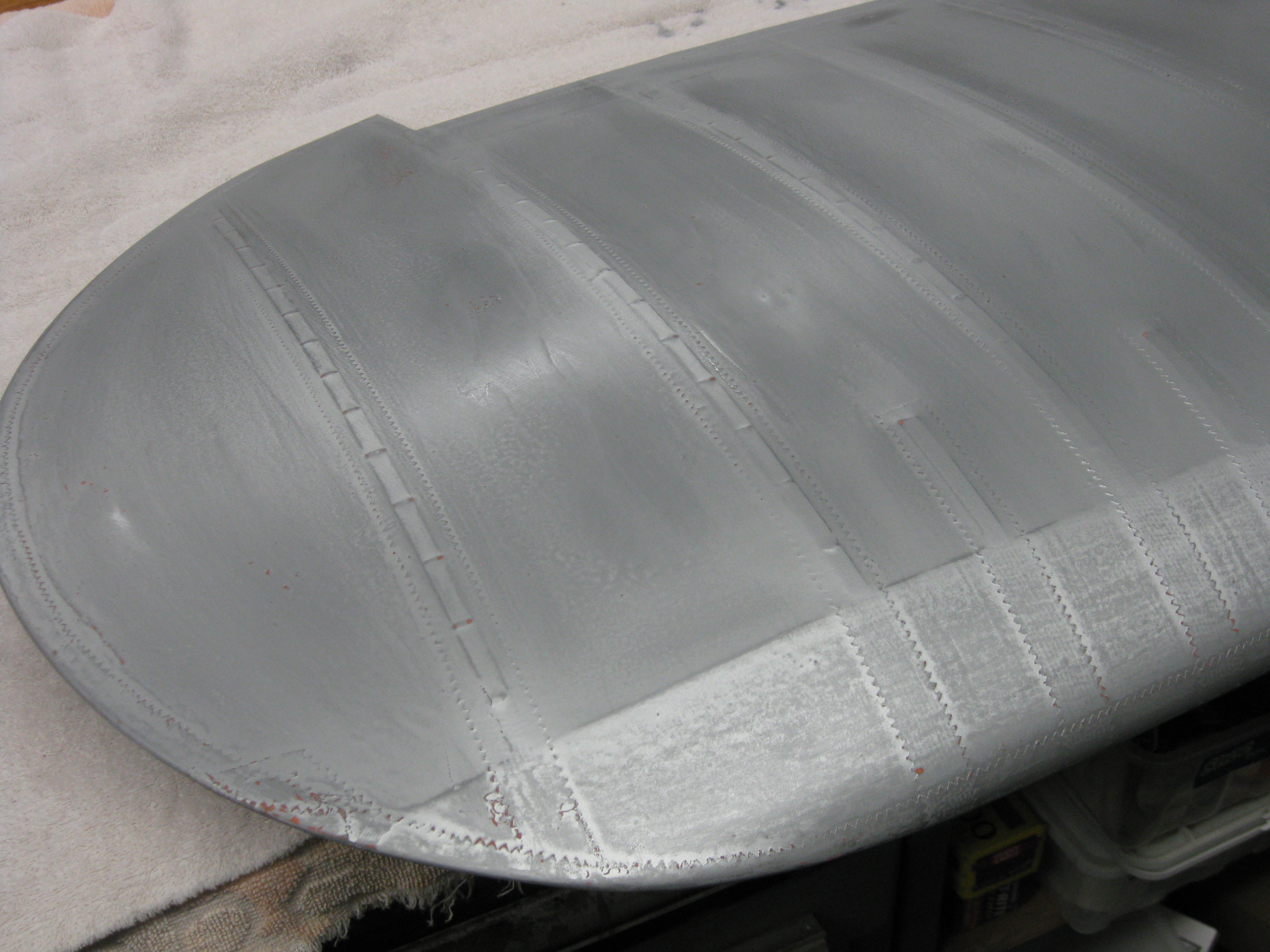

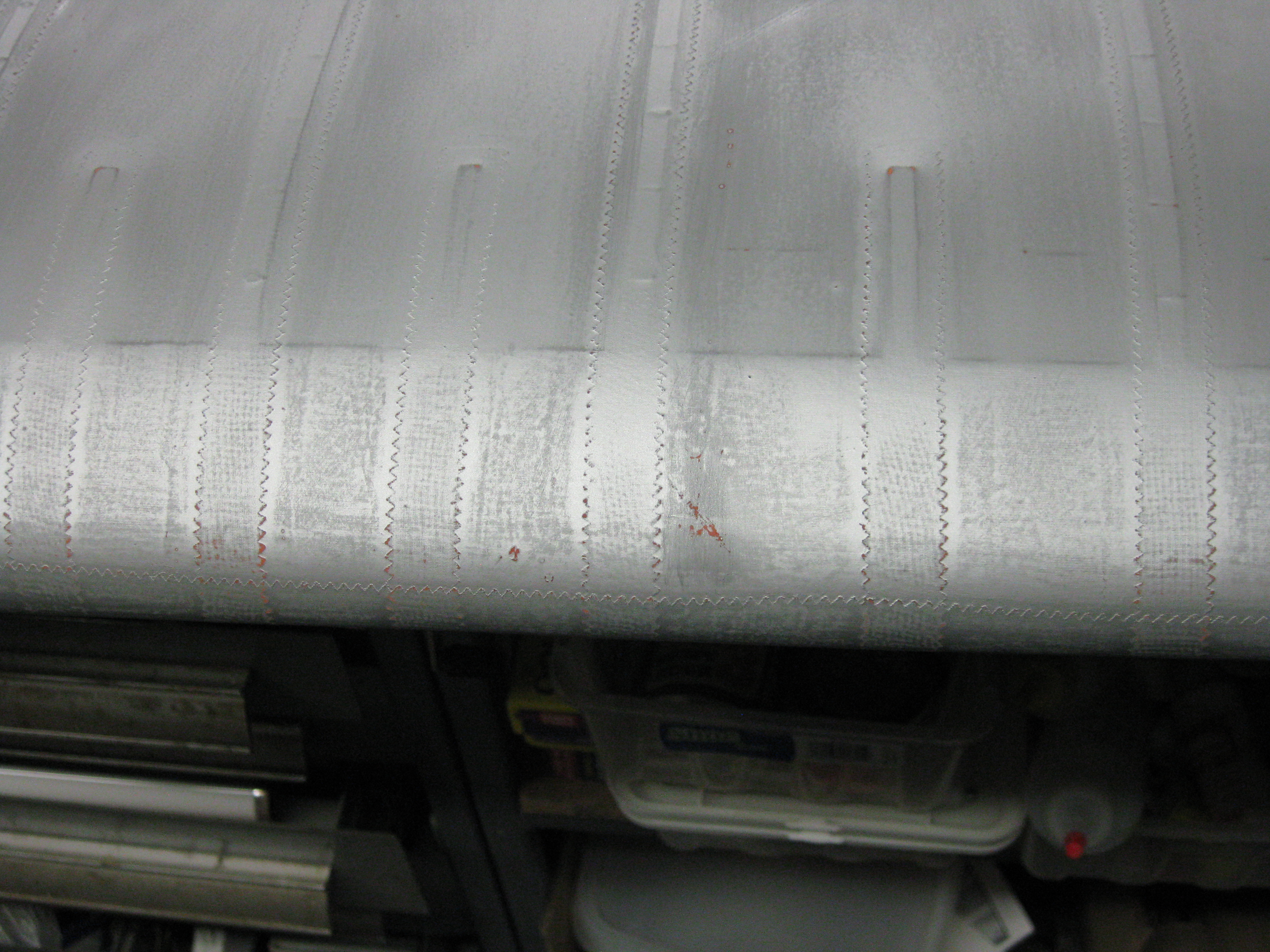

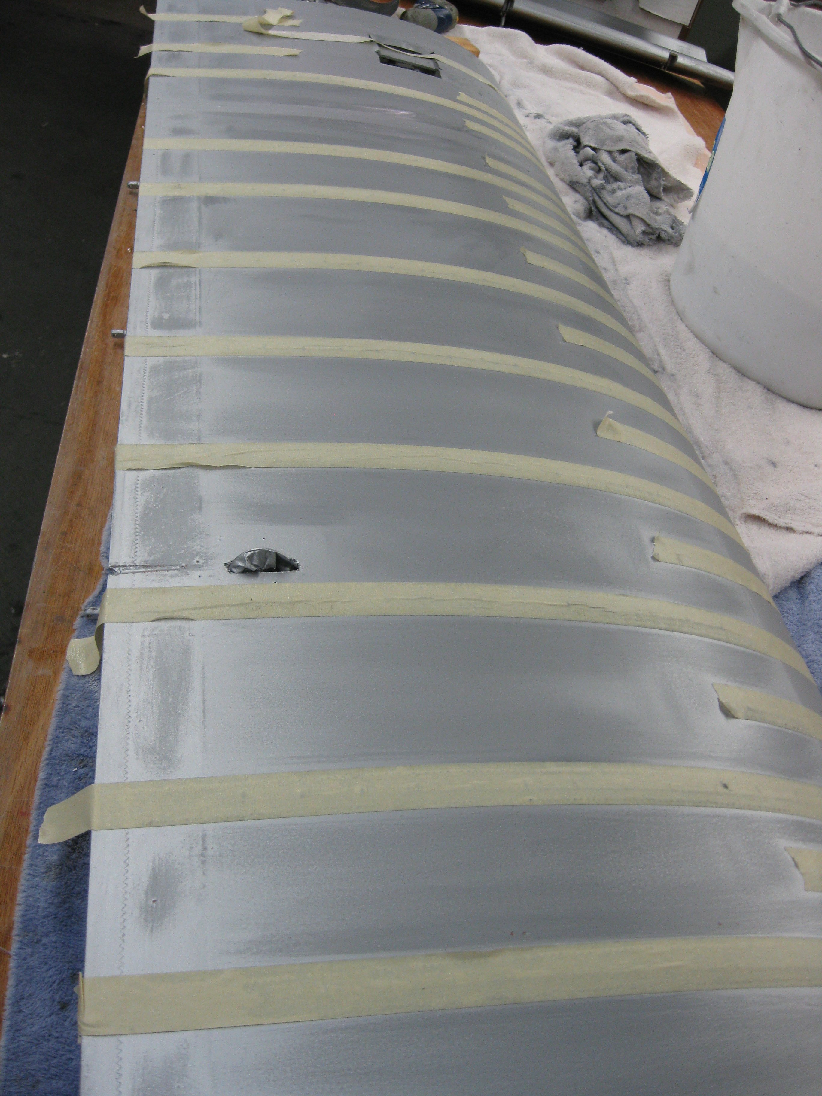

The thing about the aluminum coat is that you can sand the blemishes out. The Poly Brush is like rubber when dry and impossible to sand while the silver Poly Spray sands nice. Once the silver is on you get to see what the final product will look like and made any corrections. I put a coat on and then sanded where there were problems, the just spot torched up those areas. When you add the pinking tape that makes a whole lot of nooks and crannies, the silver coat shows the defects better.
If i were worried about the final weight I would consider consider Monokote, if you want a scale finish then you have be willing to accept some additional weight. I never used the Poly Tone paint, you may be able to spray a coat on and sand out the blemishes then put on a final color coat.
A friend had a model finished with it and I didn't care for it.
TonyHallo
Here are a few photos of the silver coat after sanding.

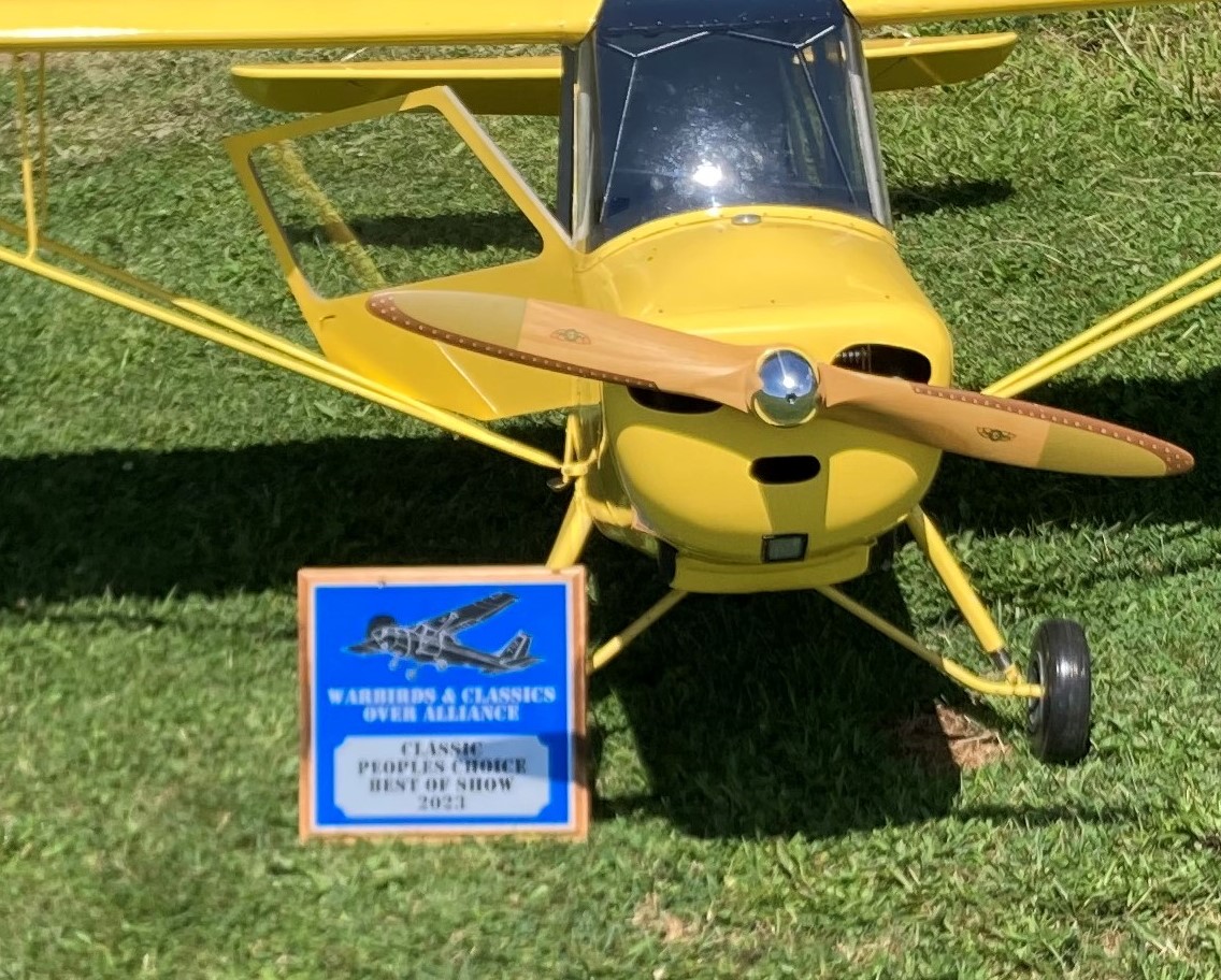

Flew the Champ at "Warbirds and Classics Over Alliance" today. Put the plane together and started BS'ing. Watched several folks fly. Found a willing spotter and fired up the Champ. Taxied out, took off and gained attitude, as the plane approached the down wind leg it quit. Completed a beautiful dead stick landing. Pondered for a while and decided to take top of the cowl off. As i began removing the screws I noticed the fuel filler and realize I never fueled it up! Put the flew screws back in, filled it up and flew.
They awarded 6 different awards, Pilots Choice, Peoples Choice, and Best flight in class. The Champ brought home the "Classic Peoples Choice Best Of Show" award!
