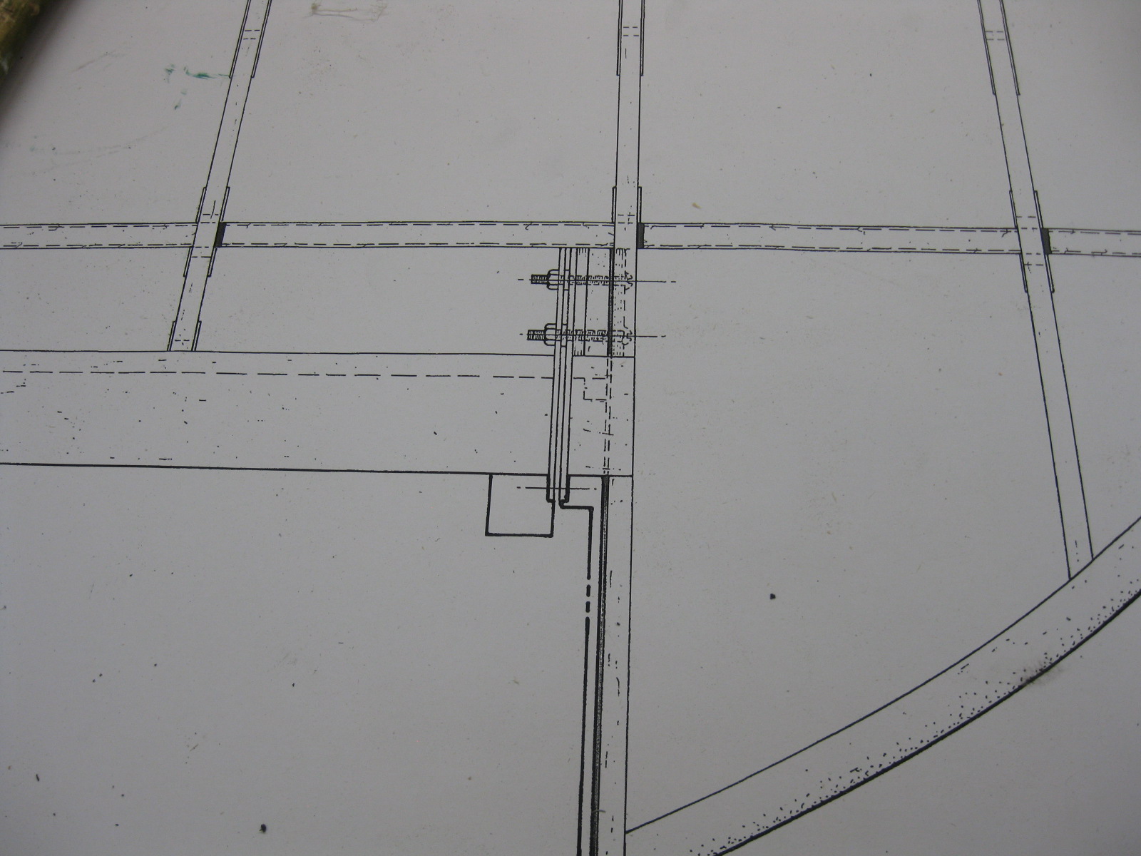

I was never crazy about the aileron hinges shown on the plans, a piece of 1/16 aluminum sheet running on a 4-40 screw, just seemed that these would develop slop in short order. About a week ago was reading a post on how to install C. B. Associates strap hinges and I remembered that I had won a package of these as a door prize some 30 years ago. I found three of them in my hinge drawer, yes I keep them all these years! Got to looking and decided that the straps would make a much better hinge. The straps are glass filled, the knuckle is 1/4" in diameter, 1/4" long, bushed with a 9/32" piece of brass tube, the hinge pin is 1/8" brass tube. I was 1 strap short but MECOA K&B has bought the line and continues to supply them, in shipping as I write. The plan hinge is shown below.

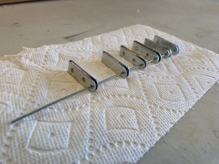

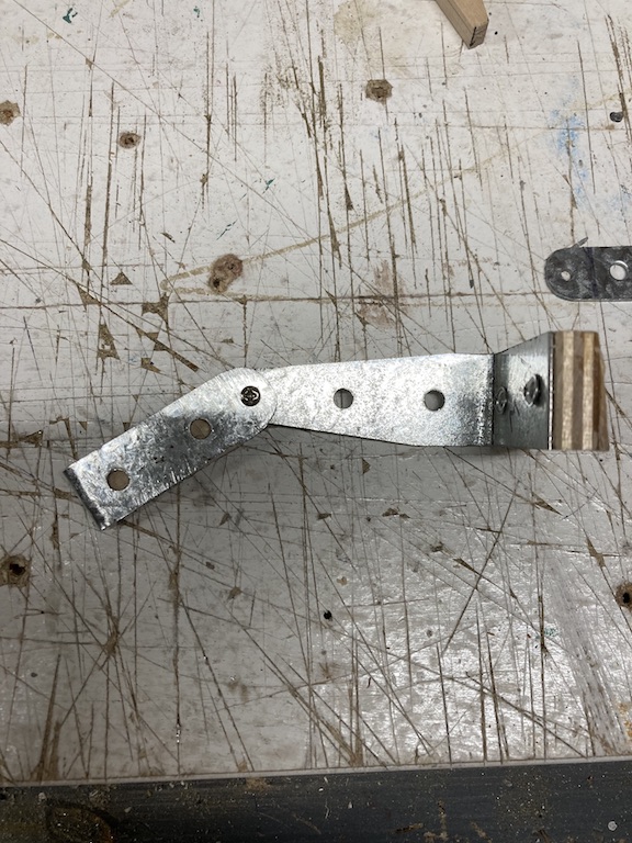

Hi Tony. How's the build going? I made these hinges based on the full-size ones on the Chief. They're galvanized steel 1/16" thick with a small ball bearing press fitted into them. the aileron side is the same material bent around a wood filler piece. It will be encased in epoxy before being epoxied into the aileron.

Welcome to GSN Gorilla Toast. Your hinges look very scale like, nice work. I'll keep an eye on your build over over on RCSB.
