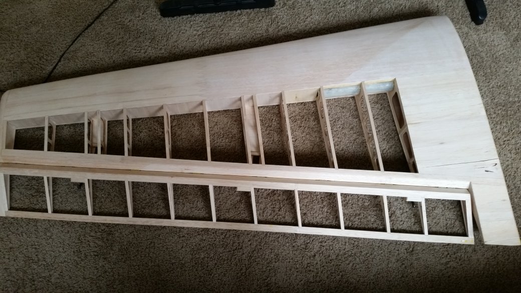

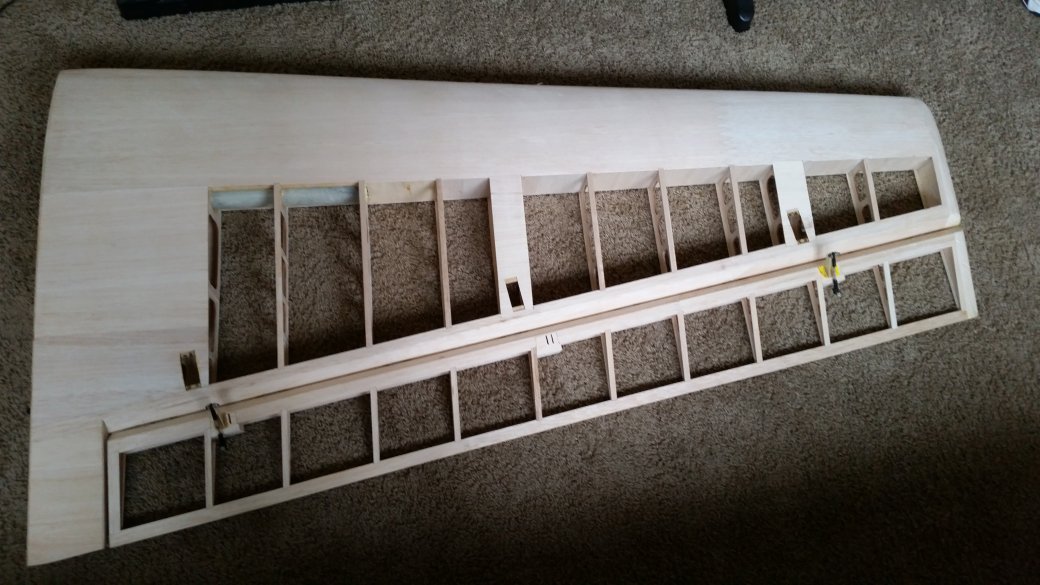

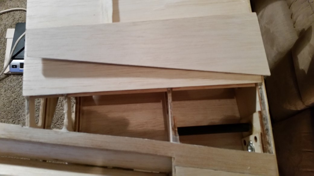

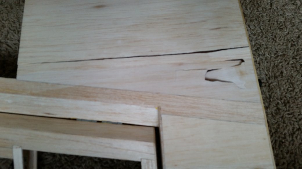

Got the repair cut out...

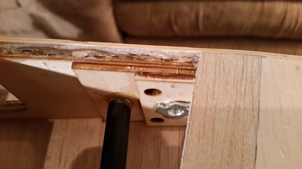

Cleaned the glue joints and added sheeting supports...

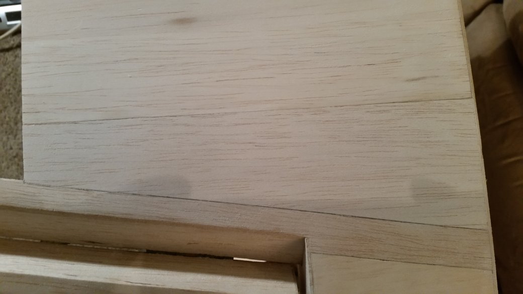

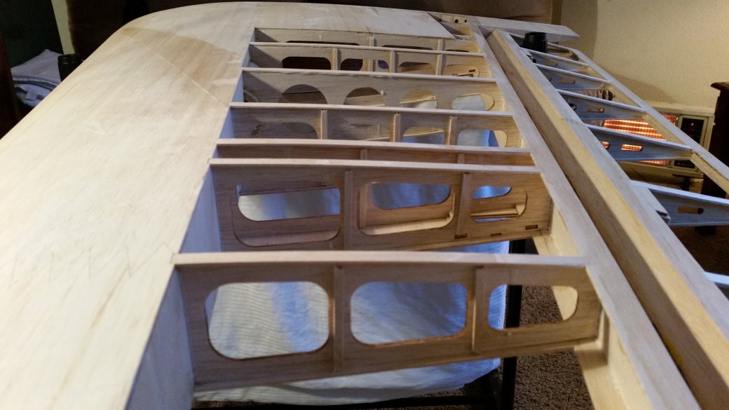

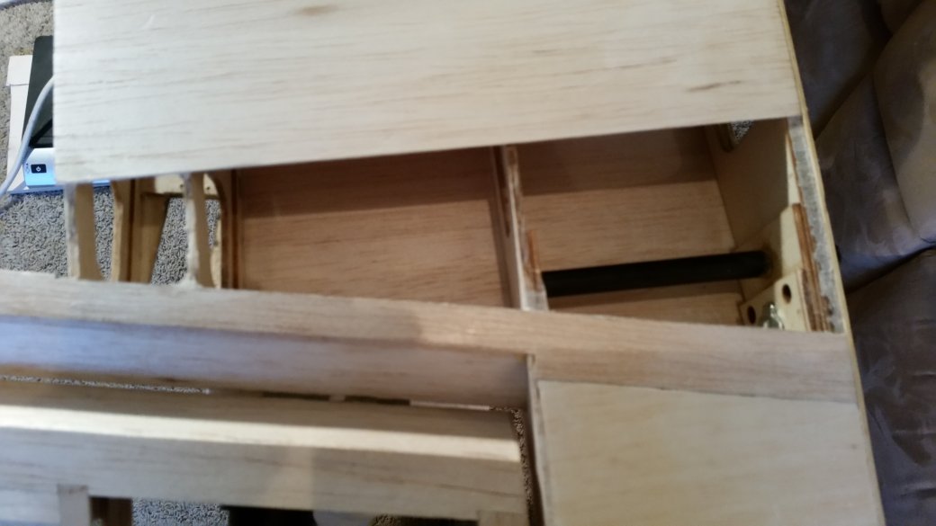

Cut and shaped the replacement section...and ready to glue in section.

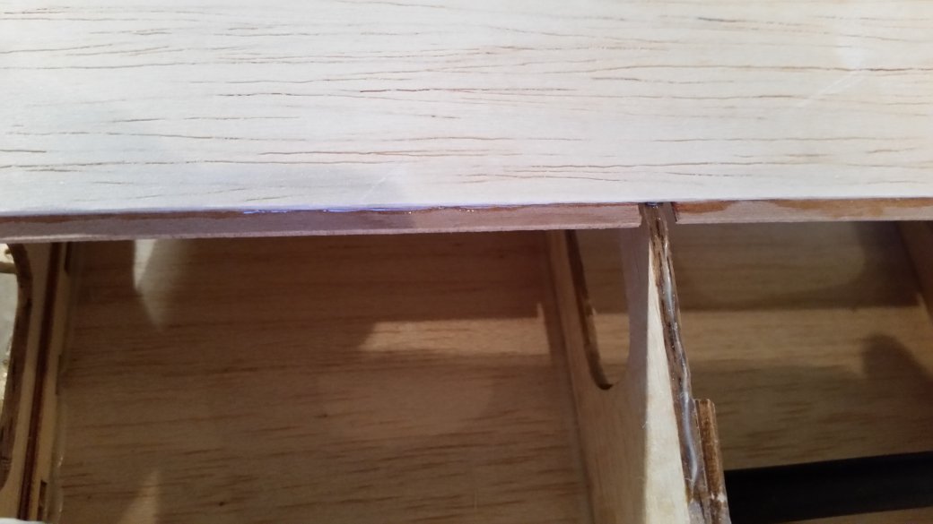

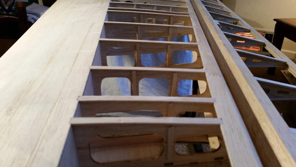

Once glued in and sanded, I almost could not tell if it was repaired or factory done.
After a quick once over to check for any other flaws and a quick sanding...the left wing panel is now ready for covering.
As a side note, I really like the construction of these Pilot airframes. Light but definitely built well.
