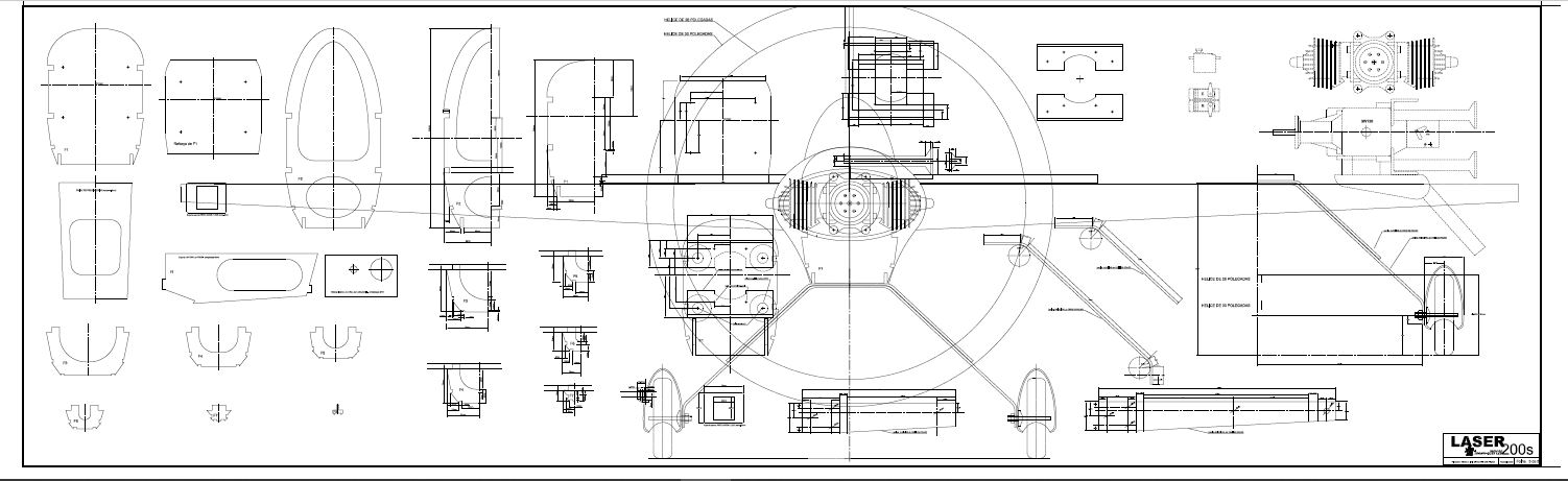

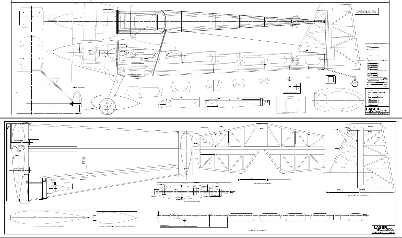

These are drawings I am using

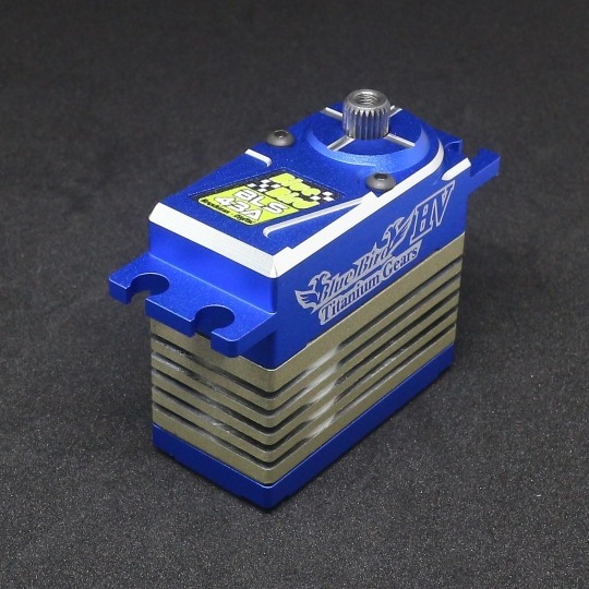

also will be using Bluebird 43A servos
Specifications
Torque At 6.0V 35.5 kg-cm / 493.1 oz-in
Torque At 7.4V 43.8 kg-cm / 608.4 oz-in
Torque At 8.4V 49.7 kg-cm / 690.3 oz-in
Speed At 6.0V 0.13 sec / 60°
Speed At 7.4V 0.11 sec / 60°
Speed At 8.4V 0.10 sec / 60°
Protection Mechanism
Soft Start Protection Soft start to neutral position.
Over Voltage Protection Over 9.0V drive the protection mode and 8.4V return to normal mode.
Low Voltage Protection Lower than 4.0V, drive the protection mode and 4.5V return to normal mode.
Locked Rotor Protection Stall in 5 sec, output torque goes down.
Temperature Protection Overheat 85 degree C, drive the protection mode and down 75 degree C
Power Supply
Operating Voltage Range 4.5V ~ 8.5V ( 4 ~ 6 Cell Ni-MH or 2S Li-Poly / 2S Li-Fe)
Standard Full Aluminum Servo
Control System Digital Controller / AD 12-Bits Resolution ( 4096 Steps )
Dead Band Width 0.001ms ( Default:1us)
Mechanical Specifications
Ball Bearing Dual
Gear Titanium Alloy Gears
Motor Premium Taiwan Brushless Motor
Horn / Gear Spline 25 Teeth ( Same as F-Type )
