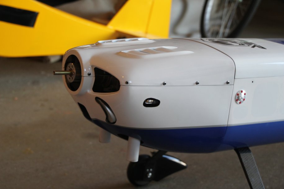

Are the screws prone to loosen on the split cowl? What about the use of washers, o-rings or loctite, is this necessary?
ericb
Team WTFO
Like this.
sweetpea
I put a dab of blue Loctite and the bonded washers.....overkill but I only take my cowl off if there is an engine issue or at the end of a season to clean things up and go over everything.
