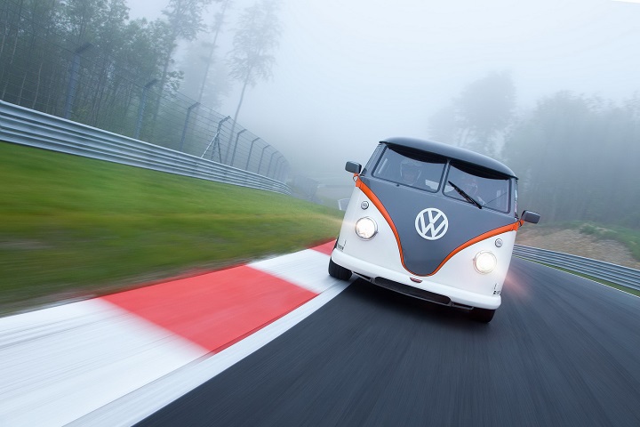

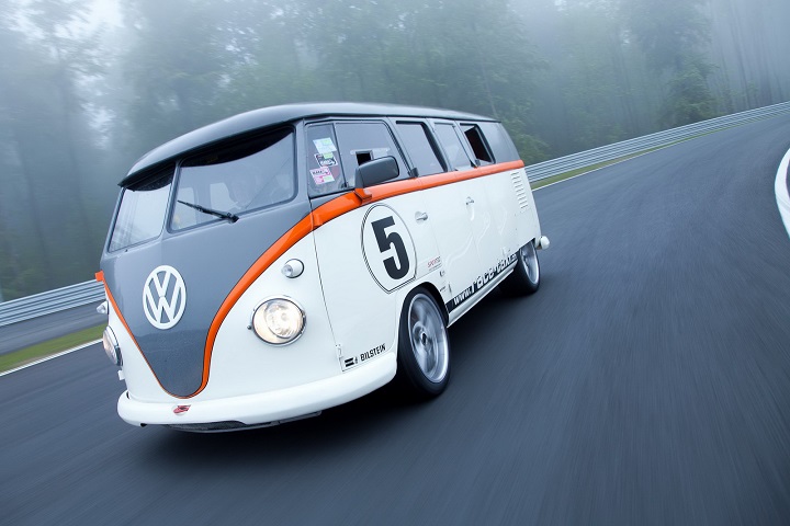

Anyone else a VW Split Window freak like me?
Dang I want this one!
This 1962 Volkswagen Bus was once a rusted hunk of metal. Until Swiss coachbuilder Fred Bernhard got his hands on the thing and spent six years turning it into a whole new vehicle. Instead of the engine it was born with, this Volkswagen has an engine straight out of a Porsche 993.
An air-cooled 6-cylinder with 523 horsepower and 558 lb-ft of torque turned the bus into the Volkswagen Bus T1 Race Taxi. It has two turbochargers and is paired to a 6-speed manual gearbox. The bus also gets steering and brakes from the Porsche 993. It all rides on three-piece BBS racing wheels with 285/30/18 tires.
Xpress
I'd love to have a 21 window for hauling gear. I'd probably have to sell both my nuts, a couple fingers, a kidney, and my big toe for one though..
Be cool for traveling to events with the right touches to it..
