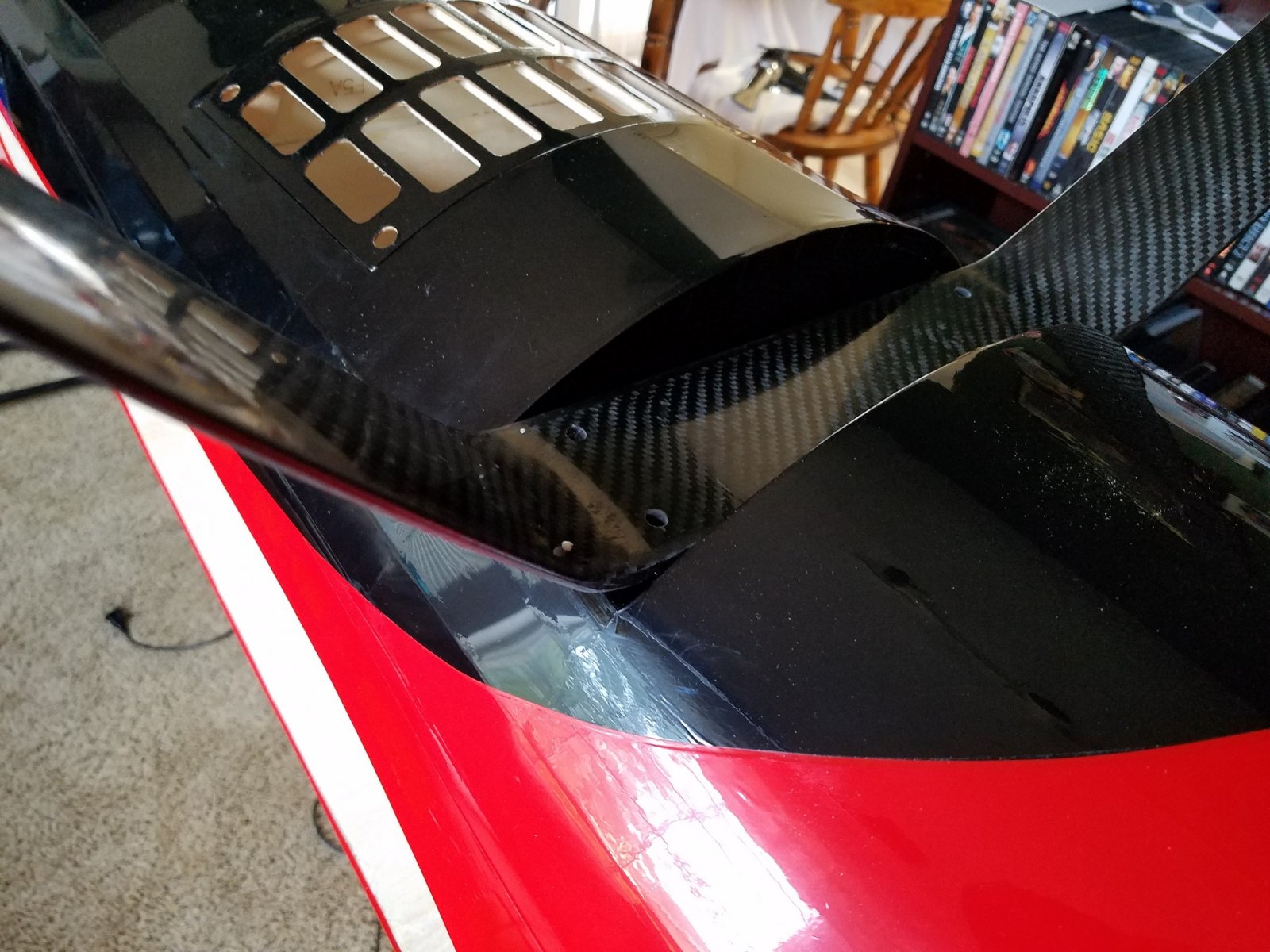

		Well ya know Kelly? After our conversation of a few days ago, I am thinking I will put the snorkel back on the 106. True I gained some rpm on the ground. 6570 is what she is twisting the Falcon 28x10. And sounds really solid, consistent and strong. But in the air...she has a dut...da...dut dut...da dut....miss. I am thinking it is the turbulence of air past the carb. Since it is in direct line of the small round opening in the lower front of the cowl, it may be getting some really "dirty" air. So, I may lose a couple of rpm's on the ground, but in the air is where it matters most. I will definitely keep ya posted. All things being considered though, ain't nuttin' like a pair of red headed jugs to keep ya breathin' hard eh? Well, unless it is a set of quad red headed jugs.
