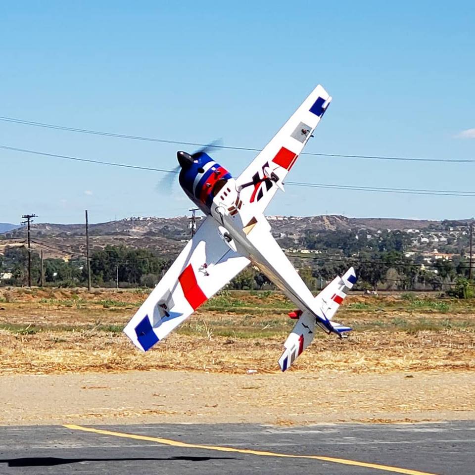

Did a little flying with the 105 this weekend. Added 4oz of lead to the tail after Terry Wiles suggested it, now it rotates much betterI'd say this bad boy is ready for the AMA Expo West in a couple of weeks
