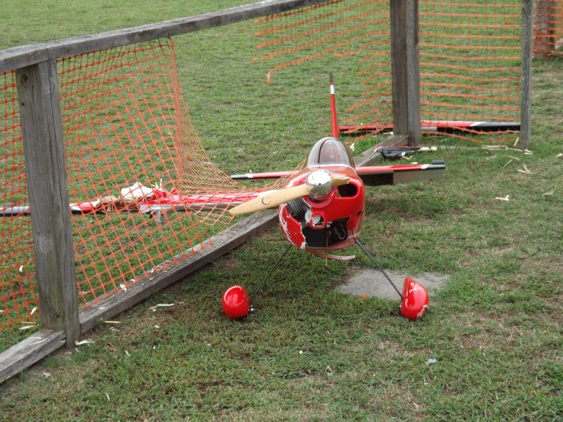

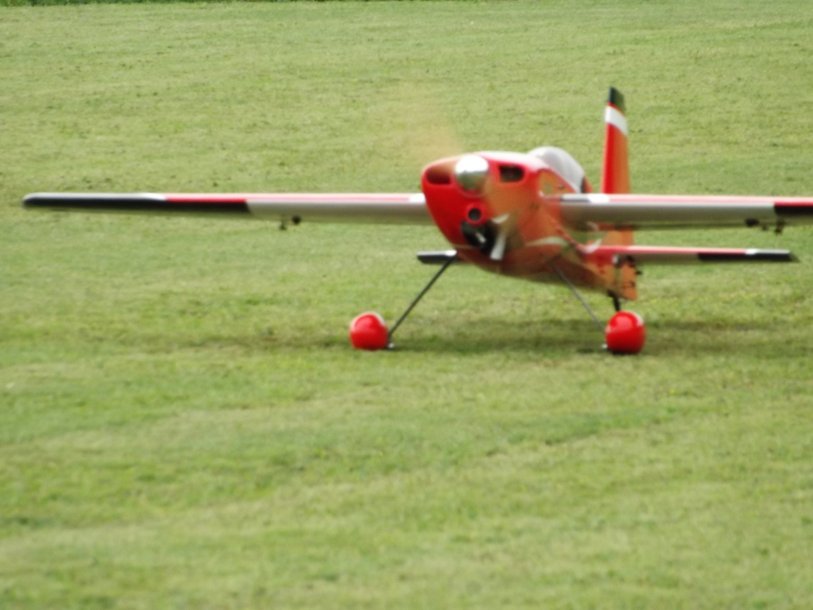

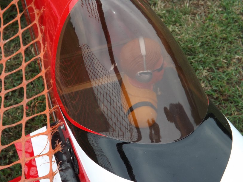

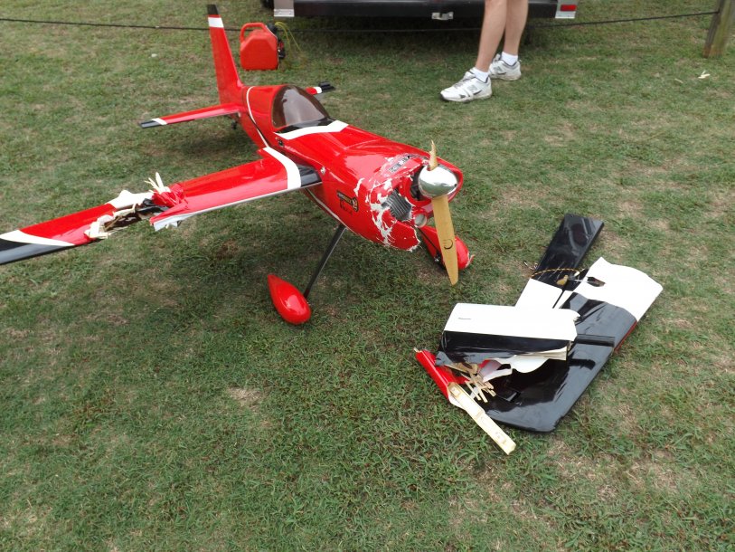

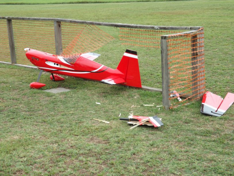

Well myself and @mulehead1969 went out this morning, it didn't go well. Really not sure what happened(lock out), flight went well, he was taxing back to safety fence, it went full throttle, took out one post of fence, HARD HIT, it knocked 2x4 post 10' into the pits. Good news, set of wings, wing tube, and cowl, he back in business. I was out there taking pics, scared the dodo outta me. First pic is the taxi back, then all hell broke loose.

Glad it was just a fence and not a person...what a weird feeling that woulda been taxing along and all of sudden full throttle.
Dang that sucks. May I ask what radio system?
Man that sucks. I'm really glad no one was hurt. Did you have a fail safe set on the throttle?

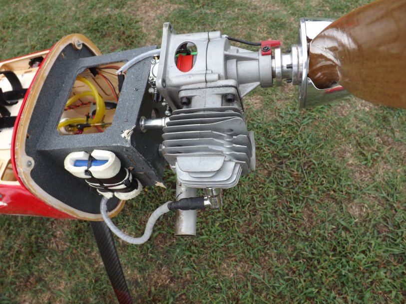

Figured out what happened. If you look at chicken balls first pic you can see the engine is only holding on by one bolt. The other 3 are sheered off. Crap luck I guess.
