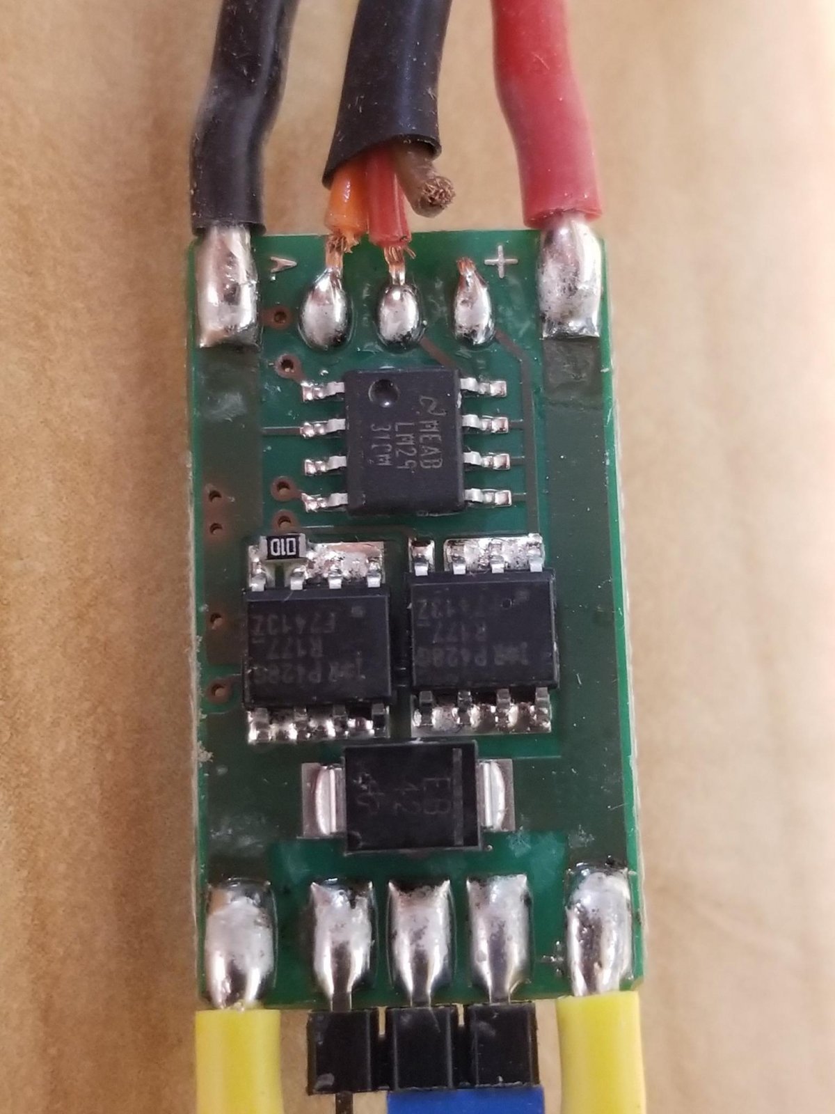

I got away with a big one tonight!!! The engine started cutting out from time to time while flying but, it seemed like it was only in certain attitudes. I brushed it off as a fuel flow issue and did a little tweaking on the carb figuring the engine was finally done breaking in :) Everything seemed to be getting better so I took it up for one more quick trip round the field. While going down the back stretch it started cutting out worse than it had all night so I immediately landed and while walking behind the plane I noticed a green led going red when the engine was cutting out. We took the plane apart because it was getting dark and didn't want to troubleshoot with the wings on. After we got it apart I turned the plane on and started wiggling wires. The electronic ignition switch control wires were definitely not acting right.
When I got home I pulled the ignition switch out and the picture below is what I found!!! I have soldered a new heavy duty connector on and made sure the wires are supported better than they were before. I also replaced the positive and negative leads with much longer ones due to the location of the switch.
IMHO the control wires should have a stress relief of some sort as they come off the board. When I soldered the new connector on, I used double heat shrink for thickness. Then I put a piece of heat shrink around all 3 wires. Finally I put a final piece of heat shrink over the whole board and let it run down the wires about 1 1/2". Now it has proper stress relief and breakage should no longer be an issue.
The other thing I noticed is the blob job soldering :( A good, strong solder joint will show the strands of the wires and there will be a fillet where the wires are soldered to the board. I wish I would have taken pictures of my final result to show you what I mean. When you have a lot of solder, you are opening yourself up to cold solder joints. They may work for a period of time and then all of the sudden you start getting strange things happening and it can be a pain to troubleshoot. 20 years of electronics in the Marine Corps taught me more than I thought :) Semper Fi!
