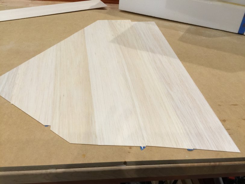

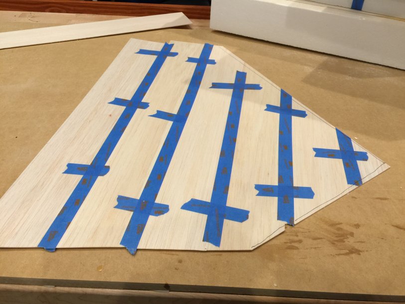

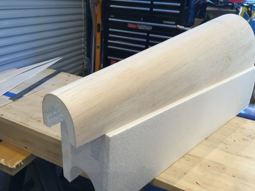

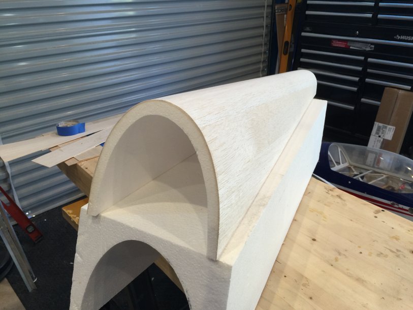

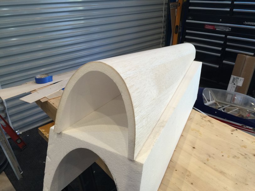

Here is the result of the similar process for the turtle-deck. I did not edge glue this one, just taped it together, placed it in the shuck, and then glued it all together.
This one is more likely to slide, so also keep a good look at it for the 1st 30 minutes.
View attachment 49996View attachment 49997
Try taking pieces of masking tape,folding it on its self, stick the pieces to the shuck, then when you put the sheeting down , the tape will hold it in place. That's how I do it and I don't have a problem with it moving.
Ah yes, i had forgotten about this trick!! I have done this in the past. Getting old sucks!
Thank you for re-reminding me about this.

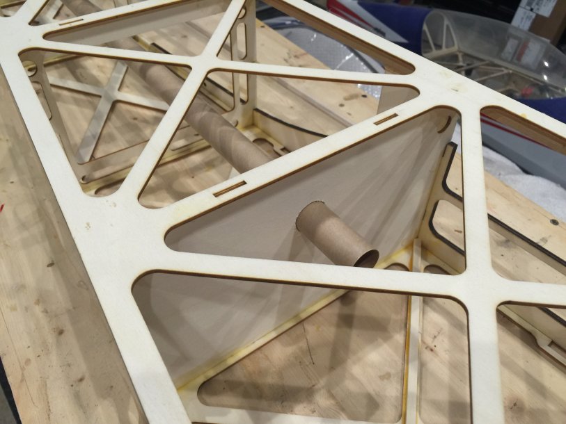

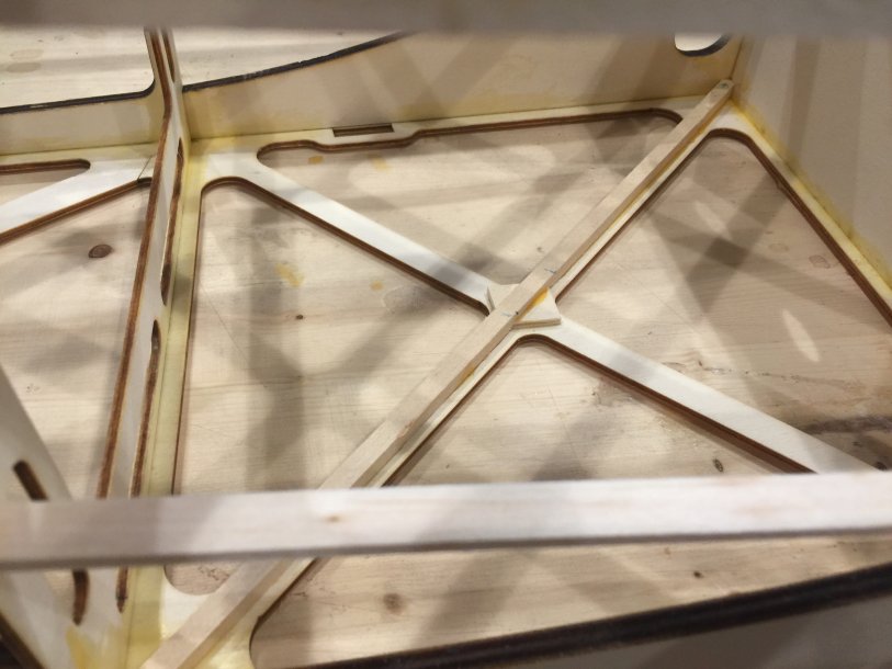

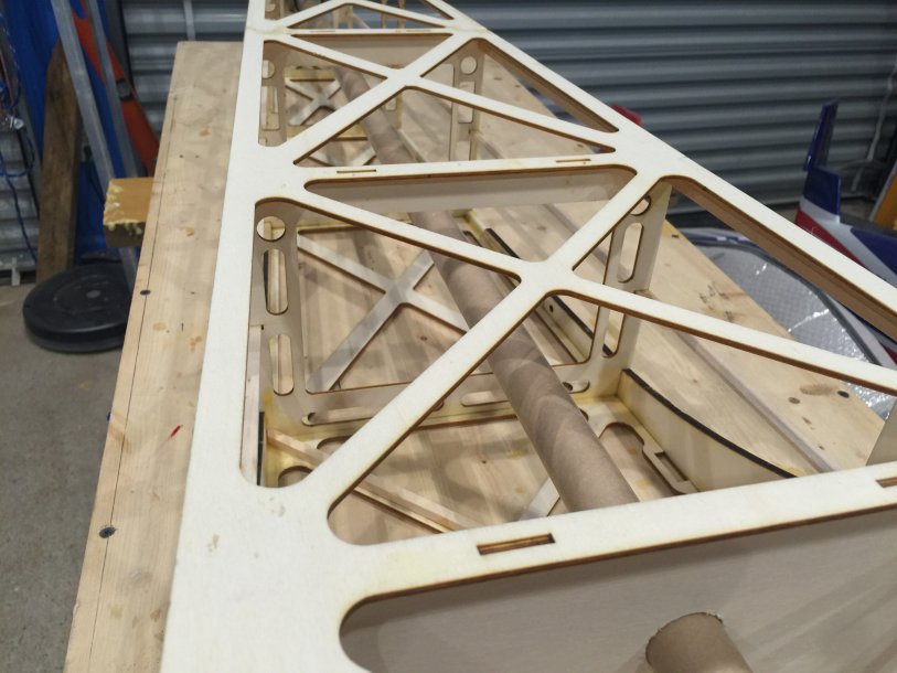

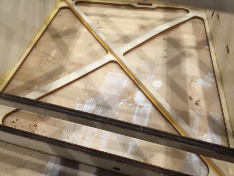

got the servo lead extensions conduit tube installed. Still have to glue it in place.
Also, I am quite paranoid, and Did not like the top brace not being reinforced, in between F2 and F3 and F3 and F4, that I had to reinforce it with 1/4" spruce.

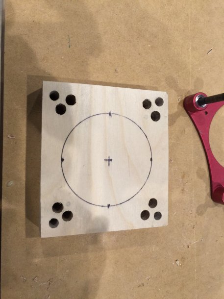

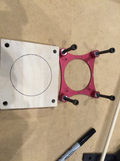

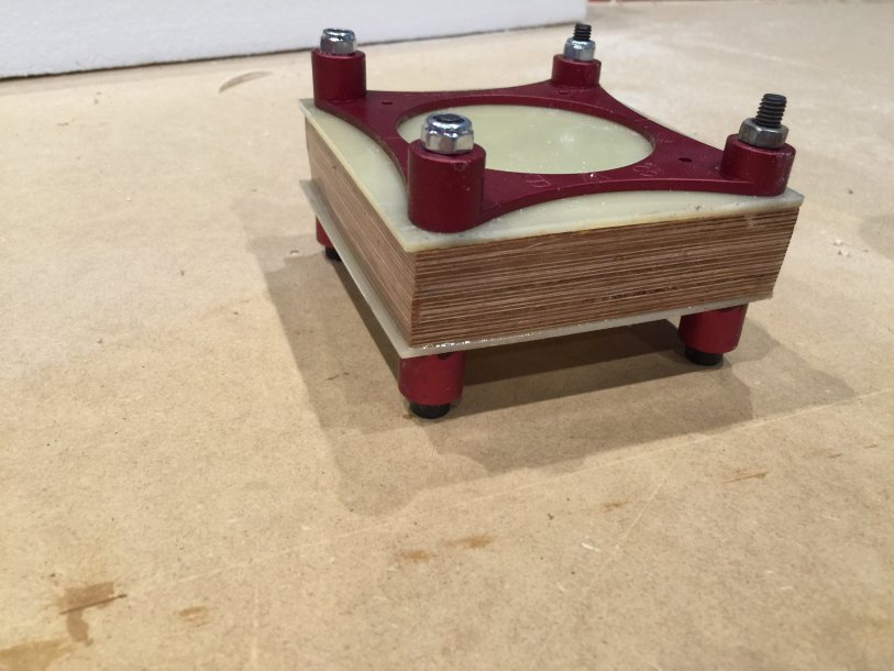

I am making a mount extension for the new motor,.
this will be a total of 44 mm.
I ordered some 1/4" Finnish plywood, aircraft quality, from Aircraft Spruce. Cut 4 pieces, and glued them together with Titebond I.
I am using an SWB mount as a template. I believe the spacing is 80 mm by 90 mm for the holes.

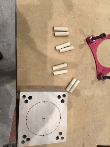

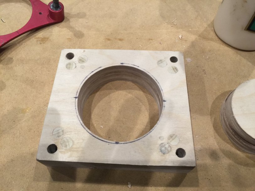

the holes for the mounting are 1/4". But then I drilled two 5/16" holes next to each mounting hole. these will be filled with 5/16" poplar wood dowels.

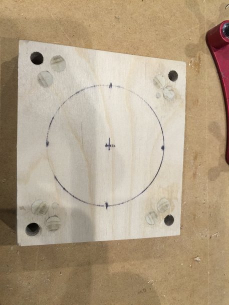

Dowels glued in

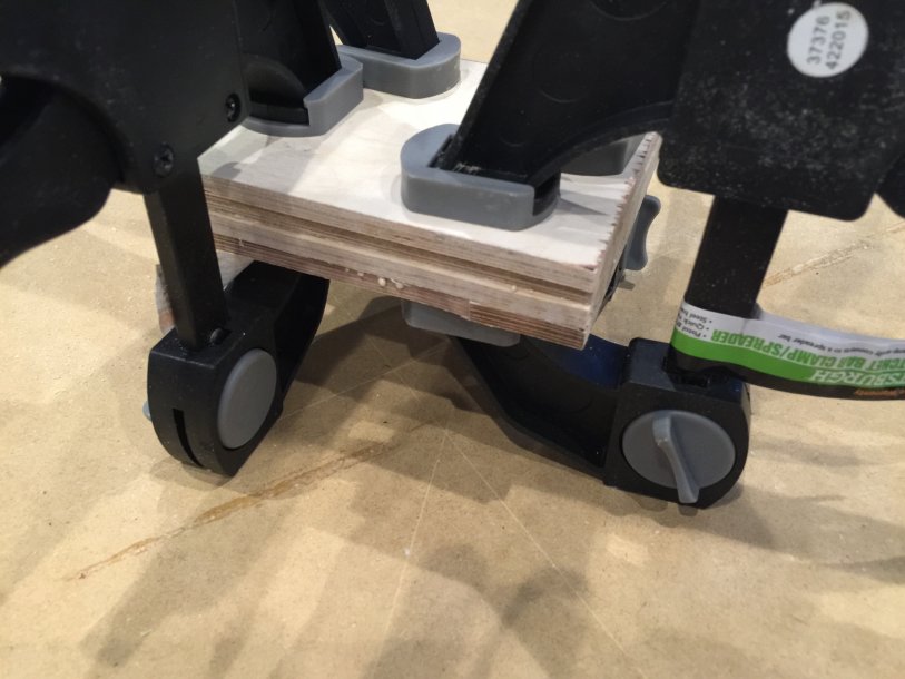

I drilled out the center so that it will cut down on the weight.
I then laminated the front and back with G10 material, and clamped it together with bolts. I am using Epoxy resin, this should be cured by tomorrow morning. then I will sand down the edges and make it "pretty". I will also cut out the center hole from the G10 material, and then I will weigh it.
