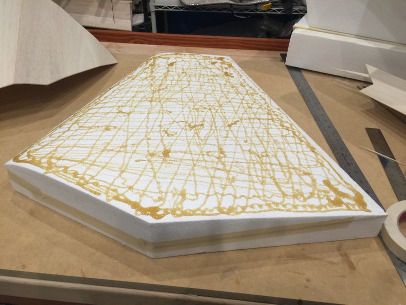

Cam its looking really nice but we have to get into vacuum bagging!
I hear ya. I am intimidated by the unknown. I have never done that before. I am afraid if I mess it up. Have you ever done it before, or, could you show me where I can learn more about it?

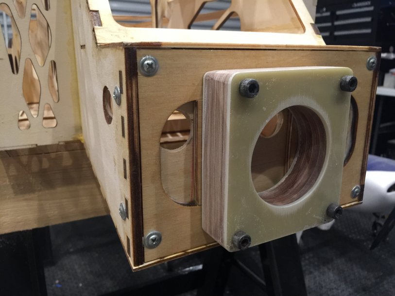

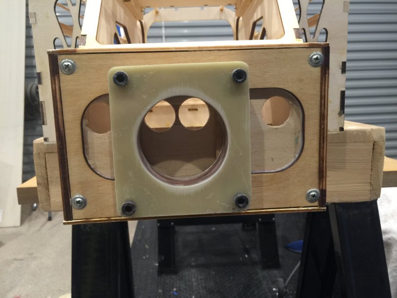

just finished the mount. Came out real good. With the SWB mount, the total length is 44 mm, which should give me about a 5 mm spinner back plate gap with the front end of the cowl.
total weight is 6 ounces.

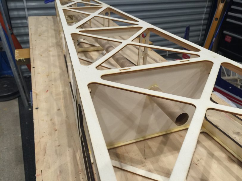

the tube is glued in. These are Estes Rocket tubes. BT 50 tubes, with the couplers.
Very lightweight. Inside diameter is 0.95"
