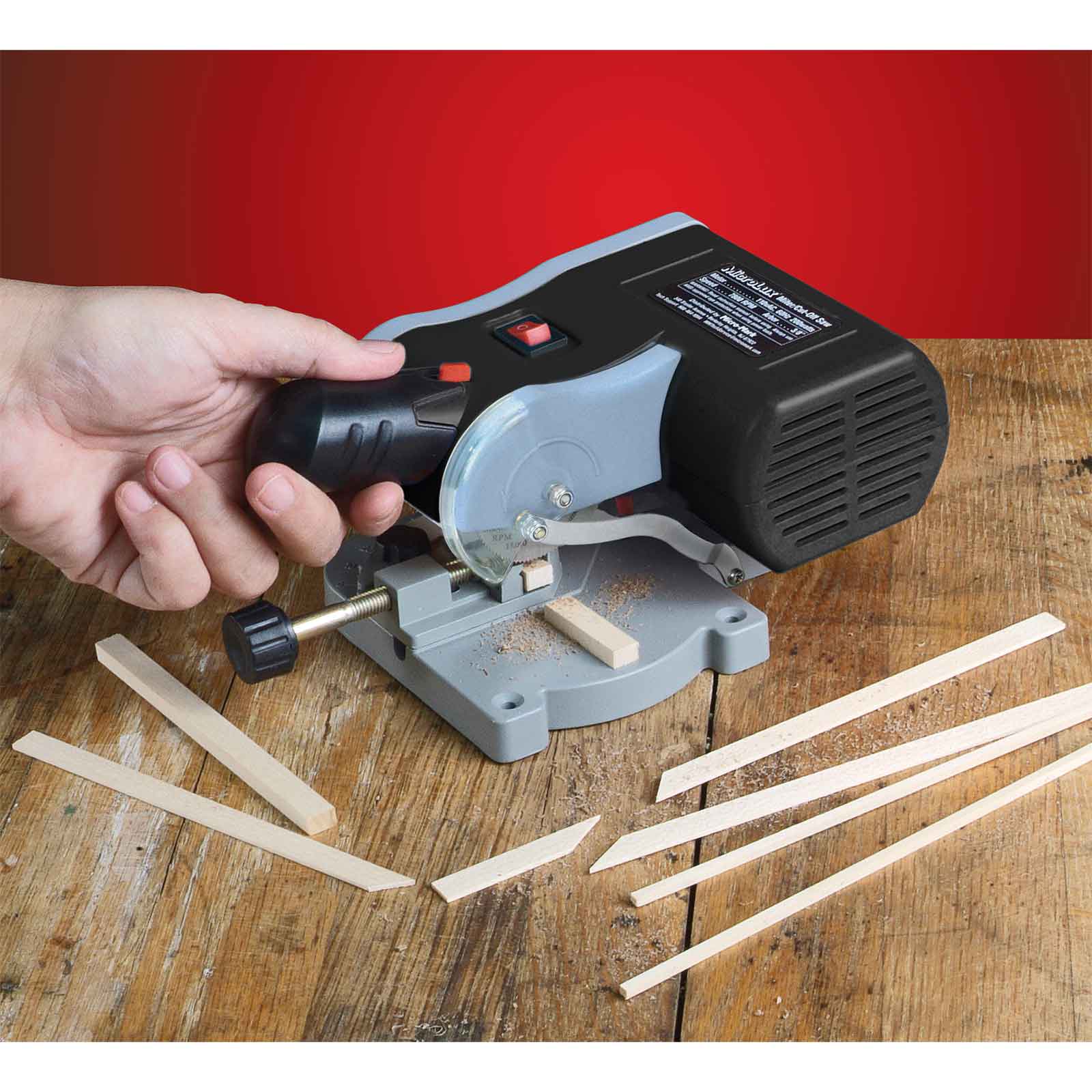

By the way, some time back a friend and fellow modeler was getting out of the hobby. I went to have a look at what he was getting rid of, which was pretty much everything hobby related, and I bought most everything he had. One item in particular I had seen around but thought for the price, along with looking cheap, it must not be much good. It was a little chop saw and he did not want hardly anything for it so I got it. It is cheap, but, it does a nice job for what it is, definitely beats sawing by hand, clean and square cuts. It did well enough with a piece of hardwood I had to try a small piece of brass tubing, good clean cut there also. Not fast by any means but does the job well enough if it went south I would by another one.

This one new from Micro Mark is $80, or you could go for the Proxxen for $330, both are on sale right now.
I might have to snag one of those. Looks like a nifty little tool.

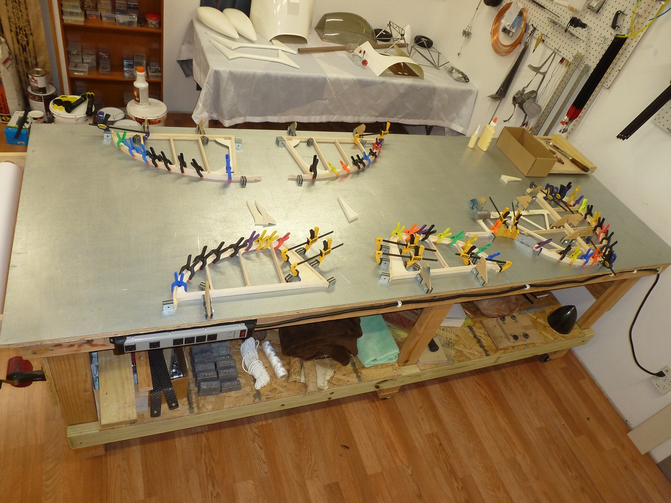

It has only taken three hours to clean all that ca junk off, cut some more strips, soak those strips, place the strips and let dry one hour, then remove and glue the strips back in place. After having to go through all that I will not seek another untried method again. I think I will let this set at least four hours, might be overnight though.
