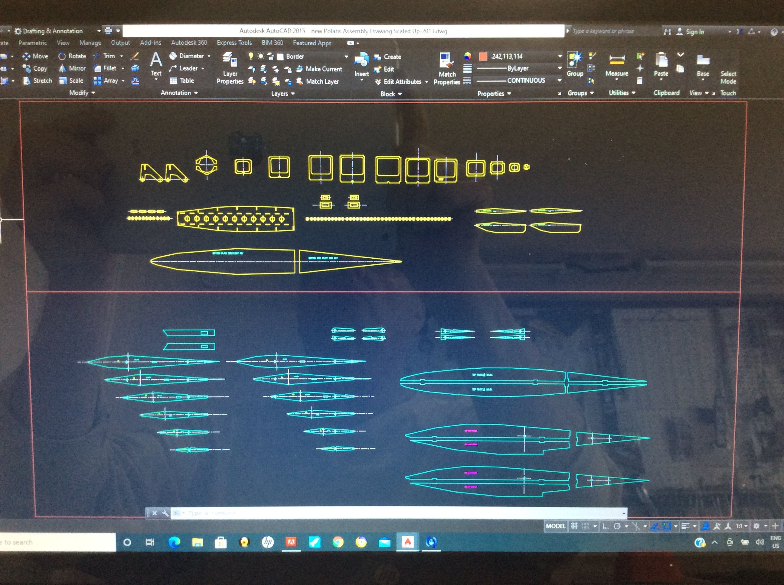

    I believe it is done every time I look at it a can make a change or improve it so just stop looking. Up to 114 detailed parts. Just have send it to the cutter to check it out and give me quotation to supply all the wood and parts. All the parts are detailed so that it all can be made from 3 by 36 inch sheets.

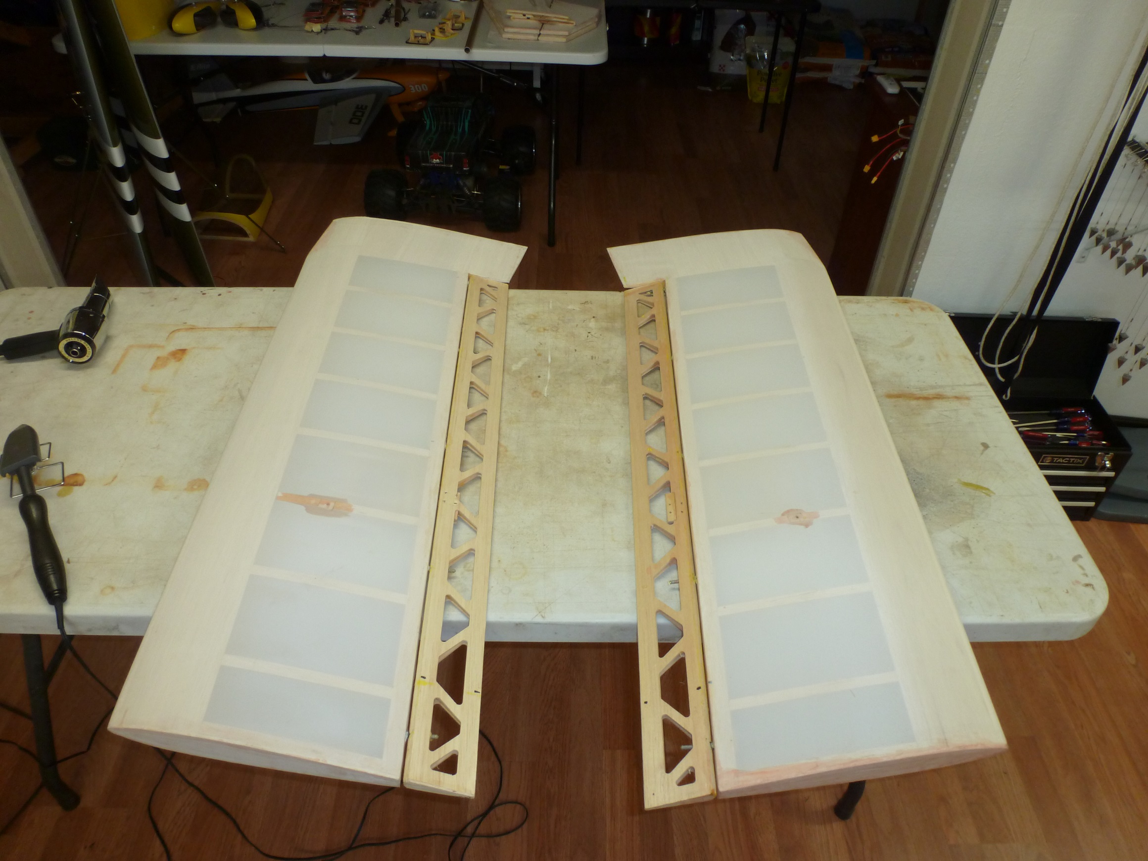

    Don't know where the thread is, not going to say much other than the base top wing is covered.

    Nice! I assume you’re using Scale Stits, aka Poly Lite?

    Yes...

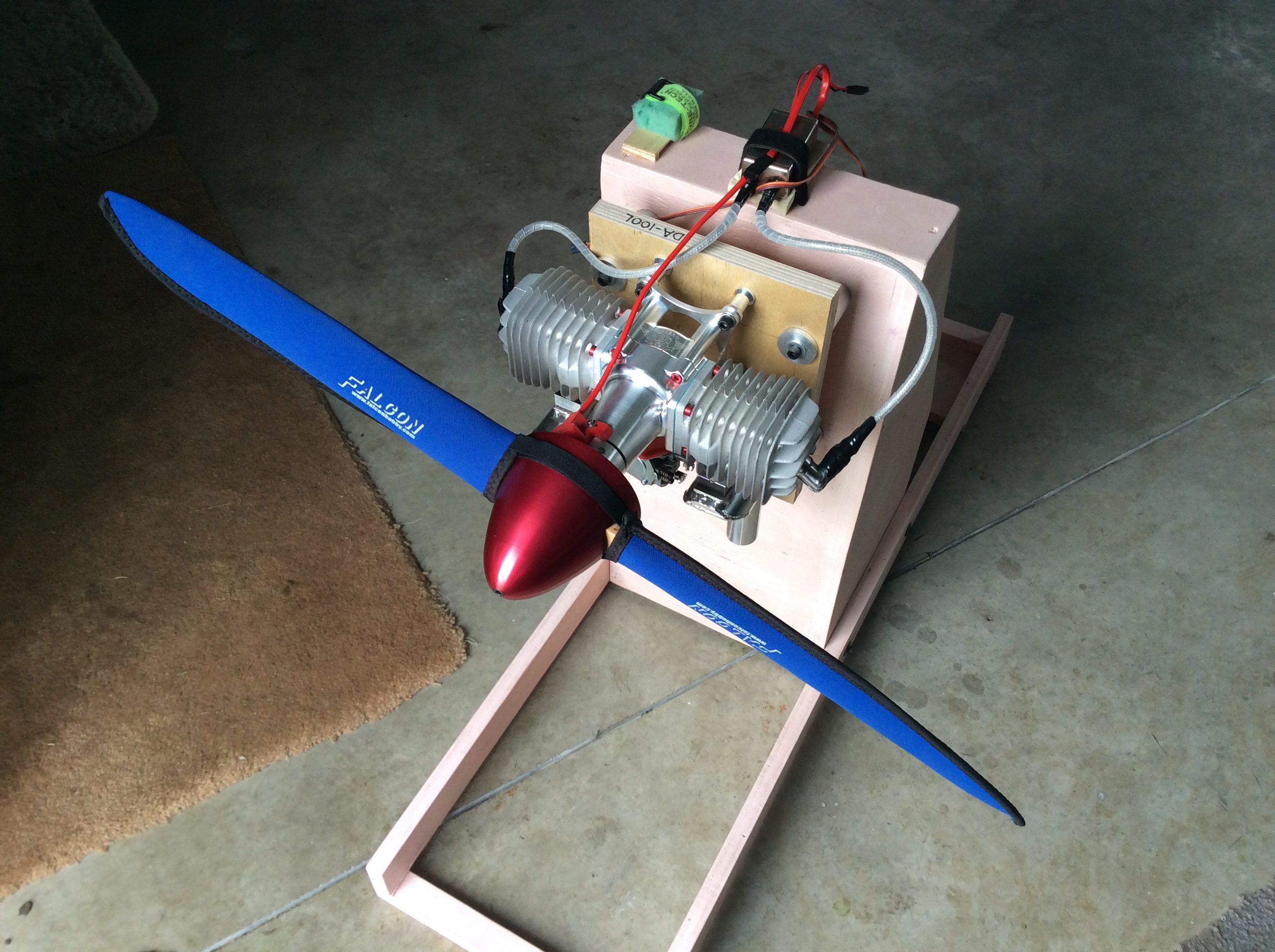

    Installed the 100 on the test stand. Flipped the propeller till the fuel interred the carburetor. Closed the choke two flips it burped. Open the choke one flip and it ran. Let it run at about 2300 rpm for a minute then accelerated to full throttle for 3 seconds and then Dow to idle. It just sat there and idled great. Couple short throttle bursts and it accelerated great. Shut it down and will installed soon, that all of five minutes and I was done, great engine looks like a winner.
