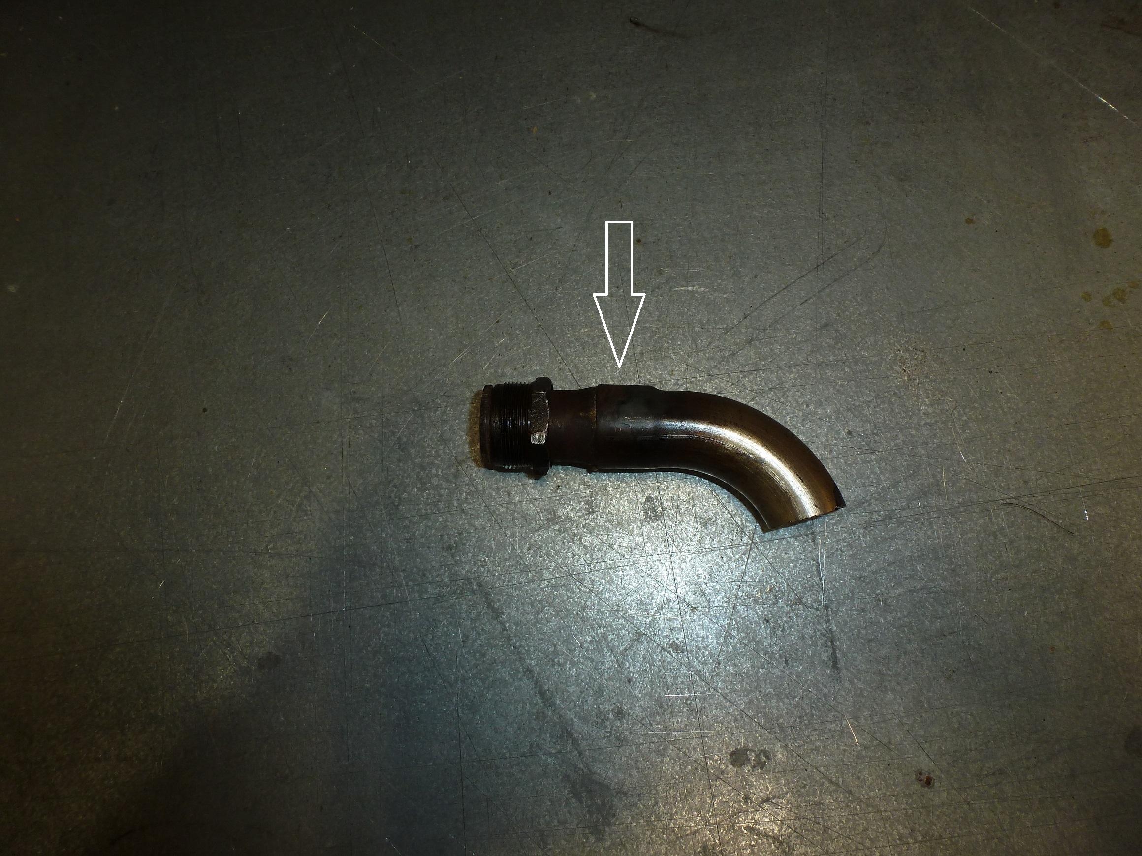

My exhaust parts from Vogelsang have shipped, I expected it to be weeks. I have a question for someone better than I, which is you guys. I have been braising these exhaust parts together which makes for a real pain when needed to separate, ended up cutting it out in pieces. Is there a form of solder that can handle the heat of exhaust that I could use instead of braising?
Pic shows the joint being assembled.

I have a mini torch, putting it together is no problem, it is separating after installation, no room to heat the header up. The set-up requires a box end wrench on the header, so instead of a two into one I'll just go with duals. The header requires removing the valve covers, a tappet, and a pushrod to get the box end on. I have been scouring the web and think silver soldering is my only option.
Are you brazing rods like from Lowes? If so you need about 1500F to braze, silver brazing filler such as Harris Safety-Silv 45 melts around 1200 f so you can reheat the joint and separate the parts. You can also use a propane torch which is easier to control the temperature and prevent overheating. You also need a flux such as Stay-Silv black flux. I find the black flux works better than the white.
I have been using an Alpha Fry kit that contains silver, propane torch I have won't touch it, have to use the mini torch. But I have been looking for the Alph kit and don't see it any longer so I may be going with the Stay Silv from Grainger.

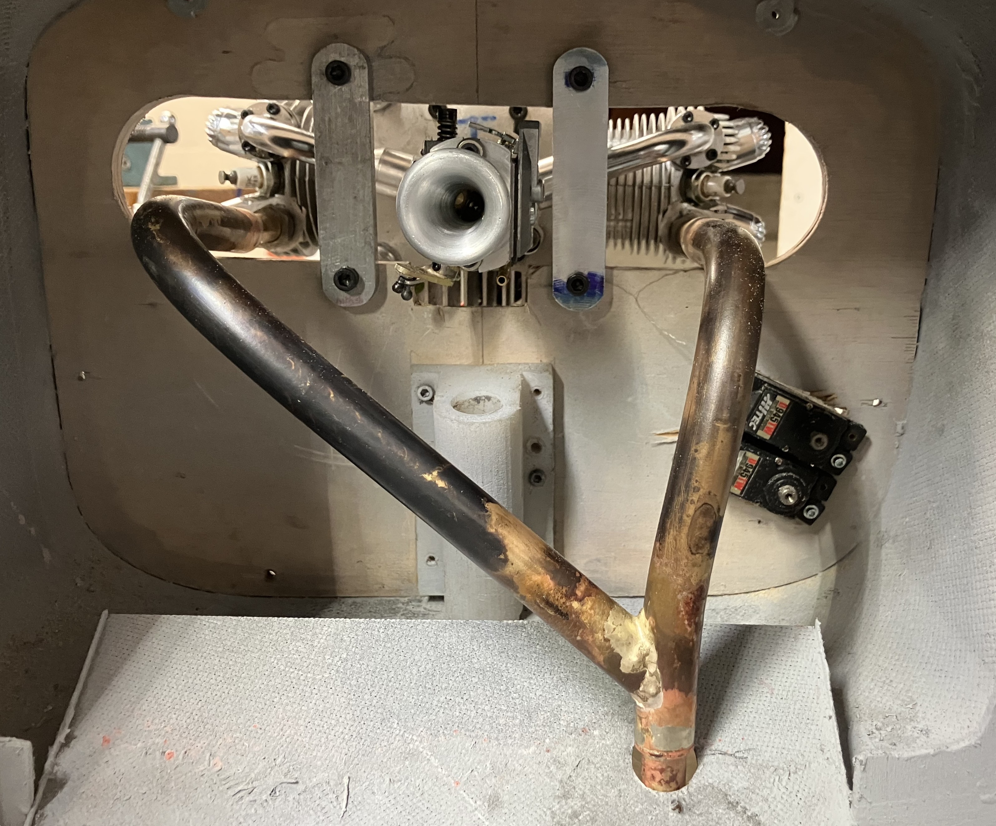

That's what I use, a plumbers torch. I use propane for small light stuff like exhaust, on heavy steel parts I use MAPP gas. The acetylene torch is too hot and destroys the flux. The 5/8 " tube below was silver brazed with a plumbers propane torch. Both the slip joints and the butt Y.
I just bought a troy ounce on Amazon for $50.
