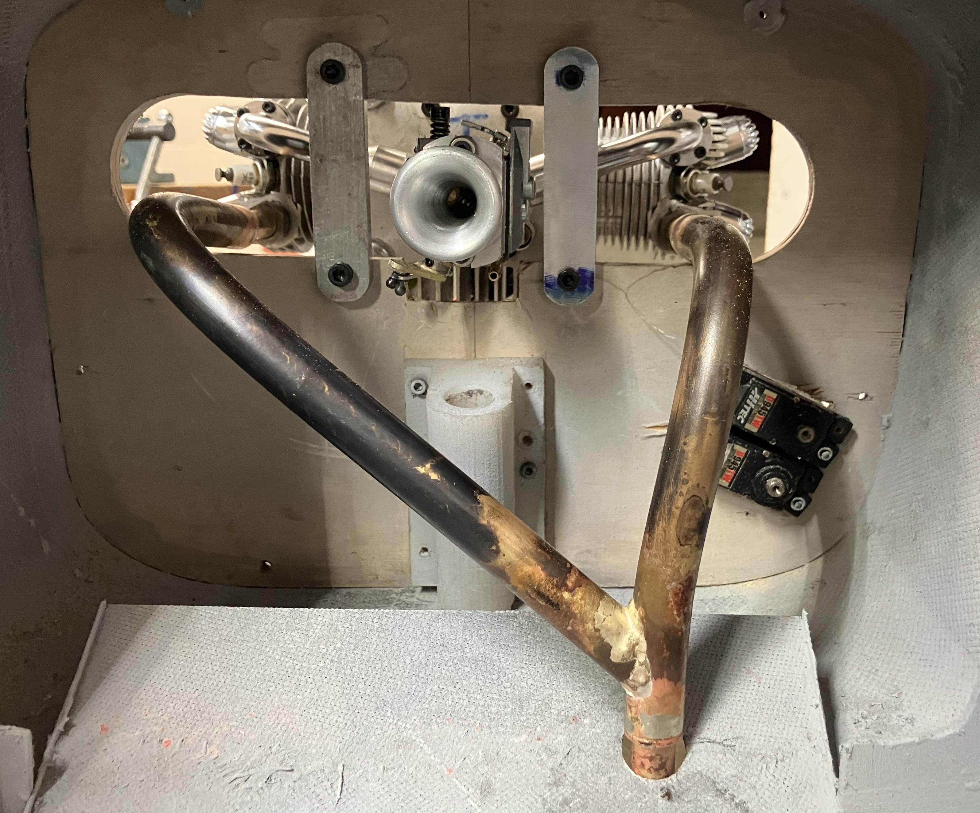

That's what I use, a plumbers torch. I use propane for small light stuff like exhaust, on heavy steel parts I use MAPP gas. The acetylene torch is too hot and destroys the flux. The 5/8 " tube below was silver brazed with a plumbers propane torch. Both the slip joints and the butt Y.
I just bought a troy ounce on Amazon for $50.
Very nicely done. Thanks for your help. I'll give it a go again with the propane.

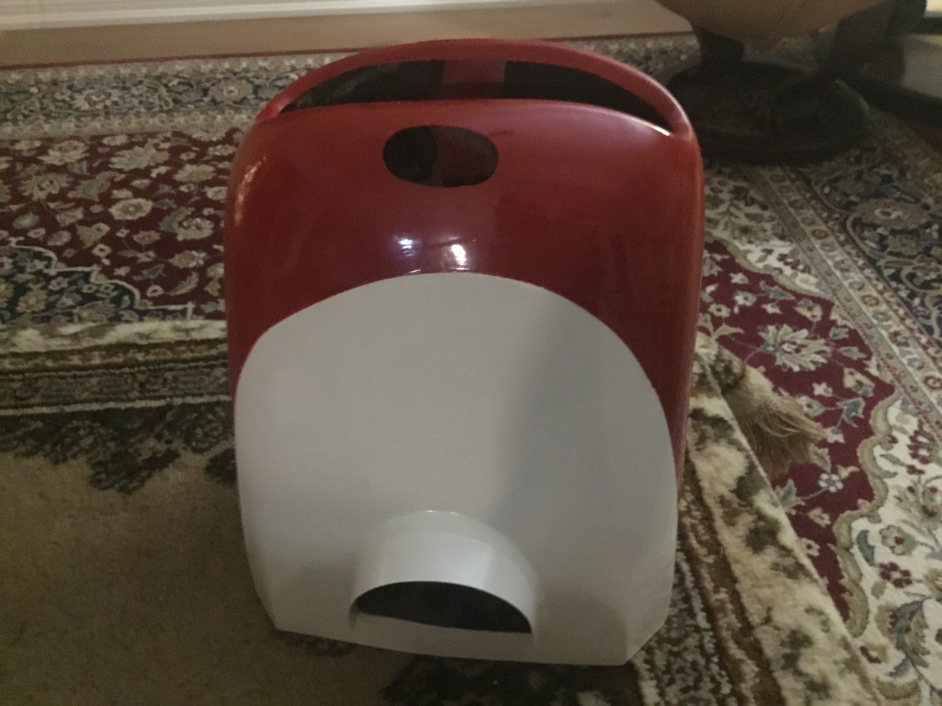

Well the cowl is painted and looks ok. The red is not quite a match but good enough for me. Flying past down the runway nobody will notice. Checked the CG and for a change it came out perfect. Just have wait for some parts to finish off the plane. The air ducts for the electric motor is done, time consuming and just tedious to do.

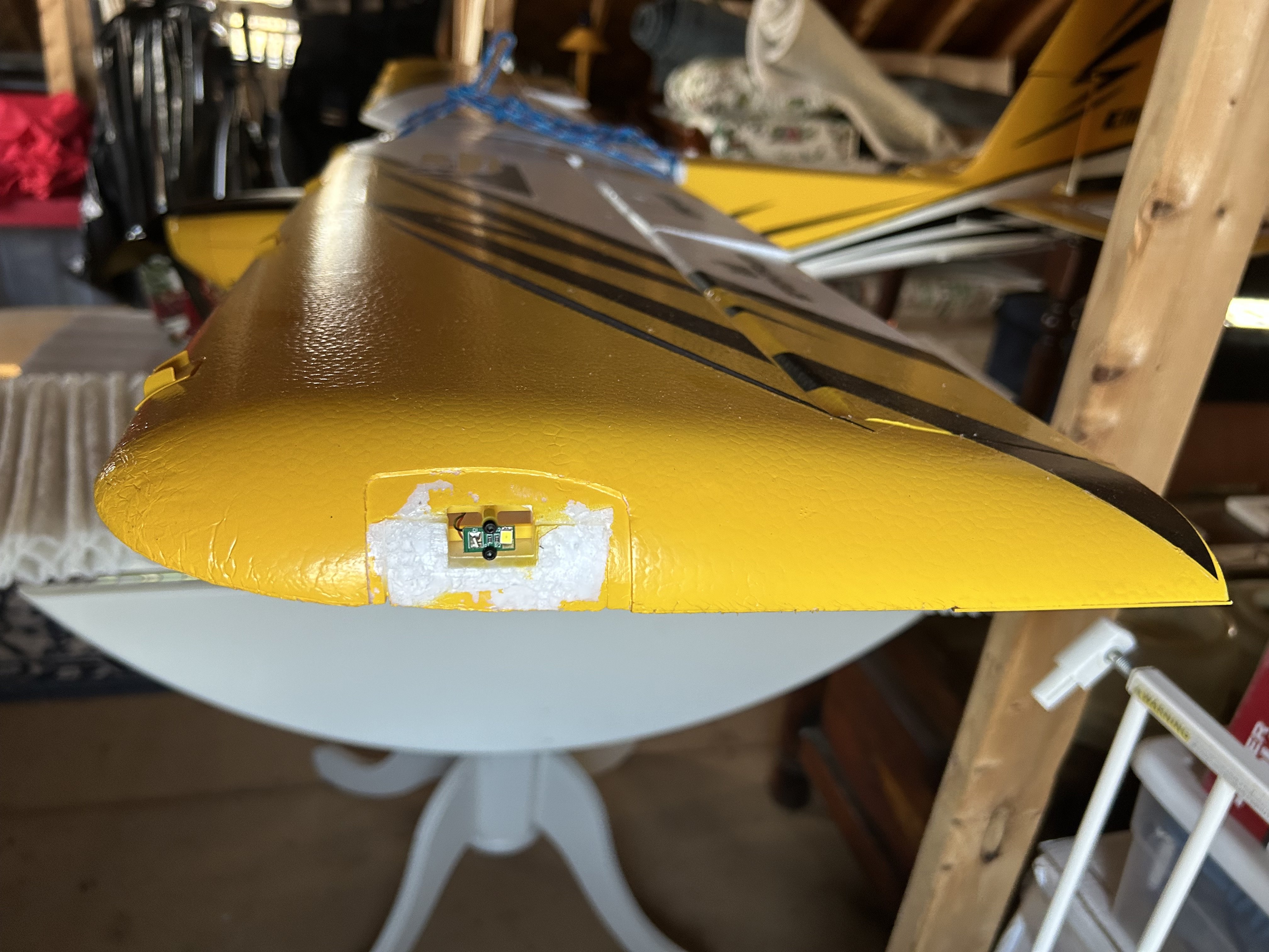

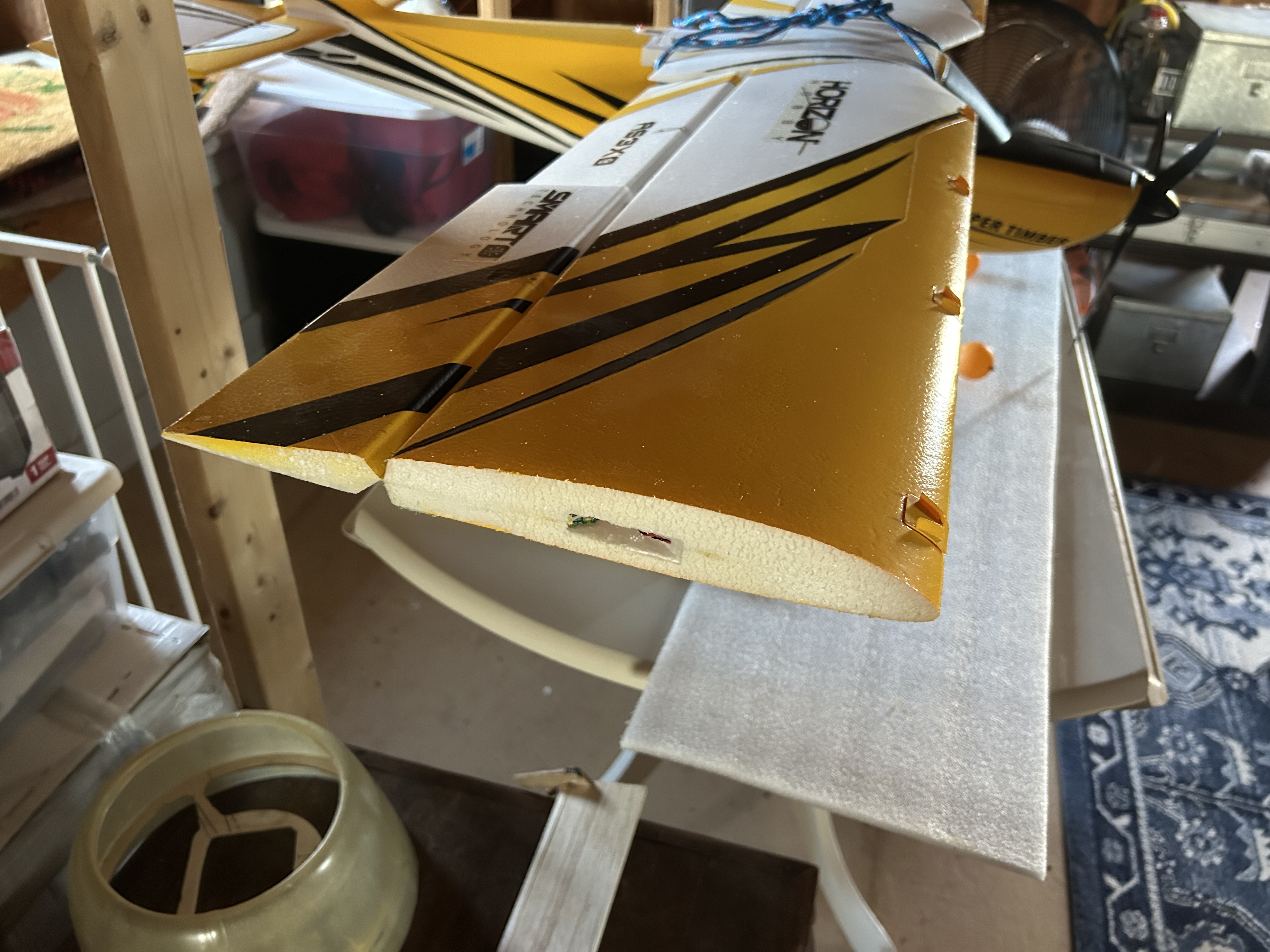

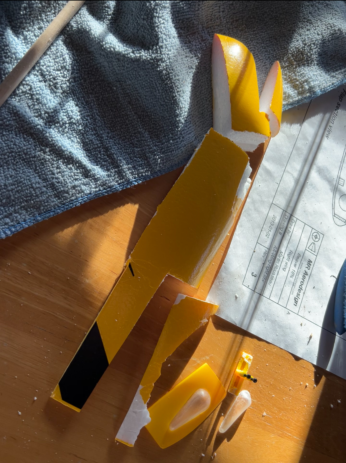

Last time out I dinged the wingtip of the Timber. So…time for clipped wings and fences! Cool little feature of wingtip lights which will be incorporated into the new tip design.
