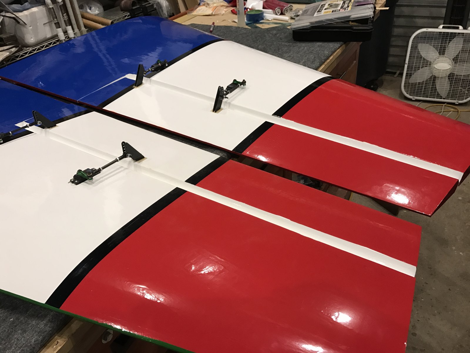

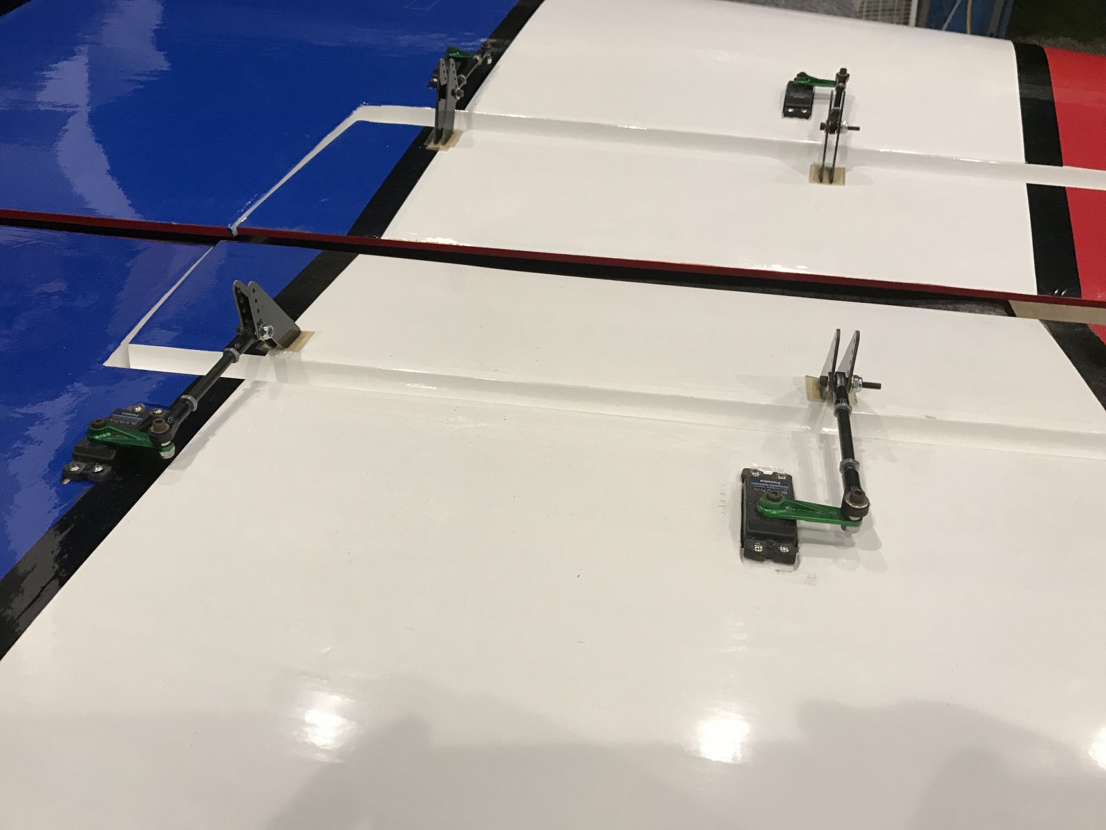

Just finished my new Dalton Yak wings! Now, she is ready for some action. Will be interesting to see how she does with the short ailerons.
