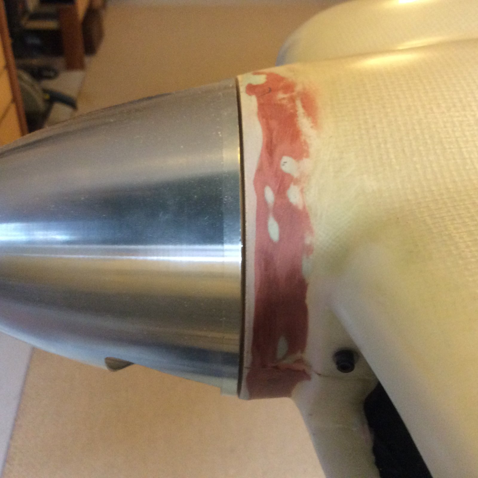

Thought I was done with the building part of the ViperSt. You know what it like the the gap between the spinner and cowl is not just right. Not quite parallel. And every time you walk by it you look at it. Well it got to me redoing the fit and gap. 2 days later and a lot of work it is done. Ok I think I am ready to cover the plane something I am not good at.
Firewall was correct, cowl did not end up with the full 2 degrees. If you adjusted the thrust angle you may have a few issues.
Never touched the the firewall left as is just add a 1/8 balsa spacer to the front of the cowl and then sanded it down to match the spinner and then did some body filling to get nice smooth transition from the cowl to the balsa shim. I can post a picture if you would like to see the end result.
